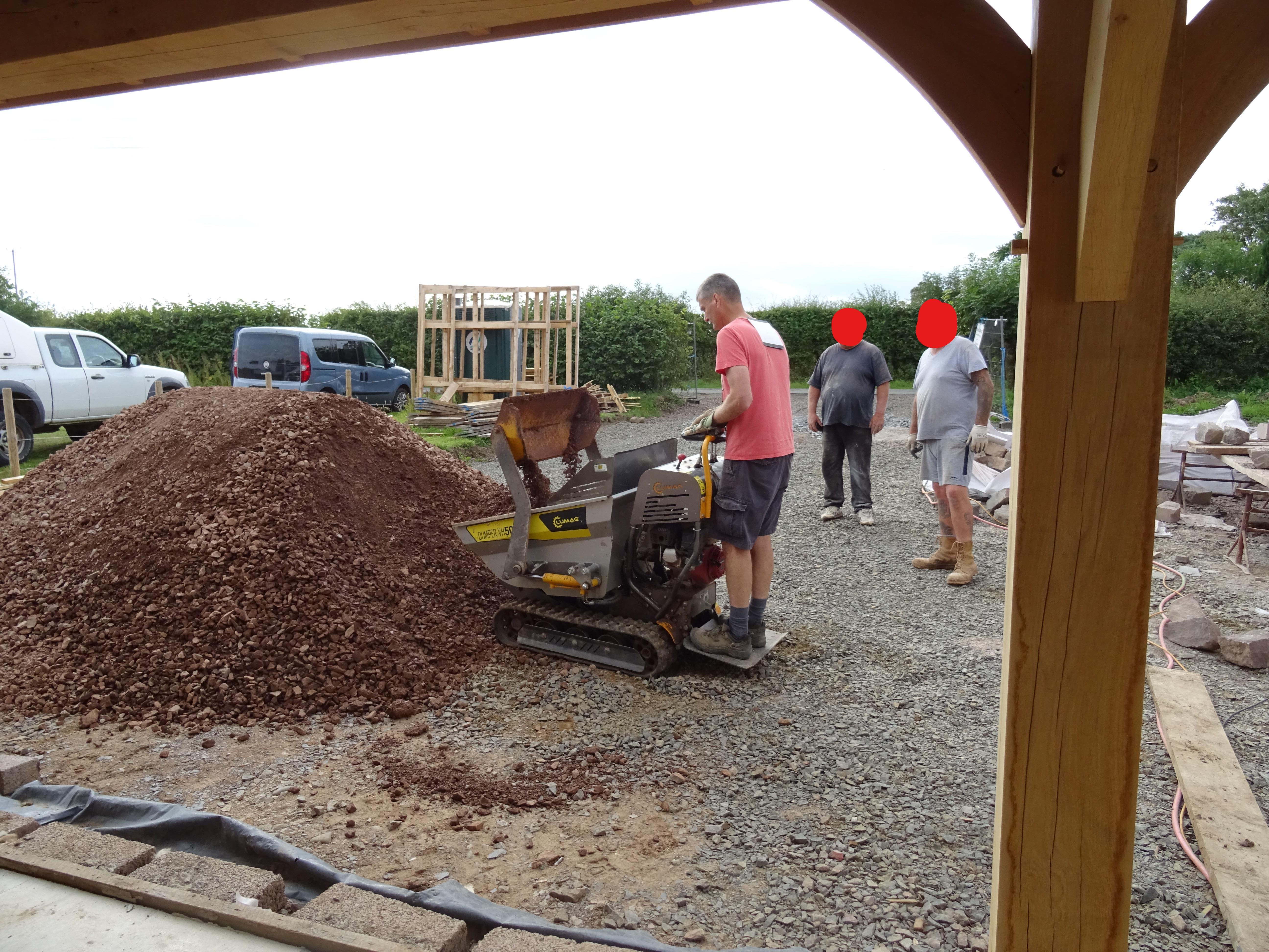

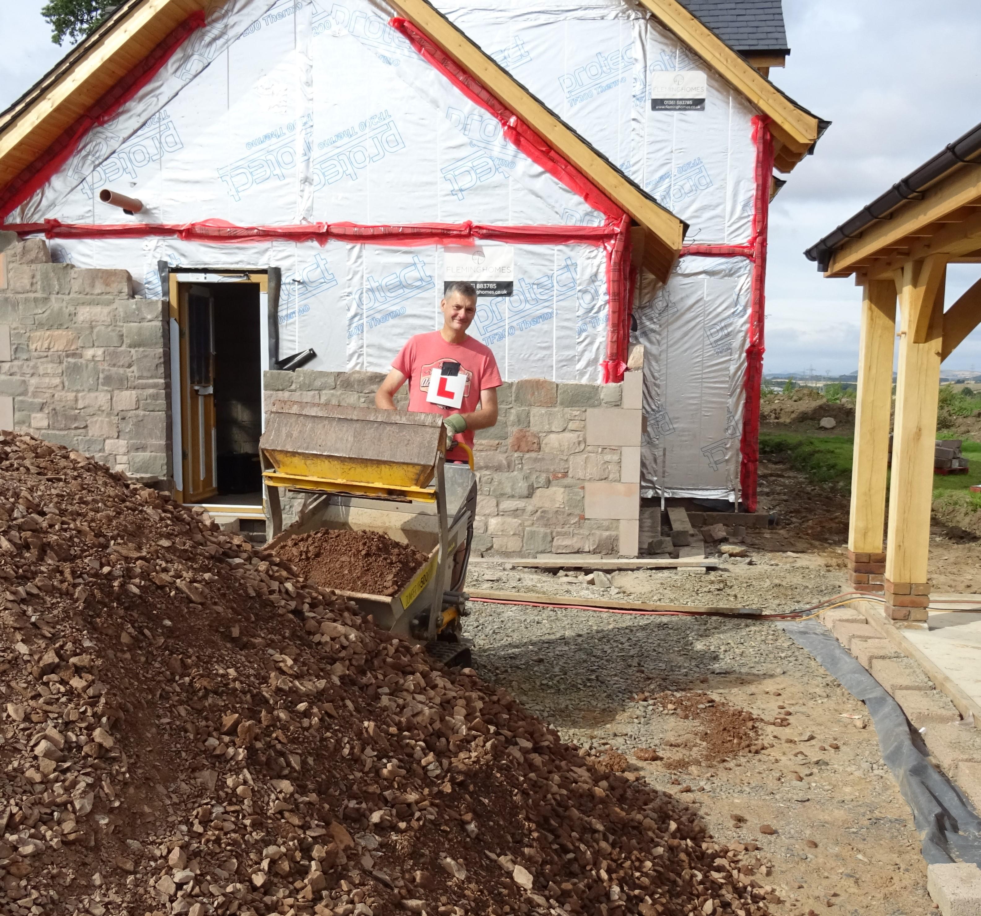

Redoctober Posted October 14, 2021 Posted October 14, 2021 (edited) 58 minutes ago, Russell griffiths said: They are good for loading loose stone and sand, pretty much useless for everything else. @scottishjohn - Exactly that - here I am using one for that very purpose back in 2018 - under the watchful eye of our builders who insisted I wore " L " Plates for H&S reasons ?? Edited October 14, 2021 by Redoctober tidy up
markc Posted October 14, 2021 Posted October 14, 2021 @scottishjohn, if you get 10-20kgs of sand into that small bucket you have done well. The tracked machines are much bigger and heavier so will scoop more.
