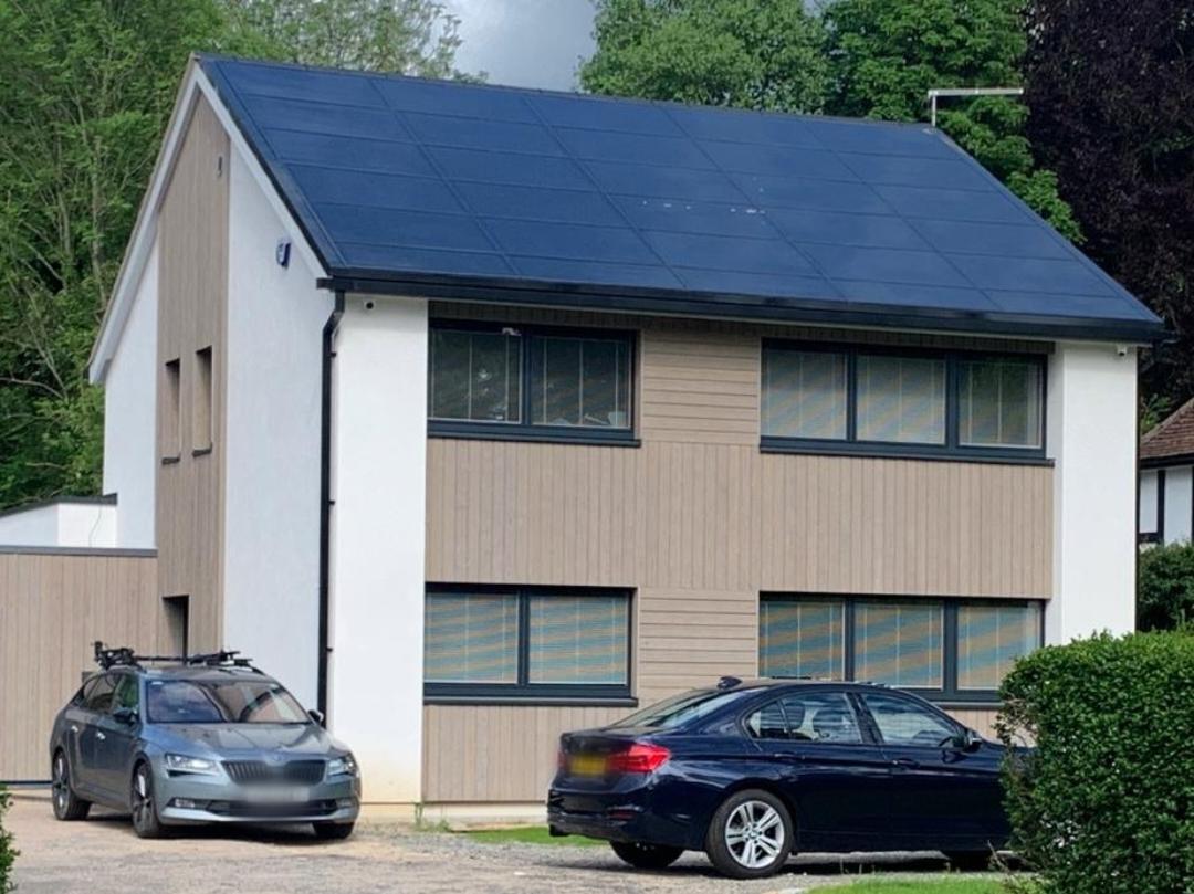

joth Posted October 13, 2021 Posted October 13, 2021 We're in a highly visible location in a conservation area, but still got a full roof of solar into the planning approval. We went with GBSol RIS full roof with no tiles at all, so it actually looks less "busy" than a plain tiled roof, but I think we could have got away with a GSE style of in roof tray system too. One thing we did is cite the Local Neighborhood Plan that conveniently had been revised a month before and said that the planner's default position should be in favour of sustainable developments and measures, i.e. so the onus is on the planner to explain why it's not in the community's interest to approve it.
Dave Jones Posted October 13, 2021 Posted October 13, 2021 (edited) 1 hour ago, joth said: We're in a highly visible location in a conservation area, but still got a full roof of solar into the planning approval. We went with GBSol RIS full roof with no tiles at all, so it actually looks less "busy" than a plain tiled roof, but I think we could have got away with a GSE style of in roof tray system too. One thing we did is cite the Local Neighborhood Plan that conveniently had been revised a month before and said that the planner's default position should be in favour of sustainable developments and measures, i.e. so the onus is on the planner to explain why it's not in the community's interest to approve it. any pics of your roof, the 'infinty' type roofs do look good. How may kw did you end up with ? Edited October 13, 2021 by Dave Jones
Mike_scotland Posted October 13, 2021 Author Posted October 13, 2021 12 hours ago, IanR said: If you're not in an AONB you'll have PD for a 4kW system once you've moved in. Can you wait, or do you want an in-roof system? Otherwise stick in an amendment a see if they've really got the guts to refuse. As long as you are sensible I think they'll back down or risk loosing at Appeal. Hi Ian, we wanted the in roof system. so it would mean lifting slates to put in, its borderline ridiculous lol
joth Posted October 13, 2021 Posted October 13, 2021 (edited) 23 minutes ago, Dave Jones said: any pics of your roof, the 'infinty' type roofs do look good. How may kw did you end up with ? 8.1 kWp Nothing busy about this! Edited October 13, 2021 by joth 1

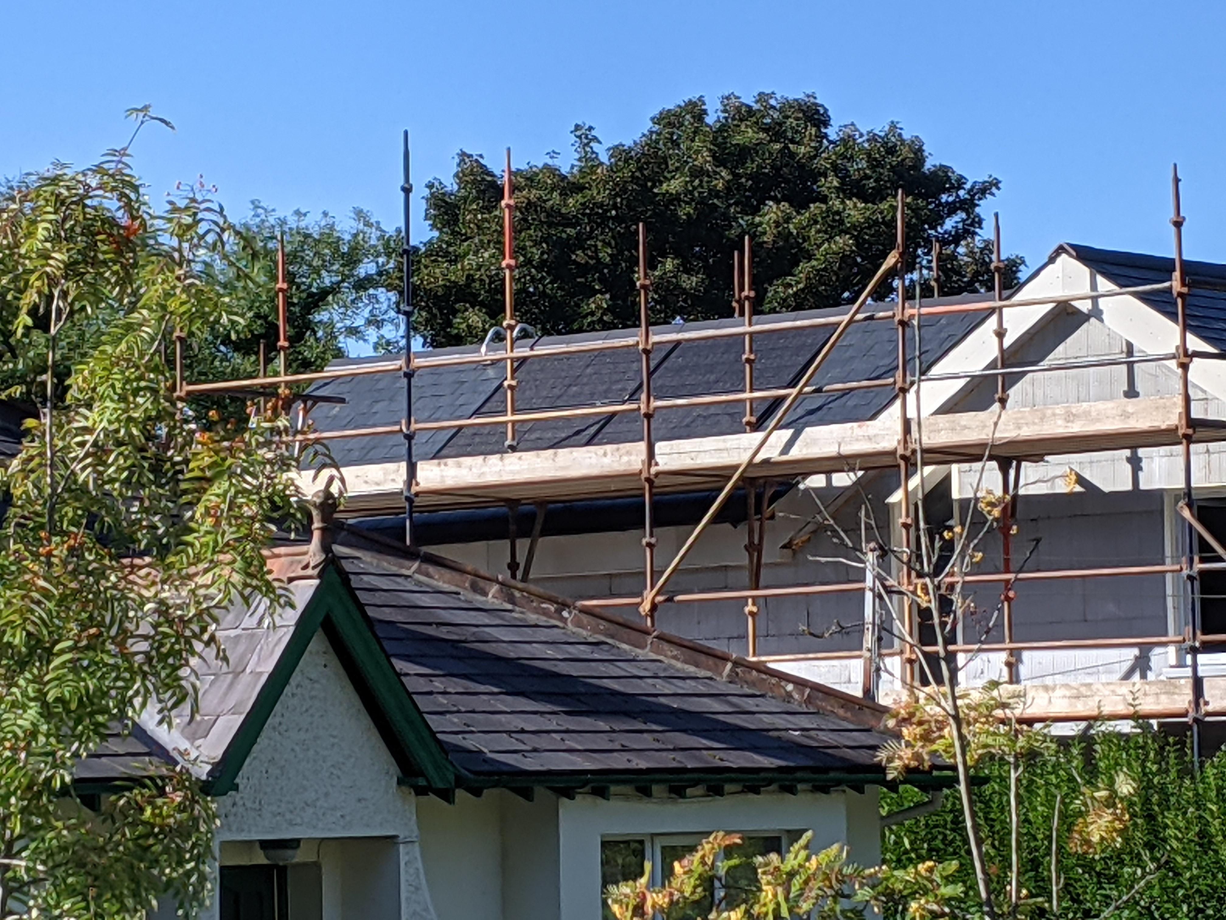

Conor Posted October 13, 2021 Posted October 13, 2021 (edited) This is where there is a knowledge disconnect between local councils and modern building technology. We're in a conservation area and the planners raised concerns that some of our rear PV panels might be visible through a sliver between buildings from the road. I got the architect to send through images of black PV panels set in an in roof system. They accepted this and in fact in an amendment allowed us to put panels on a elevation that is fully visible from the road (image below). Speak to them and put together a document with renderings of your proposed roof. They are thinking worse case of raised blue panels staggered all over the roof, not a slick black system that blends in to your roofing. Edited October 13, 2021 by Conor
Dave Jones Posted October 13, 2021 Posted October 13, 2021 51 minutes ago, joth said: 8.1 kWp Nothing busy about this! looks great, do you mind sharing the cost ?
joth Posted October 13, 2021 Posted October 13, 2021 8 minutes ago, Dave Jones said: looks great, do you mind sharing the cost ? Thanks! 2 £/W for the full package inc inverter, installation, DNO & MCS paperworks. We justified the extra cost on aesthetic it brings and the cohesion it brings to the project as a whole, in the context of being the first solar install (and Enerphit) in this very conservative conservation area , not ROI of the panels in isolation. The biggest hidden cost (not passed on to us) was all the time taken by our main contractor getting the roof plumb and true to accept it. It's not a forgiving system for a retrofit.
