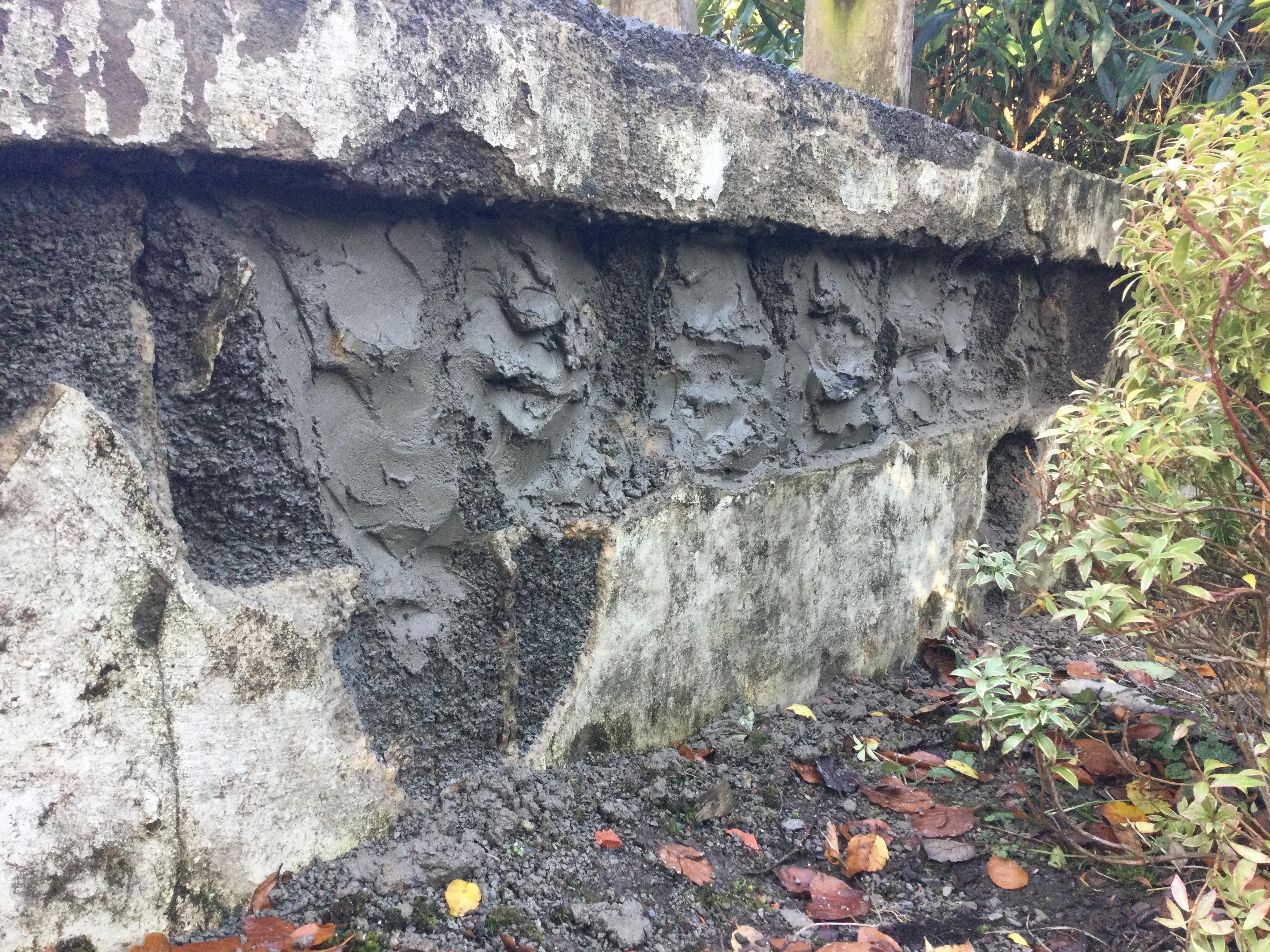

Onoff Posted October 20, 2021 Posted October 20, 2021 If you went carefully, and I mean very carefully, you could use your expanding foam gun to put some blobs here and there to keep the stacked stones in place whilst you render up against them. Remember less is more!
zoothorn Posted October 20, 2021 Author Posted October 20, 2021 7 hours ago, Onoff said: Do not use sharp sand EVER in a mortar gun! Just a cement/soft / builder's sand mix. https://www.screwfix.com/p/roughneck-brick-mortar-gun/67965 Huge pallaver trying to understand this sharp sand thing. Noone in town knows what it is. They just have 'builders sand' but said 3 types do come in, plasterers, builders, sharp.. call them a,b,c then: but they cant tell b from c, so just sell 'sand'. Both b and c bags look identical, or rather i cannot tell if two are different so if both are c or both b.. I cannot tell. Same with the next place jewsons. No idea what it was. Grit sand... i got even more blank faces. Tried to ask a van chap, no idea either. So ive just bought more 'builders 'sand'. But the person did say "builders say this is a bit coarser/ dont like it" so whether its sharp of what it is I have no idea. Perhaps it is.. but it looks identical to my demerara sugar bag pic. How important it is well how do I know exactly, but, it seems important enough from the replies. Utterly bewildering! So how can i tell if its wrong or right for a mortar gun Onoff I can't possibly know. Thx zoot
zoothorn Posted October 20, 2021 Author Posted October 20, 2021 6 hours ago, Onoff said: If you went carefully, and I mean very carefully, you could use your expanding foam gun to put some blobs here and there to keep the stacked stones in place whilst you render up against them. Remember less is more! Good idea. But its prolly jammed solid/ i think it has tbh. But a cheapo can of foam is an idea. I should have 1st drilled in two pins for each base stone to rest on the far side.. dammit.
TonyT Posted October 20, 2021 Posted October 20, 2021 Just get a trowel full of mortar and fling it at the stones, it will embed itself in the nooks and crannies. then you can go over it with a second coat
zoothorn Posted October 20, 2021 Author Posted October 20, 2021 17 minutes ago, TonyT said: Just get a trowel full of mortar and fling it at the stones, it will embed itself in the nooks and crannies. then you can go over it with a second coat I like TonyT's style! Well I thought of this.. but Onoff is correct in that if my stones fall ( base big flat one wedged fairly well in, smaller stuff above etc) then Ive really c*cked up hours of work. I was wondering about going underneath, careful as i can trowel some mortar to the base stone. But i might dislodge it. I think foam for surety.. then a TonyT flingathon. Thanks zh

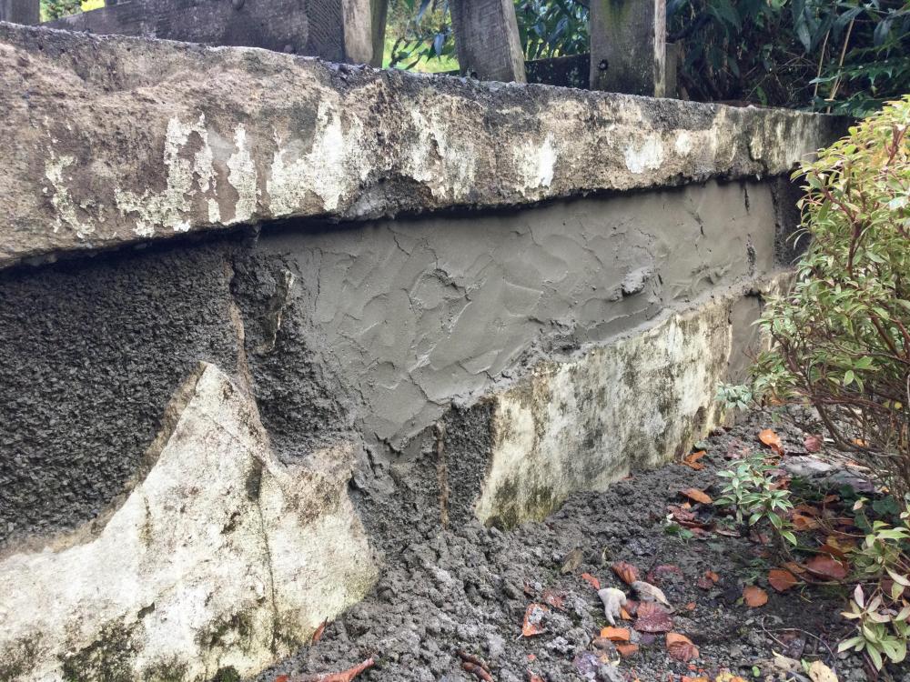

zoothorn Posted October 21, 2021 Author Posted October 21, 2021 Fired in a test/ seemed poss ok/ whacked it in.. far more mortar than anticipated, but shored up the stones ok w'out foam. Mortar's a good 1.5" deep in places tho. Will need maybe two more goes to get the surfaces out enough to do final render layer. How long for this 1st fairly thick layer to set? Thanks, zoot 2
zoothorn Posted October 21, 2021 Author Posted October 21, 2021 11 minutes ago, Onoff said: Looks good ? Hi Onoff. Should i scour the surfaces sometime/ once its going off whenever that is? I think so my next layer has a key is it..
Onoff Posted October 21, 2021 Posted October 21, 2021 7 minutes ago, zoothorn said: Hi Onoff. Should i scour the surfaces sometime/ once its going off whenever that is? I think so my next layer has a key is it.. Nope, that's well "rough" enough. Guessing you might have used the waterproof additive? Looks a nice creamy mix there.

zoothorn Posted October 21, 2021 Author Posted October 21, 2021 1 hour ago, Onoff said: Nope, that's well "rough" enough. Guessing you might have used the waterproof additive? Looks a nice creamy mix there. Yes everbuild admix a Mini splash plus 1/2 teaspoon frost stuff. 4:1 bit wetter mix to wing it in.. just staying put.
zoothorn Posted October 21, 2021 Author Posted October 21, 2021 1 hour ago, markc said: Getting there @zoothorn these PITA jobs are all good learning exercises. ( PITA - Pain In The Ar#&) Hi markc .. yup getting to know all about pita jobs. Cottage full of them. This mortaring today actually fine/ 1 hr done.. spot on with your flingathon. How long before I can put layer 2 on? Leave the whole wknd maybe? Next is a stronger 3:1 'sealer' mix onto the big krispies areas. Tomorrow.
markc Posted October 21, 2021 Posted October 21, 2021 45 minutes ago, zoothorn said: Hi markc .. yup getting to know all about pita jobs. Cottage full of them. This mortaring today actually fine/ 1 hr done.. spot on with your flingathon. How long before I can put layer 2 on? Leave the whole wknd maybe? Next is a stronger 3:1 'sealer' mix onto the big krispies areas. Tomorrow. 2nd layer will be ok after say 24 hours, actually sticks (I couldn’t spell adheres ?) better if the underlying stuff hasn’t dried out completely

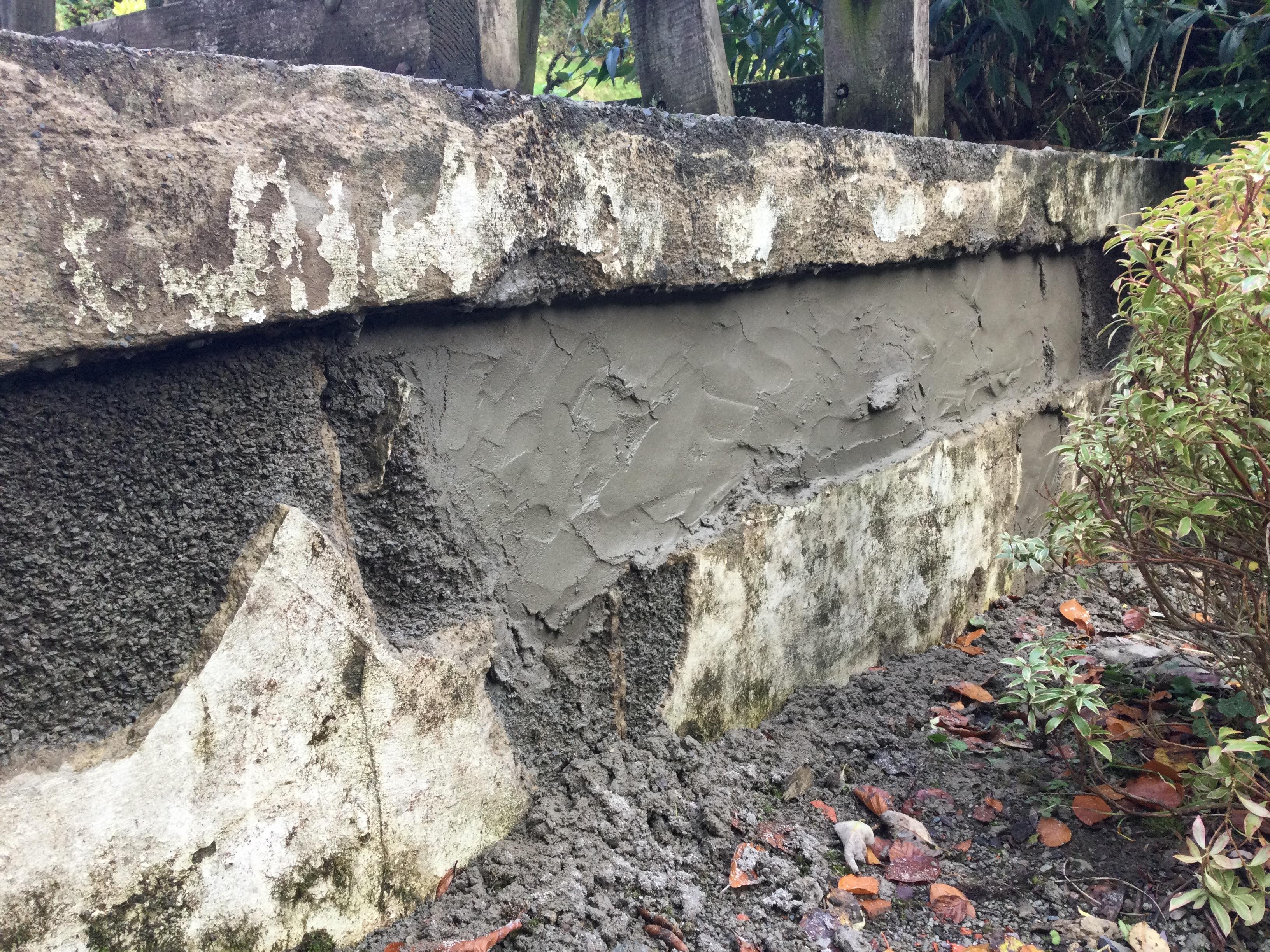

zoothorn Posted October 25, 2021 Author Posted October 25, 2021 (edited) Update on patchin' up zoot's pooper.. 3rd mortar layer just done, ready to seal my krispies with a 3:1 mix today. Then I guess its a layer of render ontop of the lot. Edited October 25, 2021 by zoothorn 1
zoothorn Posted October 25, 2021 Author Posted October 25, 2021 How long to cure for the 3:1 approx 1cm krispies seal layer ( just done ) before I can I render over the whole lot? I guess as the 3rd mortar layer is thicker it's dependent on this. A week or so? Getting more confident with mortar, a lovely material to work with! But I will cry if the word 'lime' is mentioned re. my final rendering. Thanks zoot
markc Posted October 25, 2021 Posted October 25, 2021 3 minutes ago, zoothorn said: How long to cure for the 3:1 approx 1cm krispies seal layer ( just done ) before I can I render over the whole lot? I guess as the 3rd mortar layer is thicker it's dependent on this. A week or so? Getting more confident with mortar, a lovely material to work with! But I will cry if the word 'lime' is mentioned re. my final rendering. Thanks zoot Tomorrow will be ok, let the whole thing plus the render dry out slowly.
zoothorn Posted October 25, 2021 Author Posted October 25, 2021 9 minutes ago, markc said: Tomorrow will be ok, let the whole thing plus the render dry out slowly. As early as that? Great ok markc. So my final render mix ratio would be what-? (Im hoping to goodness lime isn't mentioned!). Terrific.. job onto last stage now.
markc Posted October 25, 2021 Posted October 25, 2021 (edited) Ideally a render will be 6:1:1 sand, cement, lime but for your job just use a 6(ish) to 1. trowel it fairly smooth then give a brush with a hand or soft sweeping brush if you want the gritty texture finish. Edited October 25, 2021 by markc
jfb Posted October 25, 2021 Posted October 25, 2021 If you are rendering over ideally get some scratch marks into the render you have done to give the final coat a key. Might have gone off too much by now though!
zoothorn Posted October 26, 2021 Author Posted October 26, 2021 19 hours ago, jfb said: If you are rendering over ideally get some scratch marks into the render you have done to give the final coat a key. Might have gone off too much by now though! Hi jfb. Understood: Im lucky here it takes a day longer for anything to dry, clothes or mortar.. so will scratch today/ render tmrw. Thx zh
