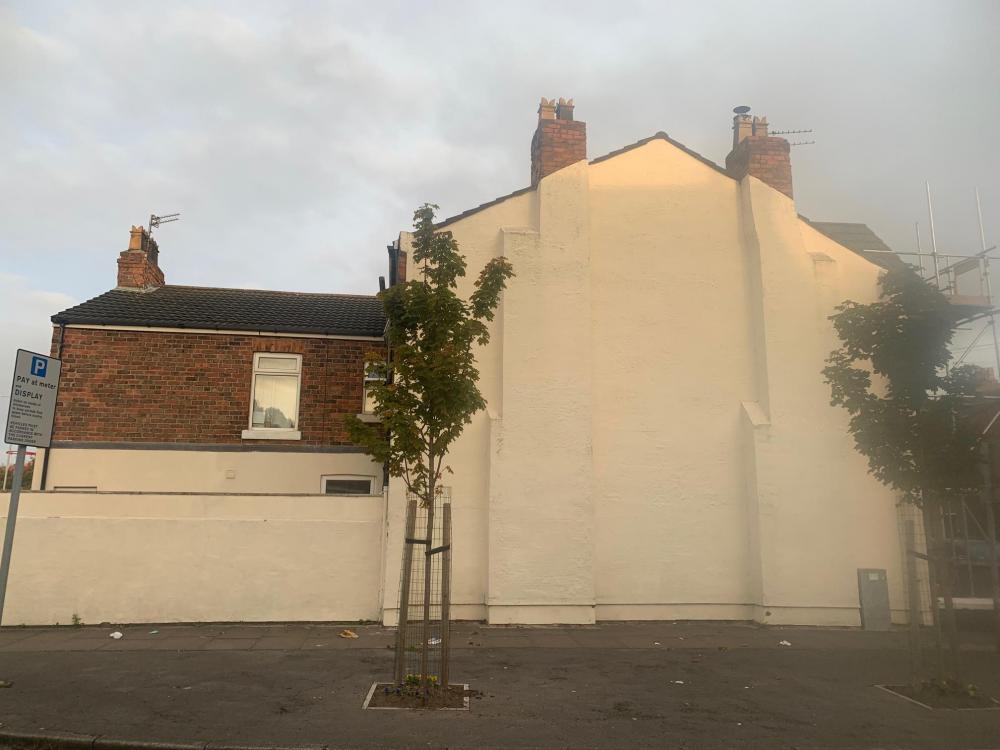

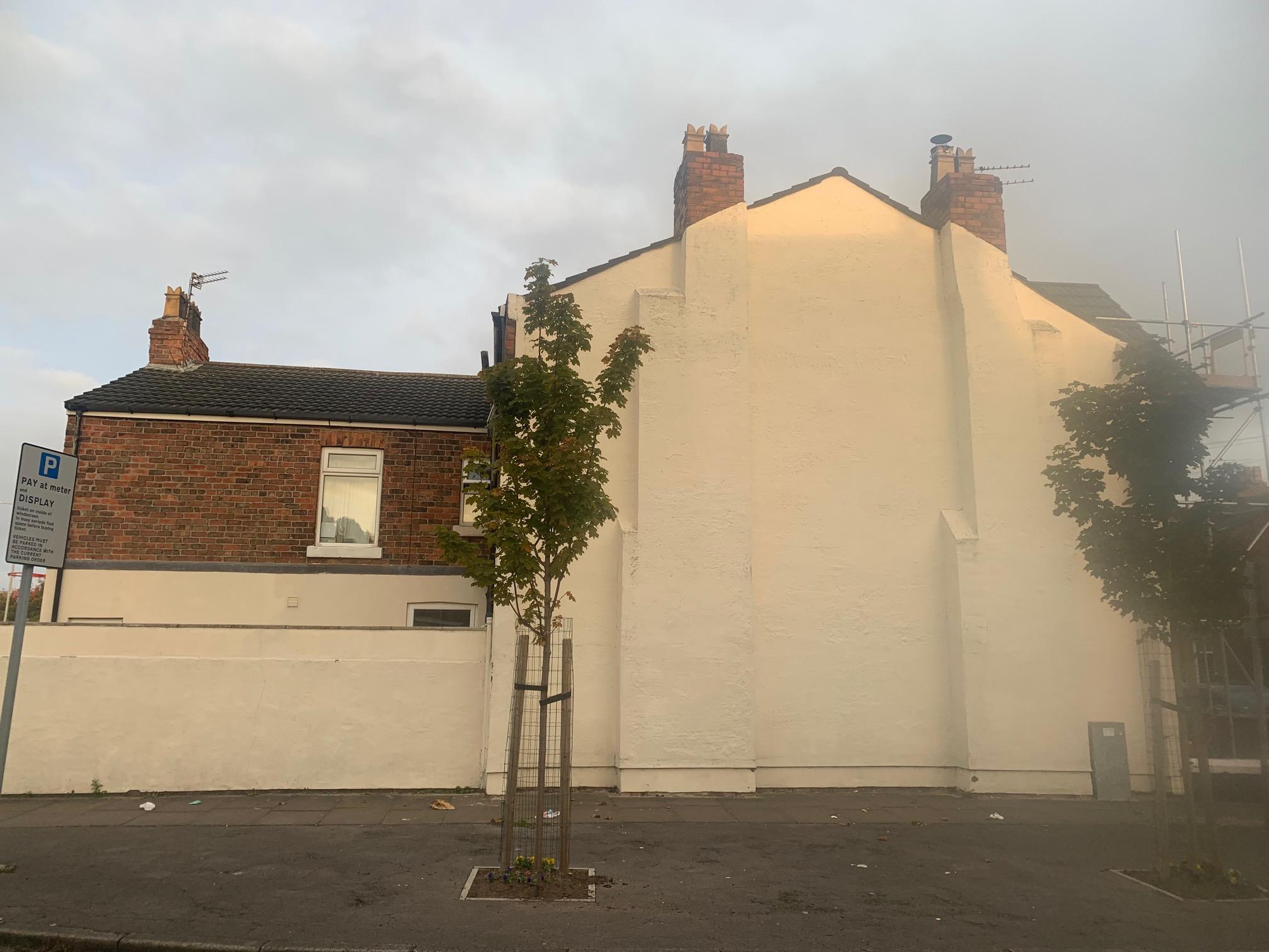

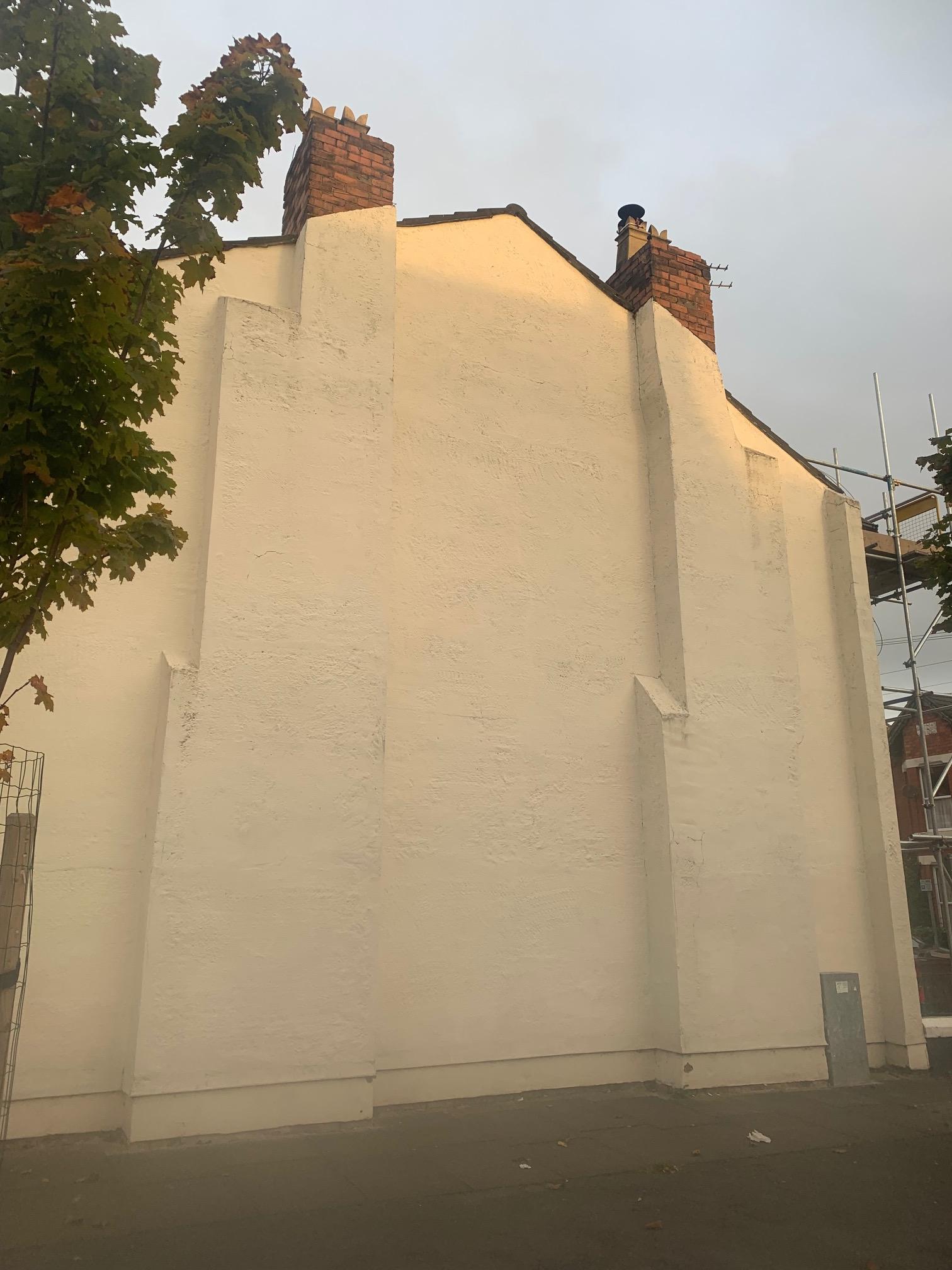

Bex Posted October 11, 2021 Posted October 11, 2021 Hi all, I am new to the group and new to building work in general. I have just purchased a 1900 victorian end terrace with a large gable end - thought to be a result of neighbouring house being bombed in WW2 My concern is related to penetrating damp on the internal walls. I have had a variety of opinions from local damp proof specialists and builders. The damp proof course is 15 years old. They are solid walls not Cavity walls and the damp appears in wet patches on the lower walls after heavy rain. I am fairly certain this is related to the exterior gable end wall, which is rendered in sand/cement render. The rendering extends too low - potentially covering air bricks, it is uneven and there are cracks and some visable damp in the render itself. The chimney stacks also need pointing/flashing/ capping. A full replacement of the external render would be a BIG job - I've had quotes around £10,000 for silicone (K rend) but the exterior wall is HUGe and the render extends along the kitchen wall too which would all need replacement if I start. Ideally I would love to go back to the original brickwork. Questions would be - does anyone have experience of doing this? I wont know what the quality of the bricks is like until the render is removed - would restoring the brickwork beneath the render be just as expensive as new render and is render always the best protector for the brickwork anyway? Thanks in advance for any suggestions

Brickie Posted October 11, 2021 Posted October 11, 2021 I’m fairly certain your property wasn’t always end of terrace-I think the rendered wall was previously the Party Wall & is 99% definitely not face (attractive) brickwork behind that render. Might still look nice,just not going to be as neat & tidy as the front as it was never intended to be seen. The erstwhile neighbours side of your chimney stack appears to be capped & unventilated-this might not be the cause of your problems but is undesirable & requires attention. 1

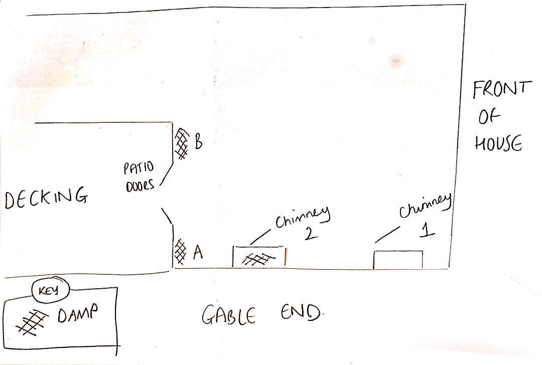

Bex Posted October 12, 2021 Author Posted October 12, 2021 On 11/10/2021 at 13:17, markc said: First thing to ask yourself - is it penetrating damp or damp trying to get out? removing render can be laborious, expensive and end up with a horrible looking brick that looks like it’s be hit by a 1000 pigeon Sh1ts. sand blasting cleans it up well but then the brickwork can stilllook bad if it’s spalled and crumbling. also render that is loose and cracking allows water behind and then it’s trapped. Expand Hi - thanks for the thoughts, really appreciated Im fairly certain this is penetrating damp - marks on walls appear darker and damper after heavy rain fall I will send rough diagrams of the house and areas of damp - as advised below to explain more , Thanks

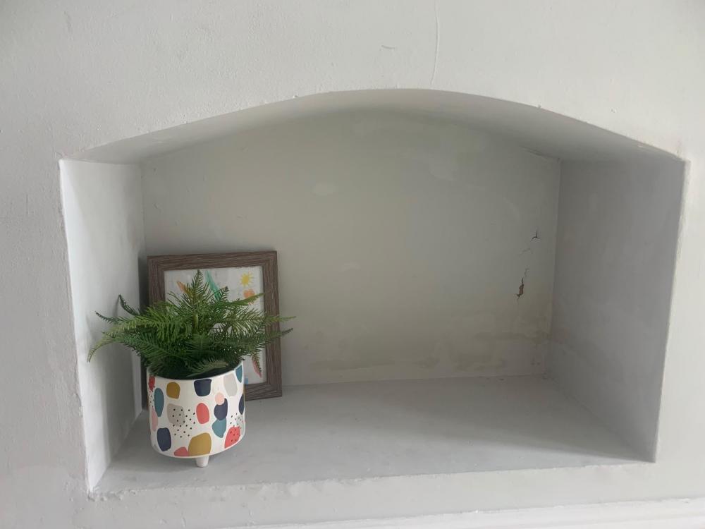

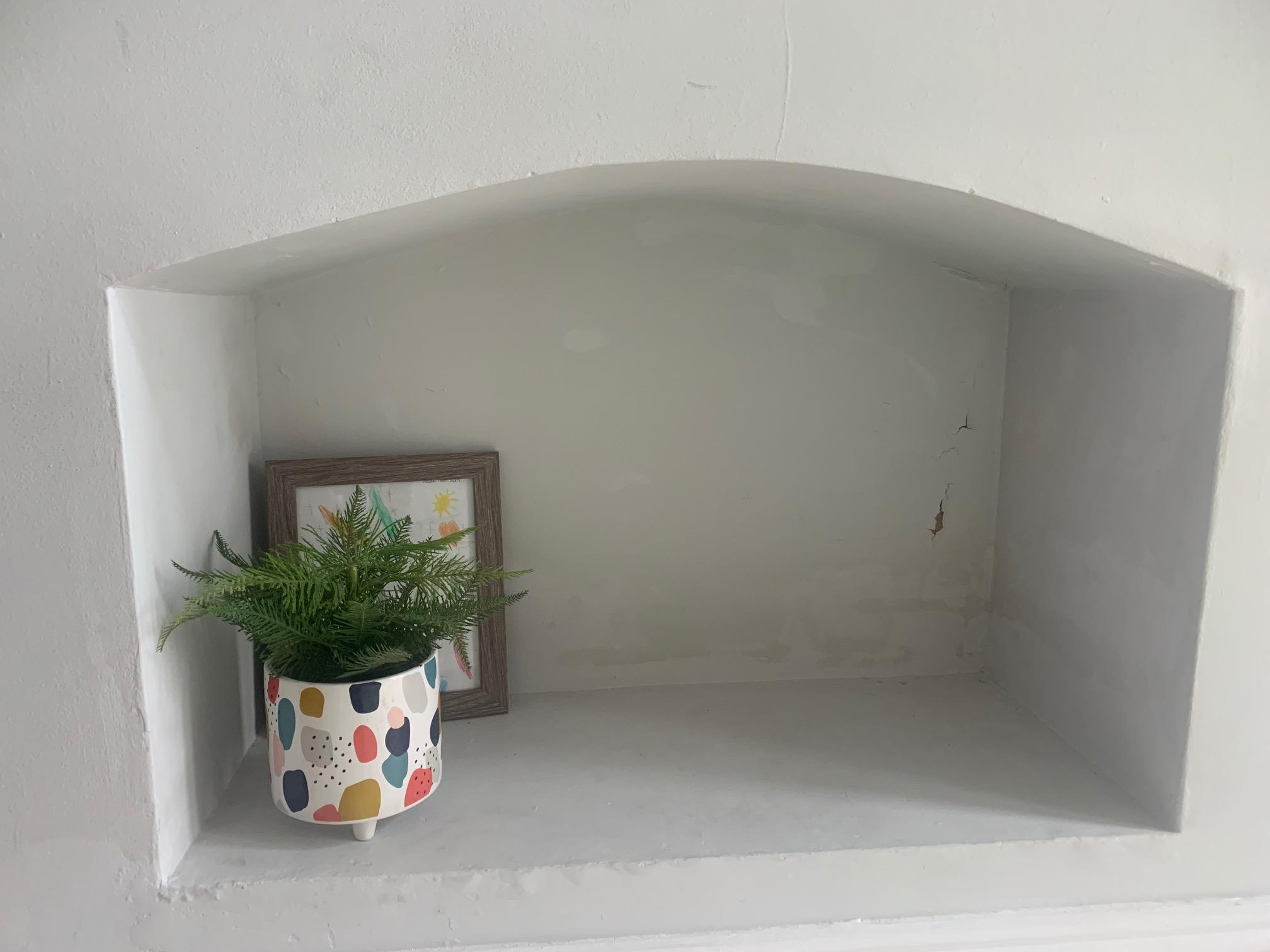

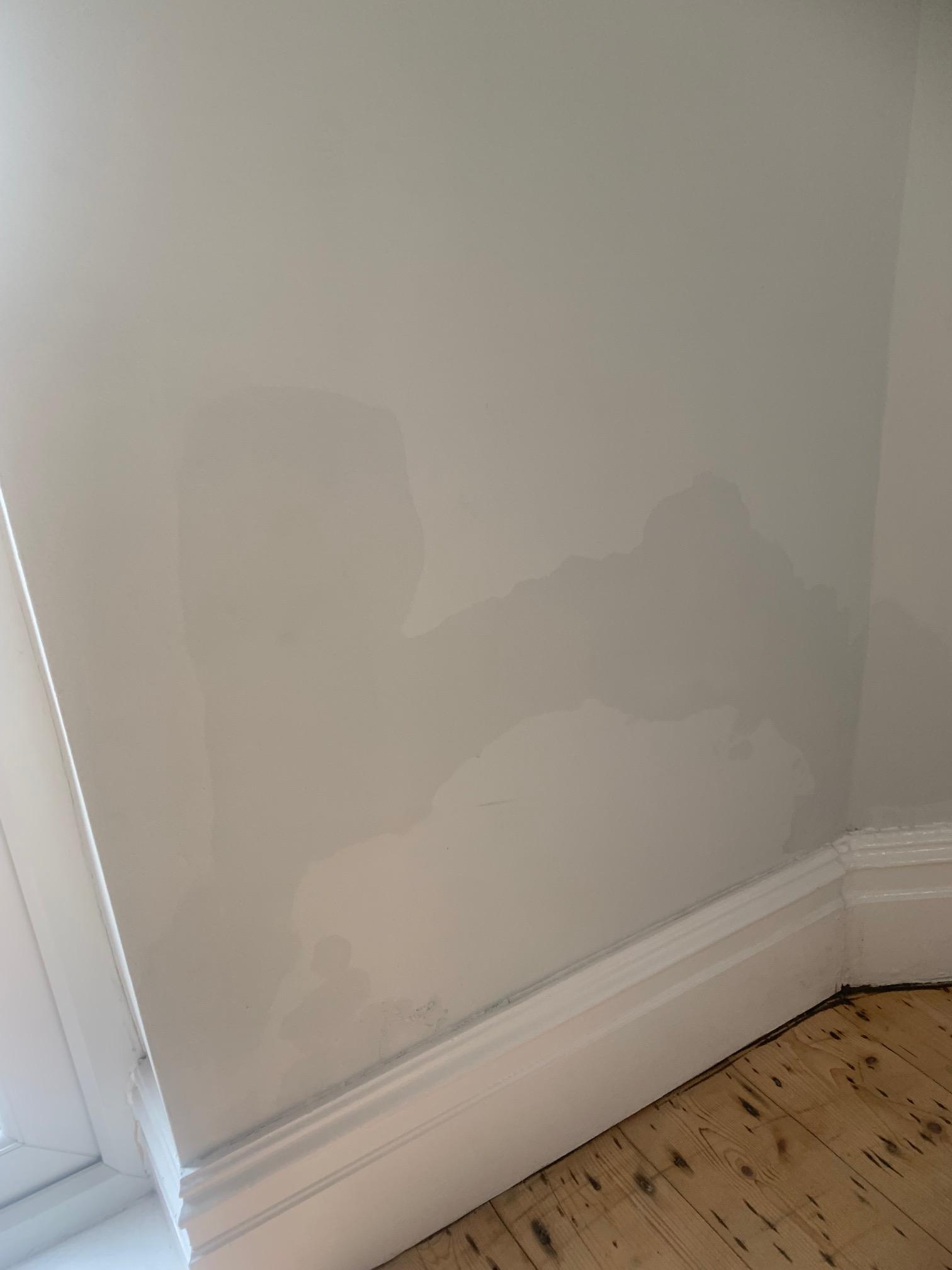

Bex Posted October 12, 2021 Author Posted October 12, 2021 On 11/10/2021 at 17:36, Brickie said: Are the internal chimney breasts removed? If still present,are they (or have they in recent times been) still in use? Expand Hi - thanks for questions Both breasts still in place (eek now I realise there are so many cheeky innuendos in DIY) one chimney recently flued and in use (front) with no real damp internally the back room chimney breast is not in use and fully blocked at internal exit. Damp also present internally here (see photo)

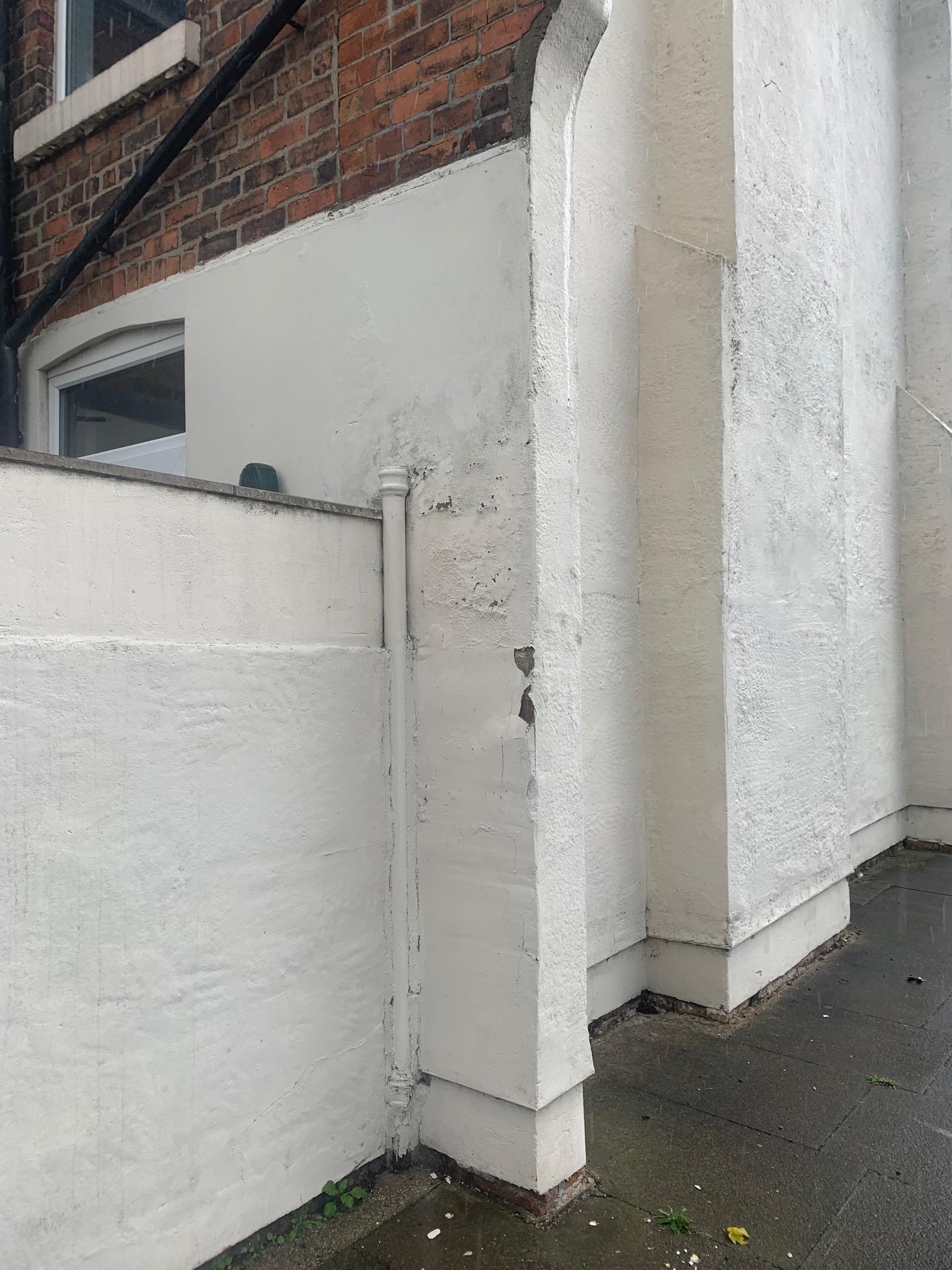

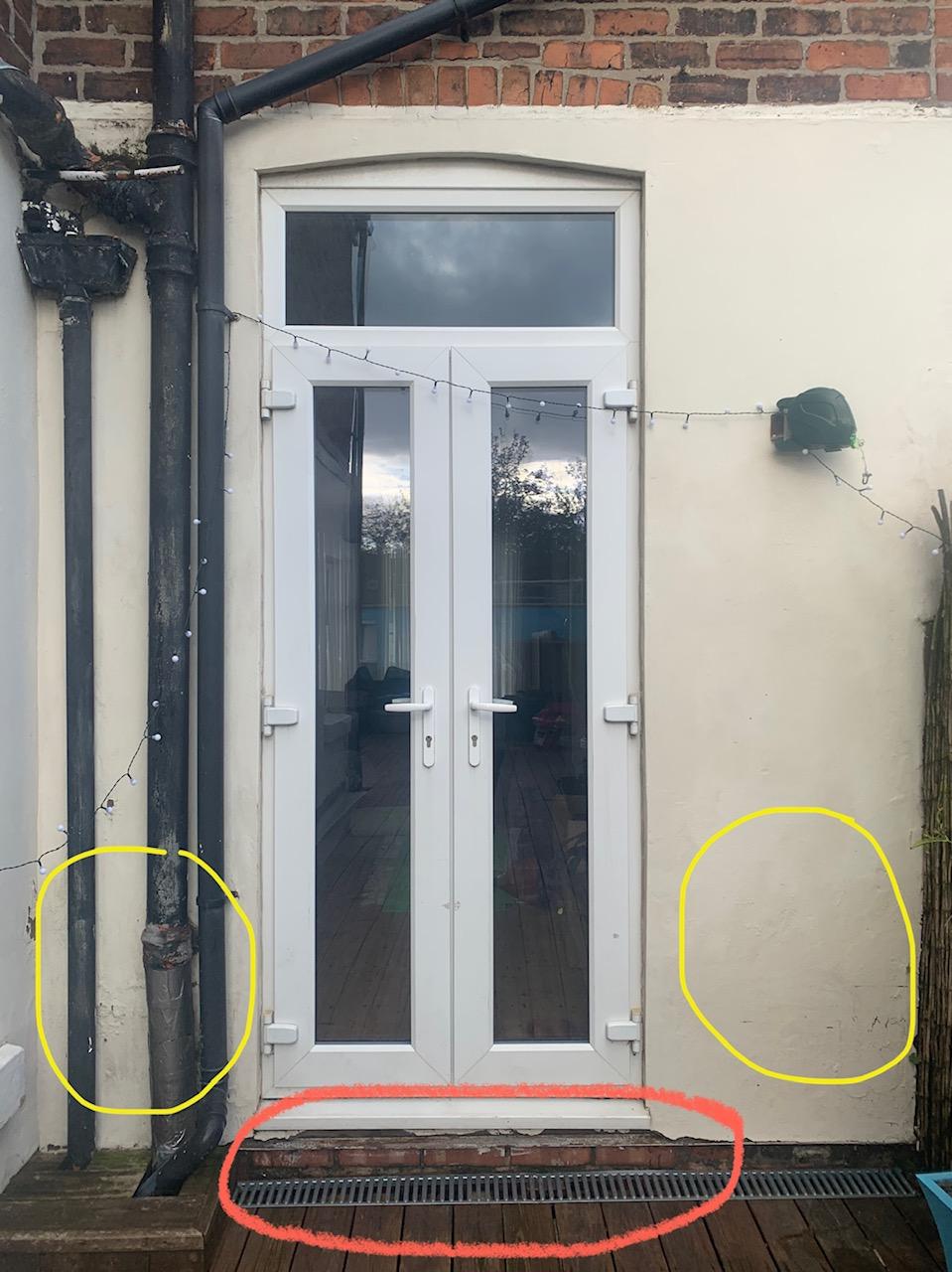

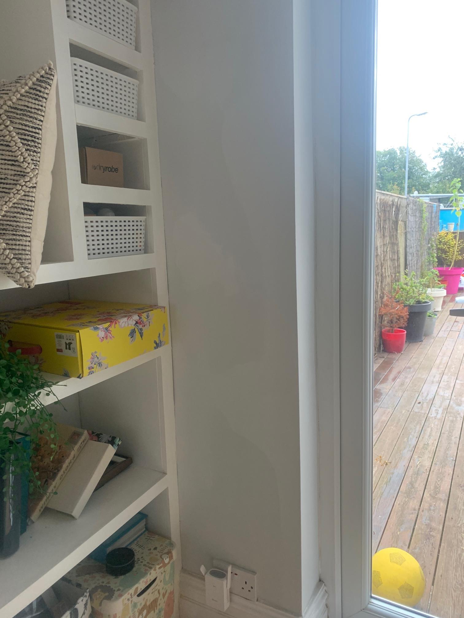

Bex Posted November 2, 2021 Author Posted November 2, 2021 On 16/10/2021 at 14:53, Brickie said: Do you have a photo of the back door from outside? Expand Yes, the yellow circles are the walls were internally there is damp. The red area is where the decking abutted the house but in the last few weeks we have added the ventilation of the silver drain so that the decking doesnt go all the way to the wall. Too early to tell if this has made a difference I think. Hope you can see the imager ok - let me know any thoughts you have.
markc Posted November 2, 2021 Posted November 2, 2021 Left side is more than likely the down pipes. Right side looks like it could be a fence fixed to the wall, if someone has gone a bit OTT with a drill the fixings could be pulling water into the wall. Under the door I would say the fill is the problem, not shedding water and drawing it back under.
Bex Posted November 2, 2021 Author Posted November 2, 2021 On 02/11/2021 at 14:26, markc said: Left side is more than likely the down pipes. Right side looks like it could be a fence fixed to the wall, if someone has gone a bit OTT with a drill the fixings could be pulling water into the wall. Under the door I would say the fill is the problem, not shedding water and drawing it back under. Expand Hi Mark - what would you suggest with the wall on the left side, how do we get round this problem of it drawing water in? Also can you further explain what you mean by under the door 'the fill is the problem' and suggest how I would solve this? Thanks

markc Posted November 2, 2021 Posted November 2, 2021 (edited) On 02/11/2021 at 14:28, Bex said: Hi Mark - what would you suggest with the wall on the left side, how do we get round this problem of it drawing water in? Also can you further explain what you mean by under the door 'the fill is the problem' and suggest how I would solve this? Thanks Expand Hi, I would definitely sort out the down pipes, get rid of the vegetation, seal any gaps etc. Where water looks to be coming out ... easier to see when raining. If the other side is a fence post I would take it off, seal any holes and re fix with spacers to allow air to circulate. Under door looks to be a bit raggy, but could be me looking on a small screen. Possibly scrape out any loose material and re point with mortar or sealant. Also clean underside of cill, there should be a groove to force water to drop off and not track back towards wall underneath the cill. Edited November 2, 2021 by markc 1
