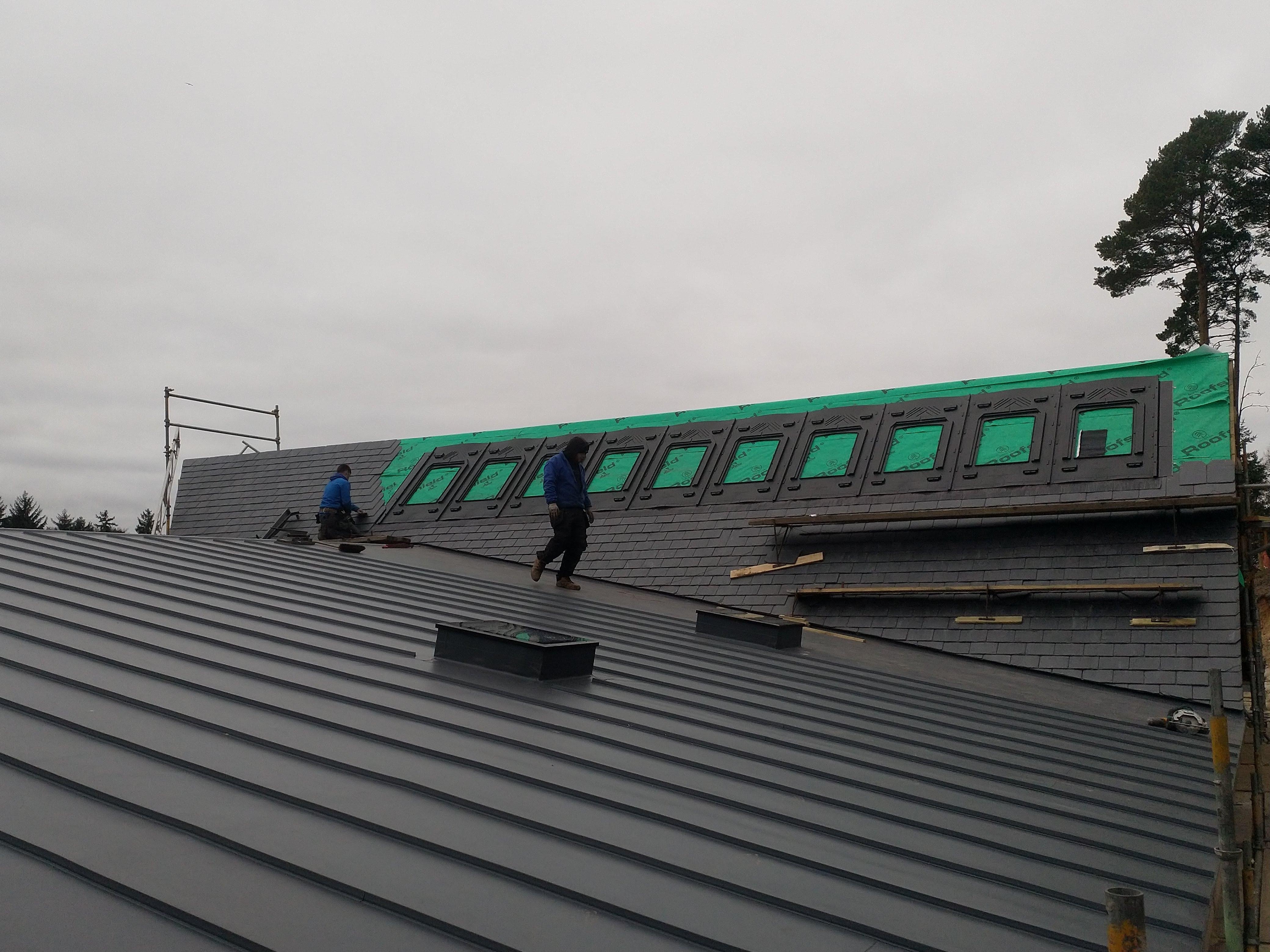

Barryscotland Posted October 7, 2021 Share Posted October 7, 2021 Our roof is slate straight onto sarking, do I need to put down a frame for the GSE frames to sit on to allow the linking of the panels and ventilation to the panels or can I mount straight to the sarking and drill into the Coombe of the roof for cabling?. Anybody done a guide to the installation to keep us right? Its an 8 panel system, 2 rows of 4 Link to comment Share on other sites More sharing options...
Conor Posted October 7, 2021 Share Posted October 7, 2021 (edited) Ideally, you'd have no sarking where the trays are going and instead use 100mm battens as per the guide. You really need the back of the trays to be ventilated. But I can't see why you couldn't directly fit the trays to the sarking boards. It would make fitting them a lot easier!! You cant raise the area up as the trays need to sit at the same height as your slates. Do you have optimisers or micro inverters? In which care you'll definitely need the ventilation gap. Edited October 7, 2021 by Conor 1 Link to comment Share on other sites More sharing options...
Barryscotland Posted October 7, 2021 Author Share Posted October 7, 2021 I'd thought if I made a frame from 25mm tile batton it would get it up enough to run the cables and wee bit of ventiliation to the panels, Then put a bend to suit the extra height in the lateral flashing. Would be alot easier to mount it straight onto the roof tho. Link to comment Share on other sites More sharing options...
Conor Posted October 7, 2021 Share Posted October 7, 2021 Nope, won't work, you'll never get the flashing to work and it'll look wrong. Either have to strip sarking away in that area or fit directly. Link to comment Share on other sites More sharing options...
Barryscotland Posted October 7, 2021 Author Share Posted October 7, 2021 26 minutes ago, Conor said: Nope, won't work, you'll never get the flashing to work and it'll look wrong. Either have to strip sarking away in that area or fit directly. If I strip the sarking away I'l be left with nothing but trusses and a giant opening straight into my attic space. Will speak to company that suppled the kit and the roofer, see what they recommend Link to comment Share on other sites More sharing options...

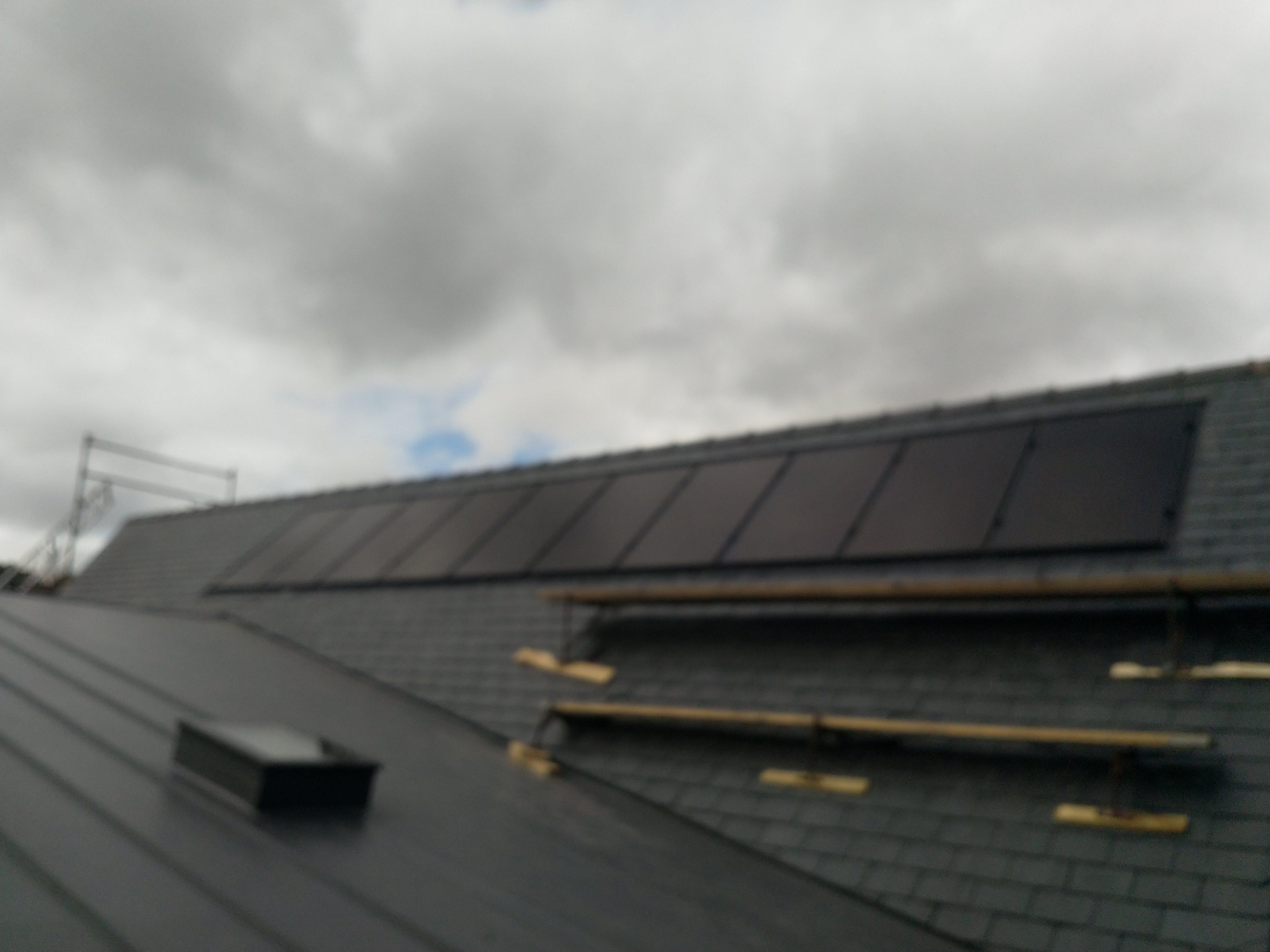

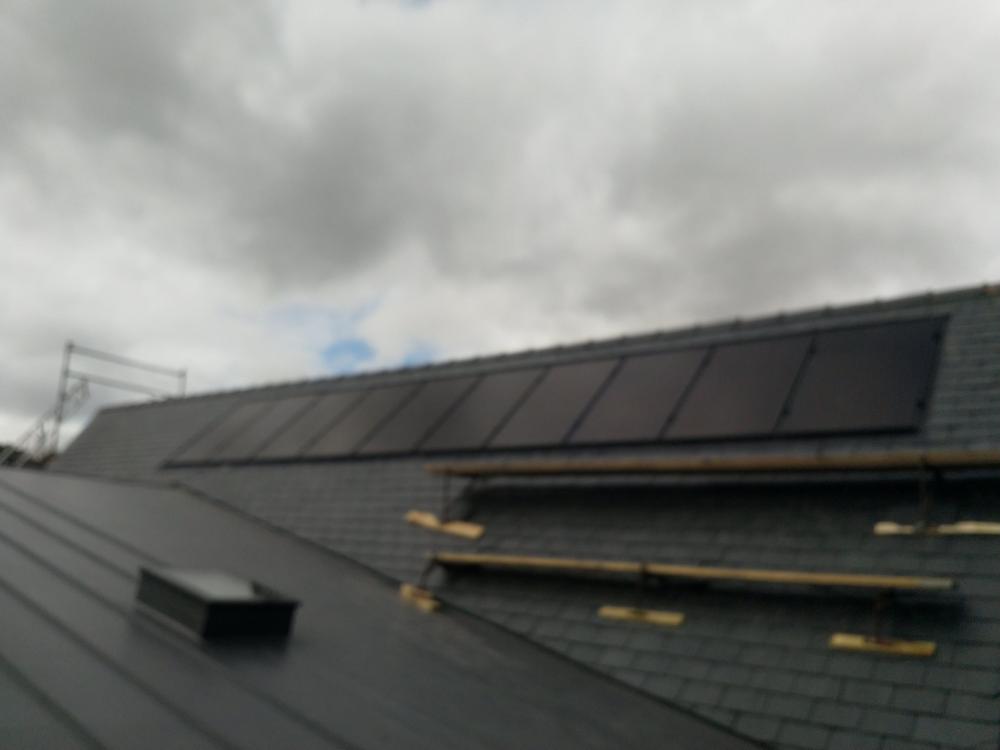

JohnMo Posted October 19, 2021 Share Posted October 19, 2021 Take it you are in Scotland, I fitted GSE trays, tried to follow the instructions and they made little of no sense when working with sarking boards. If you add additional timber on the sarking the finished roof looks rubbish as nothing aligns correctly with the slates/tiles. The additional ventilation gives you a little uplift in performance, but not much to worry about. Screw them direct to sarking boards and make life easy. I had metal flashing at top and sides, flex stuff at bottom. Link to comment Share on other sites More sharing options...
Dave Jones Posted October 20, 2021 Share Posted October 20, 2021 The GSE kits do work pretty well, they are let down a bit by the rubbish stick on flashing though. nice roof, the slate to metal transition looks very well done. Link to comment Share on other sites More sharing options...
Barryscotland Posted October 23, 2021 Author Share Posted October 23, 2021 On 19/10/2021 at 23:08, JohnMo said: Take it you are in Scotland, I fitted GSE trays, tried to follow the instructions and they made little of no sense when working with sarking boards. yes in Scotland, we ended up fitting straight onto sarking ignoring the advice of the seller but couldn’t see how it would work any other way. does anybody no if the install needs to be certified by a solar person or is it just signed of with the rest of the electrical stuff? New build in Scotland Link to comment Share on other sites More sharing options...

Dave Jones Posted October 26, 2021 Share Posted October 26, 2021 On 24/10/2021 at 11:16, Thorfun said: our solar PV company sent us photos of lead flashing details for the GSE trays. the roofer said no problem and will be using Code 4 300mm lead flashing so we're going that route. much better solution and nicely done as well. Link to comment Share on other sites More sharing options...
Dave Jones Posted October 26, 2021 Share Posted October 26, 2021 On 19/10/2021 at 23:08, JohnMo said: Take it you are in Scotland, I fitted GSE trays, tried to follow the instructions and they made little of no sense when working with sarking boards. If you add additional timber on the sarking the finished roof looks rubbish as nothing aligns correctly with the slates/tiles. The additional ventilation gives you a little uplift in performance, but not much to worry about. Screw them direct to sarking boards and make life easy. I had metal flashing at top and sides, flex stuff at bottom. interesting scaffold bench supports on the roof, what are they called ? Link to comment Share on other sites More sharing options...

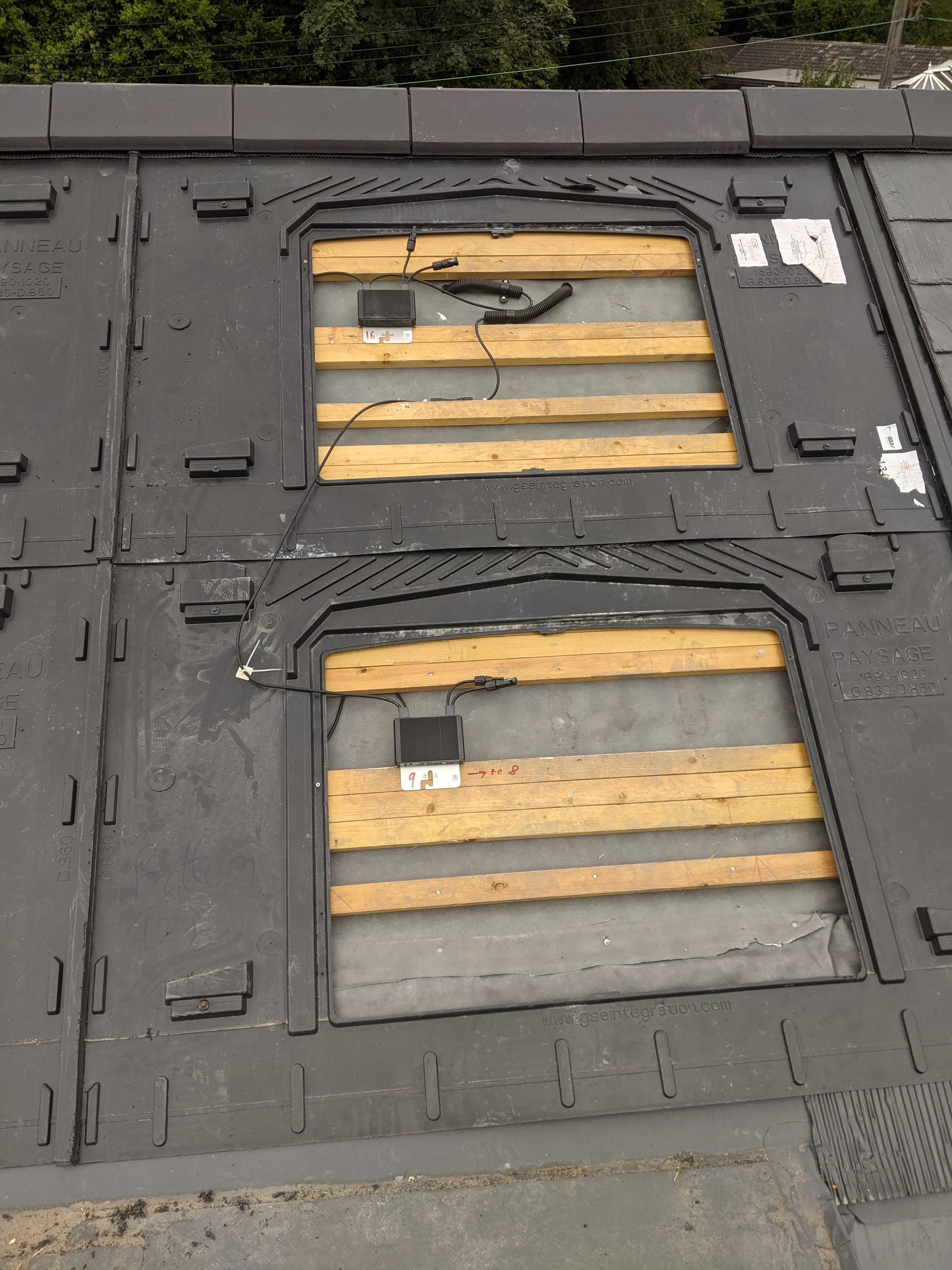

Jenki Posted July 11, 2023 Share Posted July 11, 2023 Resurrecting an old thread as it seems a good fit. I'm looking at ordering my trays now, its going to be 2 rows 5 columns of panels (10). and trying to work out the flashing required. 1: The instructions suggest top flashing is not usually required as the tiles overlap the gse tray. 2: Bottom flashing, I have the option of having the bottom of the panels at the gutter edge. if I were to do this the gse tray would overlap the felt support tray, so would flashing be needed here? any thoughts on this? Link to comment Share on other sites More sharing options...
