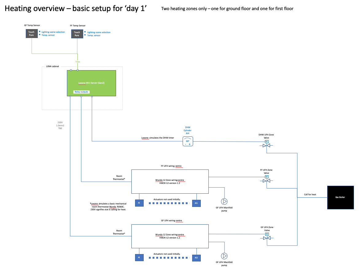

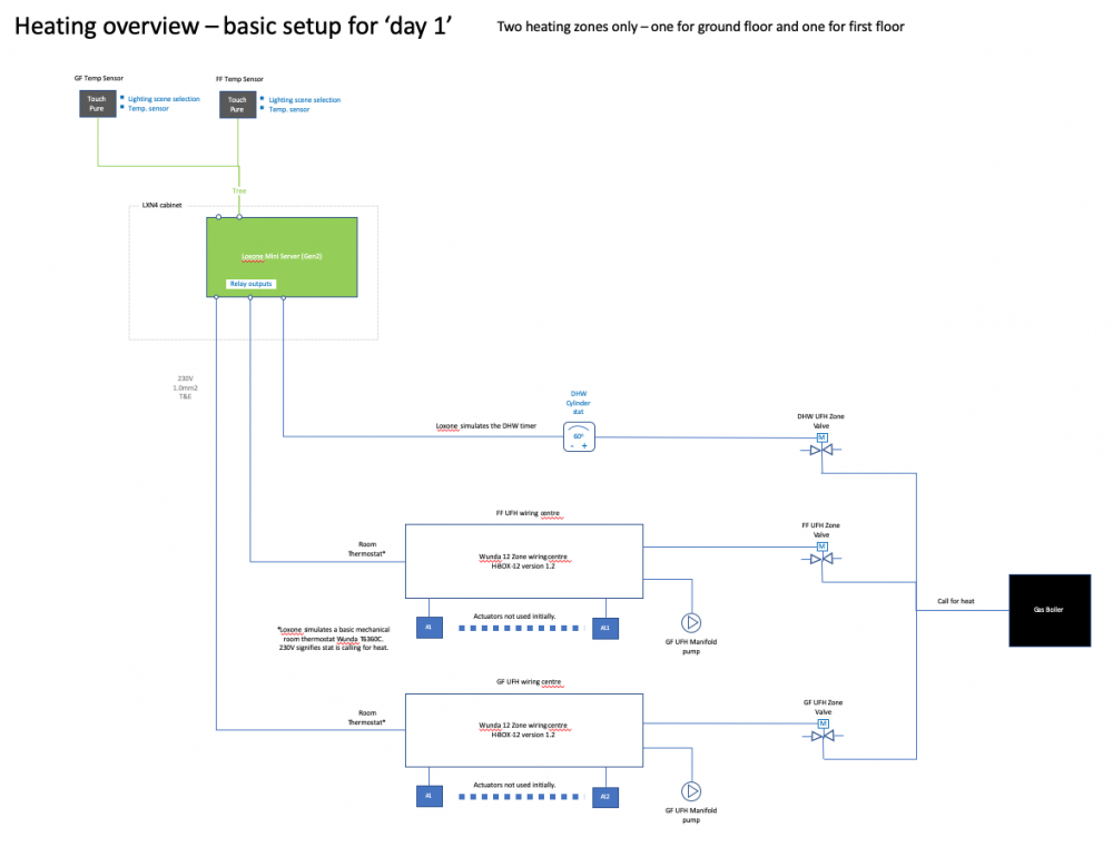

Hilldes Posted November 30, 2021 Author Share Posted November 30, 2021 Here is what we have wired for 'day 1'. We have actually wired one Salus auto balancing actuator per manifold as spark though it might affect the Wunda wiring centre without any. All decorators caps are left open on the other UFH circuits. The wiring is complete but waiting for gas to the boiler before we test. Link to comment Share on other sites More sharing options...
BartW Posted February 12, 2023 Share Posted February 12, 2023 Hi @Hilldes , This is very useful diagram, but I am struggling to understand where (and how) the auto balancing actuator is sitting / how it is installed. Surely they are made to be installed by way of screwing on top of a manifold port right? But if all your ports are open (actuators off), then where does it sit? Also, did you need the zone valve per floor? I read it was not necessary? Many thanks! Bart Link to comment Share on other sites More sharing options...

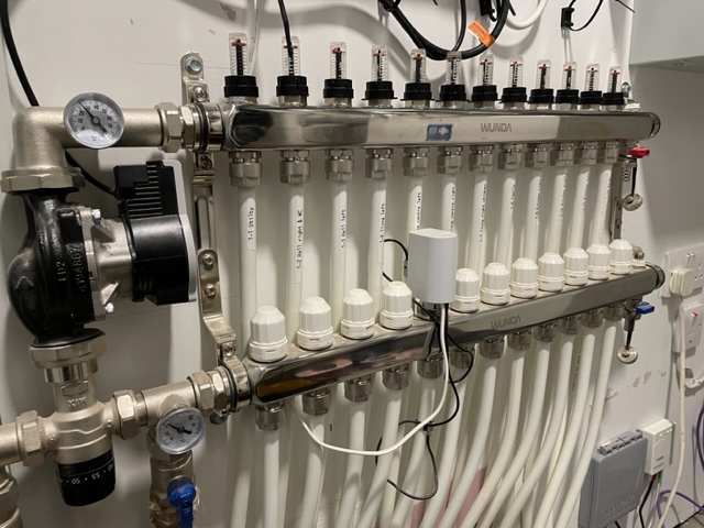

Hilldes Posted February 12, 2023 Author Share Posted February 12, 2023 1 hour ago, BartW said: Hi @Hilldes , This is very useful diagram, but I am struggling to understand where (and how) the auto balancing actuator is sitting / how it is installed. Surely they are made to be installed by way of screwing on top of a manifold port right? But if all your ports are open (actuators off), then where does it sit? Also, did you need the zone valve per floor? I read it was not necessary? Many thanks! Bart The Salus Auto Balancing Actuator sits on the return manifold on one of the longer loops - as shown in pic below - 5th loop from the left. It is only required because the WUNDA wiring centre I selected requires at least one actuator in order to enable the pump and boiler call for heat. With a different wiring centre the actuator could be omitted I believe. Yes, one zone per floor - the GF manifold shown. Link to comment Share on other sites More sharing options...

BartW Posted February 12, 2023 Share Posted February 12, 2023 1 hour ago, Hilldes said: The Salus Auto Balancing Actuator sits on the return manifold on one of the longer loops - as shown in pic below - 5th loop from the left. It is only required because the WUNDA wiring centre I selected requires at least one actuator in order to enable the pump and boiler call for heat. With a different wiring centre the actuator could be omitted I believe. Yes, one zone per floor - the GF manifold shown. Ok, thanks for explaining. Did you absolutely need zone valves? I would imagine particular UFH floors would not push any water through with their respective pumps “in the way”? I have also still not made my mind up as to the vaillant heat controls for heat pump vs loxone. kinda being greedy here. Wanting to use loxone pure switches and their sensors to tell UFH what to do, but then Vaillant seems to be doing this with ease as well. Totally confused… Link to comment Share on other sites More sharing options...
JohnMo Posted February 12, 2023 Share Posted February 12, 2023 3 hours ago, Hilldes said: It is only required because the WUNDA wiring centre I selected requires at least one actuator in order to enable the pump and boiler call for heat. With a different wiring centre the actuator could be omitted I believe. Or you just drive the pump from the thermostat switch. I would use the manufacturer controller every time. Set it to weather compensation, balance loop flows. No thermostat other than the valiant control. Operate as a single zone. If you have a towel rad stick an electric element in it, to make it dual fuel. Good for summer towel drying. Also gives you two zones to comply with building regs 1 Link to comment Share on other sites More sharing options...
Hilldes Posted February 12, 2023 Author Share Posted February 12, 2023 3 hours ago, BartW said: Did you absolutely need zone valves? I would imagine particular UFH floors would not push any water through with their respective pumps “in the way”? Good question, would need a zone valve at least for the DHW. For the UFH manifolds, if you switch off the pump will that block all water flow thought the manifold? I would assume not but others I'm sure will know more than me. 3 hours ago, BartW said: I have also still not made my mind up as to the vaillant heat controls for heat pump vs loxone. Mine is a gas boiler, for a heat pump using the heat pump controller may be better - as per @JohnMo... Link to comment Share on other sites More sharing options...
