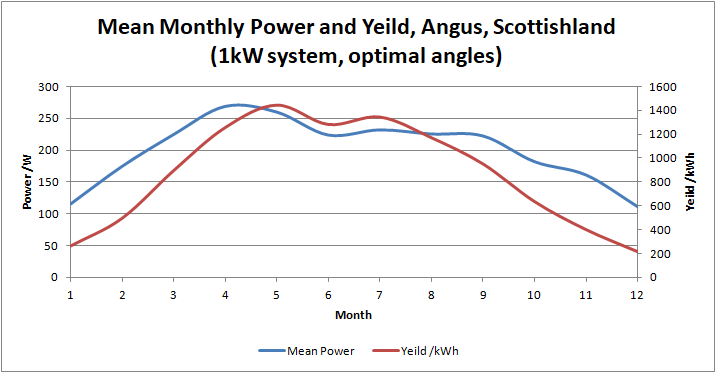

joth Posted September 27, 2021 Share Posted September 27, 2021 8 minutes ago, Mike_scotland said: yeah thats what im thinking, so basically i was just trying to work out how much energy would be made during each day/month, i know that depends on cloud cover/weather but it would be interesting to know an average, Have you put your details into PVGIS? https://re.jrc.ec.europa.eu/pvg_tools/en/#PVP Link to comment Share on other sites More sharing options...
Mike_scotland Posted September 27, 2021 Author Share Posted September 27, 2021 6 minutes ago, joth said: Have you put your details into PVGIS? https://re.jrc.ec.europa.eu/pvg_tools/en/#PVP that looks a tad too hard for me to use mate lol. have you used it ? Link to comment Share on other sites More sharing options...
SteamyTea Posted September 27, 2021 Share Posted September 27, 2021 38 minutes ago, Mike_scotland said: so basically i was just trying to work out how much energy would be made during each day/month Something like this? You can get it all from PVGIS Link to comment Share on other sites More sharing options...
A_L Posted September 27, 2021 Share Posted September 27, 2021 (edited) 32 minutes ago, Mike_scotland said: that looks a tad too hard for me to use mate lol. have you used it ? Its easy, just select your location and follow your nose! For Forfar it gives about 890kWh/yr per kWp with about 4kWh/day per kWp in summer and about 0.7kWh per day per kWp in Jan/Dec Edited September 27, 2021 by A_L typo Link to comment Share on other sites More sharing options...
