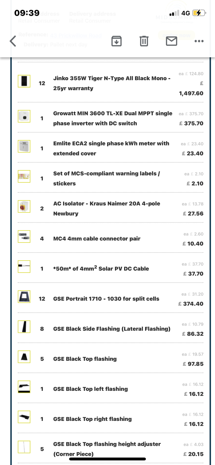

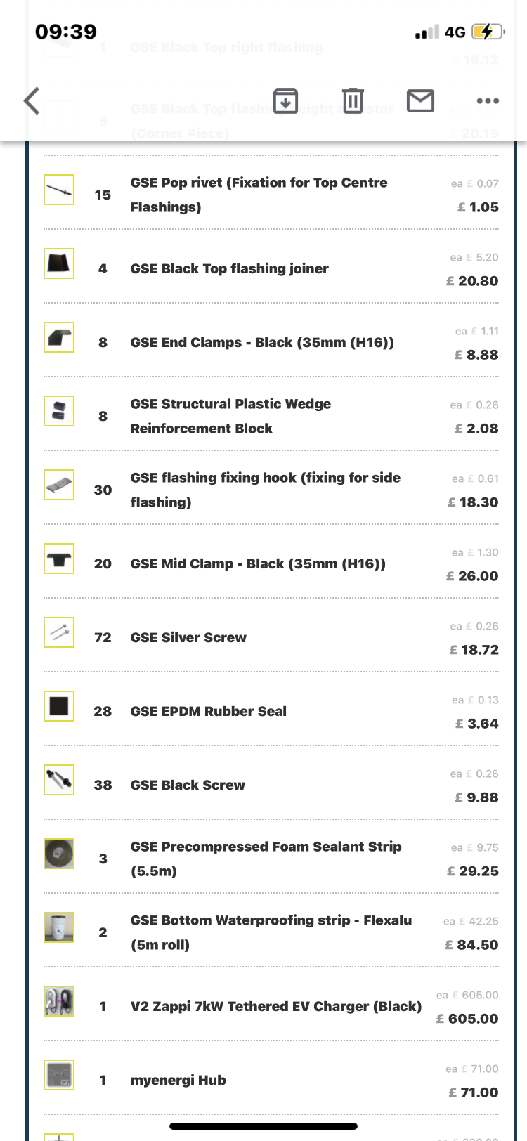

DragsterDriver Posted September 26, 2021 Author Posted September 26, 2021 On 26/09/2021 at 07:35, joth said: I assume you mean to share one inverter between both arrays? The main constraint is the distance from array to inverter. This is high voltage DC cable, needs armouring if not left fully visible. Too long a run will cause losses, especially if it's on a short "string" of panels (which means lower delivered voltage, hence line voltage drop takes a greater proportion of the output). In general Voltage drop can be minimised by using thicker core cable, but MC4 connector limits how far you can increase PV cores. Ours is about 10m, from house roof to garage. What sort of distance are you thinking? Expand Thanks! I'm hoping to have a ‘plant room’ in the garage with everything ducted from there to the house which is 7m away. So the house panels would be maybe 20m from inverter? looking at the energy situation now I’m leaning toward more panels and a storage battery
SteamyTea Posted September 26, 2021 Posted September 26, 2021 (edited) On 26/09/2021 at 07:55, DragsterDriver said: looking at the energy situation now I’m leaning toward more panels and a storage battery Expand Ideally you want batteries charged from the most productive modules i.e. south facing, optimal inclination. That will reduce the amount of modules needed and reduce the exporting of power. The East-West split PV systems 'to spread the load' can now be done from the batteries. Though batteries, on power delivery, are still limited by the inverter, and may not work too well with very small loads i.e. just lighting, assuming you only have a few watts of lighting on, not kW, like the olden days. Edited September 26, 2021 by SteamyTea 1
DragsterDriver Posted September 26, 2021 Author Posted September 26, 2021 On 26/09/2021 at 08:12, SteamyTea said: Ideally you want batteries charged from the most productive modules i.e. south facing, optimal inclination. That will reduce the amount of modules needed and reduce the exporting or power. The East-West split PV systems 'to spread the load' can now be done from the batteries. Though batteries, on power delivery, are still limited by the inverter, and may not work too well with very small loads i.e. just lighting, assuming you only have a few watts of lighting on, not kW, like the olden days. Expand I think what I need is somebody to design a system. I’m not bothered about MCS so we can fit the panels and electrician wire stuff- but it needs to all work together properly roof is south facing. this is what’s been suggested:

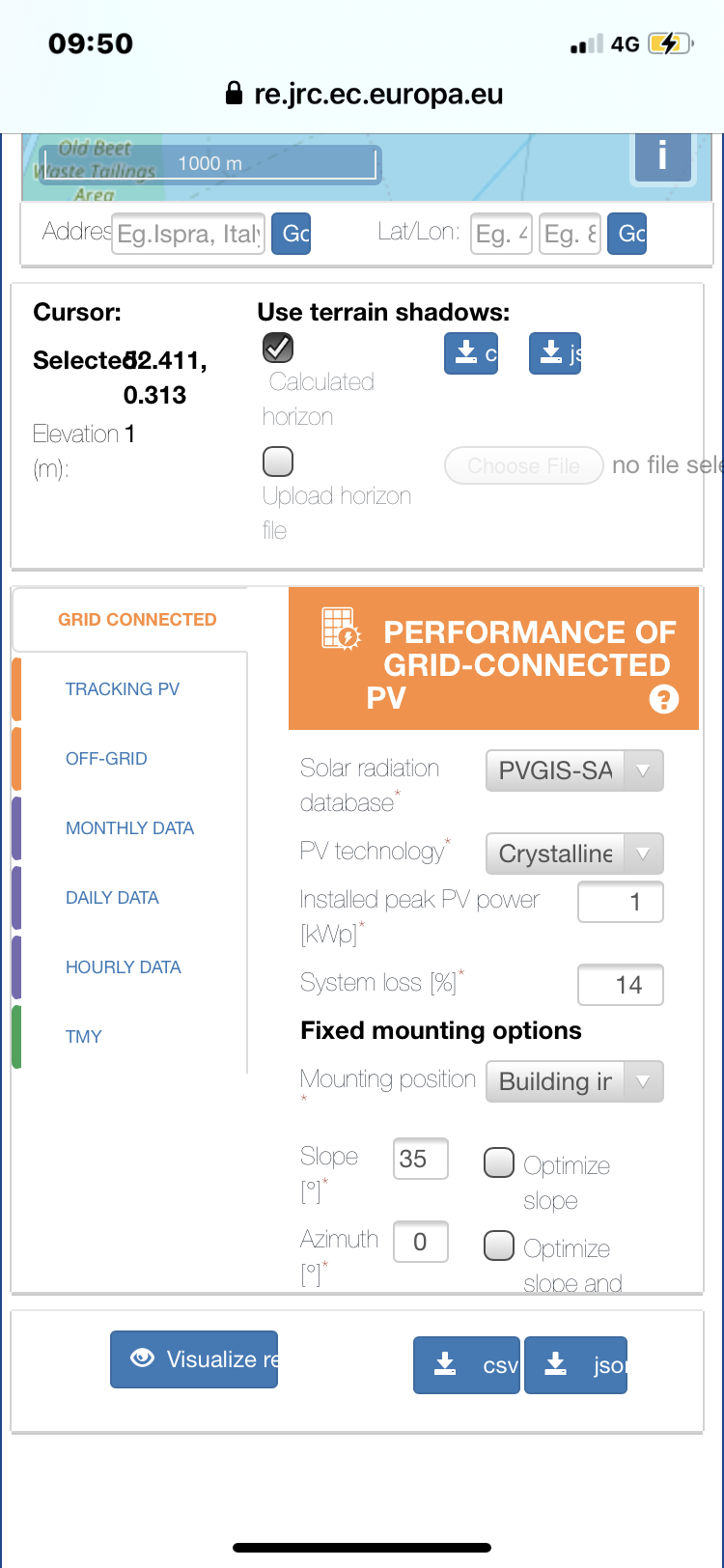

SteamyTea Posted September 26, 2021 Posted September 26, 2021 On 26/09/2021 at 08:41, DragsterDriver said: this is what’s been suggested: Expand Have you run it thought PVGIS
DragsterDriver Posted September 26, 2021 Author Posted September 26, 2021 On 26/09/2021 at 08:44, SteamyTea said: Have you run it thought PVGIS Expand Nope- never heard of it before!
SteamyTea Posted September 26, 2021 Posted September 26, 2021 On 26/09/2021 at 08:48, DragsterDriver said: Nope- never heard of it before! Expand It is the sanity checker for PV. East Anglia is pretty good for production. 1
