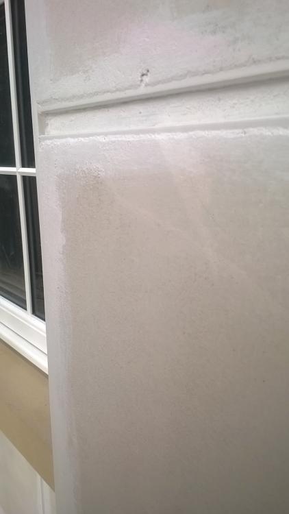

I thought i'd resurrect this rather than making my own thread...
I bought a Wagner PP90 and I mist coated 1 room from bare plaster. I used the included 517 HEA tip and set the pressure the middle of the HEA 'zone' on the gauge. I used Dulux matt retail paint and thinned by around 20%. Having never used an airless sprayer before, I was expecting an extremely smooth surface. What I in fact got was something that had orange peel and a surface that felt like sandpaper. A few air bubbles in places, but that's likely due to it going on heavy. Wagner told me that the sprayer is fine and the problem is likely the walls or the paint.
Is anyone able to shed any light on if this is normal and if it can be improved?
