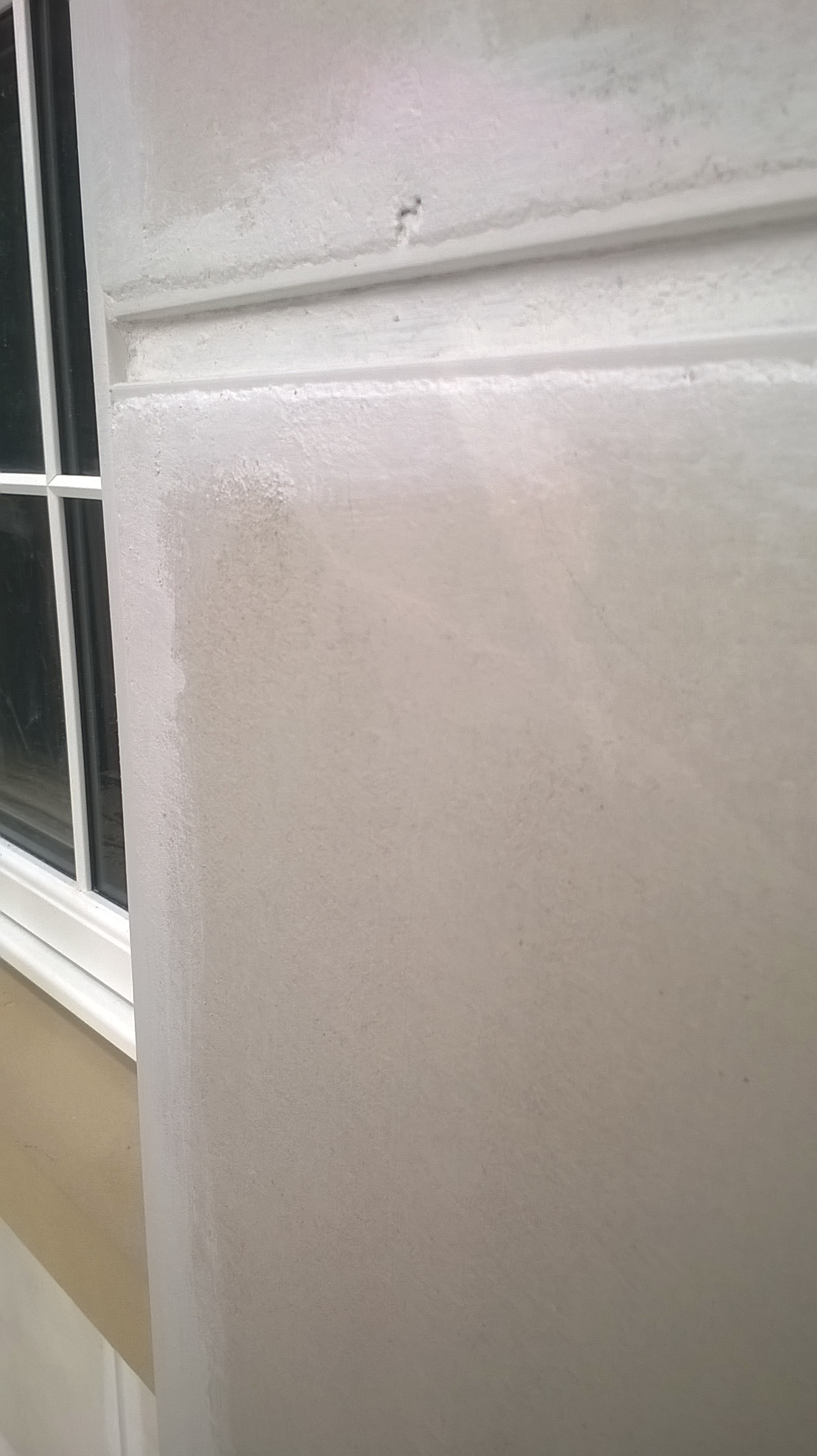

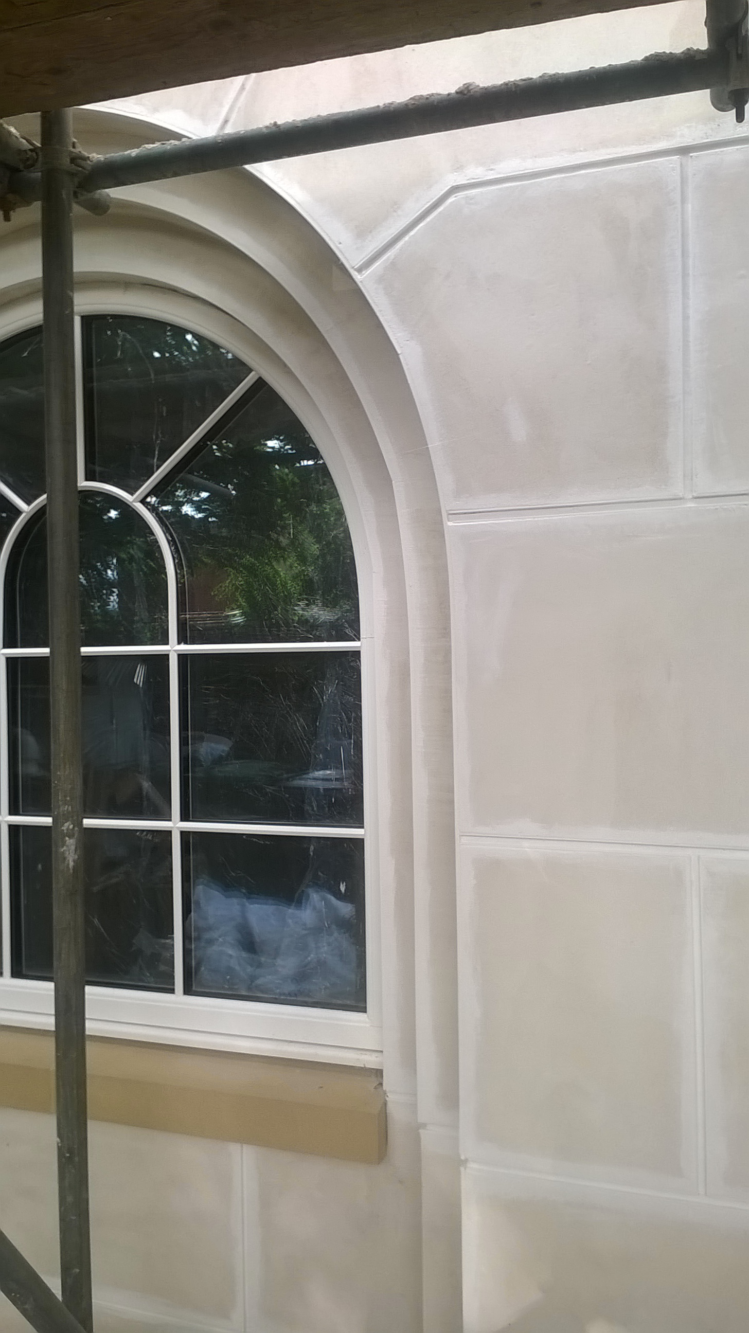

bassanclan Posted September 18, 2017 Share Posted September 18, 2017 I'm wanting to paint 330sqm of external render with an airless spray paint machine, but the render has 6-8mm deep, 12mm wide ashlar grooves in. (Regency spa town style) Will an airless sprayer do the job on its own? Or would I be better painting the ashlar grooves with a brush? As you can see I have already painted the grooves with a primer as they are formed from upvc beads. Link to comment Share on other sites More sharing options...
Nickfromwales Posted September 18, 2017 Share Posted September 18, 2017 Go over all the grooves with at least one full coat, staying away from the adjacent faces of the render 'blocks'. Once you've been right around all of these aka cutting in is done, go around the perimeter and do the same. See how well the beads have covered and coat them again, only if absolutely necessary. Do all the fiddly detail work before reloading the machine for the general spray work as when your moving at a pace you really don't want to be arsing around with nooks and crannies . Link to comment Share on other sites More sharing options...
Jeremy Harris Posted September 18, 2017 Author Share Posted September 18, 2017 If you use a small spray tip, then lower the pump pressure a bit, you will easily be able to spray those grooves OK. My kit came with a 415 tip and a 315 tip, and I would suggest getting a 215 tip for the grooves (they are only about a fiver each). The first digit is half the width of the spray fan, in inches (so a 415 = 8" pattern, a 215 = 4" pattern, etc) and the second number is the size of the orifice, in thousands of an inch. I found that a 15 thou orifice seemed fine for pretty much everything. Follow @Nickfromwales advice to do all the grooves first, with a 215 or perhaps 315 tip, then change to a wider tip for the main coat. I doubt you'll want anything wider than a 415, I found that this was pretty quick, with a wide enough spray pattern to cover a wide area pretty quickly. In my case the speed of painting was set by how fast I could move around more than the capability of the spray gun; there is a knack to walking along keeping the gun at a constant distance to the wall and perpendicular to it. 1 Link to comment Share on other sites More sharing options...
