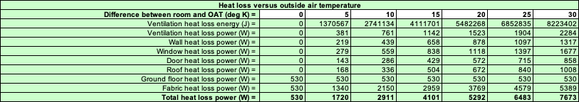

shuff27 Posted September 17, 2021 Posted September 17, 2021 So I've plugged all my data into the @Jeremy Harris spreadsheet with this result. Annual heat requirement comes out as 10852 kwh for average OAT & 13830 kwh for min OAT. How do I use this data to correctly size my ASHP to heat wet UFH on the GF (110 sq.m. single zone) & DHW? Upstairs I'm planning to do without heating in the bedrooms & have elec mat UFH & elec towel rails in the 2 bathrooms. Plus whole house MVHR of course! For DHW the occupancy will only be 2 persons for 95% of the time. Thanks for any guidance. Heat loss versus outside air temperature Difference between room and OAT (deg K) = 0 5 10 15 20 25 30 Ventilation heat loss energy (J) = 0 199015 398030 597044 796059 995074 1194089 Ventilation heat loss power (W) = 0 55 111 166 221 276 332 Wall heat loss power (W) = 0 212 425 637 849 1061 1274 Window heat loss power (W) = 0 85 169 254 338 423 508 Door heat loss power (W) = 0 19 38 58 77 96 115 Roof heat loss power (W) = 0 75 150 225 300 375 450 Ground floor heat loss power (W) = 378 378 378 378 378 378 378 Fabric heat loss power (W) = 378 769 1160 1551 1942 2333 2724 Total heat loss power (W) = 378 824 1271 1717 2163 2610 3056
Conor Posted September 17, 2021 Posted September 17, 2021 You look at the total worst case heat loss - 3056w = 3kW. So it's saying on the coldest day you'll need continuous 3kW of heating to cancel out they heatloss and keep the house at that temperature. That means you want a 5kW heat pump.
shuff27 Posted September 17, 2021 Author Posted September 17, 2021 6 minutes ago, Conor said: You look at the total worst case heat loss - 3056w = 3kW. So it's saying on the coldest day you'll need continuous 3kW of heating to cancel out they heatloss and keep the house at that temperature. That means you want a 5kW heat pump. Thanks. Would 5kW also provide enough DHW? I'm guessing a tank capacity of min 200L, max 300L would do us. Is there any benefit of oversizing the heat pump? The price difference between a 5kW & 7kW Vaillant Arotherm Plus, for example, is only around £350.

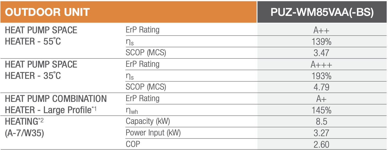

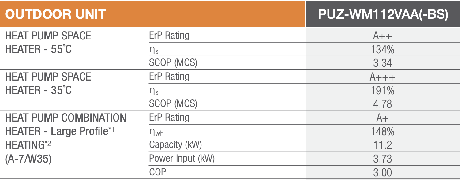

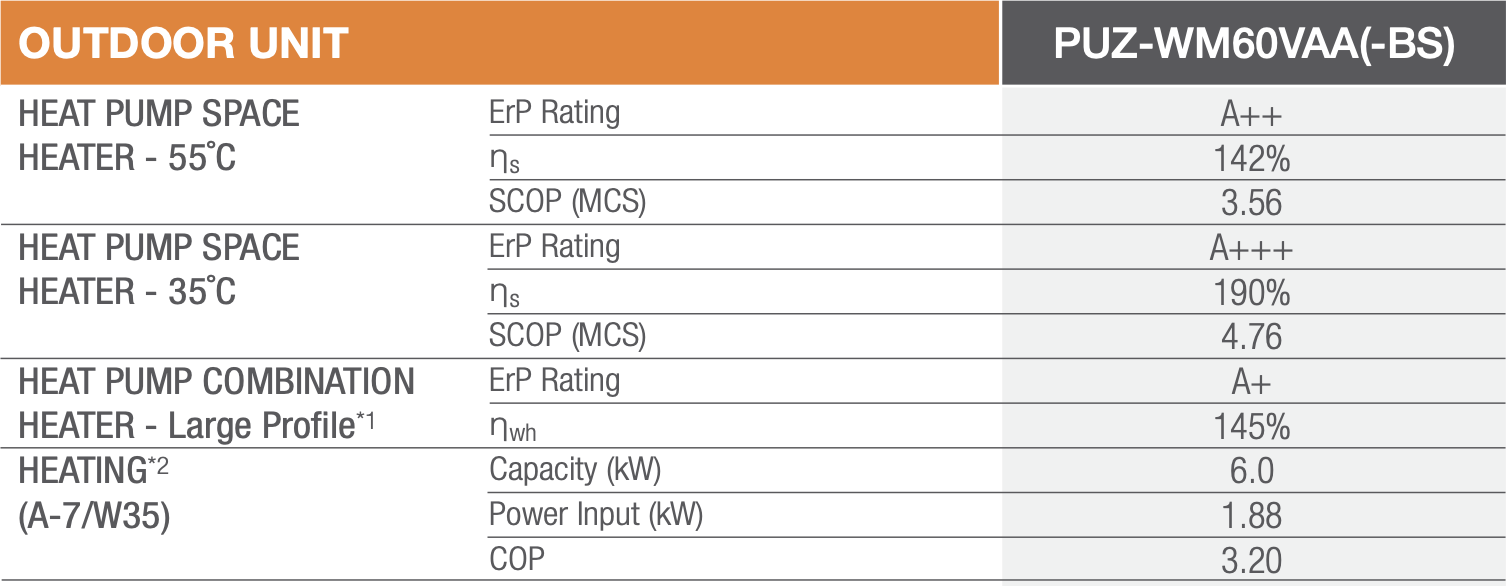

Thorfun Posted September 28, 2021 Posted September 28, 2021 this is an interesting thread for me as we're finalising our ASHP size and have a few options! I'll start with a bit of background. we have a basement, ground and 3 bedrooms on the first floor. at the moment the plan is to only heat the ground floor using wet UFH. the FF will have electric UFH and towel radiators in the en-suites and we have decided to use split/ducted AC units for cooling on the FF so can use that for supplementary heating if required. our M&E guys have worked out that we should have a 11kW ASHP but that is based on all 3 floors having heating requirements. here's my output from @Jeremy Harris's spreadsheet: that is based on 1 ACH which is the most I'm hoping for so, fingers crossed, the actual figures will be less. So I can see from that output that 6kW ASHP is too little and an 8.5kW ASHP might be pushing it a bit in the coldest days and I can understand why they suggested a 11kW unit. But, after further discussions with them and with the fact that only the GF will be wet UFH they have said that my heating requirements for the GF is only 3.6kW and so we could potentially only require a 6kW unit. Although, as we've no idea how the house will actually perform and we may need heating in the basement I'm a bit concerned that the 6kW unit doesn't give us any potential expansion if we need it in the future. As such, I am thinking of simply going for the 8.5kW Ecodan unit. seems to be the sweet spot and will easily cope with our initial demands but also gives us a 'buffer' should our heating requirements change over the years. From a cost perspective there's approx £500 difference between each unit. What are other's thoughts on our situation and which heat pump size would you recommend? 1
SteamyTea Posted September 28, 2021 Posted September 28, 2021 2 minutes ago, Thorfun said: What are other's thoughts on our situation and which heat pump size would you recommend? How many hours a year will you need the full capacity of the HP. Then, how many hours a year will you need more power. Then do the sums, allowing for the drop in CoP and the cost of running extra heating, probably a resistance heater. Don't forget your DHW will take a chunk of time out of the day.
Thorfun Posted September 28, 2021 Posted September 28, 2021 1 minute ago, SteamyTea said: How many hours a year will you need the full capacity of the HP. Then, how many hours a year will you need more power. I can't see it being many. we're based in the South East so winter temps don't usually get too low for too long. 2 minutes ago, SteamyTea said: Then do the sums, allowing for the drop in CoP and the cost of running extra heating, probably a resistance heater. Don't forget your DHW will take a chunk of time out of the day. the drop in CoP is interesting. it looks from the spec sheets that at A-7/W35 the 8.5kW unit is the least efficient. but doing the maths to calculate what that reduced CoP means in actual costs especially when we're planning a 10kWp PV array and the payback period for the extra £500-odd increase to the 11kW unit is beyond me.
IanR Posted September 28, 2021 Posted September 28, 2021 7 minutes ago, Thorfun said: But, after further discussions with them and with the fact that only the GF will be wet UFH they have said that my heating requirements for the GF is only 3.6kW and so we could potentially only require a 6kW unit. Your M&E guys must be assuming the energy losses of the FF (and basement) are then being covered by another heat source. I can't imagine you want to use the electric UFH and towel rads to fully heat the FF, but rather to top up those rooms if the GF heat has not permeated sufficiently. Your ASHP needs to cover the total energy losses for the house and the GF UFH needs to emit sufficient heat for the whole house. This will then permeate to the 1st floor via convection, conduction and MVHR. In a well insulated and airtight house, DHW is more likely to be the energy requirement that drives ASHP sizing. What size UVC have you spec'd? I have a slightly lower energy loss than your calculation, and a 500l UVC. I went with an over-sized 12kW ASHP for a quick reheat time on the cylinder. I could probably have gone with 8kW ASHP and not noticed the difference as the DHW usage is not as big an issue as I expected, even when both space heating and hot water are being called for simultaneously. Over-sizing the ASHP does of course require a decent size buffer for space heating. 1

Thorfun Posted September 28, 2021 Posted September 28, 2021 4 hours ago, IanR said: Your M&E guys must be assuming the energy losses of the FF (and basement) are then being covered by another heat source. yep. the FF can be heated by the AC units if required. The basement we have not actually decided on a heat source nor if we will need one. I guess that's another reason why the 8.5kW unit would be better so we have the option to put wet UFH in the basement should we require it. 4 hours ago, IanR said: What size UVC have you spec'd? 300l. 4 hours ago, IanR said: Over-sizing the ASHP does of course require a decent size buffer for space heating. they've suggested a 25l buffer tank
SteamyTea Posted September 28, 2021 Posted September 28, 2021 1 minute ago, Thorfun said: 4 hours ago, IanR said: Over-sizing the ASHP does of course require a decent size buffer for space heating. they've suggested a 25l buffer tank What is the volume of the smallest circuit, and what is the minimum volume the ASHP can handle?
Thorfun Posted September 28, 2021 Posted September 28, 2021 7 minutes ago, SteamyTea said: What is the volume of the smallest circuit I haven't had the ufh designed yet so can't answer this ? 8 minutes ago, SteamyTea said: what is the minimum volume the ASHP can handle? how would I find this out? the spec sheet on the units don't seem to mention it. https://library.mitsubishielectric.co.uk/pdf/book/Ecodan_PUZ-WM85VAA_Monobloc_Air_Source_Heat_Pump_Product_Information_Sheet#page-1-2
IanR Posted September 28, 2021 Posted September 28, 2021 14 minutes ago, Thorfun said: they've suggested a 25l buffer tank My 12kW Nibe requires a minimum 80l buffer (or always open loop), and I believe the 8kW Nibe was the same. I've gone with a 200l buffer, but for cooling reasons. ie. I can cool the buffer and let the UFH work off of that for longer while the ASHP is heating the UVC. 1
SteamyTea Posted September 28, 2021 Posted September 28, 2021 (edited) 10 minutes ago, Thorfun said: how would I find this out? Call the Mitsubishi technical help line. 01707 282880 Edited September 28, 2021 by SteamyTea 1
