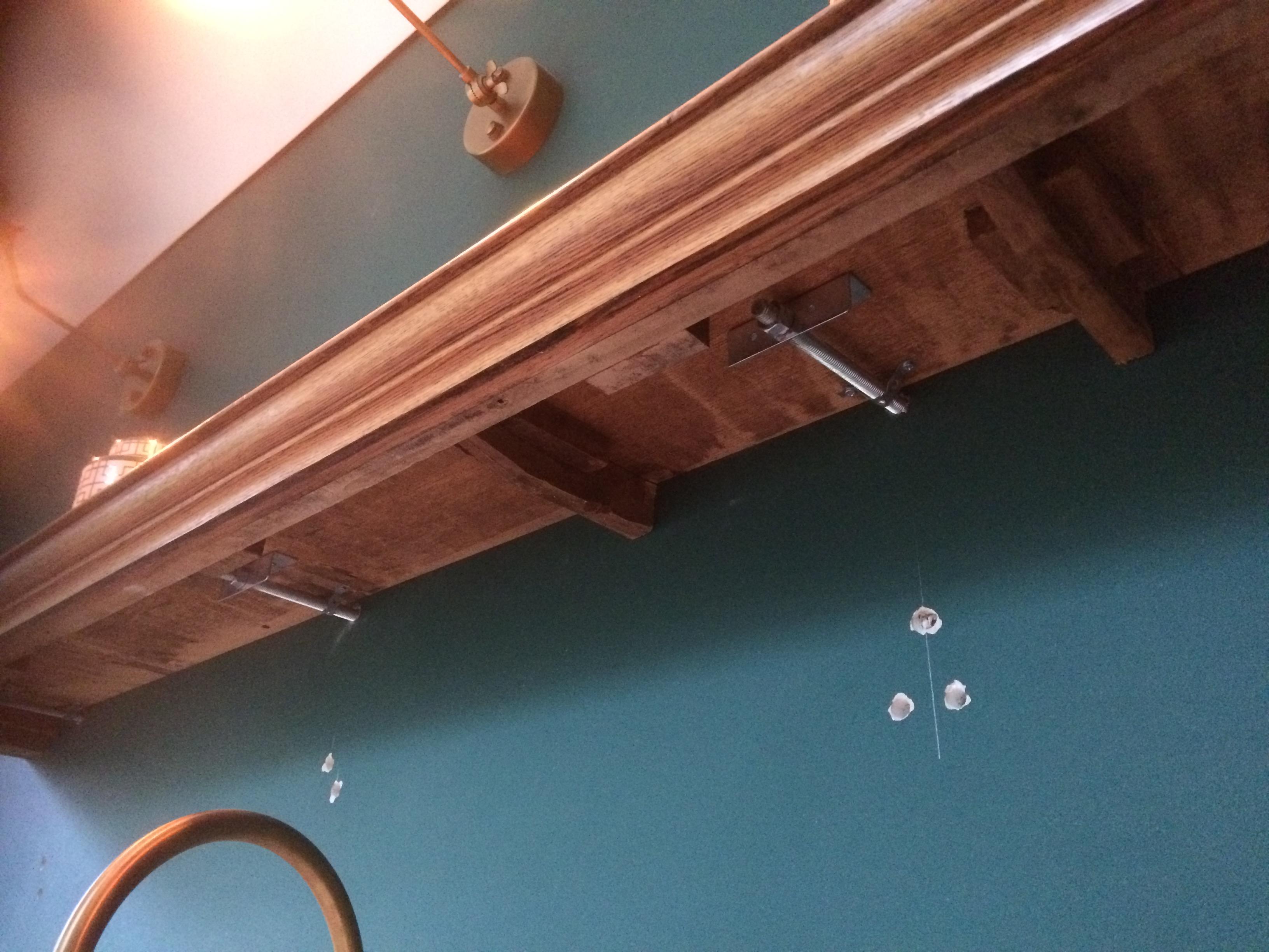

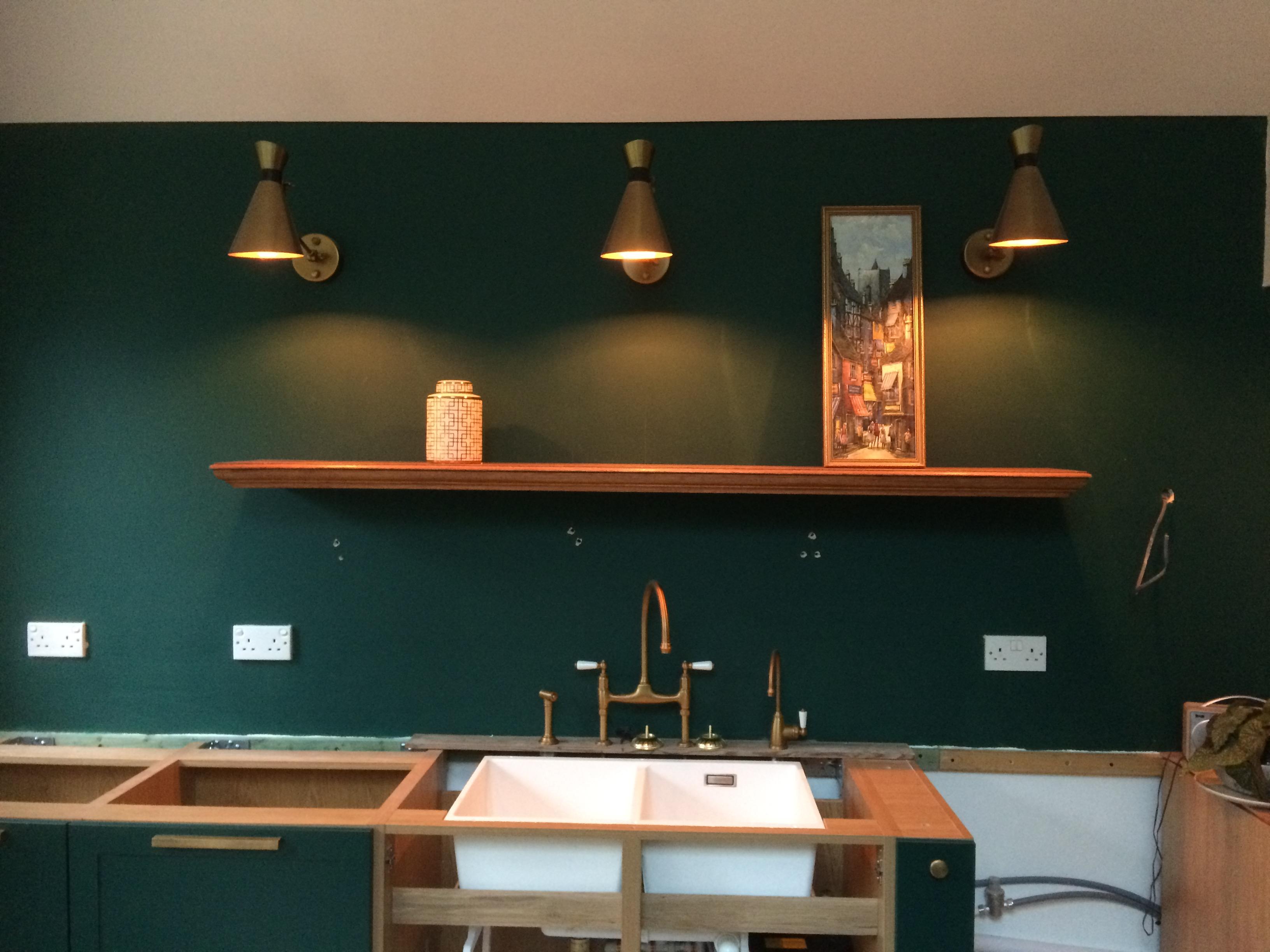

Gus Potter Posted September 10, 2021 Posted September 10, 2021 Bit of fun on using up extra resin anchors. Setting up part of the kitchen. The shelf is the top off an old oak sideboard. Will put a false base on it with some lighting to shine down on kitchen worktop and hide the rod /galv band ect. Rods are left over M12's that was used for anchoring structural stuff. Wall is 52.5 mm insulated plasterboard with 30mm of fire protection behind so 80mm of soft stuff. Holes below are test holes to find the studs. Drilled through the lot and about 40mm into the timber studs behind.. they (studs) can take this hole in this case structurally wise. Was going to put some resin in but thought let's try it by just putting a double lock nut on the end of the rod so I can turn the rod with a spanner.. and see if it the shelf will hold a bit of weight by just self tapping /threading it into the timber. It does so far! There is a little flex in it but not putting loads of books etc on the the shelf. 2
