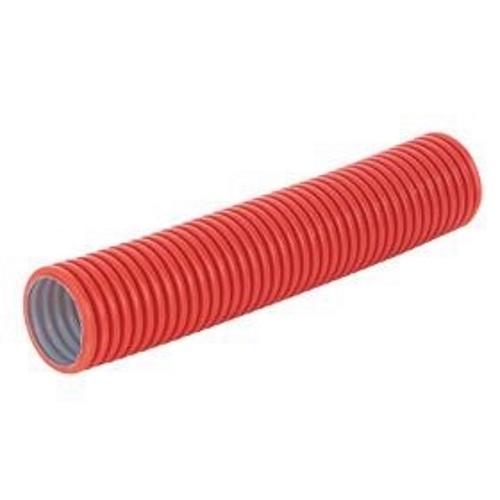

MJNewton Posted September 10, 2021 Posted September 10, 2021 (edited) 19 minutes ago, saveasteading said: Drainpipe. Easy to get, smooth flows, solid, proper, sealed joints at junctions. Doesn't rot or scuff or get eaten, has standard brackets for fixing solid, can change to rectangular at tight spaces. Is that recommendation from personal experience? I've not heard that approach before. I found 75mm semi-rigid radial ducting perfect for the job and a joy (well, almost!) to use once I'd got the hang of it. No joins (barring the two end points of course!), easy to route around obstacles, swept bends, loose coupling with the house structure to avoid vibrations etc. I didn't find the pricing particularly offensive, especially given how quick it was to install, and it wouldn't surprise me if it was far cheaper the drainpipe given all the fittings you'd need. My case was a retrofit and so solid piping would never have been any option but I think my positive experience would be equally applicable to a new build with much easier access. P.S. Being more specific, I used Airflow Airflex (the red stuff) and whilst Blauberg do a similar (compatible) product in green I had a piece and found it far less flexible and not quite as self-supporting in making a tight bend should that be required. Edited September 10, 2021 by MJNewton 2

MJNewton Posted September 10, 2021 Posted September 10, 2021 I'm nodding at all those points, although I've never measured its air resistance and it's not clear what the 'less work to do' is in comparison to (other than ducting with higher resistance of course!). Certainly as far as I'm aware it's working perfectly, and is doing so completely silently so I can't really think of any downsides. I suppose there is the issue that you have to buy it in large rolls and so you are at risk of over/under-buying. I sold what little excess I had though as there's often someone looking for just that little extra having run out themselves! If you've never had a piece in your hands more than happy to pop one in the post so you can get a proper idea what it's like. Of particular note is the internal lining which whilst ridged is what I'd call 'semi smooth', which of course is impossible to interpret accurately.
MJNewton Posted September 10, 2021 Posted September 10, 2021 (edited) 16 minutes ago, saveasteading said: Yes. Used it for extract fans, including multiple intakes from an inline fan downline. When you take out old spiral stuff you see how filthy it gets because of all the shapes and ripples in it. Round pipe you could even rod if you wanted. It sounds like we might be talking about different things. I can't imagine anyone using semi-rigid radial ducting like the following for extractor fans. It's got an internal diameter of 68mm so it would indeed be a terrible choice given the flow rate of a typical extractor. Edited September 10, 2021 by MJNewton
