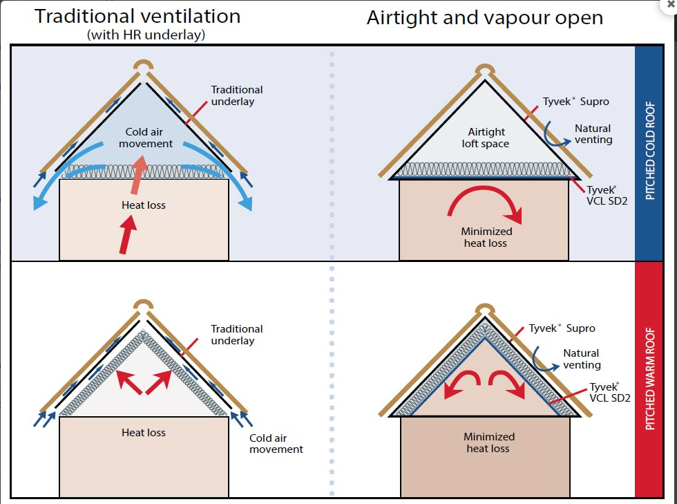

You're better off keeping the wind out of your cold loft.
Breathable membrane taped at all joints.
Batten and counterbatten and ventilate above the membrane.
Attached are diagrams from proclima and tyvek and a greenbuildingstore video that from 3:30 discusses Thermal Bypass.
 Pro Clima
Above Sheathing Ventilation - Part 1: Rise of the Cavity
  • Like 2

Thanks for the replies. Enough to convince me to counter batten.
Perhaps in the vid (which I'll watch this eve), what is the best detail for taping the membrane at its lower edge? Does the membrane not needed to somehow dispense any water into the gutter, but needs to seal to the inner leaf of the cavity wall?

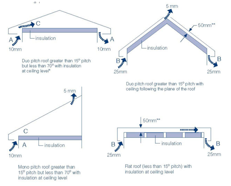

So, I spoke to the roofing sub contractor, who uses Proctor Roofsheild which is a breathable membrane which will be fitted with no sofit vents. So in effect giving a slightly ventilated cold roof, in as much as the ventilation is through the membrane. He also insists the counter battens are not needed.
Link to comment
Share on other sites
I'm not sure this will pass regs as you either need air passing below your membrane via soffit vents or a clear 50mm space above and over membrane ventilation. What kind of insulation are you using in your cold roof?
counter battens aren't required *if* you have a gap between the membrane and the insulation. it doesn't have to be 50mm with Roofshield though, just enough so that any water than runs down the membrane isn't in contact with the insulation (I think Proctor say 15mm but believe my BCO said 25mm iirc).
I believe this is obviously only an issue if you're insulating between the rafters. if you're insulating at joist level then no counter-battening is required I guess
https://www.proctorgroup.com/products/roofshield
this page has detailing for different roof types for the product.
