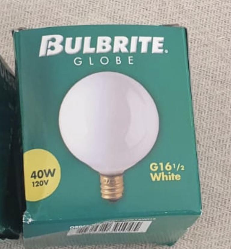

Adsibob Posted March 29, 2022 Author Share Posted March 29, 2022 On 04/09/2021 at 08:55, ProDave said: At least the cable they have used is rated for 600V and 105 degrees so you will have no problem. I have a problem. Wasn’t banking on the light bulbs the fitting is designed for being a funny American size. This is what came with the fitting: anybody know what the UK equivalent of a G16.5 bulb is? Been googling it for a while and they appear to be conflicting answers. Link to comment Share on other sites More sharing options...
dpmiller Posted March 30, 2022 Share Posted March 30, 2022 So IIRC G16 means the bulb is 16/8" in diameter, so about 52mm. It doesn't refer to the ES size. You'll need to measure the base to see of it's E12 or E17 Link to comment Share on other sites More sharing options...

Adsibob Posted March 30, 2022 Author Share Posted March 30, 2022 (edited) I measured the diameter of the screw base and it is 12mm. Does that correspond to an E12 bulb? Cannot seem to find it anywhere in something with a frosted golf ball glass or similar. It seems only E14 are available here! Edited March 30, 2022 by Adsibob Link to comment Share on other sites More sharing options...
dpmiller Posted March 30, 2022 Share Posted March 30, 2022 yep, it's E12 then. There's always a chance the moulding is loose enough to take a 14, you might give it a try... Link to comment Share on other sites More sharing options...

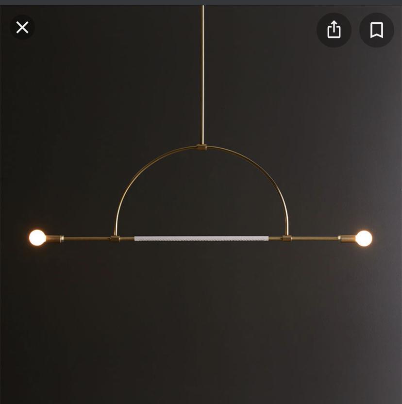

Adsibob Posted March 30, 2022 Author Share Posted March 30, 2022 (edited) 38 minutes ago, PeterW said: Have you got a photo of this light ..? May be able to come up with some ideas Yep: Edited March 30, 2022 by Adsibob Link to comment Share on other sites More sharing options...
Adsibob Posted April 23, 2022 Author Share Posted April 23, 2022 On 30/03/2022 at 21:15, PeterW said: Have you got a photo of this light ..? May be able to come up with some ideas Any ideas? i worked out that I probably don’t need that many lumens after all. 500 per bulb would just about be enough. And I can also forego the dimmability In terms of changing the bulb holder, I think I could fit this, as the internal diameter of the fitting is 24mm and this is 23mm wide, but at 50mm in projection, it will stick out and look pretty ugly. A 36mm projection (or as close to that as I can get, would be better). All thoughts welcome. Link to comment Share on other sites More sharing options...

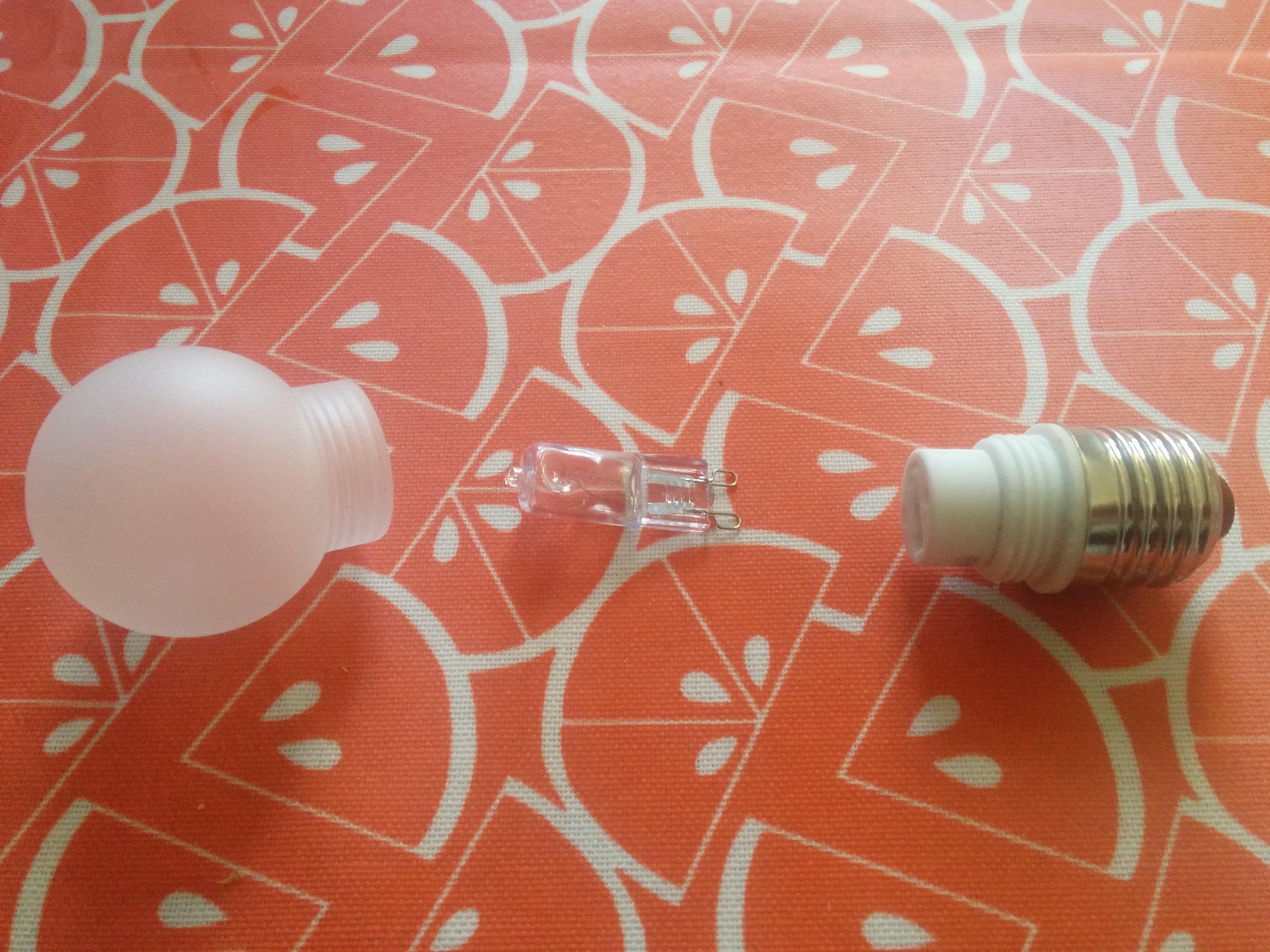

PeterW Posted April 23, 2022 Share Posted April 23, 2022 So you can buy the G9 globes on eBay for £5-15 depending on size, and e12 to G9 adapters are readily available so you could do this with some bits. G9 halogen are also available for a while too - the LED versions aren’t the best. Link to comment Share on other sites More sharing options...
