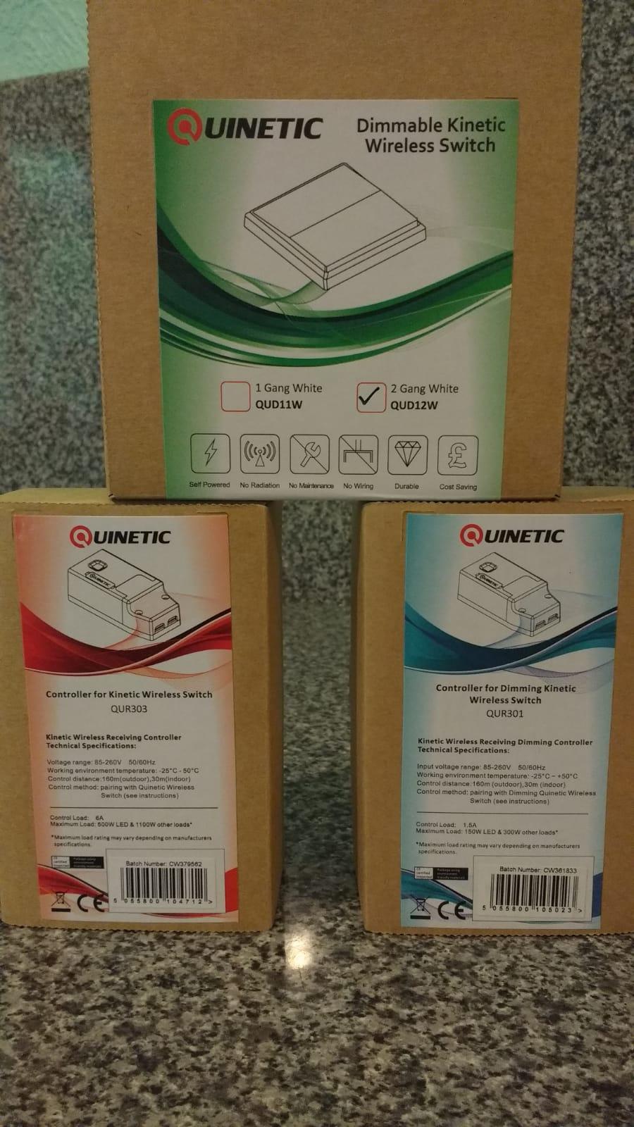

I've just purchased some Quinetic gear after confirming something that had been bugging me for a while but I've now figured.
The Quinetic 2-gang wireless dimmer switch (QUD12W) bumpf says it needs to be paired with the appropriate dimming receiver (QUR301). It DOESN'T. The dimmer switch will operate the standard 6A receiver (QUR303) to give on / off, no dimming function. I went into TLC earlier and they didn't know but were happy to open boxes and we wired it up on the bench.
So it works that one gang of the dimmer will control / dim the downlights via the dimmer receiver. The other gang of the dimmer will do the ambient, non dimmable lighting, LED strip and Bluetooth receiver via a standard 6A receiver.
Guessing they just assume you will want to use dimmable kit with a dimmer switch so highlight the need for a dimmer receiver and don't mention it will also work with the standard receiver.
Edited by Onoff

27 minutes ago, Dee J said:
Chatting to the wholesaler today about a related quinetic issue... standard switches in a simple on-off situation lose orientation after power loss. I.e. normal down=on ... if power is lost when switched on, on recovery it powers up in the off state, so now becomes up=on. Not a great problem, and invisible in multi switch situations. Except if you have one switch controlling several lights on separate circuits. Lose power on one circuit while the lights are on, and then you have one circuit switching in the opposite sense! Easy to reset, but might not impress the customers.
These dimmer switches I have, you can only switch them down, let go and it springs back.
So if you prod them quick do they switch on and off on a normal receiver ..?? Just thinking that using just dimmers would make sense as they can never fail “on”.
Yep, give a dimmer a stab and it turns on a normal receiver, though there's nothing official I've found that says it works. Stab again and it turns off.
