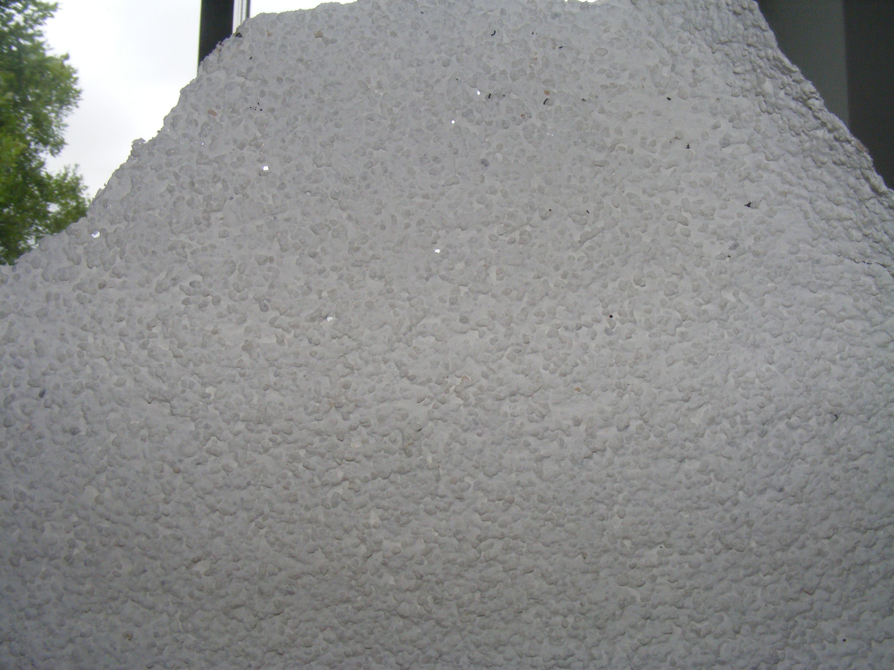

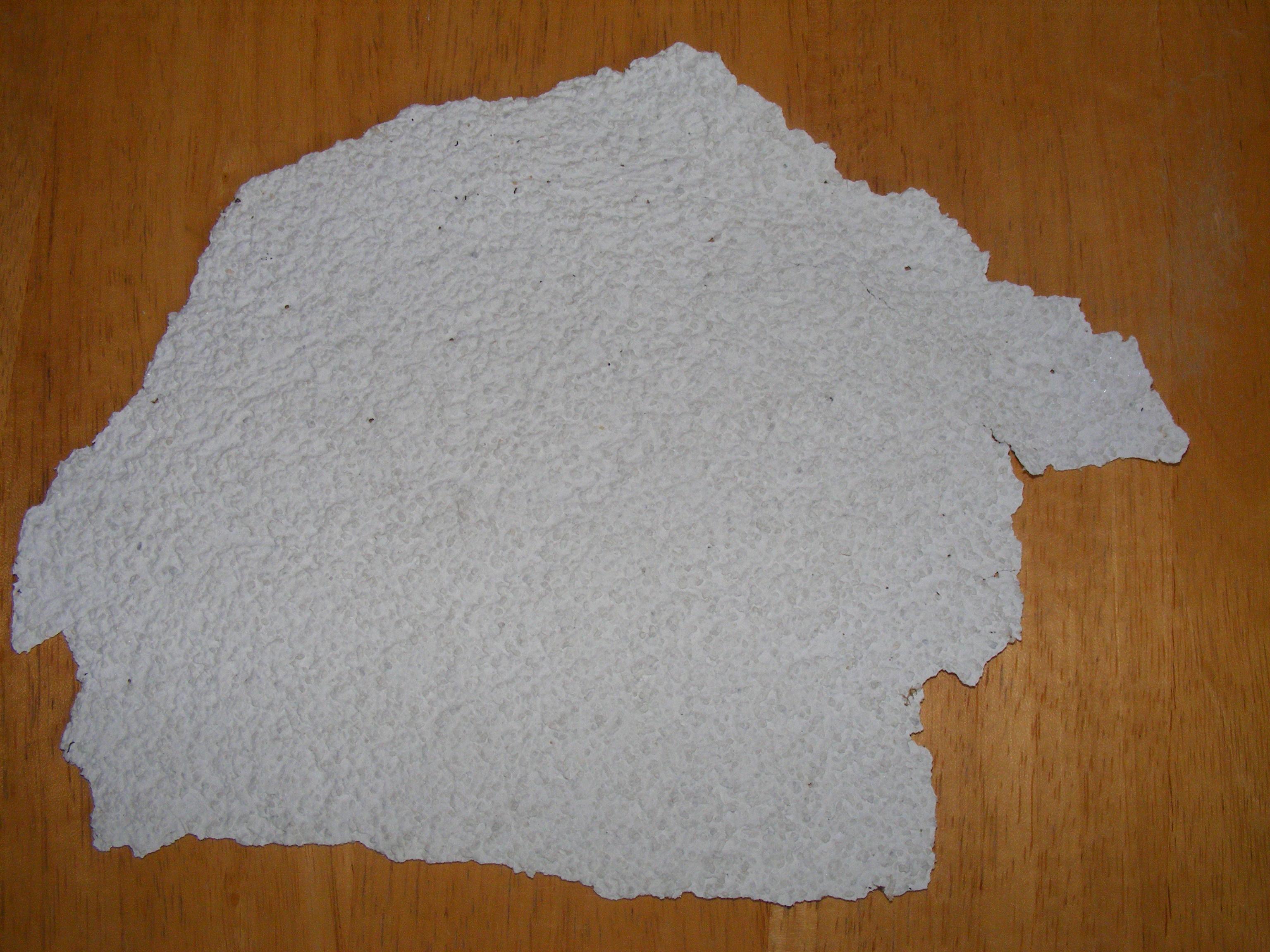

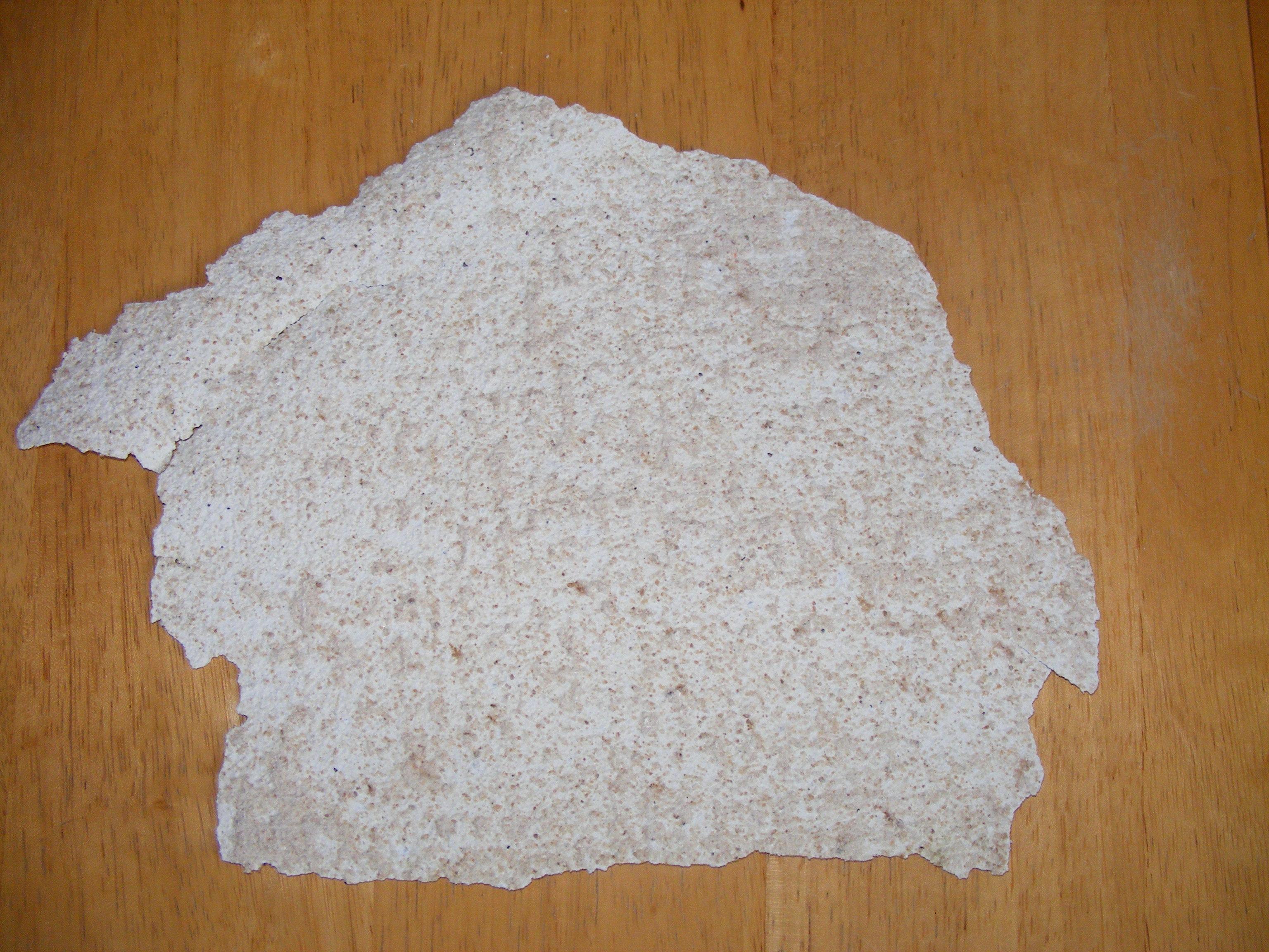

ProDave Posted August 6, 2021 Author Share Posted August 6, 2021 Okay here is the latest. The plasterer has made contact with the technical rep of another distributor of the Baumit product, where he can have an open, frank and honest discussion without them being on the defensive to defend a claim as they were not the supplier and have nothing to lose. The plasterer has also had a pick through some of the render that has been removed in sheets and is sitting in my trailer at the moment. One observation is a lot of the Silikon top top coat render appears to have a lot of pinholes in it. And observation of some of the other areas of the house that have blisters but have not yet been removed seems to show the same. The technical rep cannot think of any reason to do with application that would result in this happening. Product failure? Following on from that, these pinholes would allow rainwater to get through to the MC55W base coats which would become soaked and then frost over the winter would cause the breakdown we have seen. I presently have some sample pieces of the render collected that I am going to photograph in as high resolution as possible to email to him, and I might well then package them up and physically post them to him. Regards MC55W Vs RK39 base coat. This technical rep is of the opinion RK39 is okay and has the advantage that it is rated as a sole coat i.e should be waterproof even without the Silkon top top coat, so any further moisture penetration should not cause it to fail. So we are making a little understanding about what might have happened. Link to comment Share on other sites More sharing options...

ProDave Posted August 6, 2021 Author Share Posted August 6, 2021 Picture of a sample of failed render. From the front: From the rear Held up to the light to show pinholes. Link to comment Share on other sites More sharing options...
