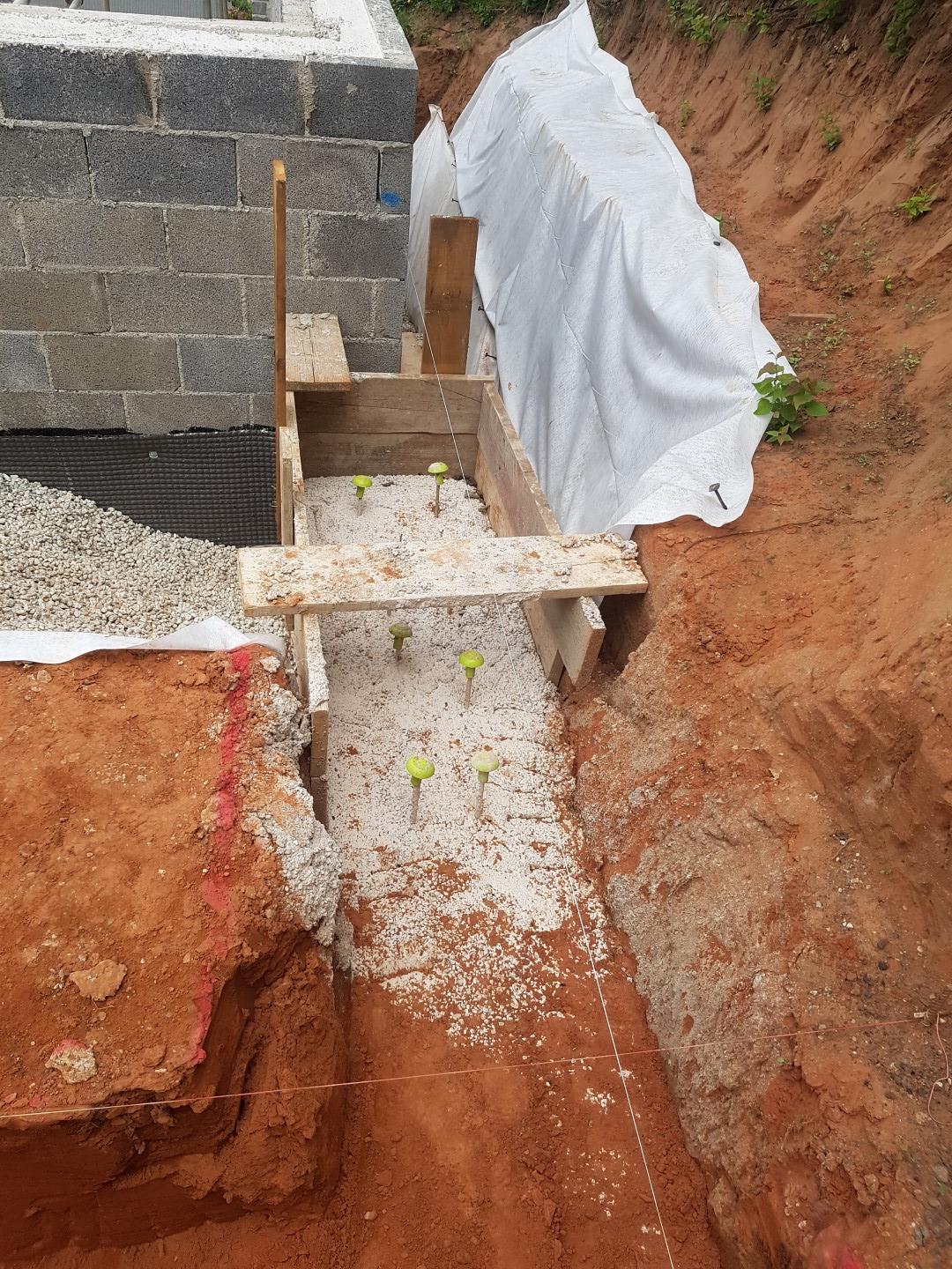

Moonshine Posted August 2, 2021 Share Posted August 2, 2021 (edited) 12 minutes ago, MonkeyTom said: Thank you for the reply tonyshouse. I've already filled the founds to 450mm below ground. Do you know whether I can overfill the foundation to bring it up and whether this could cause an issue with integrity / building regs? It does otherwise seem like a good solution. My understanding with trench fill is you typically bring it to 150mm below ground level. Though one thing you may want to consider is because you are pouring two layers of foundation, you may need to structurally link them with rebar. like this in vertical https://nhbc-standards.co.uk/4-foundations/4-3-strip-and-trench-fill-foundations/4-3-13-construction-joints/ I have just done this, where the footings are about to be poured over a mass foundation as below (i embedded the rebar in just after the pour) in your case if you want to do this, you are going to have to drill into the existing concrete and affix rebar studs in it Edited August 2, 2021 by Moonshine Link to comment Share on other sites More sharing options...
Mr Punter Posted August 2, 2021 Share Posted August 2, 2021 (edited) 22 minutes ago, Moonshine said: Though one thing you may want to consider is because you are pouring two layers of foundation, you may need to structurally link them with rebar. No this should not be required if they are just being topped up. Clear it first with BCO. Edited August 2, 2021 by Mr Punter Link to comment Share on other sites More sharing options...
Moonshine Posted August 2, 2021 Share Posted August 2, 2021 53 minutes ago, Mr Punter said: No this should not be required if they are just being topped up. Clear it first with BCO. Hopefully that is the case as retrospectively doing it would be a pain in the bum Link to comment Share on other sites More sharing options...
