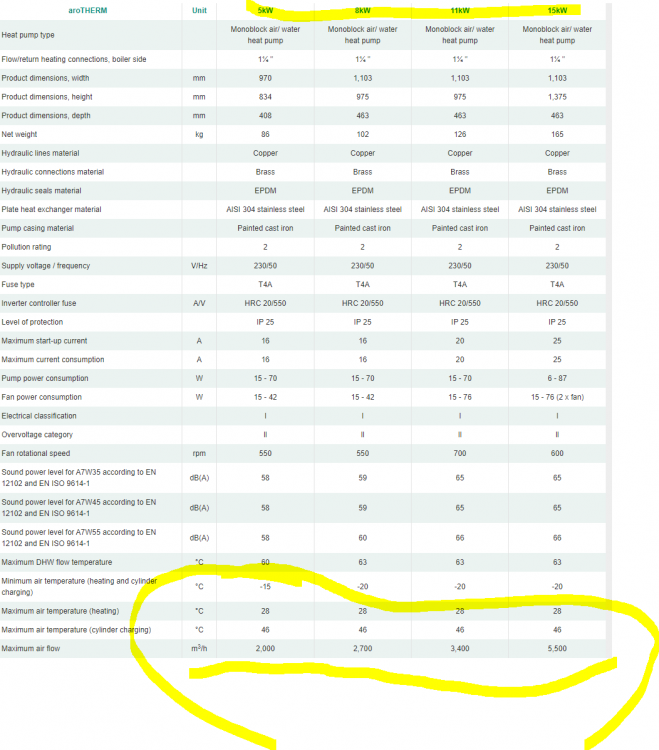

Iceverge Posted January 24, 2022 Share Posted January 24, 2022 3 hours ago, epsilonGreedy said: The onus is really on you to disprove human intuition and life experience on this matter since we all know that sitting in the shade is usually chilly in the UK. ASHP simply move too much air to make much use of relatively small localised warm air pockets. A 10kw heat pump moves up to 3000m3/hr. Say you were to allow an hour for each airchange to gain meaningful heat in a nice suntrap that was sheltered up to 10m high with 300m2 ground area .Then put the heat pump in the middle. On a still day it would make a measurable difference to the performance of your ASHP. However you’d be better off just putting the entire house in the said suntrap instead! I wager a better ASHP location would be as close to the house as possible to reduce pipe heat losses and in a naturally windy area so the fans don’t need to work so hard. 1 Link to comment Share on other sites More sharing options...

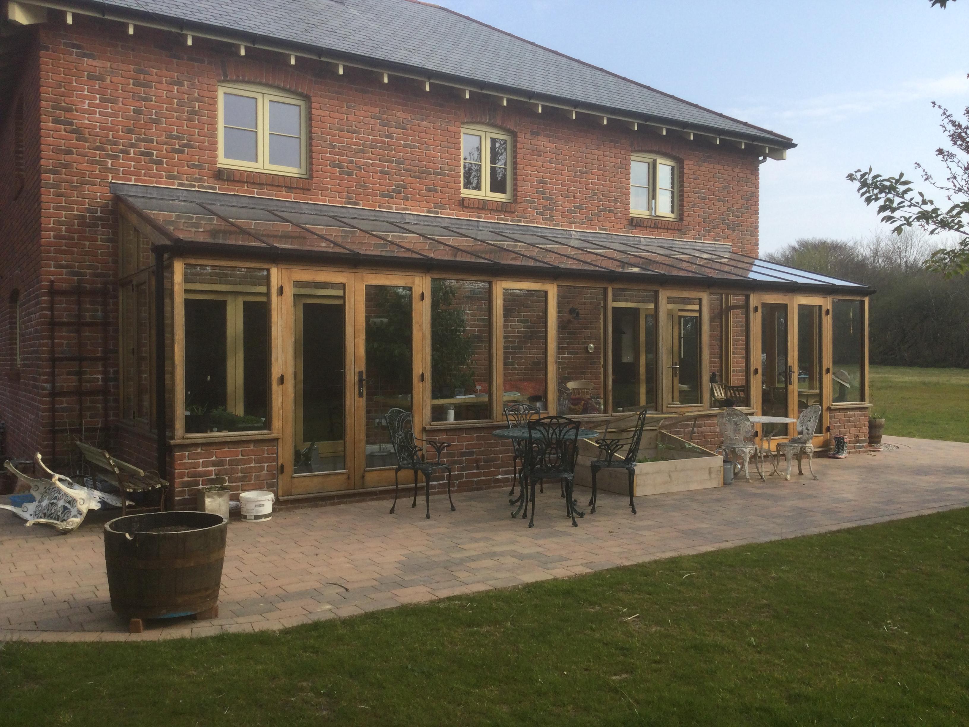

joe90 Posted January 25, 2022 Share Posted January 25, 2022 9 hours ago, Iceverge said: However you’d be better off just putting the entire house in the said suntrap instead! ? this is why I faced the back of our house south with a large conservatory across the whole 12m, black tiles on the floor above insulation and large bifolds into the house. I think this contributes a massive amount of heat into the house fir a lot of the year. The heating rarely comes on even mid winter on clear sunny days. Even our Jeremy with all his extensive knowledge and calculations didn’t realise the impact of the microclimate in his location, he ended up needing more cooling than heating. Link to comment Share on other sites More sharing options...
Iceverge Posted January 25, 2022 Share Posted January 25, 2022 I think this merits further study. Pull out some real data. Have you any simple thermometer to keep an eye on temps for us @joe90 I get the feeling it might be a very useful element of low energy building. All the benefits of massive glazing without the heat loss or overheating. "The selective use of solar gain through manually operated glazed appendages on domestic housing" Or a conservatory m8. ? 1 Link to comment Share on other sites More sharing options...

epsilonGreedy Posted January 25, 2022 Share Posted January 25, 2022 12 hours ago, Iceverge said: However you’d be better off just putting the entire house in the said suntrap instead! I wager a better ASHP location would be as close to the house as possible to reduce pipe heat losses and in a naturally windy area so the fans don’t need to work so hard. No one is suggesting positioning a new build house elsewhere on a plot so that an ASHP gets the prime sunny location. Likewise there has been no discussion of remote siting of an ASHP in the sunny corner of a plot. The matter of debate is: given equally viable ASHP locations on a north or south facing wall what advantage will be gained on the southern wall. Putting aside the summer chilling function I think we all accept there is a theoretical advantage on the southern wall but is it a 0.1% reduction in heating cost or 5%? It would help if you and @SteamyTeacould concur on the volume of air drawn through an ASHP. @SteamyTeasays "several tons a day" and you are claiming "up to" 3.7 tons an hour. Anyhow the real point of interest is ASHPs that are prone to frosting. Let's not forget the COP of an ASHP in defrosting mode is negative 1.0 or is it negative infinity? The worst outcome is an ASHP that spends so much time defrosting there is not enough time left to maintain the required internal house temp. Someone reported such a case here recently. Would a southerly aspect help such edge cases? Link to comment Share on other sites More sharing options...
