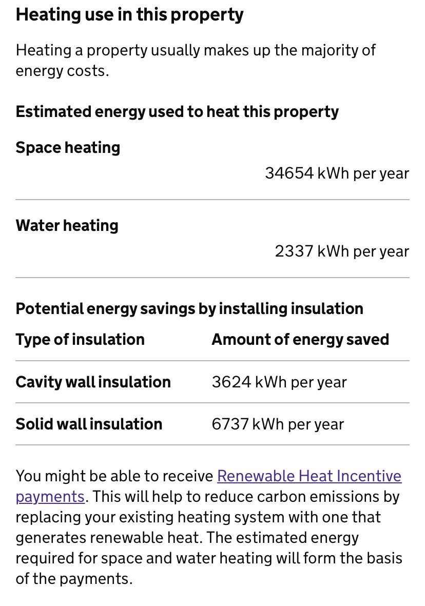

CotswoldDoItUpper Posted July 26, 2021 Posted July 26, 2021 We’re not on mains gas and have a 10yr old LPG combi boiler. It’s an old house with an EPC of 19(!) and a estimated energy usage for space heating of 34500kw per year. we are adding insulation where practical and changing light fittings to LED etc but want to investigate ASHP further. I guess we’d be looking at a 16kw unit and an approximate cost of £15-20k installed with RHI payments capped at £1300/yr for 7 years (£9100 in total). it doesn’t seem worth it to me but I want to make the best decision possible. Am I missing something? Is it worth waiting 3-5years to see if the cost of the unit comes down? please convince me either way!

SteamyTea Posted July 26, 2021 Posted July 26, 2021 (edited) 1 hour ago, CotswoldDoItUpper said: It’s an old house with an EPC of 19(!) and a estimated energy usage for space heating of 34500kw per year. How big is the place (m2), how much DHW do you expect to use (litres/day), is it detached, semi, terrace, number of stories, is the loft converted to a habitable area? Does it use 34,500 kWh/year (~35 MWh/year) (kW is power, kWh is energy, kw is a nonsense unit, as is kwh, kW/h, KWH). It may seem a bit snobby and pedantic mentioning the units, but apart from the odd type, if you get a quote that is incorrectly mixing SI units, consistently misquoting derived units, and the worse, mixing SI and Imperial units i.e. kWh/square foot, be very wary of the company. Edited July 26, 2021 by SteamyTea
CotswoldDoItUpper Posted July 26, 2021 Author Posted July 26, 2021 @SteamyTea its a 1800s cottage of around 120sqm and a 1987 extension (cavity wall, tho think it’s only about 50mm) of around 100sqm Detached, all 2 stories. Loft not converted (yet!). Double glazed all round, no idea on age of windows, think mid-90s. no floor insulation, we’re installing that this week. 100mm between joists (not enough space to keep to have more and keep an air gap!) and 20mm above agree with specific units being important. Was an oversight on my part! @scottishjohn I didn’t realise energy trust did free surveys. I’ll definitely arrange that!
SteamyTea Posted July 26, 2021 Posted July 26, 2021 (edited) That works out at ~18W/m2, which does not seem excessively high for an old place. (it is late and I may have made an error) But it is still ~160 kWh/m2.year. A quick google shows this. https://www.ovoenergy.com/guides/energy-guides/how-much-heating-energy-do-you-use.html UK average seems to be about 133 Edited July 26, 2021 by SteamyTea
IanR Posted July 26, 2021 Posted July 26, 2021 2 hours ago, CotswoldDoItUpper said: It’s an old house with an EPC of 19(!) and a estimated energy usage for space heating of 34500kw per year. EPC's aren't necessarily all that accurate, is that 34,500 kWh space heating demand confirmed by how much LPG you purchase in a year? LPG boilers are up to 90% efficient, so that would be around 38,500 kWh worth of LPG annually, plus what ever your DHW demand is. Unless you also have alternative heat sources, such as log burners, and then it will be difficult to calculate. 3 hours ago, CotswoldDoItUpper said: I guess we’d be looking at a 16kw unit and an approximate cost of £15-20k installed Where did you get this figure from? and what does it include? Unvented cylinder, buffer, larger radiators and/or wet UFH? Hopefully that figure includes everything you need. 3 hours ago, CotswoldDoItUpper said: with RHI payments capped at £1300/yr for 7 years (£9100 in total). Is that the cap now? Even with low flow temp (35°C) heating emitters? What ever heating system you go with, insulate as well as possible and make the property as airtight as possible. Ideally you'd plan for a low flow temp heating system, so if you don't go for an ASHP now, you won't be ripping it all out if you need to in 10 - 15 years. Low flow temp heating systems require ideally UFH with "good" insulation underneath and/or larger radiators plus a hot water cylinder. 2 hours ago, JamesP said: The electricity cost would be substantial and not sure it would be able to provide you with adequate heating. I would hang on to gas / lpg for as long as possible before being forced down the electric only route. This I don't necessarily agree with this. I've never had LPG, but it looks like it's around 6.5p per kWh (45p/litre and 7kWh per litre). At 90% efficiency, that costing 7.2p/kWh With electricity at 12.5p/kWh, you've only got to get a COP of 2 and an ASHP is cheaper to run. You'll be far better than a COP of 2, you could probably get to a COP of between 3.5 to 4 for an average throughout the year. The lower you can get the flow temp, the more efficient the ASHP will be. Large heat emitters and large hot water cylinder means lower flow temp. How much insulation can you get under your floor? Are you considering wet UFH? Are you planning any significant renovation, or are you trying to improve insulation with minimum disruption?

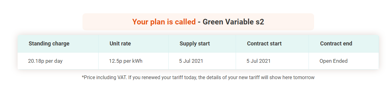

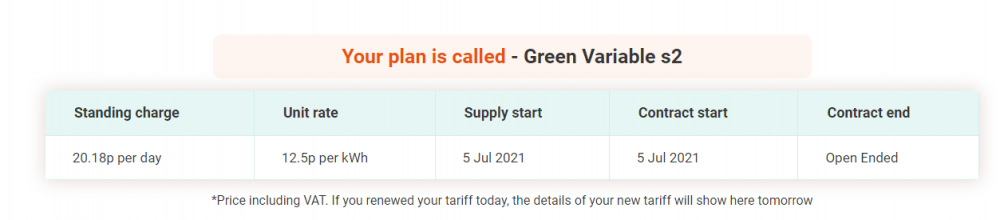

IanR Posted July 27, 2021 Posted July 27, 2021 12 minutes ago, JamesP said: Please let me know where I can find a supplier for 12.5p/kWh. I've just moved from Symbio to PFP Energy, both are charging 12.5p / kWh. Symbio are terrible though, hence my move. 13 minutes ago, JamesP said: The Government is looking at delaying the ban on gas boilers to 2040 due to soaring "net zero" cost. Have you got a link? the devil's in the detail. Currently announced was that new builds would be net-zero-carbon from 2025. There hadn't been an announcement (to my knowledge) on how they were going to encourage existing housing stock to more away from fossil fuels, only that EPC requirements were going to be ramped-up from 2028 - 2035. 1
IanR Posted July 27, 2021 Posted July 27, 2021 (edited) 26 minutes ago, CotswoldDoItUpper said: @IanR the EPC was done when we bought the house about 2 months ago. You'd be better off going by how much LPG the previous owner purchased per year, or paying for someone to do some detailed heat loss calcs. My experience of the EPC's created for house sales are they are a tick box exercise with lots of assumptions, so *could* be wildly out. 26 minutes ago, CotswoldDoItUpper said: Cost includes a pre plumed UVC, the unit itself and Installation, nothing else. Couple of quotes online to give me a rough idea. You should be able to get far cheaper. 26 minutes ago, CotswoldDoItUpper said: We are instilling wet UFH downstairs and will do larger rads upstairs. we can get 100mm PIR between the joists and 20mm on top. Couple of places we can go to 150mm between, but only basically in the hall! That gets you to a level where the losses won't be too high on the UFH, and if you've already "booked" this cost, I feel the pendulum has swung in favour of going with an ASHP. The job now is to reduce heat losses to permit a smaller ASHP and reduce the install cost further, and that looks like it is already in your plans. Edited to add: You need your new ASHP heating system commissioned by 31.03.2022 as RHI is finishing. It does sound like there will be something to replace it, but no details yet. Edited July 27, 2021 by IanR

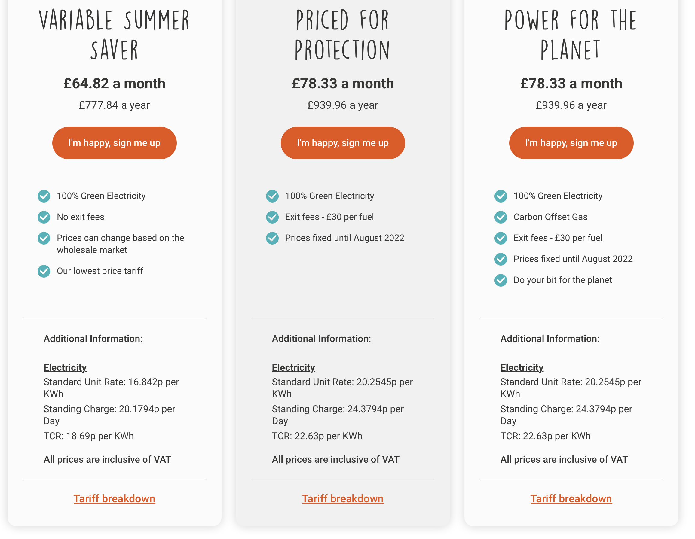

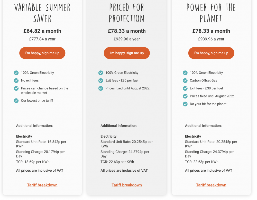

IanR Posted July 27, 2021 Posted July 27, 2021 (edited) 7 minutes ago, JamesP said: Thanks Ian, lowest rate from PFP is 16.84p and that's a variable summer rate. Fixed is 20.25p. Do prices fluctuate that much across the country from the same supplier? They must offer different prices across the county. Here's my current deal with PFP, it is variable, and they're offering a 12 month fixed for a few tenths more. I'm thinking it's probably wise to take the fixed deal. Edited July 27, 2021 by IanR 1
Nestor Posted July 27, 2021 Posted July 27, 2021 3 hours ago, CotswoldDoItUpper said: we’ve just switched to a ‘cheep’ 14.8p/kWh package. Previous was 11.5p!! Agh! As noted above it does depend on your location, even from the same supplier the price varies by 30%+.
