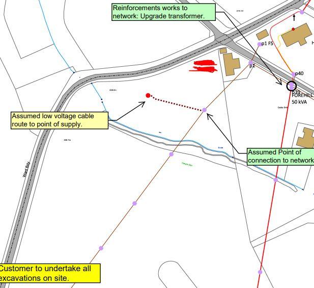

Kelvin Posted July 26, 2021 Posted July 26, 2021 (edited) Hi all, my first post. ? We are in the process of buying a plot of land. We've had our offer accepted subject to conditions one of which is the cost of the electricity supply. I've completed the form for an estimate from SSE and they've come back today with £25,500 ex vat. They've based this on a new three phase supply with a mx capacity of 35kVA for the entire development. We're building one three bed house with an ASHP, MVHR, and possibly an EV point but not confirmed. The plot is in a rural area with electricity supply nearby (the supply runs overhead across the bottom of the plot) The design document suggests they need to upgrade a transformer. I know they recently installed a brand new transformer in the field opposite that my connection will come off. I am somewhat surprised at the cost as had budgeted around £17,000 at the high end. I was warned to expect a high estimate though. Part of the game apparently. I've left them a message to call me back to discuss. Would welcome any suggestions or advice. Thanks Kelvin. Edited July 26, 2021 by Kelvin
ProDave Posted July 26, 2021 Posted July 26, 2021 Do you NEED 3 phase? Did you ask for it? Do you NEED 35kVA? That is a LOT for a single house. In my case I avoided any upgrade charges by accepting an offer of a single phase 12kVA supply which is proving plenty.

Kelvin Posted July 26, 2021 Author Posted July 26, 2021 I didn't request 3 phase and estimated the supply at 20kVA.
ProDave Posted July 26, 2021 Posted July 26, 2021 SSE are usually pretty good. They should provide you with a drawing showing what is going to be upgraded and what is going to be installed as new equipment. If you have that, then post it (anonymised) If you did not ask for 3 phase then definitely tell them you only need single phase. What are your intentions re heating demand? are you just going to build something that will scrape through building regs or are you planning a well insulated low energy house? do you have any idea yet how you plan to heat it?
nod Posted July 26, 2021 Posted July 26, 2021 18 minutes ago, Kelvin said: Hi all, my first post. ? We are in the process of buying a plot of land. We've had our offer accepted subject to conditions one of which is the cost of the electricity supply. I've completed the form for an estimate from SSE and they've come back today with £25,500 ex vat. They've based this on a new three phase supply with a mx capacity of 35kVA for the entire development. We're building one three bed house with an ASHP, MVHR, and possibly an EV point but not confirmed. The plot is in a rural area with electricity supply nearby (the supply runs overhead across the bottom of the plot) The design document suggests they need to upgrade a transformer. I know they recently installed a brand new transformer in the field opposite that my connection will come off. I am somewhat surprised at the cost as had budgeted around £17,000 at the high end. I was warned to expect a high estimate though. Part of the game apparently. I've left them a message to call me back to discuss. Would welcome any suggestions or advice. Thanks Kelvin. We’ve just had a quote for two six beds ASHP also Rural location From GEC Took about a week About £7500 for two
Kelvin Posted July 26, 2021 Author Posted July 26, 2021 (edited) 9 minutes ago, ProDave said: SSE are usually pretty good. They should provide you with a drawing showing what is going to be upgraded and what is going to be installed as new equipment. If you have that, then post it (anonymised) If you did not ask for 3 phase then definitely tell them you only need single phase. What are your intentions re heating demand? are you just going to build something that will scrape through building regs or are you planning a well insulated low energy house? do you have any idea yet how you plan to heat it? Well insulated SIP house with ASHP and MVHR. Possibly a Heb Home timber kit. It's alsp worth pointing out that their drawing below is wrong. Where they have marked the assumed point of connection to the network well that pole is actually at the East boundary nearer that house on the right. Edited July 26, 2021 by Kelvin
ProDave Posted July 26, 2021 Posted July 26, 2021 I don't know how far the map extends beyond the bit you have posted, but is is possible to work out how many houses that existing 50kVA transformer is feeding presently? In our street we were the 9th house to connect to an existing 100kVA transformer, and further down the street there is a 50kVA transformer feeding 5 houses. So i expect if there are 5 or more houses already on that transformer then it will need upgrading. But you might be able to argue you only need a low capacity supply. DNO's get nervous of heat pumps because older ones had a high start up surge, make it clear you will be using an inverter driven low power heat pump with soft start.

Kelvin Posted July 26, 2021 Author Posted July 26, 2021 I think about 7 from looking at google maps. However, if you follow the poles south from the one on the plot the second one down has a brand new transformer on it which they've not marked on the map

ProDave Posted July 26, 2021 Posted July 26, 2021 If you can, I would visit the site and have a walk around and see if you are able to follow the wires to see how many houses are actually connected to that particular transformer. But definitely ask them to re quote for say a 12kVA single phase supply.
