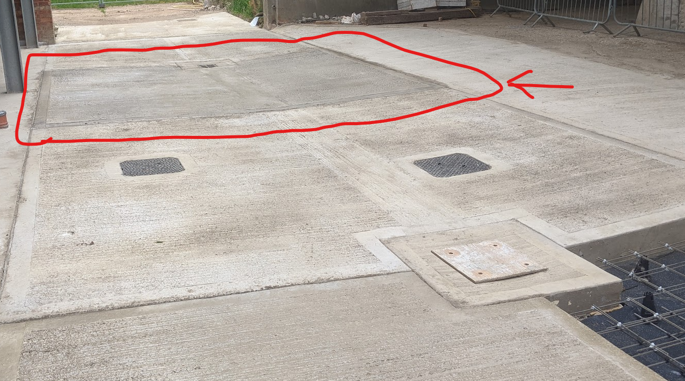

About 150m2 getting an external concrete slab. Nicely divided into reasonable sized, mostly squarish bays. Several of these have gone in fine.

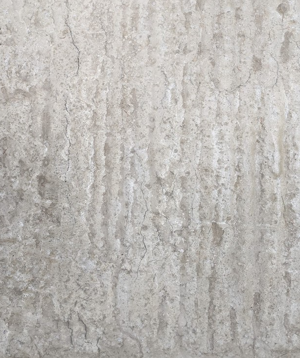

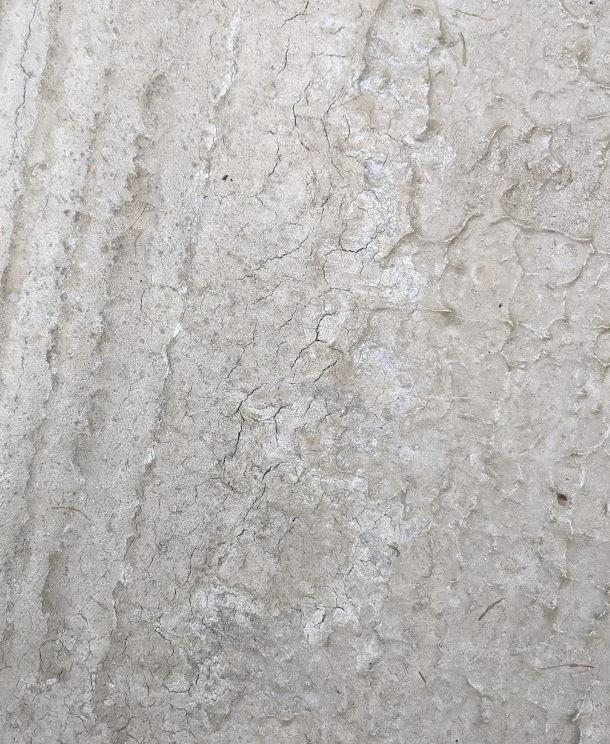

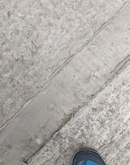

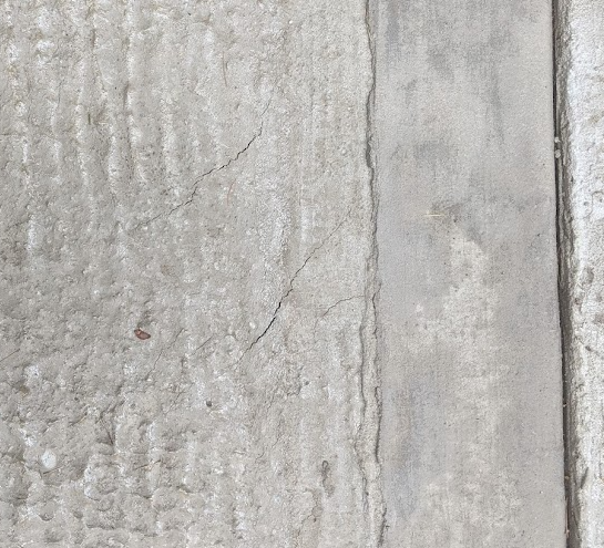

But one of the bays poured on Thursday (i.e. 48 hours ago) has now developed lots of small cracks, which I assume are early contraction cracks as the slab heats, cools, dries out, and whatever else concrete does as it cures.
My concern is - how much do these matter? Is any remedial work worth it? I'm assuming this is annoying but probably fine to leave as is?
This slab:
- Farm roadway to take occasional heavy traffic
- 200mm thick
- Roughly 5x4m
- Single layer of thickish reinforcement mesh (basalt fibre - more on that another time) at about 130mm from base i.e. in upper half
- Layer of poly at the bottom
- Compacted subbase of crushed concrete
- Laid on hot sunny day, some shading
- Something was sprayed on top - I think to slow down evaporation
All the other slabs have been totally fine, including two others done same day. I wasn't on site to see this one, but the usual groundworker foreman was on holiday, and apparently there was a dog that ran into the mix as it was being poured which caused some disruption.
This one:
Examples of cracks:

Looks like cracking from too warm and not protected after pouring in this really hot weather concrete would really need damp Hessian at a minimum.
Don't look like they'll be too much of a worry but I'd war h them and see. If caught early you can brush some raw cement in which will help seal some.
Biggest problem with small cracking like them is it's a route for water which can cause larger problems with the freeze thaw affect in winter time

Concrete too wet when laid, then dried too quickly. And esp too much wet paste at the top.
Probably inappropriate reinforcement, and lack of debonding at joints.
Hot day and fast evaporation.
(The difference between curing and drying is for another essay).
This is a very common problem and I am constantly amazed that groundworkers do not know this. I can only assume that they have not been docked for it before.
Adding extra water makes it much easier to move around and level. But then that water evaporates and leaves voids, where there should be concrete.
In any ready-mix delivery there is a space on the chit to record added water, and the driver will fill it in and want it signed, because the supplier knows this can cause problems, and they  don't want the blame.
A concrete mix is an exact science. When 'just right' for strength it is awkward to shovel, so they will add water, without asking anyone in authority..
They may well have sprayed some sealer on top, supposedly to keep it from evaporating, but it hasn't worked, probably because it has just sat on the free water.
polythene/wet hessian are more fool-proof.
It may not fall apart, or maybe it will. As stated above it will let water through the cracks, and that will freeze, and that will break the concrete.
I think the top surface of paste (no stone) will abrade quite quickly.
Also, all concrete cracks, and it is a matter  of controlling it to a minimum and to multiple invisible microcracks.
The reinforcement , and debonding at earlier edges, helps with that, and I can't comment on what you have in that regard. whether it was appropriate, and whetehr it reached the edges/ overlapped etc.
The choice of appropriate steel mesh is well proven, but I have no idea with 'thickish basalt' mesh. Certainly plastic fibres don't work as well as was originally trumpeted, or as steel mesh. More info would be interesting.
I would worry that a small mesh would reduce  bonding at the layer. But it is new to me and I don't know.
Depends what you have paid really. If you have employed a bunch of labourers who don't know the science of it ( and simply have not been paying attention) then perhaps it is your problem, and is decent value, as you have saved 25% oh and p, and management.
If there is a specification or a known performance requirement then you have an argument.
If this was for a formal contract it would  have to  come out  and be redone.
as a private job for yourself it is up to you.
Whatever, keep the whole roadway damp throughout the warm weather and for a month in total, as the cement needs that time being damp to do its job.

What you are seeing their is shrinkage, either from direct sun, high temps, or a breeze blowing over it.
I would not be too worried about this given the application, the cracks will not be all the way through.
