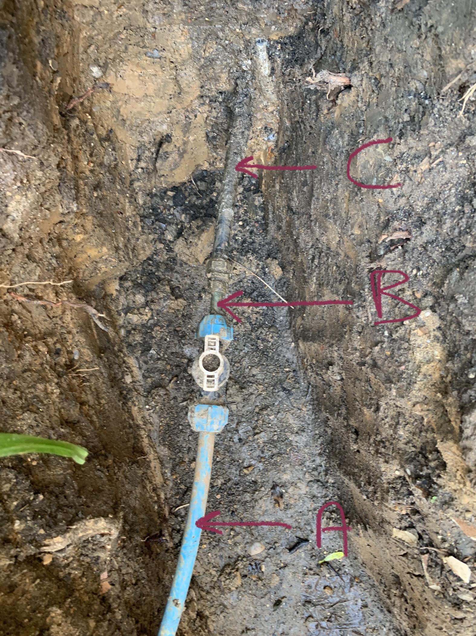

hendriQ Posted July 22, 2021 Posted July 22, 2021 My builder is laying a new 35mm plastic pipe from the water mains at the property's boundary to the house (a distance of about 8m). We currently have 22mm but with an odd restrictor close to the connection which looks like it is reducing it at that point to 15mm. My builder has said that he doesn't know what the restrictor is but will remove it. He said that replacing the current 22mm to a 35mm pipe will improve flow but not as dramatically as if I paid Thames Water to modify the actual connection to their mains. He said he's not authorised to touch their property. I have had a quick look at Thames Water's website and it seems it's a lot of bureaucracy and cost to get them to do the upgrade of that bit. They do list about 150 suppliers that they have authorised to do works to their network as an alternative, but I've called about 15 of them and either they don't cover London or they don't cover individual residential properties. I will keep trying, but wondering if anyone can make a stab at whether it will actually make a huge difference, as my understanding is that my existing pressure (which is between 2.8 bar and 3 bar, depending on time of day) won't change, it's just the flow rate (which currently is about 20L per min) will improve. We are going to have an UVC. Photo below of what's installed at the moment, showing the weird 15mm narrowing (at point B), the 22mm plastic pipe we are upgrading to 35mm (at point A) and what I presume is the black outlet pipe from the Thames Water connection thing (at point C). That pipe is only about 30cm long then it hits the Thames Water connection

fezster Posted July 22, 2021 Posted July 22, 2021 (edited) Simple answer is, Yes - increasing the diameter of pipe A will increase flow and reduce the pressure drop across that section of pipe, which means dynamic pressure will be higher (static pressure remains the same, as you rightly said). Edited July 22, 2021 by fezster Clarified
hendriQ Posted July 22, 2021 Author Posted July 22, 2021 1 minute ago, fezster said: Simple answer is, Yes - increasing the diameter of pipe A will increase flow and dynamic pressure (not static pressure, as you rightly said). Thanks. I'm already doing that: builder is only charging me £200 to do it, so it was a no brainer. He's also going to remove the weird restriction at B. My question is whether it is worth the bureaucratic hurdles and cost of getting Thames water to increase the pipe at C and it's entry point into the mains thingy, whatever that's called.
fezster Posted July 22, 2021 Posted July 22, 2021 Just now, hendriQ said: Thanks. I'm already doing that: builder is only charging me £200 to do it, so it was a no brainer. He's also going to remove the weird restriction at B. My question is whether it is worth the bureaucratic hurdles and cost of getting Thames water to increase the pipe at C and it's entry point into the mains thingy, whatever that's called. Do you have a water meter? Usually, the pipework on your land belongs to you and is one side of the water meter. I don't quite understand why B and C are Thames Water's responsibility? In answer to your question, you could ask TW to measure the open pipe flow rate at the boundary to get an indication if increasing the remaining pipe size would give any improvement.
hendriQ Posted July 22, 2021 Author Posted July 22, 2021 3 minutes ago, fezster said: Do you have a water meter? Usually, the pipework on your land belongs to you and is one side of the water meter. I don't quite understand why B and C are Thames Water's responsibility? In answer to your question, you could ask TW to measure the open pipe flow rate at the boundary to get an indication if increasing the remaining pipe size would give any improvement. I don't have a water meter - the water is unmetered, we just pay a standing charge. Technically you are probably right in that Thames Water is not responsible for anything on my land. I think my builder is just being cautious because pipe C is very short, about 30cm before it goes into public land (i.e. the Council's land, i suppose, in that it is under a pavement) so whilst he could technically replace most of that as soon as he crosses the boundary he is nervous and for some reason he is not keen even to replace that last 30cm. Maybe I should tell him I'm not happy and that we agreed the £200 would be to replace my pipe and that that black bit is my pipe as well.

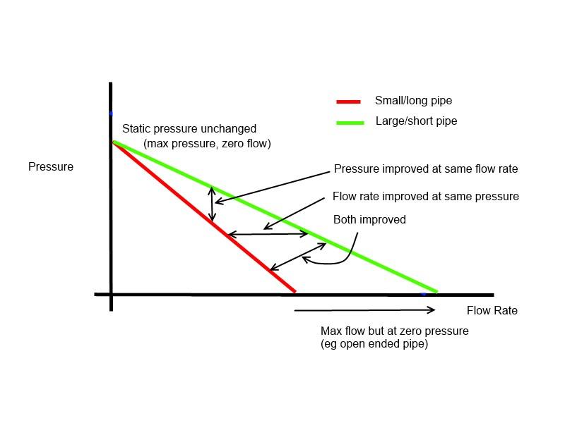

Temp Posted July 22, 2021 Posted July 22, 2021 6 hours ago, hendriQ said: as my understanding is that my existing pressure (which is between 2.8 bar and 3 bar, depending on time of day) won't change, it's just the flow rate (which currently is about 20L per min) will improve. You can get improvements in pressure. Not the static pressure, that won't change, but the pressure in your house at a set flow rate can improve. So for example suppose your static pressure is 2.8-3 bar and your open pipe flow rate is 20L/min. Then the pressure at say 10L/min can improve. Likewise the flow rate you can draw before the pressure falls below say 2 bar can increase. How and where was your 20l/min measured?
