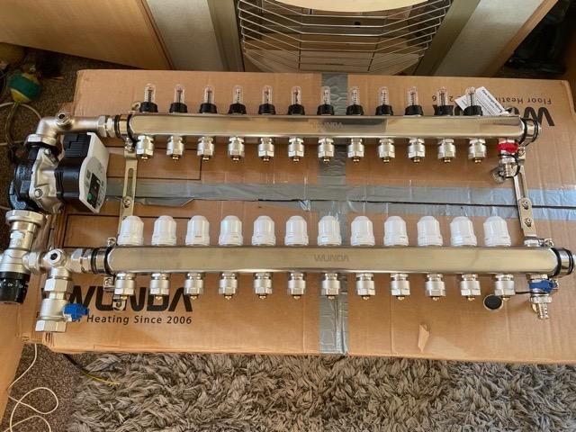

Hilldes Posted July 20, 2021 Author Posted July 20, 2021 36 minutes ago, Bitpipe said: It took me all of 20 mins to foam the joints, had too much plant installed at that stage to get the PB skimmed. 4 minutes ago, Nickfromwales said: Yup. They do get crazy very quickly! My plant rooms are bare right now but need to decide very soon as UFH installation is the next job. Need to find a home for these beasties: ...and discovered today that neither unvented DHW cylinder I have quotes for will fit in the first floor plant room, so now looking to enlarge or move the room ?
Hilldes Posted July 20, 2021 Author Posted July 20, 2021 1 hour ago, Nickfromwales said: You can get horizontal UVC’s if that helps? Its more the height that was the issue because its a 1.5 story house and the roof slope clashes with the top of the cylinder. Just need to expand the plant room footprint further from the roof. As a bonus it will actually simplify the UFH pipe routing. 1
