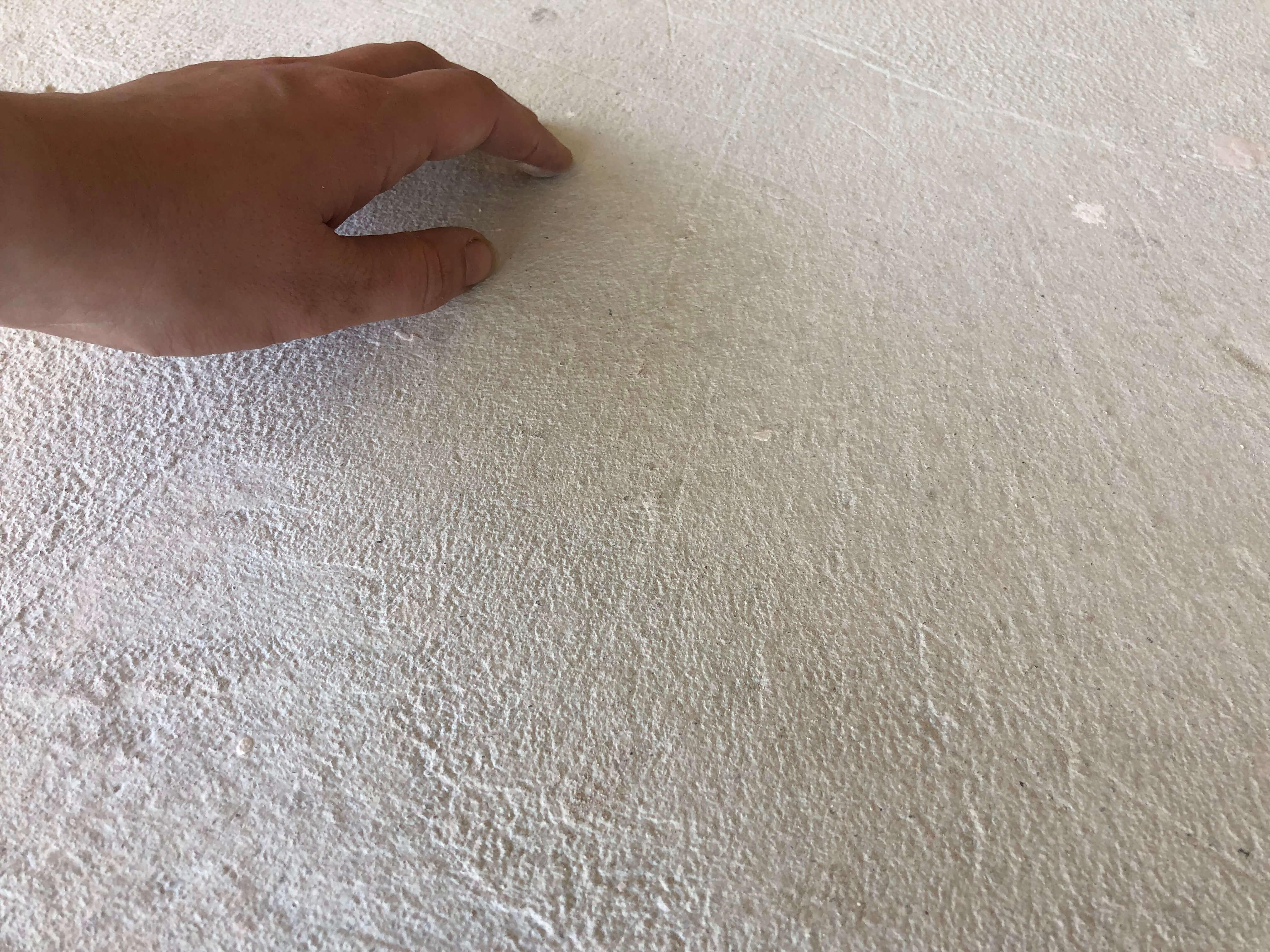

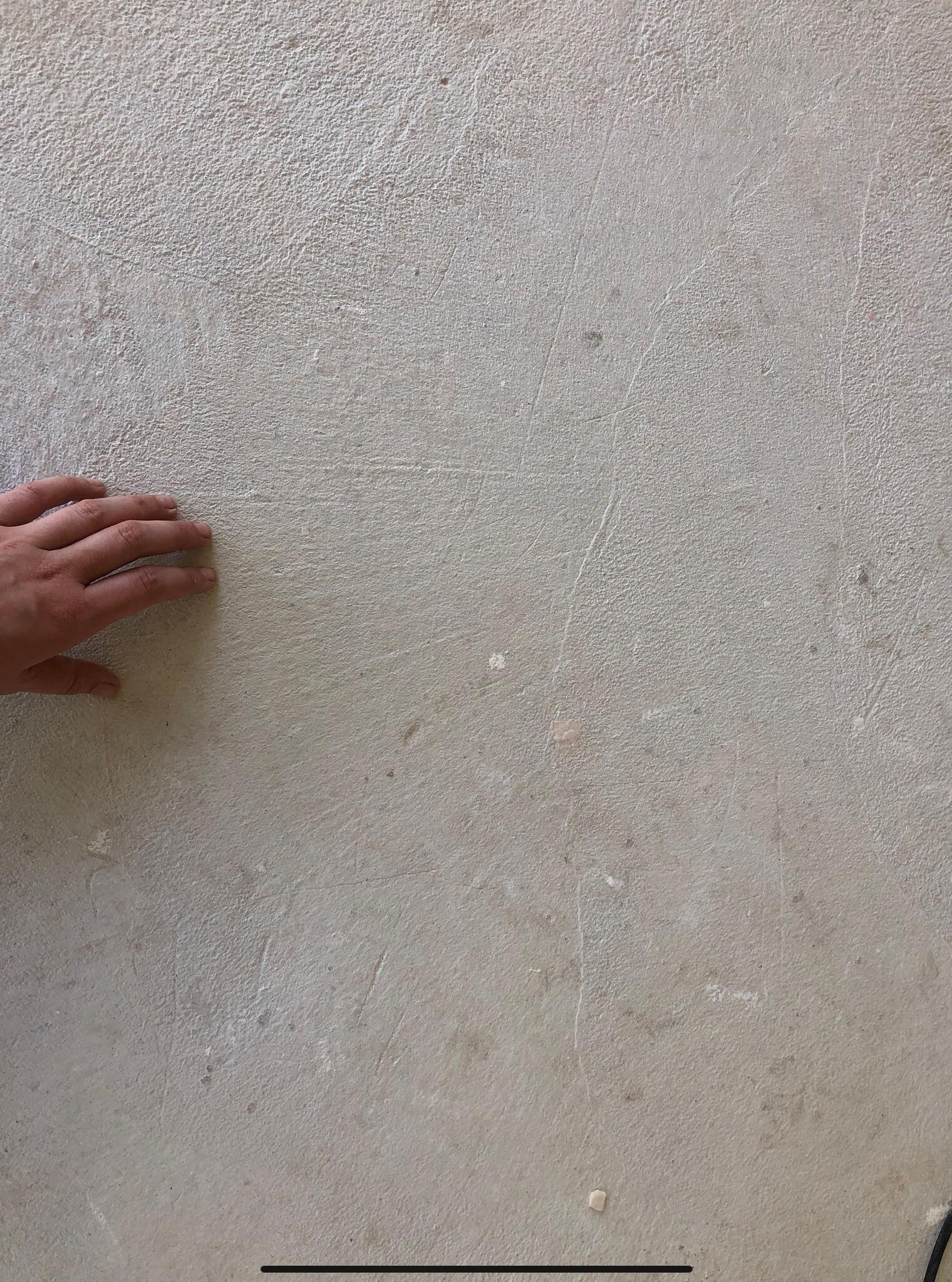

i’m about to lay my engineered oak floor to my concrete slab, sticking using sika 54 glue.
a floor fitter I spoke to said we should sand the concrete slab to remove latency, at a very low grit. I haven’t found any other information about this online so can anyone share their experiences? The slab is pretty flat otherwise except for a few spots I can manage with a hand tool. If I don’t need to sand the slab I won’t as it doesn’t sound like a nice job and I would need to hire a floor sander
Is it generally recommended to prime the concrete? Or is that only if it’s dusty?
edit to add: the slab has a membrane, insulation and ufh pipes underneath it. It was a single pour

If the only issue is a few screed marks, then they rub off easily. can use tools or just rub with a brick.
I have known a floating engineered floor to make a slapping sound where there is a tiny hollow, but it  then relaxed to shape.
Wood bends, even laminated wood.
How thick is the glue?  Have you tried a straight edge?
Latency is another matter. Basically dust or a weak surface caused by too much water or too much trowelling, as that will be a weker bond than glue to wood.
 If it is ultra soft the it should be rubbed back to a clean hard surface.
If reasonably good, it might be worth a coat of PVA. perhaps a thin coat then a thicker one.
If hard, leave it.
Try scratching with finger nail then screwdriver.

I’ve taken some images of a random patch - went over quickly with bottom range vacuum, and it obviously has some paint and plaster spots I should get up.
I tried rubbing with a crow bar and not much dust comes up, it seems pretty hard . Did video but don’t seem to be able to upload due to file size
the glue you trowel on with a 6mm bead I think, which then compresses. I do need to triple check with a straight edge, I don’t have anything very long but will borrow sometching!

No need for a latex screed in my opinion. Floorers like it because they make quite easy extra money for it while also taking away some risk (there are some horrible efforts at flooring out there).
I have had lots of cases of floorers tutting about levels and moisture content and it has always been false: whether scam or ignorance who can say?
How long has your concrete been down?
Try putting a glass bowl upside down on it on a warm day, and if it doesn't steam up you are fine.

Thanks! Glad to hear you think so ? I’ll double check with a long level later for flatness but otherwise I’m hoping that’s the general thought, I really didn’t want to sand it ?
the concrete has been down over a year, but that’s a really good tip about the glass bowl!
