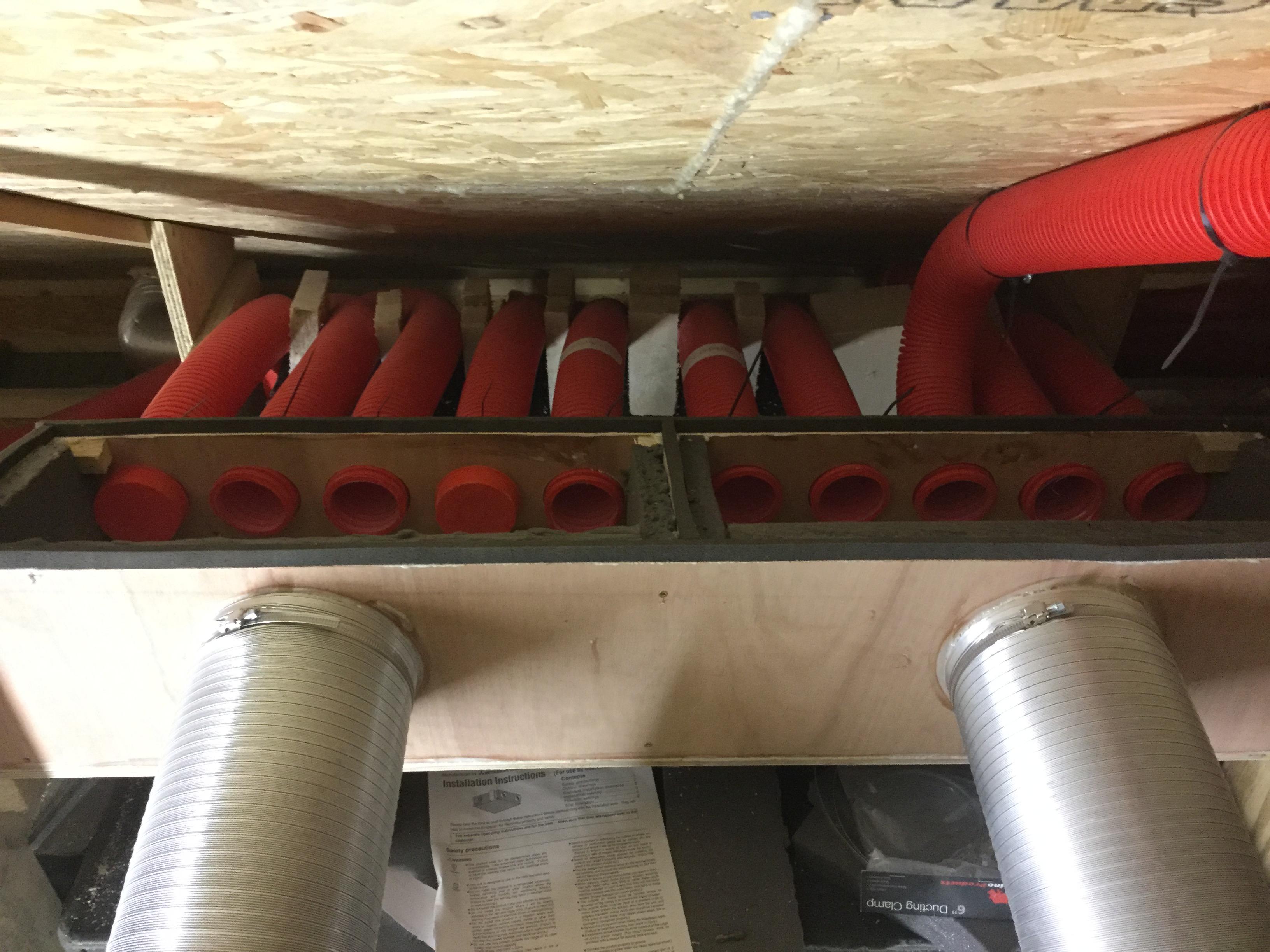

joe90 Posted December 2, 2020 Share Posted December 2, 2020 I made my own from ply and incorporated the manifold as well into one box, extract one side, input the other 1 Link to comment Share on other sites More sharing options...
PeterW Posted December 2, 2020 Share Posted December 2, 2020 I’ve got a couple of issues with noise due to having very short ducts from the manifolds to the supply valves so looking to use some sort of pyrosorb foam in the duct plenum to try and reduce some of the transferred noise but not lose the flow. Link to comment Share on other sites More sharing options...
joe90 Posted December 3, 2020 Share Posted December 3, 2020 8 hours ago, PeterW said: I’ve got a couple of issues with noise due to having very short ducts from the manifolds to the supply valves so looking to use some sort of pyrosorb foam in the duct plenum to try and reduce some of the transferred noise but not lose the flow. yes I lined my “box” above with sound absorbing foam which helped but admit it’s the short lengths that produce the most noise. Link to comment Share on other sites More sharing options...
