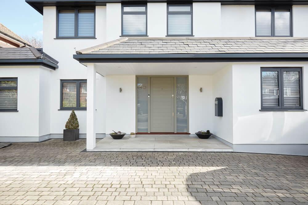

I'd say there is a downpipe hidden in that square column/support.
Goes into that Aico drain you can just see.
Edited by Onoff

DP`s in columns is common in commercial buildings.

Interesting point. But that downpipe would only service the little roof, not the main roof.. although I guess you could sneak a few pipes here and there

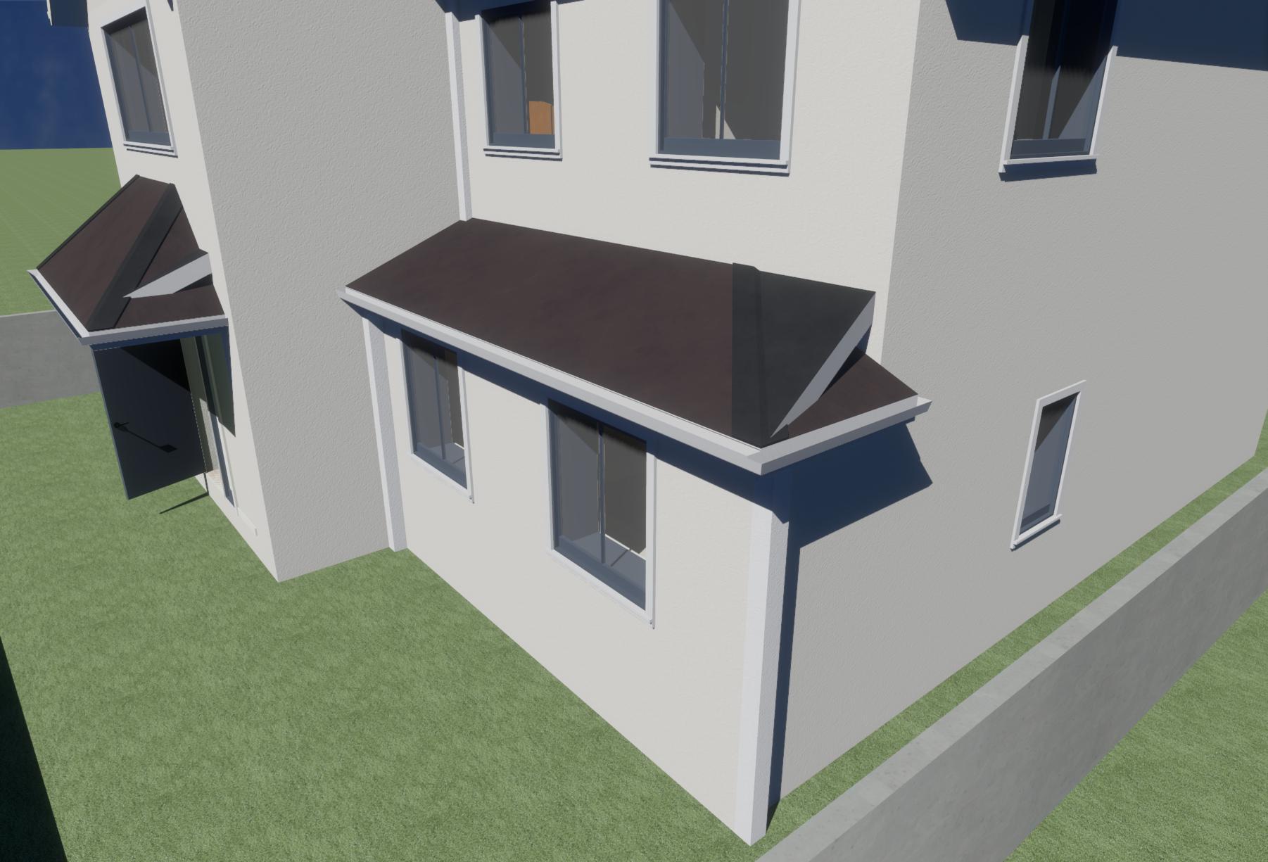

Here's an implementation of 150x150 square downpipes, 2 in the corner, and 1 'artificially extending' the front of the house somewhat. As @AliG noted curving around the actual roofplanes is a hassle (can't we go through without introducing major issues?)
Would this work?
Also, are there triangular downpipes to really squeeze into a corner? Or is that (again) asking for trouble?

I guess looking at this picture the plan is to make everything white which would then be OK. The earlier picture with black windows and gutters was confusing me?
The number of downpipes required is driven by the amount of roof and expected run off.
That small piece of roof would be fine with only the downpipe in the corner, it doesn't need two. You would just create a run to the end where the pipe is.
However, the roof above that then runs down onto this one is large, you will need to be careful with the pipe in the corner running off the top roof. It might be better to have a wide flashing and the pipe run into that rather than across the tiles.
By the time you have brackets etc, it would never look like shown in the picture, the pipe at the end would stick out from the house with a gap. In this kind of case the better idea would be to put the pipe round the corner on the side elevation. Similarly you cannot put a pipe as tight in the corner as you suggest, it needs brackets to hold it up.
You cannot put the downpipe through the soffit as it needs a run off from the bottom of the gutter. It would be too high in the soffit and also the standard connectors attach to the bottom of the gutter not the side.

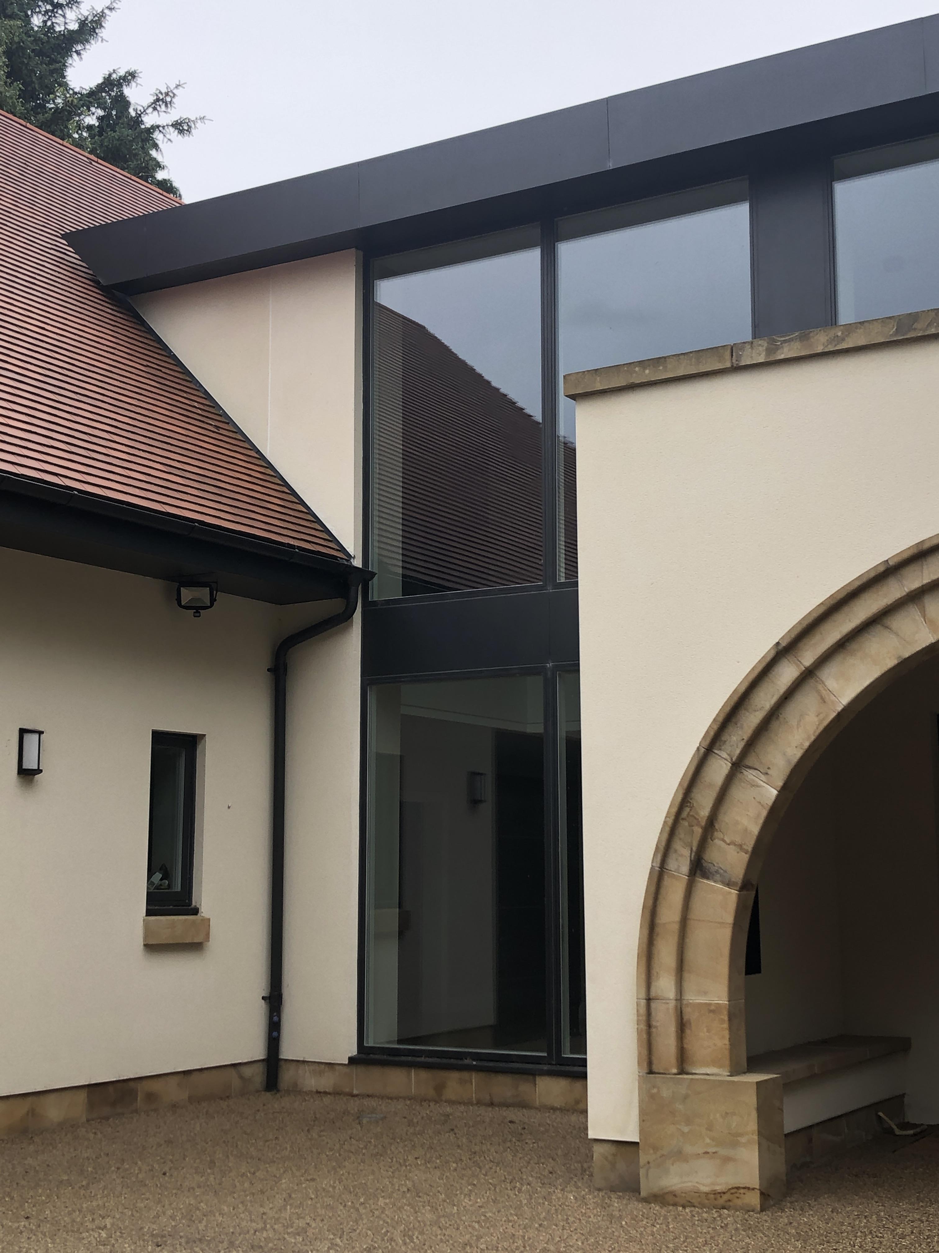

I am pretty OCD about hiding things and keeping things as tidy as possible, but there is a limit to what can be done. For example relative to the picture you will also need a strip of flashing all along the top edge of the tiles and at the left hand side. These will be harder to see from the ground than the angle shown. You don't really notice them once they are in. What people notice is things that are odd, like horizontal downpipes across a wall or pipes right in the middle of the front wall of a house.

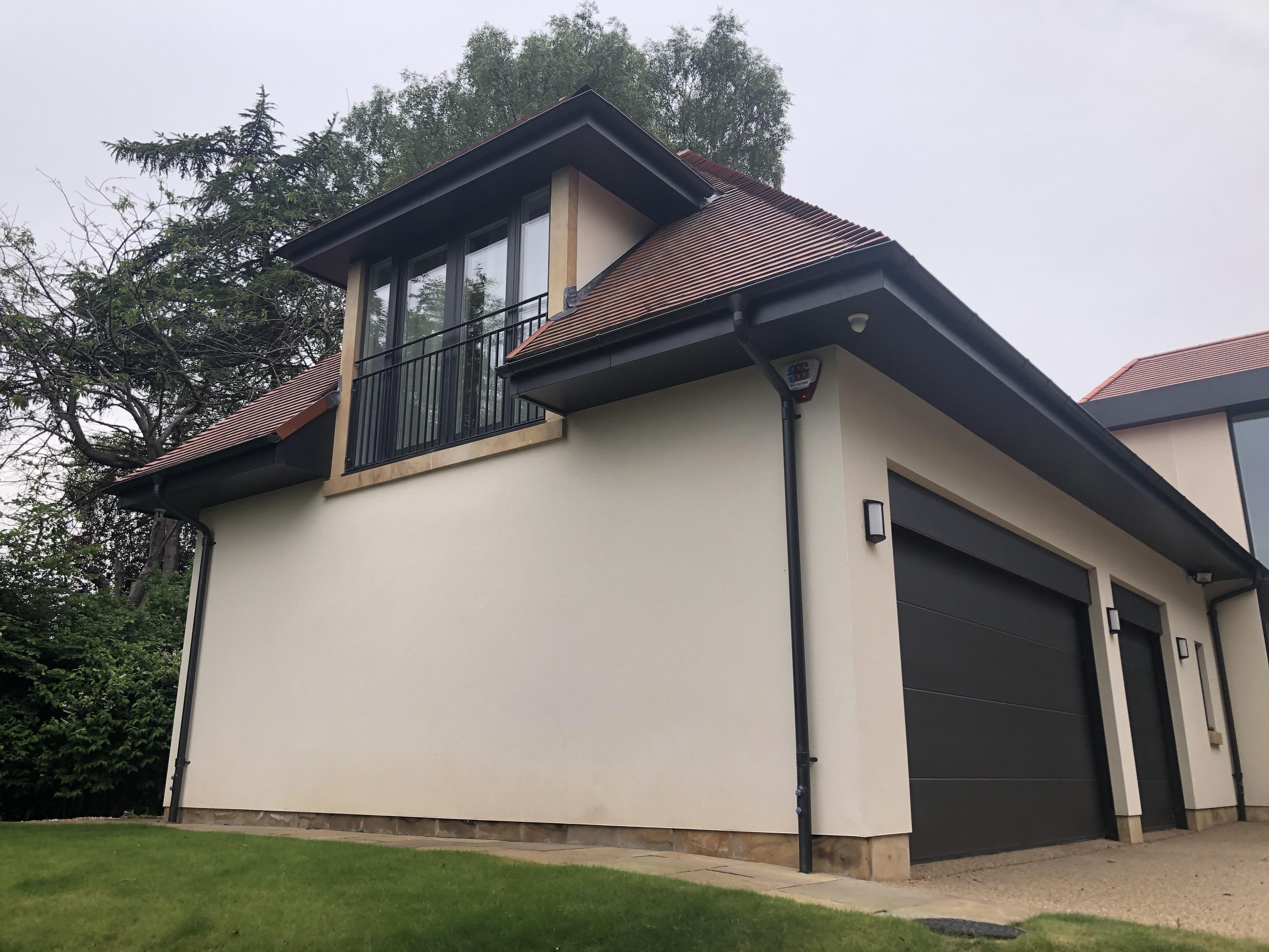

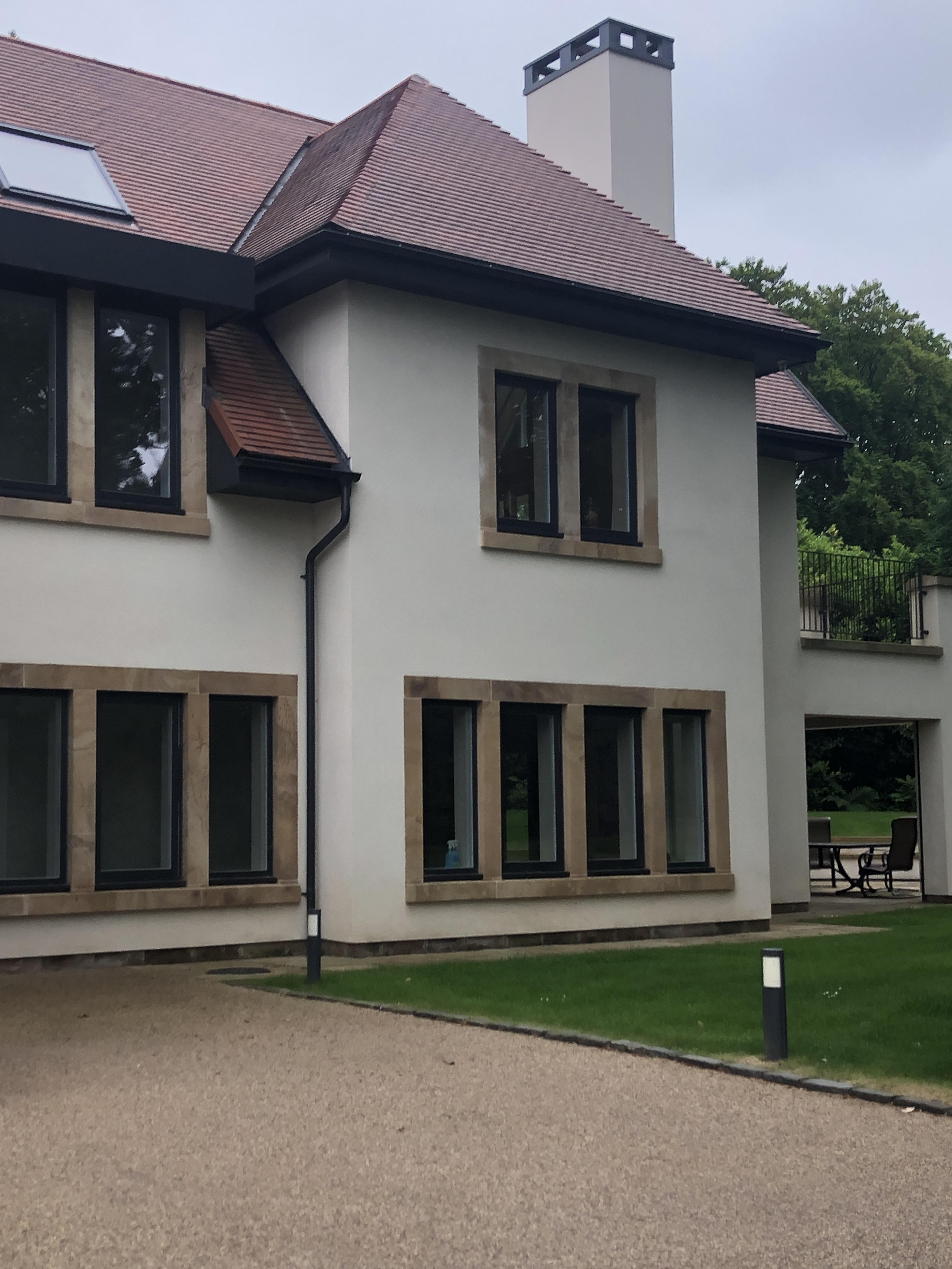

We are black and white.
Downpipes generally tucked into corners.
Why the tiny piece of roof?
But yeh looks like having black downpipes tucked in corners does 'contour' the shape of the house nicely.
