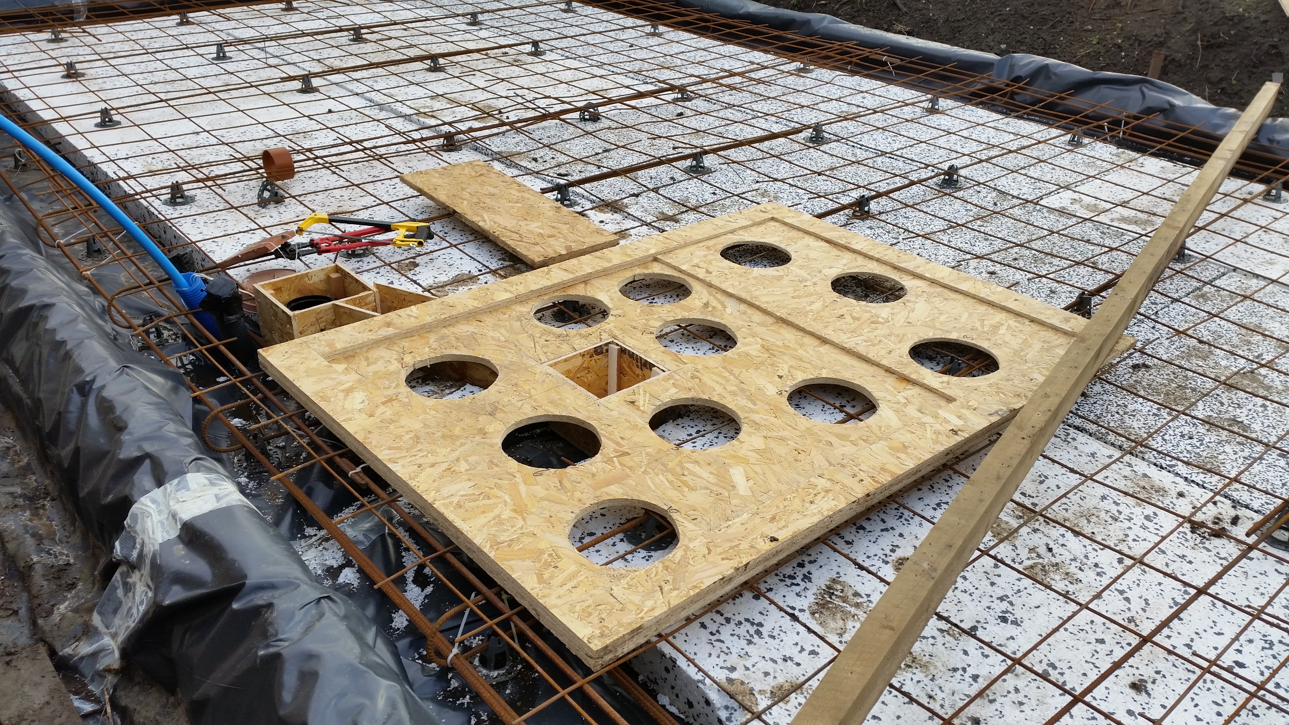

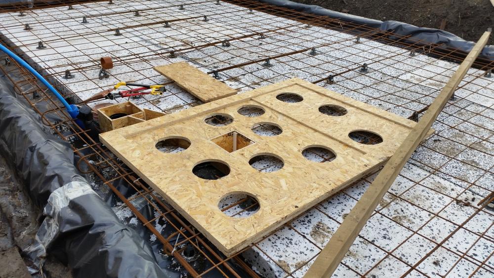

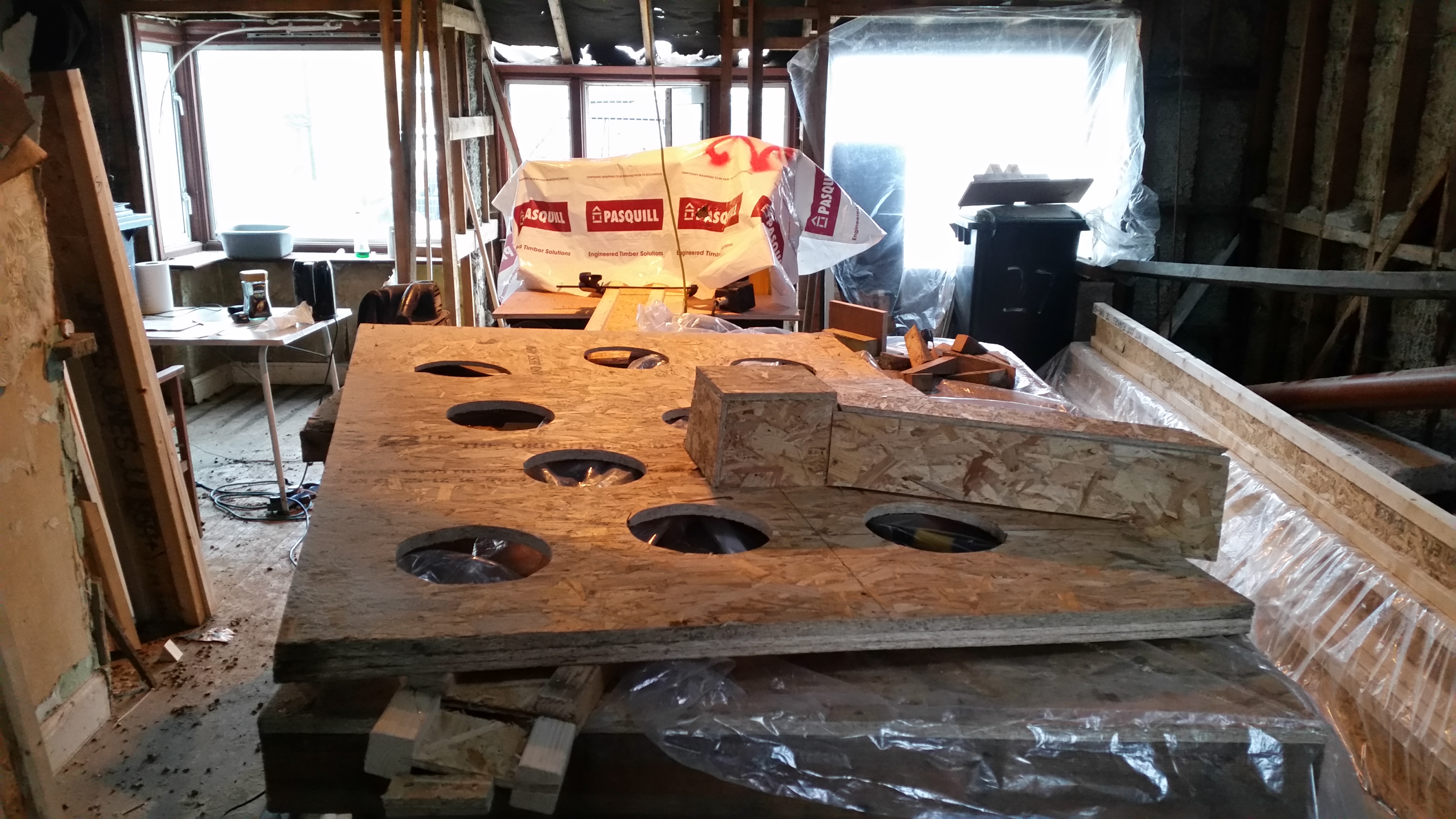

MikeSharp01 Posted March 12, 2017 Posted March 12, 2017 (edited) Here is the former I have made for our wet rooms 1200 x 1200 tray and 600 more of flat tiling (upside down here). Holes all have screw down plugs that will allow me to check the concrete in the slab is everywhere I want it and they will then be closed. The boxes are for the trap and the outfall pipe that runs to the main foul riser. All I have to do is ensure it doesn't float when we pour the concrete on Thursday. No UFH under the first one but there will be in the second one in the second slab where hopefully this former will get a second life - what ever happened to second life? Edited March 12, 2017 by MikeSharp01 Forgot image - doh! 2
Onoff Posted March 12, 2017 Posted March 12, 2017 18 minutes ago, MikeSharp01 said: Here is the former I have made for our wet rooms 1200 x 1200 tray and 600 more of flat tiling (upside down here). Holes all have screw down plugs that will allow me to check the concrete in the slab is everywhere I want it and they will then be closed. The boxes are for the trap and the outfall pipe that runs to the main foul riser. All I have to do is ensure it doesn't float when we pour the concrete on Thursday. No UFH under the first one but there will be in the second one in the second slab where hopefully this former will get a second life - what ever happened to second life? So...are there falls in that?
MikeSharp01 Posted March 12, 2017 Posted March 12, 2017 (edited) Once I lift the former the space for the pipe run across to the foul stack will be in free air until I back fill, once the tray, trap and pipe are in, and the levels do change - so yes, and I have tapered the sides of the former so I can get it out easily as well. It now has a sheet of plastic covering it to help it release as well - belt and braces. Might get a better idea from this, with it in place. Edited March 12, 2017 by MikeSharp01 Improve meaning a bit.
ToughButterCup Posted March 13, 2017 Posted March 13, 2017 Breaking ground today and your post is therefore particularly welcome. Help me @MikeSharp01 get my head round this, please.... In the photo above, the former shows how the foul drain is connected to the shower drain the holes in the former allow you to check that the concrete has flowed to the level of the bottom of the former and the final level of the concrete will be level with the top of the former The floor make up elsewhere will be (say) 25mm higher than the top of the former It's Monday, and I feel like a Bear-With-A-Small-Brain today. Have I got this right?

MikeSharp01 Posted March 13, 2017 Posted March 13, 2017 2 hours ago, recoveringacademic said: In the photo above, the former shows how the foul drain is connected to the shower drain the holes in the former allow you to check that the concrete has flowed to the level of the bottom of the former and the final level of the concrete will be level with the top of the former The floor make up elsewhere will be (say) 25mm higher than the top of the former It's Monday, and I feel like a Bear-With-A-Small-Brain today. Have I got this right? Hi Ian @recoveringacademic. The former is designed to be the full size of the wet room (1200 x 1600). The foul drain stack is, will be, connected to the shower trap by a short length of 40mm pipe on a slight - but correct, fall - the former creates a cavity in the slab for this to run through. As you say the holes in the former allow me to ensure the concrete is fully under the former then I close them up and Fill around the former to the top of the former which is flush with the finished (we are having a polished concrete floor) concrete surface so there will be no floor make up in our case. Where the shower tray goes the former is 42mm thick the shower tray unit, an AKW component (1200 x 1200), is 20mm thick leaving me 22mm for tiling on the tray to the trap unit which has a fall built into its 20mm depth. The remainder of the former is 22mm thick to provide a pocket for the tiles that will be 'on the flat' in the rest of the wet room. The wet room sole plate for the walls sits directly onto the polished surface around the pocket in the slab created by the former. Hope that helps, I have a section drawing back at base I can paste up to show you if you need more.
ToughButterCup Posted March 13, 2017 Posted March 13, 2017 1 minute ago, MikeSharp01 said: [...] Hope that helps, I have a section drawing back at base I can paste up to show you if you need more. That'd be so kind, Mike. Thanks Ian
MikeSharp01 Posted March 13, 2017 Posted March 13, 2017 2 hours ago, Onoff said: I'm struggling to see where the fall is tbh! There is no fall in the former as such because it creates a groove in the slab into which the outflow pipe will drop when the tray, with its associated trap is lowered into the pocket created by the former. I can then backfill under the shower tray with concrete if I wish around the outflow pipe.
ToughButterCup Posted March 13, 2017 Posted March 13, 2017 Ahhhh, right, click. You are creating a space in which to insert a ready made shower tray. Not creating a shower tray out of the concrete.... Told you I feel like a Bear-With-A-Small-Brain today.
Onoff Posted March 13, 2017 Posted March 13, 2017 (edited) 31 minutes ago, MikeSharp01 said: There is no fall in the former as such because it creates a groove in the slab into which the outflow pipe will drop when the tray, with its associated trap is lowered into the pocket created by the former. I can then backfill under the shower tray with concrete if I wish around the outflow pipe. Got it! Falls in the tray! Edited March 13, 2017 by Onoff Typo
