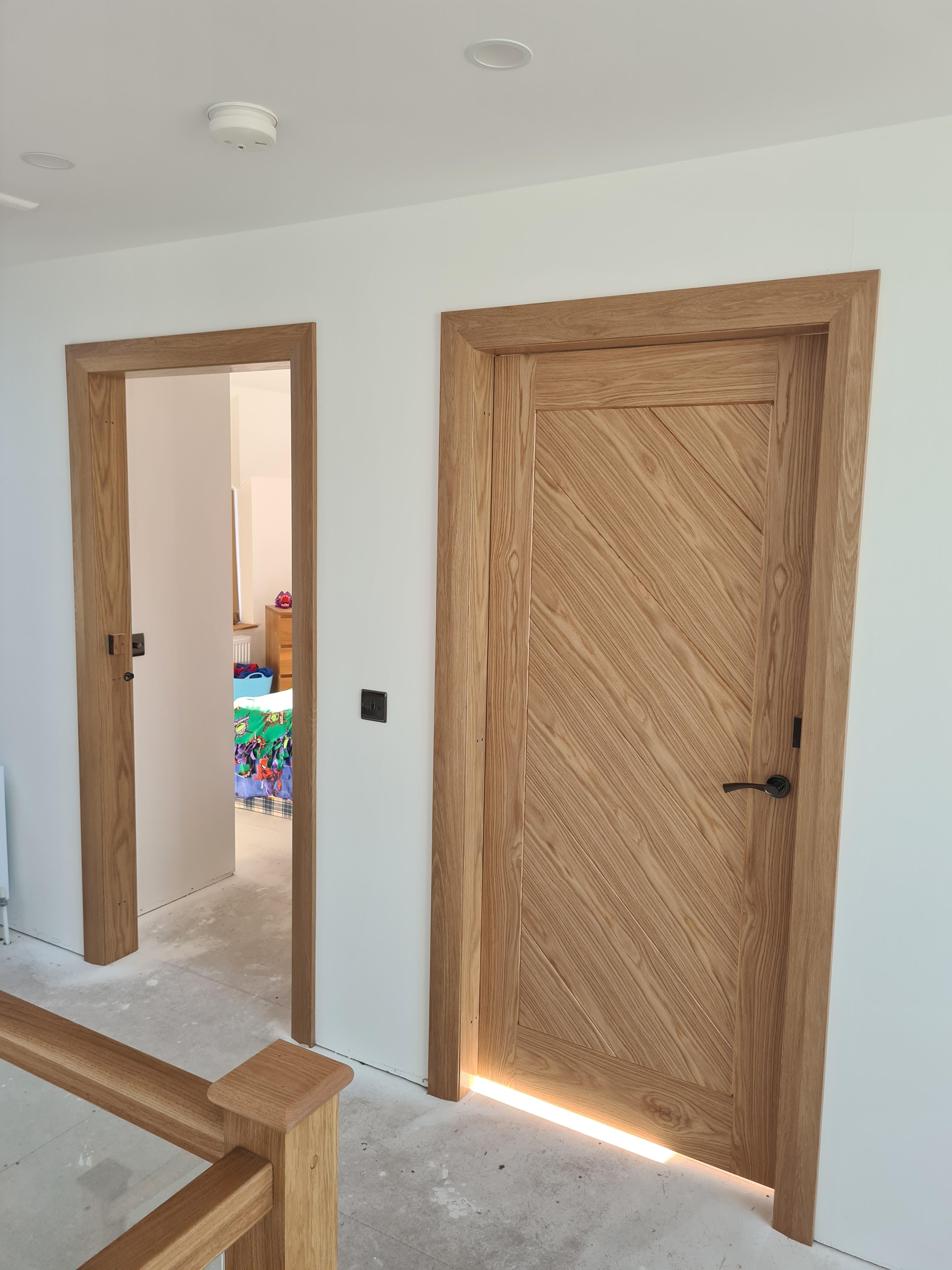

BMcN Posted June 19, 2021 Posted June 19, 2021 I went for oak veneer for all my architraves, skirtings and half my door casings (different wall thickness meant the veneered casing was not suitable for all openings). Stairs and window cills are real oak. All doors, architrave and skirtings are by Deanta. I think casings were around £40 - 50 ea. Architrave was only about £39 for a pair (enough to do both sides). Skirting was around £7 per meter. 1

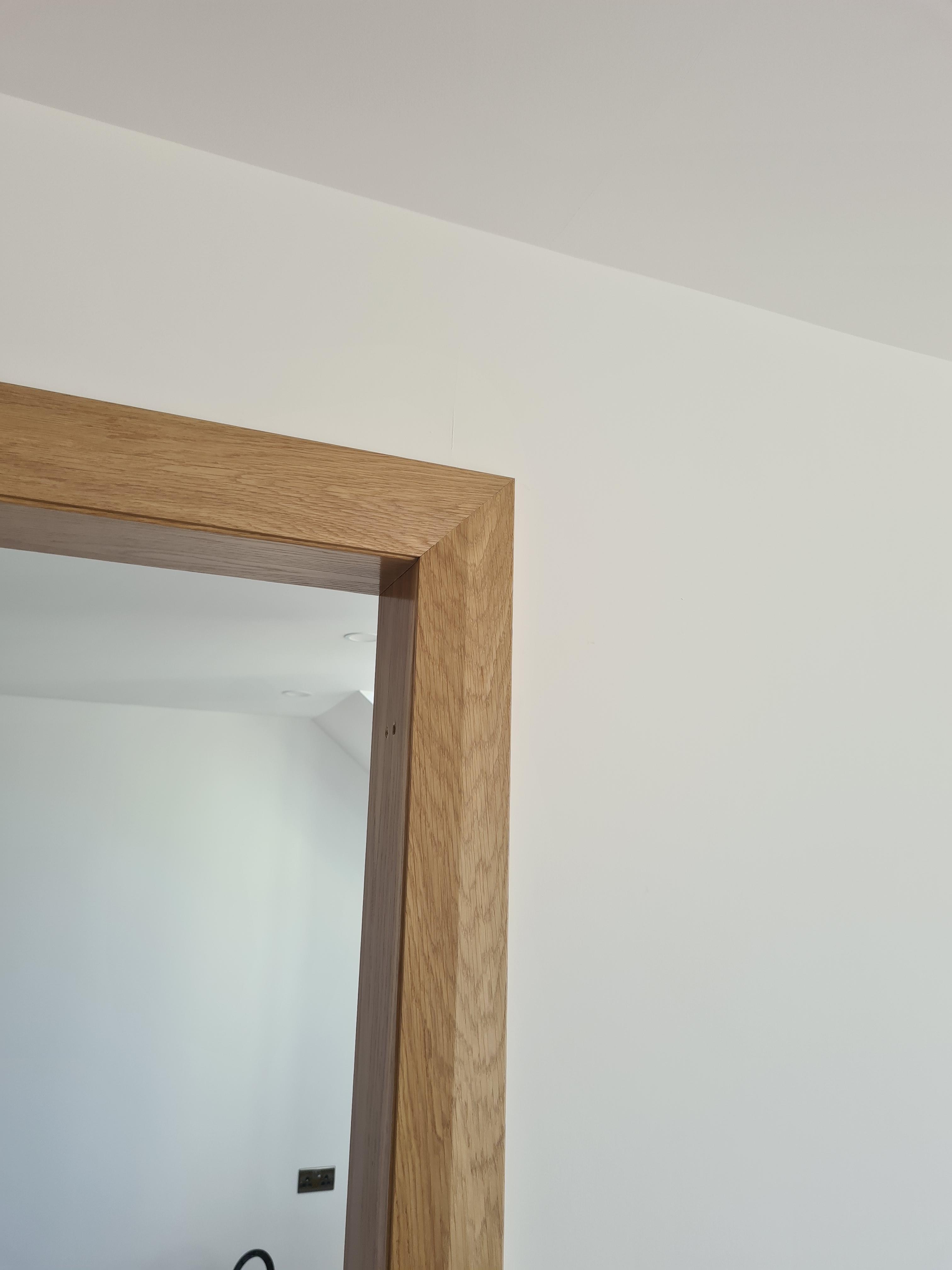

ProDave Posted June 20, 2021 Posted June 20, 2021 I got a bit creative. Upstairs door frames were made of left over engineered wood flooring, with oak veneered architraves. Downstairs, I made a structural door frame of chipboard (strips ripped from P5 flooring) and lined it with 3 lengths of 12mm thick planed Oak to give the finish I wanted. Again using veneered architrave. 1
