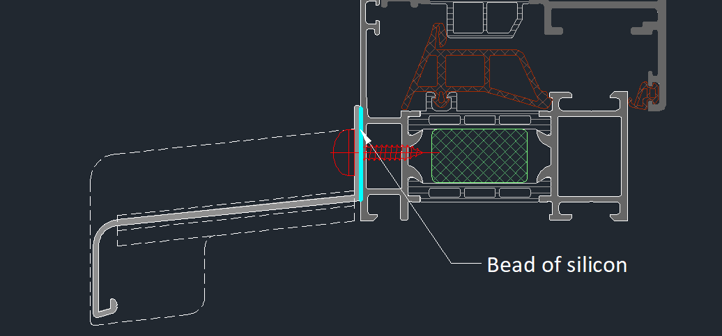

Adsibob Posted September 29, 2021 Author Posted September 29, 2021 By way of update, the window company agreed to replace the glazing units that were distorted. Even though I told them to make sure the glass is from a GGF supplier so that it complies with GGF guidelines, the distortion is just as bad. Really fed up of these idiots. I think I will have to end up suing them. They've made a bunch of other mistakes on some of the other windows, like not applying a sealant between the aluminium window frame and aluminium sill and we actually have a tiny amount of water ingress on the more exposed windows because of that. Seems like a pretty flagrantly stupid error to have made. Is it just a case of sealing the external join between window frame and sill, or should the whole frame be taken out so that two beads of sealant can be run in between the frame and sill?
craig Posted September 30, 2021 Posted September 30, 2021 23 hours ago, Adsibob said: Is it just a case of sealing the external join between window frame and sill, Depends on how the cill, is connected, if it is basically screw through the upstand to the window, then a bead of silicon should be applied. (quick example)
