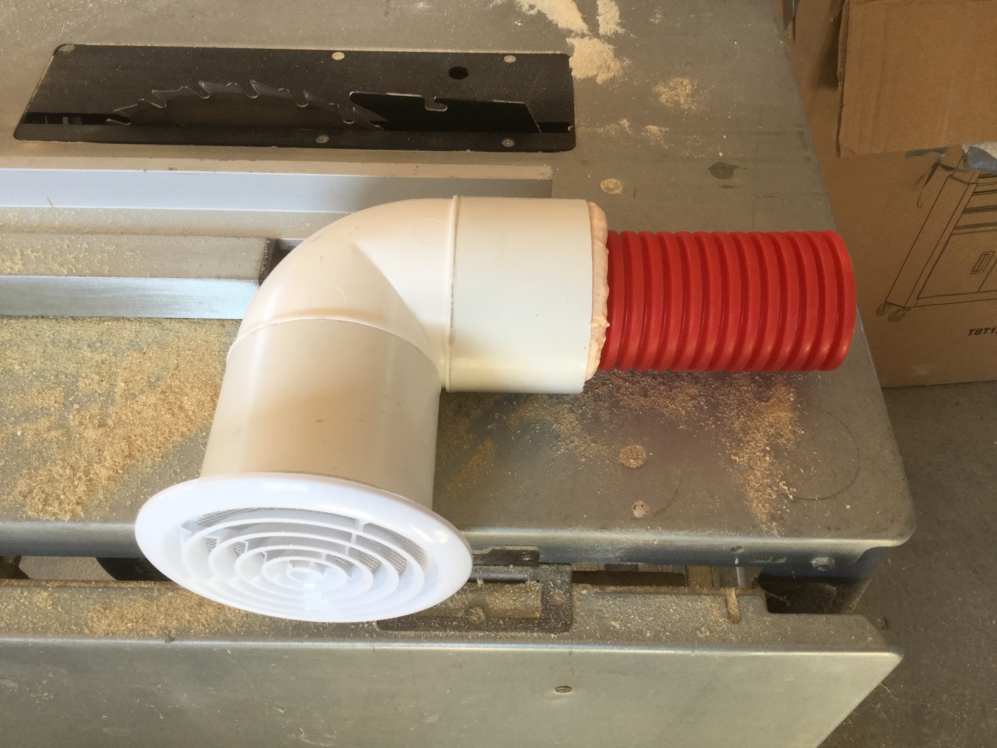

joe90 Posted July 7, 2017 Author Share Posted July 7, 2017 (edited) Sorry it's been so long but I have been on site for three weeks and have no broadband there yet. Here is a picture of my Heath Robinson room plenum, saved me about £20 each, and I need 9. I have started mounting the unit and will next show pics of the homemade manifold/silencer arrangement. Question, I have 5 supplies to rooms and 4 extracts and I was wondering that because I have a warm roof and heat rises is it worth putting another extract up to the ridge of the loft to recover any heat that finds its way to the highest point in the house ??. Edited July 7, 2017 by joe90 Link to comment Share on other sites More sharing options...

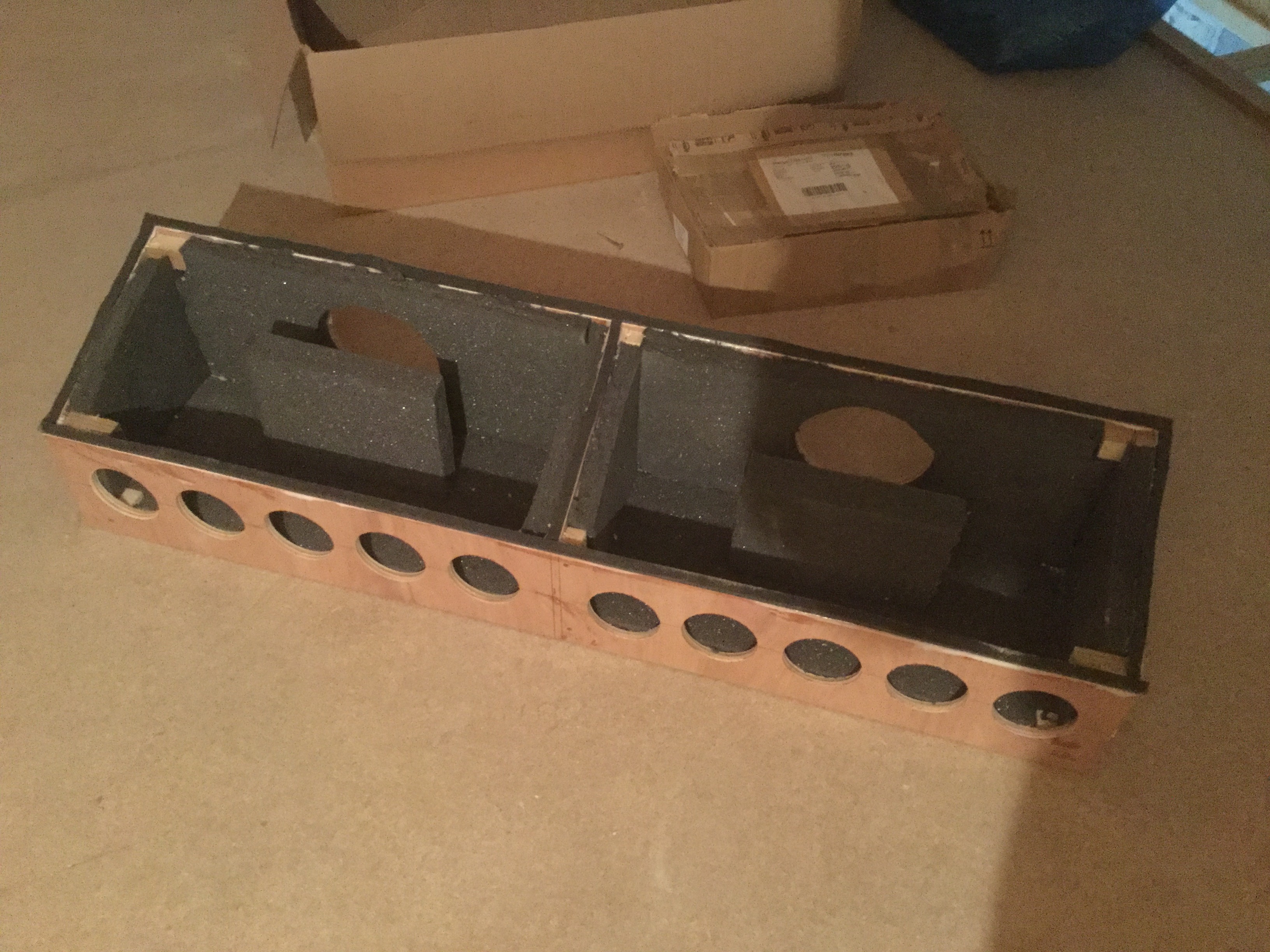

joe90 Posted July 12, 2017 Author Share Posted July 12, 2017 Well here is the homemade manifold/silencer, yet to fix in place but will update when I do. Notice the sound absorbing foam baffle, I recon less sound will transfer it has to go around corners !!!!! Link to comment Share on other sites More sharing options...
Barney12 Posted July 12, 2017 Share Posted July 12, 2017 On 07/07/2017 at 16:14, joe90 said: Sorry it's been so long but I have been on site for three weeks and have no broadband there yet. Here is a picture of my Heath Robinson room plenum, saved me about £20 each, and I need 9. I have started mounting the unit and will next show pics of the homemade manifold/silencer arrangement. Question, I have 5 supplies to rooms and 4 extracts and I was wondering that because I have a warm roof and heat rises is it worth putting another extract up to the ridge of the loft to recover any heat that finds its way to the highest point in the house ??. Out of interest. How will you join your flexible duct lengths? Or are you going to bond each one in at the end? Link to comment Share on other sites More sharing options...
joe90 Posted July 12, 2017 Author Share Posted July 12, 2017 Hi Barney, as per the picture I used pieces of foam to keep the pipe in the middle of the socket and bonded with expanding sticky foam , at the manifold it's a cable tie to hold it still and foaming glue to seal. Hopefully it will never need taking apart but if it does the one in the picture was simply cut apart with a Stanley blade and re fixed to the in situ pipe again. Heath Robinson it may be but it works ( and is a lot cheaper). More pics to follow ( when I am allowed up the pub again?). Link to comment Share on other sites More sharing options...
joe90 Posted July 18, 2017 Author Share Posted July 18, 2017 Well it's nearly all in ( pics to follow) one problem I have yet to deal with is how to control airflow per room from the manifold (I don't want to adjust airflow at the rooms), I think I read about knockout rings in proprietary manifolds but mine is DIY, ed. I could use the end caps from the flexi pipe and cut holes in them but don't have enough, has anyone got quiet vent pipe ends that come on the roll to stop muck getting into the pipe?????, I will pay for postage. Link to comment Share on other sites More sharing options...
