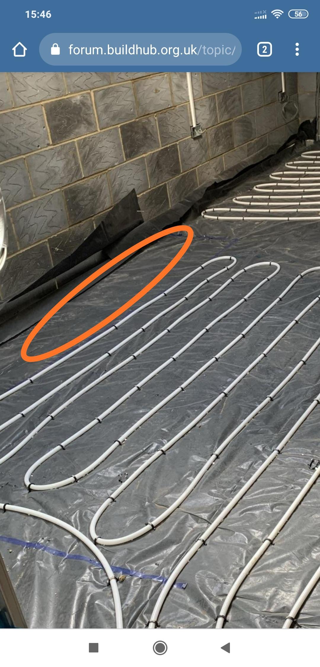

Vera16 Posted June 15, 2021 Share Posted June 15, 2021 Hi, new to this site. I am renovating on older property and have installed a solid floor in the old part of house and new extension (concrete base + 150-200mm celotex + UFH + screed). I'm worried about the screed as it has cracked near the door. Apparently this is normal when a large door is installed but I measured the cracked part and it is only 30mm. Difficult to guage the depth of the rest of the floor (although measured less than 50mm in another part) but I'm worried....should I be? Also the screed appears to have large aggregates in it. Is this normal? Link to comment Share on other sites More sharing options...

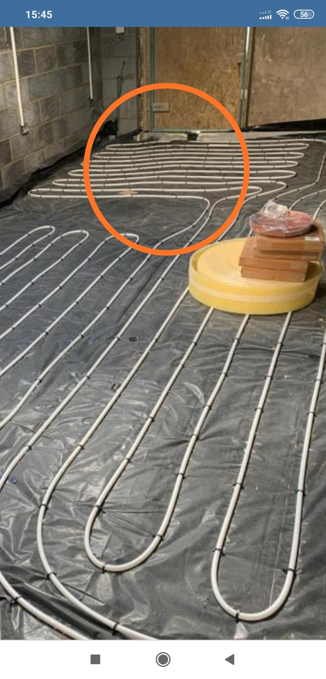

Cpd Posted June 15, 2021 Share Posted June 15, 2021 How level is the area ? Did you get the correct up stands put in ? Do you have some better photos of the whole area before the screed went in and after ? I am no expert but it might help people give better advice. Link to comment Share on other sites More sharing options...
Vera16 Posted June 15, 2021 Author Share Posted June 15, 2021 (edited) Before and after. Upstands are in. And edging strip although coming out in places. Edited June 15, 2021 by Vera16 Link to comment Share on other sites More sharing options...
Declan52 Posted June 15, 2021 Share Posted June 15, 2021 On this pic there is Def something wrong with the ufh pipes. You can see they aren't sitting flat with a very noticeable bump. Was there subfloor beneath the insulation not left flat and smooth. Get a hammer drill and drill through the subfloor at this point. Going by the pics you should be enough away from any ufh pipes. If this is 30mm then it's up to you. Digging it all out will damage the ufh pipes though which will need redone. How much height is there between the floor as it sits now and the bottom of the door. If you have 30mm you could rough the floor up with a hammer and bolster,apply a primer and put more concrete on it. You can also use self leveling compound that has fibres in it for this depth. Link to comment Share on other sites More sharing options...

Vera16 Posted June 15, 2021 Author Share Posted June 15, 2021 (edited) The sub-floor is not beam and block it is a concrete slab. I think a lot of the issue is with the insulation layer. It was VERY rocky when I walked over it which likely explains the lumpy appearance. I did question this at the time time but was told the screed layer would stabilise everything. I wanted to tape it but there was so much movement in it I'm not sure the tape would have held. There were also some large-ish gaps. I really should have put my foot down at this point (but it gets tiring complaining about every single thing). 5 hours ago, Declan52 said: Get a hammer drill and drill through the subfloor at this point. Going by the pics you should be enough away from any ufh pipes. If this is 30mm then it's up to you. Digging it all out will damage the ufh pipes though which will need redone. This is a good idea. There isn't a huge amount of room under the door frames for extra layers. Edited June 15, 2021 by Vera16 Link to comment Share on other sites More sharing options...
James Newport Posted June 15, 2021 Share Posted June 15, 2021 Where did the 30mm piece of screed come from in your pictures? it looks as though it slopes a bit in front of those chipboard doors, but it’s difficult to tell from the photos. A metal ruler pushed down in the gap between wall and screed till it touches concrete or insulation might let you gauge the depths at strategic points around the floor Link to comment Share on other sites More sharing options...
