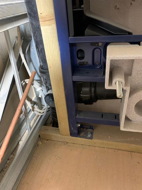

  3. Bought a toilet 'bargain' on eBay which was advertised as wall hung. When it arrived (and after last return date) I realised it was back to wall. The frame is already plumbed in... can I use the same frame for a back to wall toilet? Assuming the floor height, and soil and flush pipe line up?

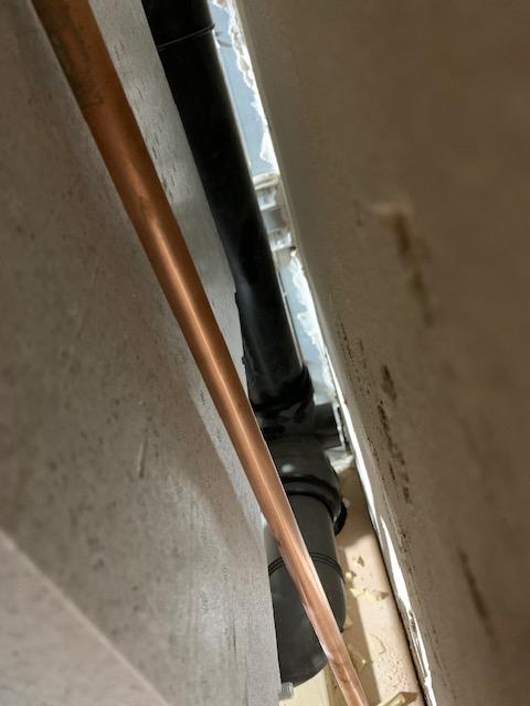

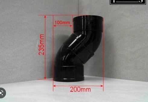

  4. This is the kind of thing I was thinking of. I can't do much else with the layout as the toilet has to go into this space. The wall is brick (single skin) with a 20mm lime plaster layer on top. I am looking at offsetting the soil pipe back into the wall (or even just against the wall - currently it is sitting a few cm out). Maybe some thing like this could work? The soil pipe is the main issue I think. If this was resolved I could use something like Nick suggested. Or go for a floor standing toilet if the bottom bracket of the wall hung frame is getting in the way of the soil pipe.

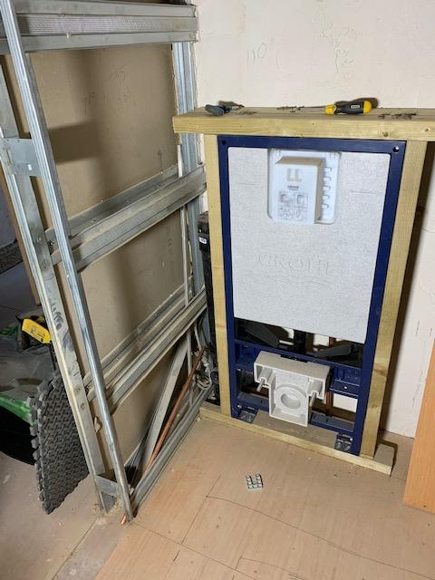

  5. Specified a wall hung toilet which I thought would fit neatly behind the the pocket door. In reality the frame and boxing is 21cm from the wall (solid brick wall) leaving me only around 50cm for the pan (bringing it all the way up the door - not ideal). I need to re-think how the reduce the projection of toilet but I'm limited by the 4in waste pipe sitting slightly away from the wall (it comes up from downstairs inside the house). Any recommendations for best way to tackle this? One option is a close coupled toilet but I was planning for a bidet toilet and most/all are floor standing or wall hung. Also considering a floor standing back to wall and trying to somehow curve the waste pipe into the wall (the plaster layer is around 20mm so can shave off a bit).

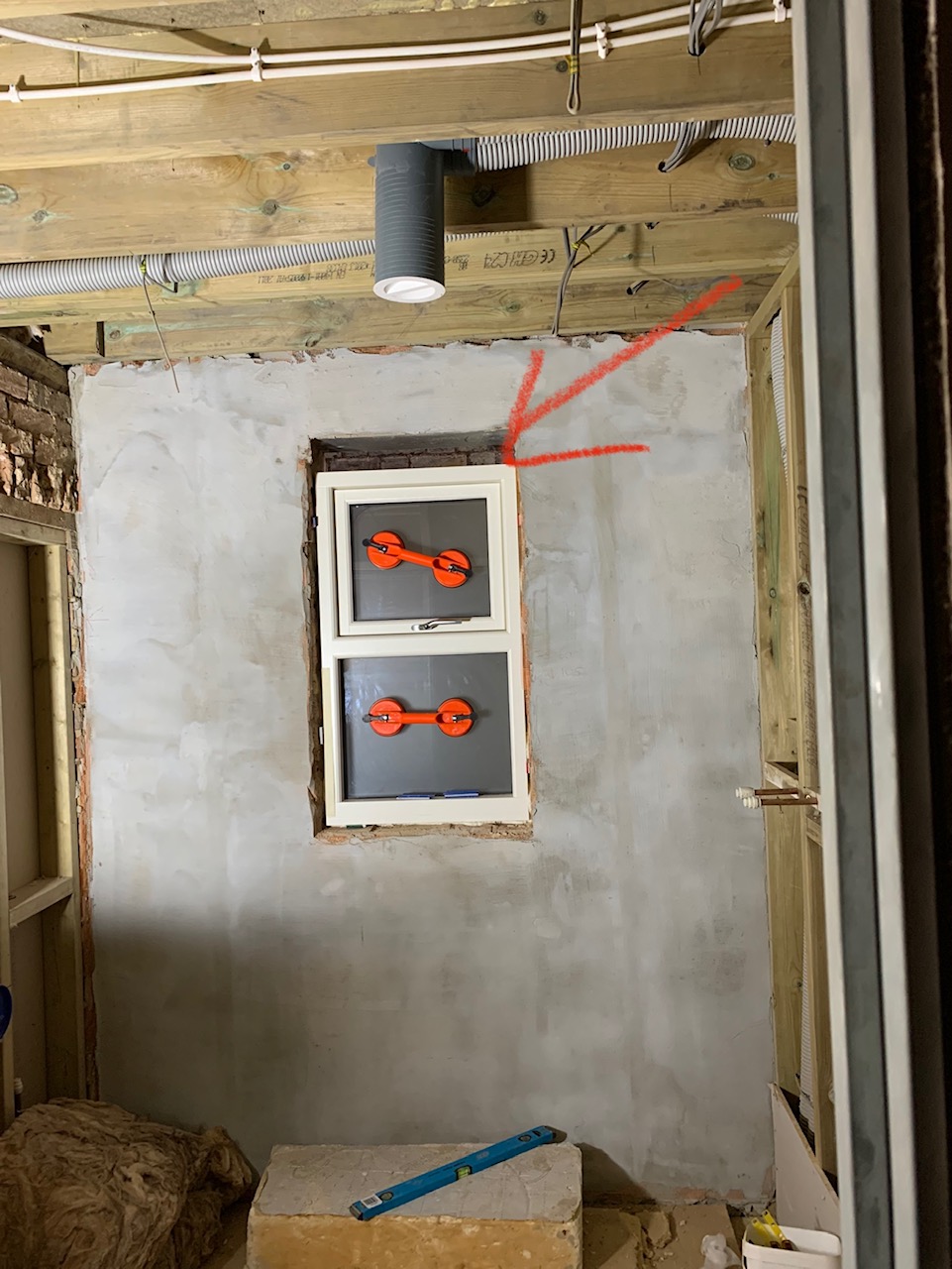

  8. For whatever reason (have parted company with builder so...) the window measurement was 10cm out and I have a huge gap under the lintel. I am considering the best way to fill this? The plus side is the window will not be very visible from the outside as it looks out onto a narrow passageway. I am think of glueing a block of wood painted in the same colour and then foaming to fill the remaining space. Does this sound sensible?

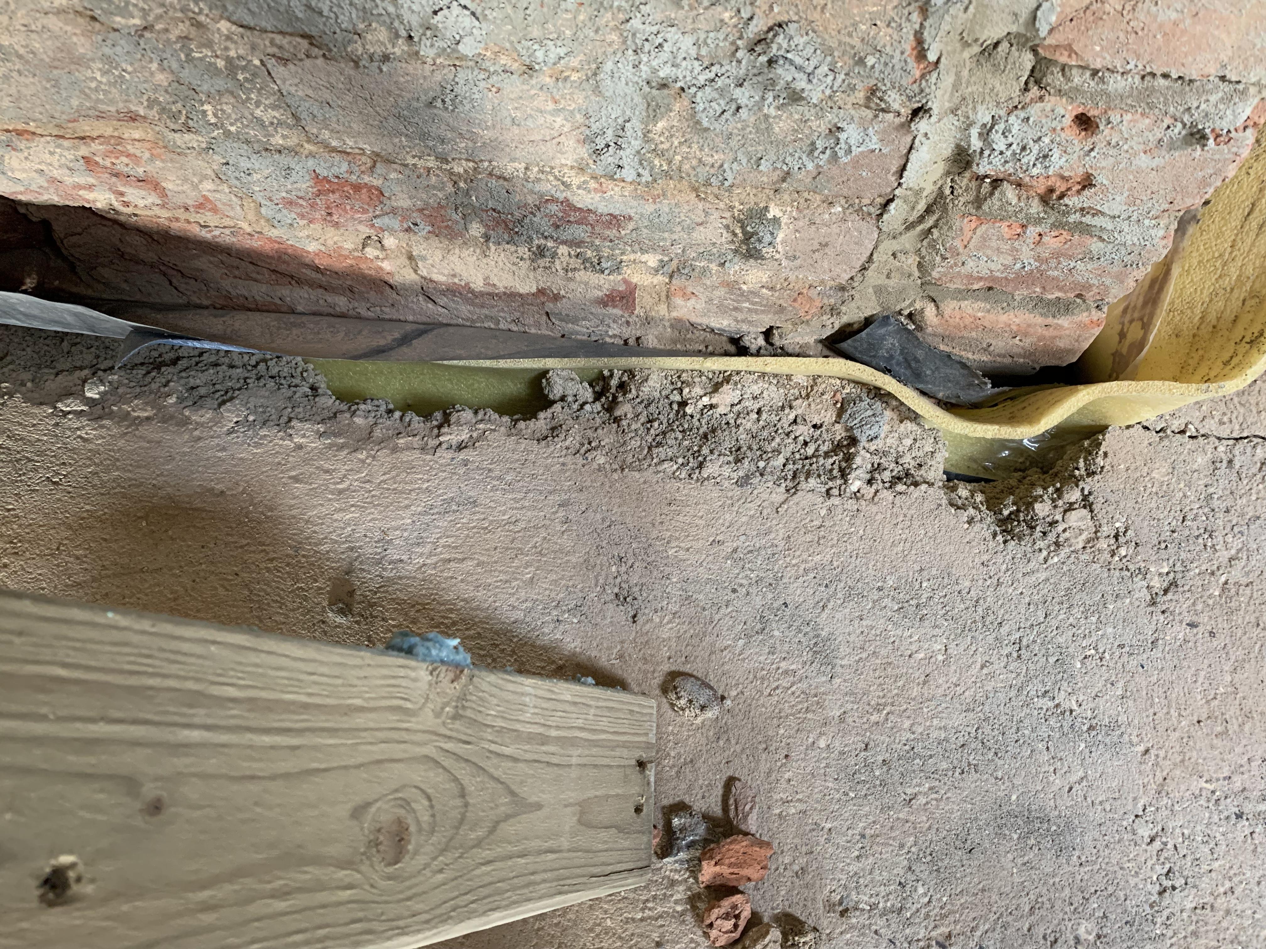

  10. Having problems with my screed floor in kitchen extension. At one end it was too thin (30mm) and cracked so builder took up that part. More cracks have since appeared even in thicker parts (see right of photo) and today I unwittingly hoovered a big hole into one edge! Is it normal that you can hoover up crumbly patches at the edge??
