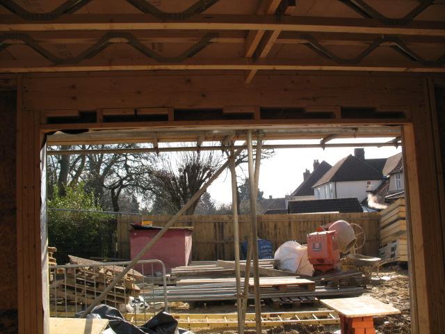

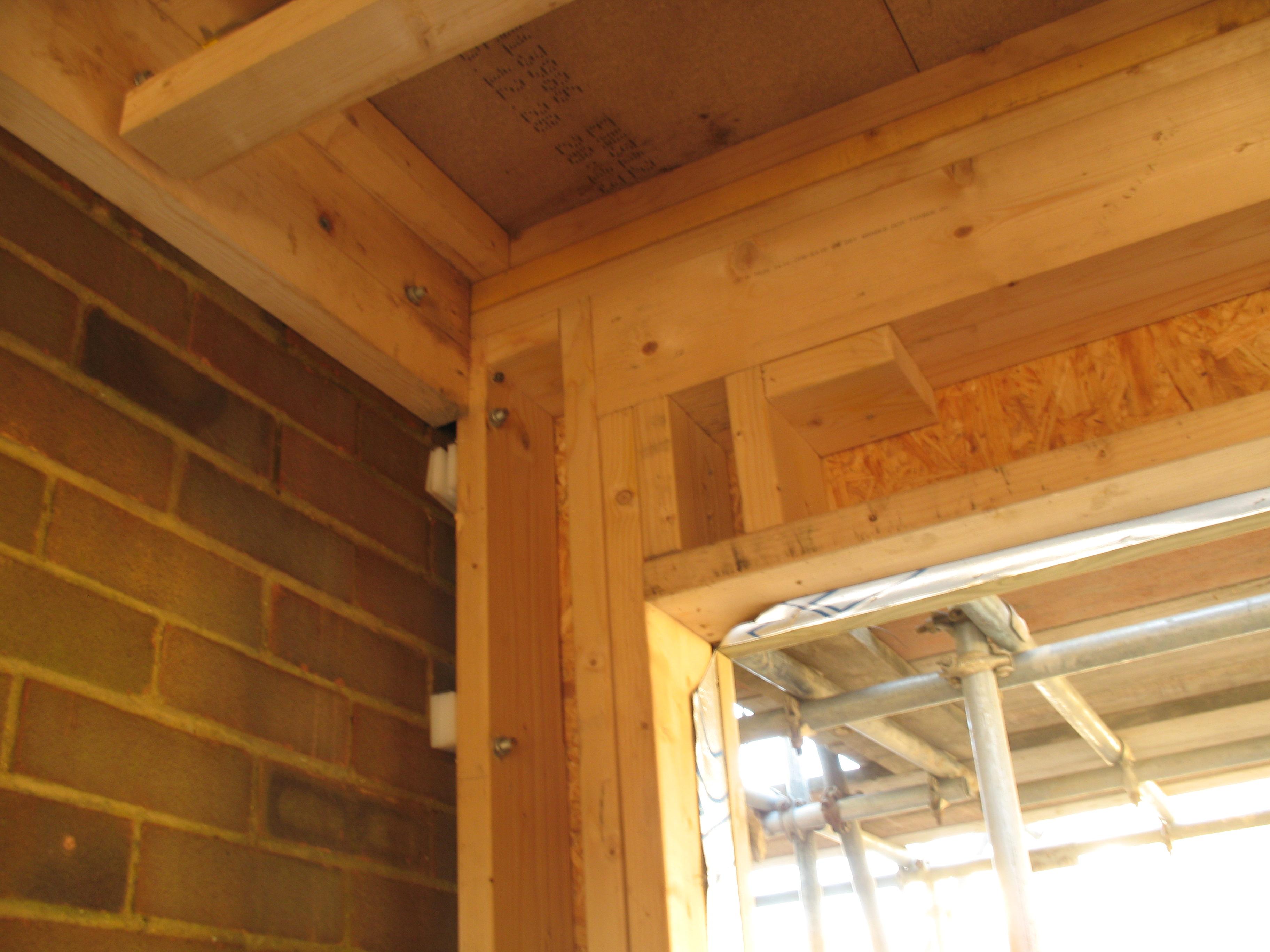

SillyBilly Posted June 13, 2021 Share Posted June 13, 2021 I am ordering materials for a self-build annexe. The studwork is eased 47x150 which I am told is reduced in each dimension. I am puzzled as to what to use for the timber lintols. I was planning to use 3-plys of the same as the studwork bearing on 1 stud for 1200mm openings, on 2 studs 1800mm, and 225mm bearing on 3-studs for an opening of 2700mm. I have attached 2 pics showing my concern. My Builders Merchant has standardised on eased timber which leaves a gap as in a picture taken from the construction of another house. The alternative is to find a stockist of non-eased kiln dried lumber which would give a 3-ply lintol as in second picture. What do people recommend. Is the gap allowed? Link to comment Share on other sites More sharing options...

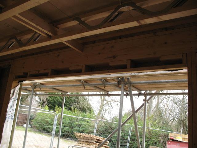

SillyBilly Posted June 13, 2021 Author Share Posted June 13, 2021 1 hour ago, Russell griffiths said: I doubt very much if you can use timber over the 2700 openings, I think it will need to be steel, the deflection in timber will be huge. I also don’t think the 150 deep timber will be enough for any of the openings, the strength is in the depth of the timber, I would have thought 225mm would be better. I am studying an actual construction of 4 houses. Pics from 2 of these show the 225mm 3-ply timber lintels over 2.7m openings Link to comment Share on other sites More sharing options...

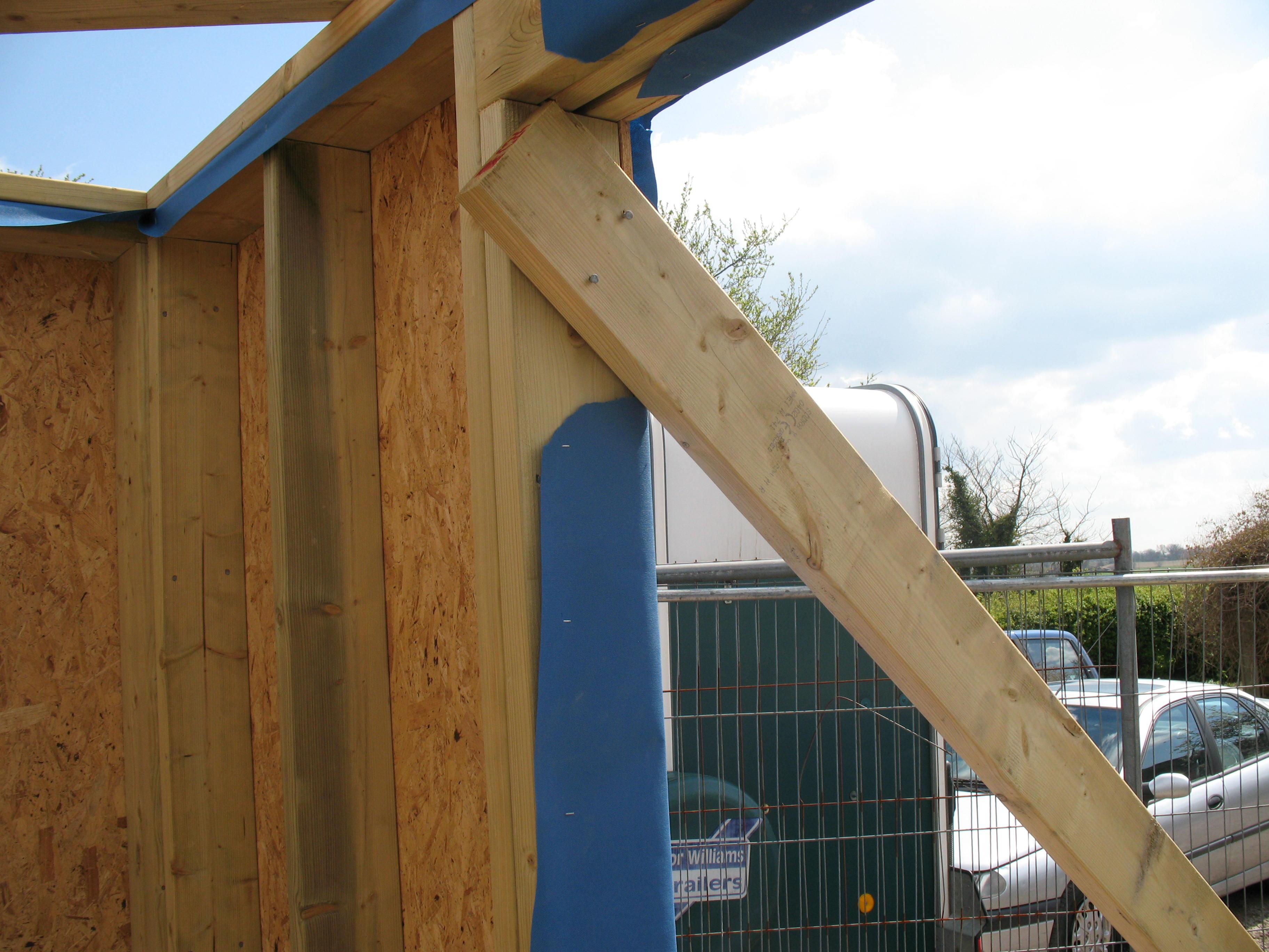

Russell griffiths Posted June 13, 2021 Share Posted June 13, 2021 (edited) 3 hours ago, SillyBilly said: I am studying an actual construction of 4 houses. Pics from 2 of these show the 225mm 3-ply timber lintels over 2.7m openings Maybe, but that doesn’t make it right. Have a look at a topic on here of window heads deflecting and stopping the sliding doors working. Looking at those pics,there’s not a lot I like really, just stand issue poor timberframe construction. If your happy following that then then just rip a plywood packer to make up the difference. Edited June 13, 2021 by Russell griffiths Link to comment Share on other sites More sharing options...
SillyBilly Posted June 13, 2021 Author Share Posted June 13, 2021 Hi, I take your point but both examples were on architect designed houses and had BC approval. In my case the 2.7m window will be in a single storey lean to part of the extension so deflection isn't a concern to me. With my builders merchant only stocking eased regularised KD timber I need to know what to search other suppliers for. What standard size timber headings would have been used in the gapless case in my first pic? I have already faced inflationary rises in my project which is why I am trying to order the timber Link to comment Share on other sites More sharing options...
Nickfromwales Posted June 13, 2021 Share Posted June 13, 2021 Also note the additional shoulder of stacked vertical timbers taking the downward forces at the ends of the lintels . A very important detail. 3 a side in one of the pics. If it were my house, it would be steel without hesitation. That can sit atop the same shoulder of timber uprights, so only very minimal uplift in cost, but belt and 15 braces if flying over large sliders. Link to comment Share on other sites More sharing options...
Temp Posted June 13, 2021 Share Posted June 13, 2021 Timber lintels were used for hundreds of years and many modern buildings use laminated timber. They can work fine if correctly specified but thats the issue. Normally the designer would specify the make up of the lintel laminations and how they are fixed together and supported at the ends. Those details are important. 47 x 150 Eased is typically 45 x 145mm. So three would be 135mm with a 10mm gap. I wouldn't think its an issue as less than 7 % gap but we are comparing varieties of apple when the designer might require bannas. Who has checked 3 x 47 x 150 is adequate? Its not good to rely on the BCO. 2 Link to comment Share on other sites More sharing options...

Gus Potter Posted June 14, 2021 Share Posted June 14, 2021 (edited) Hello SillyBilly. Well done picking up on the arrangement and timber sizes. In pic two at the top of the thread you can see there is a gap between the outer ply and the two inner ones. Now it may be that the two inner timbers are enough to carry the load and the outer one is just a "filler". But when you design timber lintels you can "enhance" the strength and stiffness in recognition that the plys are acting compositly.. together. For example in the BS code you can increase the capacity of the timbers in bending say by ~10% and the stiffness of 3 plys by ~21%. The "strength" part is to do with making sure the timber does not "break" under load".. the stiffness property (Young's modulus.. E) is to do with how much the timber will bend. Members posted a while ago about this and deflections over the heads of bifolds / sliding doors a while ago in the thread " Issues with sliding doors" Some of that post be be of use to you. Link here The key here is to recognise that to get an extra bang for your buck the lintels need to be fixed together (no gaps) say with 4.5 x 100mm galvanised nails top middle and bottom at 300mm horizontal centres. If you are using say a C16 / 24 timber grade then the overall thickness will be ~ 135mm and as Russell says you can use a timber ripping on the inside to make the wall flush on the inside for the plasterboard. This is common practice. If your flat roof joists don't span onto the timber lintels then 3 ply 225 x 45 timbers effectively spanning say 2.8m ( 2.7 + 1/2 rest) supporting say typically a 1.0m wide strip of flat roof (only) has a good chance of working with an over all deflection of some 6mm. Some of that will take place under the self weight of the roof before you fit the doors, the rest due to roof access loadings, snow and a bit of creep in the timber. Edited June 14, 2021 by Gus Potter 2 Link to comment Share on other sites More sharing options...

SillyBilly Posted June 15, 2021 Author Share Posted June 15, 2021 Turns out Howarth-Timber don’t have any sawn non-eased timber so it will have to be a ply infill. Quoting Craig The key here is to recognise that to get an extra bang for your buck the lintels need to be fixed together (no gaps) say with 4.5 x 100mm galvanised nails top middle and bottom at 300mm horizontal centres. If you are using say a C16 / 24 timber grade then the overall thickness will be ~ 135mm and as Russell says you can use a timber ripping on the inside to make the wall flush on the inside for the plasterboard. This is common practice. If your flat roof joists don't span onto the timber lintels then 3 ply 225 x 45 timbers effectively spanning say 2.8m ( 2.7 + 1/2 rest) supporting say typically a 1.0m wide strip of flat roof (only) has a good chance of working with an over all deflection of some 6mm. Some of that will take place under the self weight of the roof before you fit the doors, the rest due to roof access loadings, snow and a bit of creep in the timber. My extension is to have a timber single storey section in which there will be a 3-panel 2.7m sliding (not bifold) door in a 5.3m timber wall. The roof loading will be modest as there will be a 30deg warm roof with edpm not tiled top. Some of the rafters at 600mm centres will bear on the lintel. Can you hazard a figure for the deflection if I glue and screw the 3 plys? Link to comment Share on other sites More sharing options...

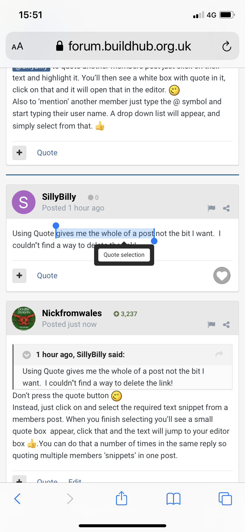

SillyBilly Posted June 15, 2021 Author Share Posted June 15, 2021 Using Quote gives me the whole of a post not the bit I want. I couldn''t find a way to delete the link! Link to comment Share on other sites More sharing options...
Nickfromwales Posted June 15, 2021 Share Posted June 15, 2021 (edited) 1 hour ago, SillyBilly said: Using Quote gives me the whole of a post not the bit I want. I couldn''t find a way to delete the link! Don’t press the quote button Instead, just click on and select the required text snippet from a members post. When you finish selecting you’ll see a small quote box appear, click that and the text will jump to your editor box ?.You can do that a number of times in the same reply so quoting multiple members ‘snippets’ in one post. Edited June 15, 2021 by Nickfromwales 1 Link to comment Share on other sites More sharing options...
