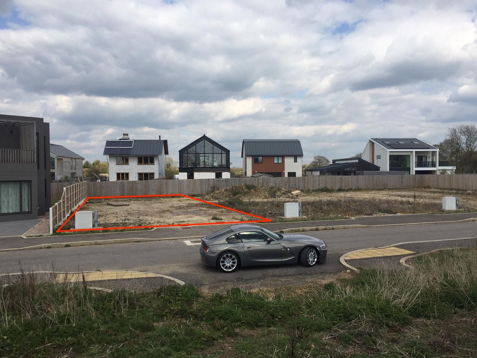

Saul Posted June 6, 2021 Posted June 6, 2021 I appreciate this is a very subjective question but I have been informed that the plot I am interested in buying will require Pile Foundations. I am awaiting Soil Survey documents that were completed in 2016 but it is known that this is poor Oxfordshire soil with extremely high clay content. The plot is level and access is great but those are about the only positive signs. I am planning on a 130sqm 2 storey Timber Frame house so nothing too dramatic. Graven Hill anticipate that the cost would be £70k which sounds absurdly expensive to me. That is also based on waiting for all 6 plots to sell and doing the Piling simultaneously. Anyone care to offer a ball park range of what might be a more typical cost for pile foundations, perhaps screw pile foundations to cut down on machinery needed? Thanks Saul

Saul Posted June 6, 2021 Author Posted June 6, 2021 44 minutes ago, Russell griffiths said: Is £70 for the piles or finished floor at dpc level. My costs. Excavation work £6000 pile mat £1500 Piles £12,000 ringbeam £12,000 blockwork £3500 floor beams £4000 block infill £1500 Labour £6500 that was then ready to stick the icf house on top. Piles went down to 6m house size 240m. It's Golden Brick price so presume it is to DPC. I had been working on a £40-45k basis but they said there was no chance it would be that low. The DanWood house was apparently £70k a few years back on the same strip. I'll be contacting HexHomes to see the kind they had. Having said all that GH have an insane timescale planned which means it would be years before I got to build so unless I can buy the plot independently of Golden Brick it's a non-starter.

Saul Posted June 9, 2021 Author Posted June 9, 2021 23 hours ago, PeterW said: Not necessarily and depends on the type of clay and the depth. Lots on Graven Hill don’t have anything other than standard foundations so I doubt it’s that deep anyway. The plot is out by Foundation Sq so very different to the rest of the main site. A show home builder was quoted £69k for piled foundations by RM back in 2016 and GH expect the Hoare Lee price to be be circa £70k. I know you never know what you're dealing with until you actually break ground for real but I can't go anywhere near £70k with a £220k plot price + a hopeful £1500per sqm for 130sqm for a house that might be worth £450-500k... Back to Square 1
