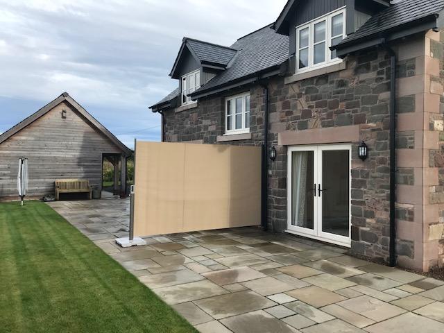

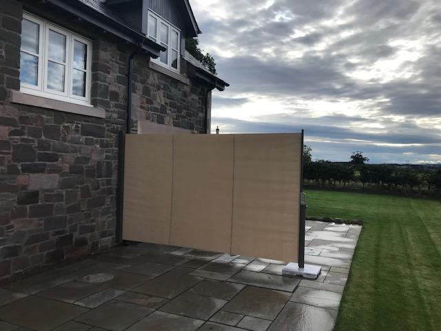

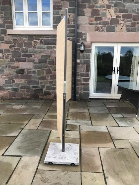

@Stones Bringing this thread up to date a touch, as we have finally had our "windbreak" - side awning installed. It was installed today some 8 weeks after the 8 week lead time we were given at the time of the order. As a result, we are unlikely to get much use out of it for what remains of this year but hey ho.
The photos show it in place and I had tried to capture the "bellow" - the wind at the time was what I would describe as a gentle breeze.
