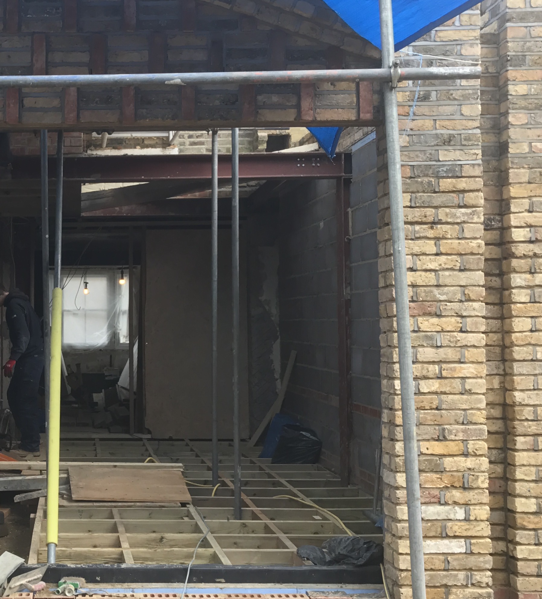

jayroc2k Posted March 7, 2017 Posted March 7, 2017 I have costed OSB 3 T&G and it is £100-150 cheaper than 18mm plywood for structural floor on ground floor joist. Is the £100 worth saving? i just want a floor that does not Squeak. The builder went over board with noggin so the joists have a solid timber noggin almost every 800mm. Whole joist looks like lots of square boxes. All joist in C24 47x150 timber thanks
Crofter Posted March 7, 2017 Posted March 7, 2017 Why not just use chipboard? You could probably go up to 22mm and still work out cheaper.
Onoff Posted March 7, 2017 Posted March 7, 2017 22mm T&G chip with Spax floor screws. Solider than a solid thing and no squeaks.
Cpd Posted March 7, 2017 Posted March 7, 2017 (edited) Wow that looks like your preparing to park a tank in there..... i cant help on which material to use but i have used a "no squeak" silicon on top of joists before gluing and screwing them down and it worked very well, more money though. I used 22mm chip on the above. Edited March 7, 2017 by Cpd Forgot something....
Barney12 Posted March 7, 2017 Posted March 7, 2017 +1 on the 22mm chipboard. Glue the joints if you want to make the whole thing bullet proof. Or brush a PVA solution into the joints afterwards. Don't be shy on the screws!
jayroc2k Posted March 7, 2017 Author Posted March 7, 2017 Thanks. Floor build up has been designed with 18mm floor boards in mind. Chipboard is only £20 cheaper than OSB
PeterW Posted March 7, 2017 Posted March 7, 2017 22mm P5 Chipboard, glued to the joists and then joints glued. Screws (not nails) every 300mm, and at 50mm of a join. It will be moisture resistant and also solid and squeak free..! OSB is too rough to use as flooring, and ply is overkill UNLESS you are laying tiles on it. If it is being tiled, go for 18mm P5 Chipboard then overlay with 6mm ply fully bonded and screwed to the deck below.... I take it you've no pipe or wiring runs to do in that floor otherwise the plumber and sparky are going to hate your bricky... 1

jayroc2k Posted March 8, 2017 Author Posted March 8, 2017 Thanks 18mm T&G ordered from buildingdepot for cheap. Will ask builder to screw it down i may have been over thinking this. As with all things relating to the renovation!
