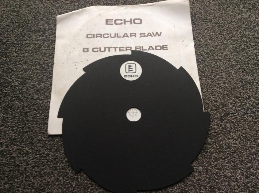

Don’t do it, the slightest off balance will wreck your body, and you won’t notice until next day when you wake up in pain.
Cover the postage and I will send you a spare brand new blade that I have for free.

OMG, use a proper blade, a brush cutter blade has (should have) been designed to limit the amount of grab.
Posted

I could be wrong but the one @Roys has kindly offered has maybe a 14mm bore. I think the Einhell one is 25.4mm?
Posted
The bore is 25.4mm and the diameter is 255mm on the Echo blade.
Posted
? Ah, in that case then I'd very much like it if that's OK. PM incoming. Cheers.

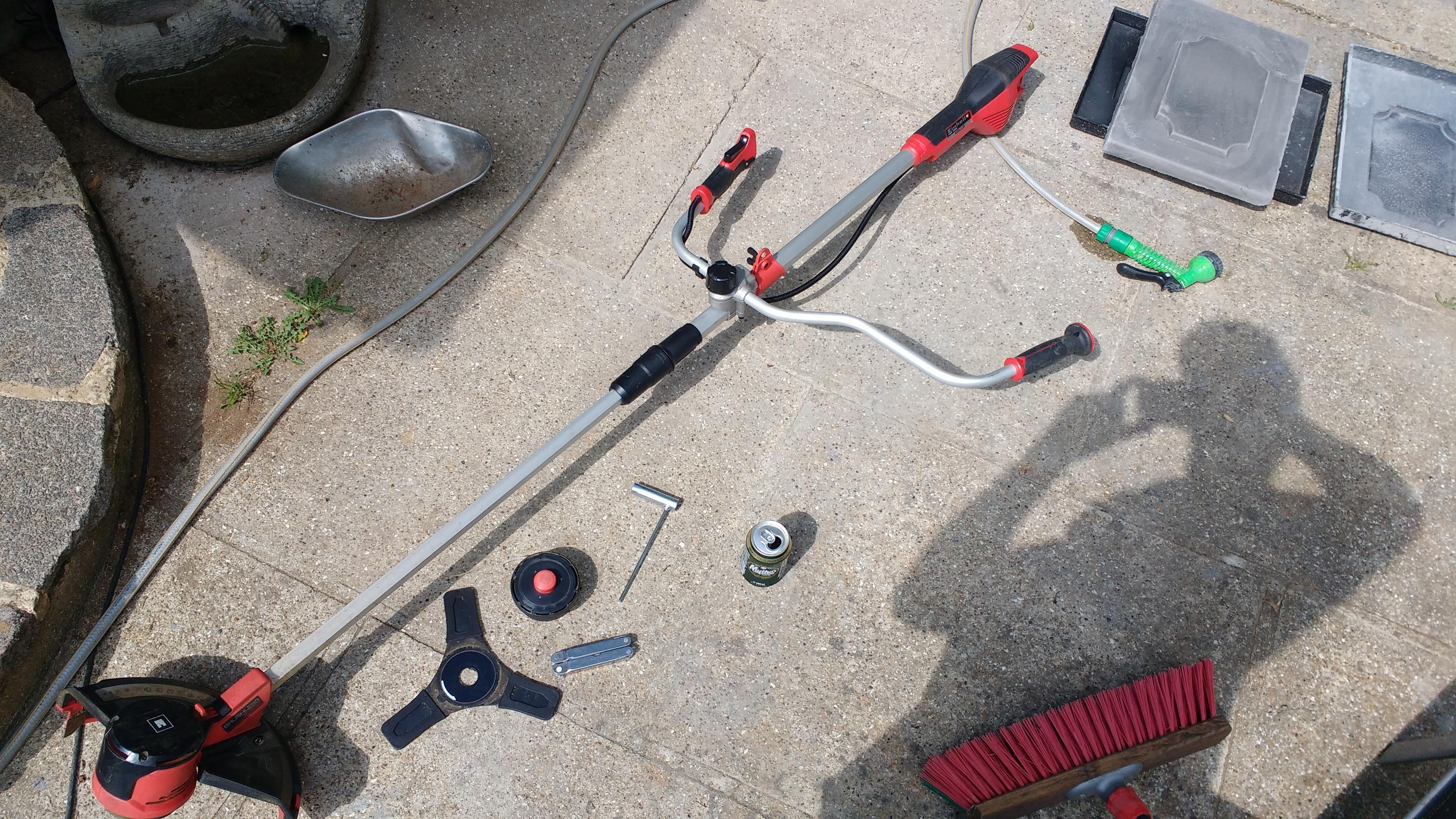

Posted

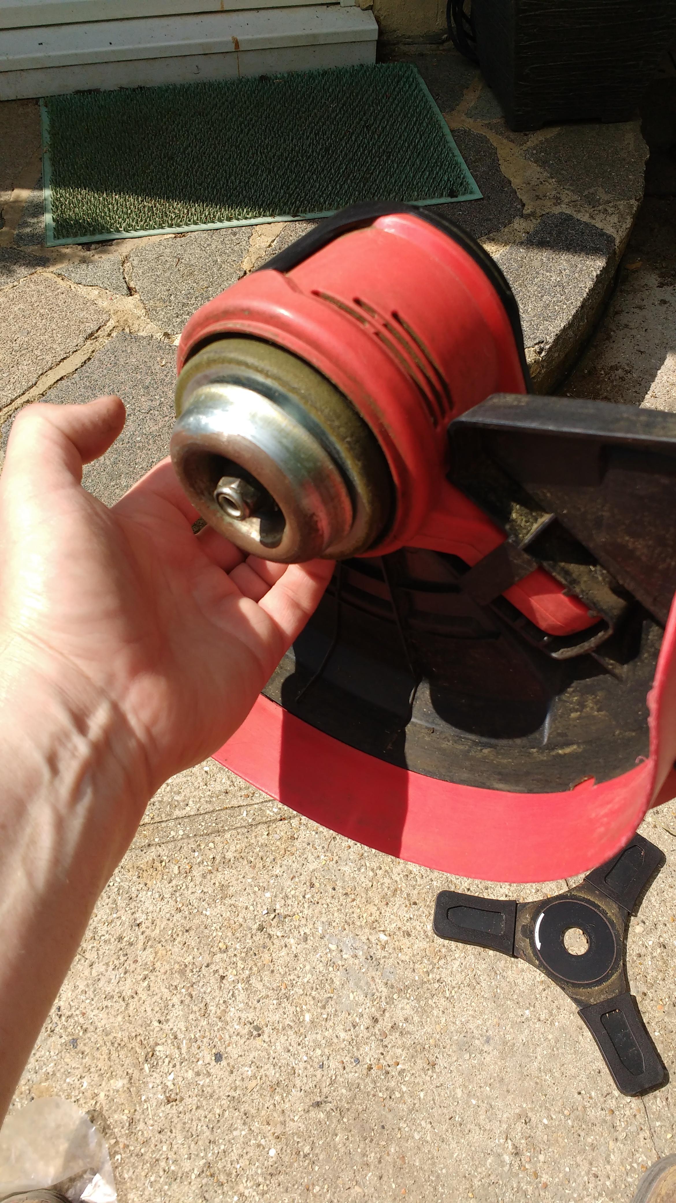

The"returns" brush cutter turned up. It appears to have seen light use but oddly comes complete with the blade, strimmer head and box spanner, something I didn't expect from reading the ad...
Of course I've yet to power it up and see what happens...if anything.
The one thing that is missing is the body harness/strap to support it as you use it (surprisingly heavy). Pretty certain I can do something with a spare, out of date full body harness, some D shackles and karabiners etc.
Just waiting for the Makita batteries to charge up.
Best I go find the chainsaw and see if the battery adapters fit!
@Roys looks like I have  blade after all. Will still happily take that other one off your hands though! ?

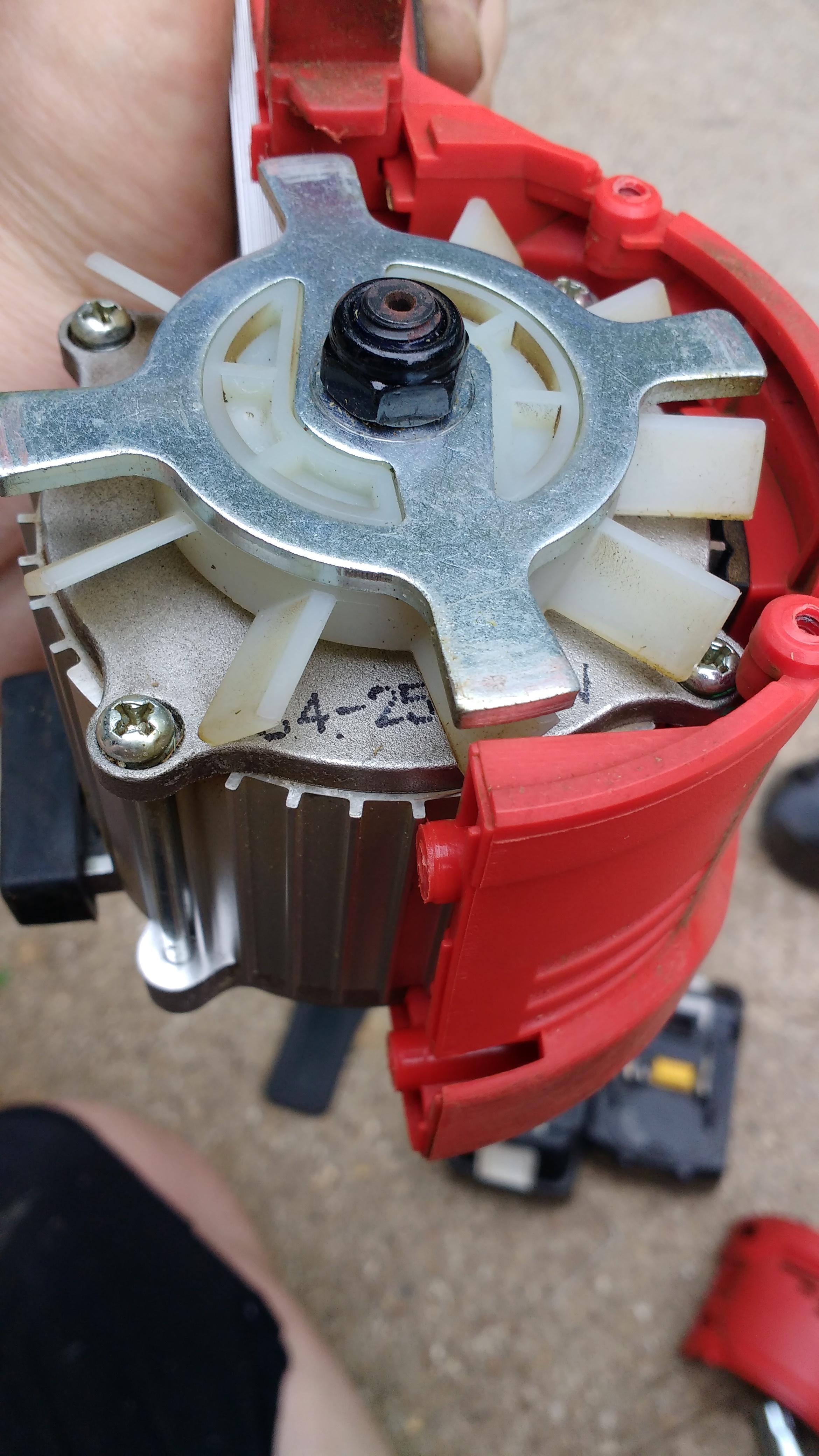

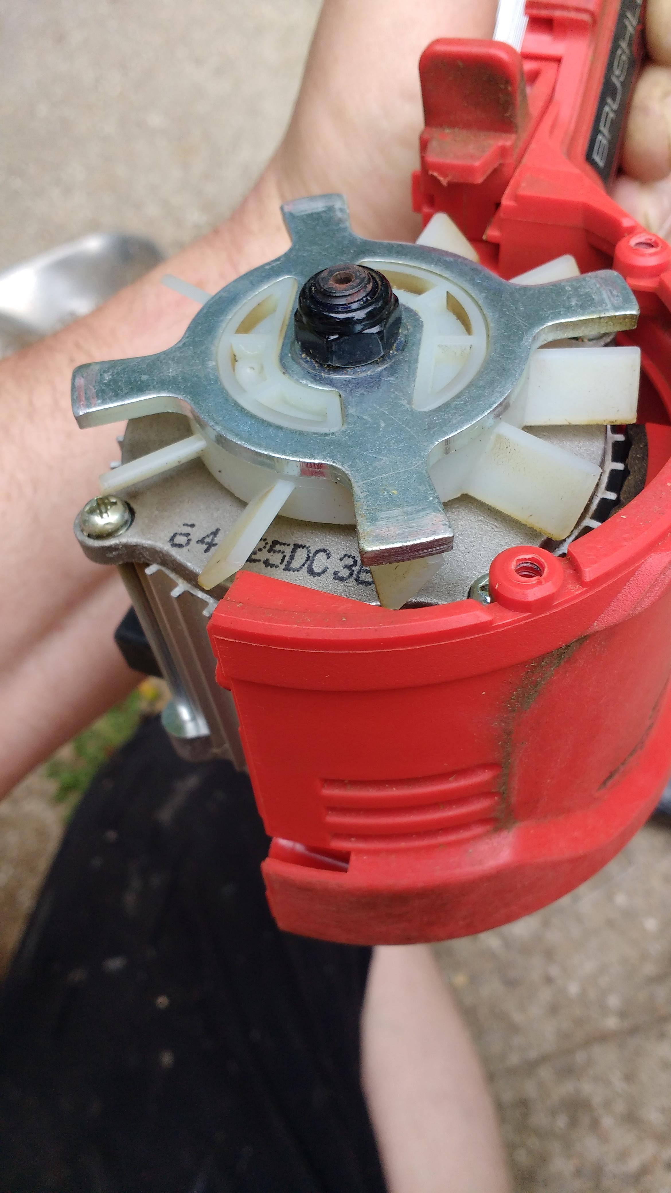

Posted
OfWoof, woof! ?
So far it appears to be a pup!

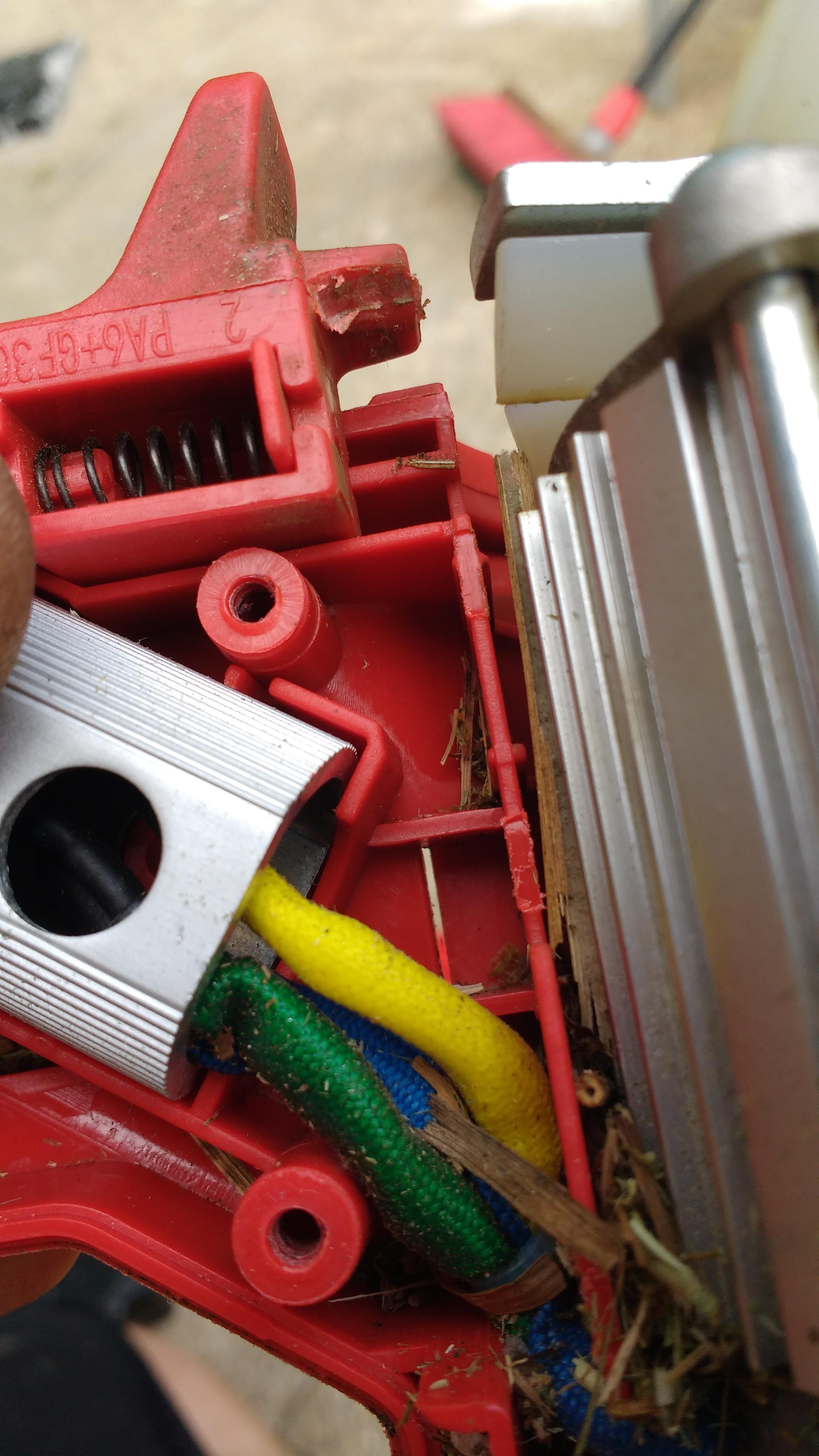

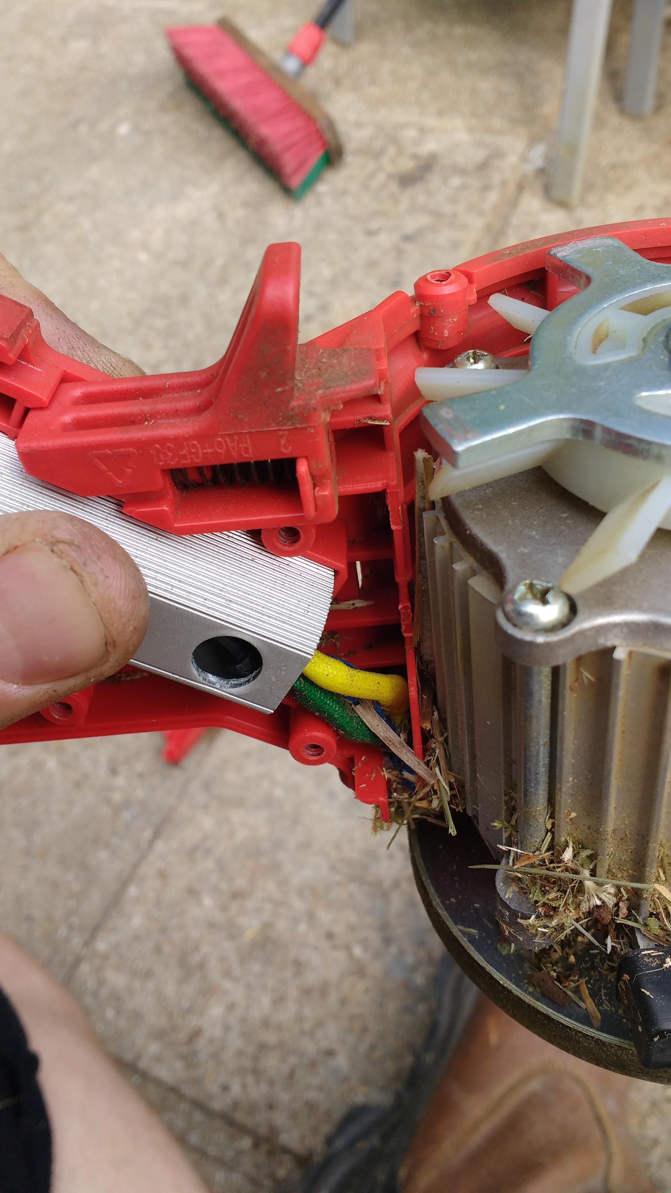

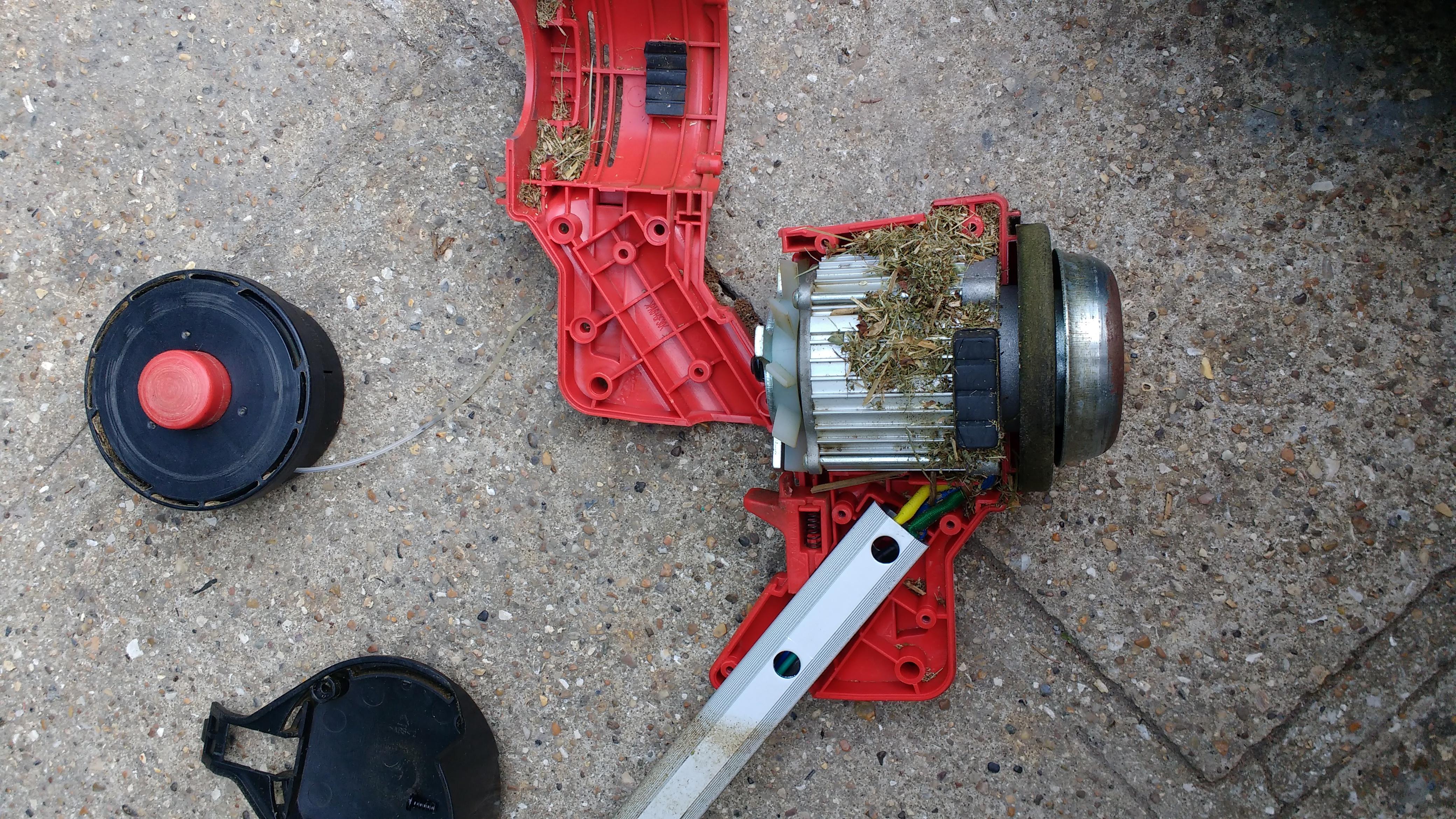

Putting the batteries on and nothing so in we go...
The blade locking plastic thing is well worn. It works OK to put a blade on but won't pick properly to take one off. I guess 3D print one or make from ali/steel.
It's clearly seen some use. Strip down / meter time.
Motor is stamped "64-25DC36V"
All the jammed vegetation removed from the head around the motor...tbh it didn't stop it turning. Tried again, nowt.

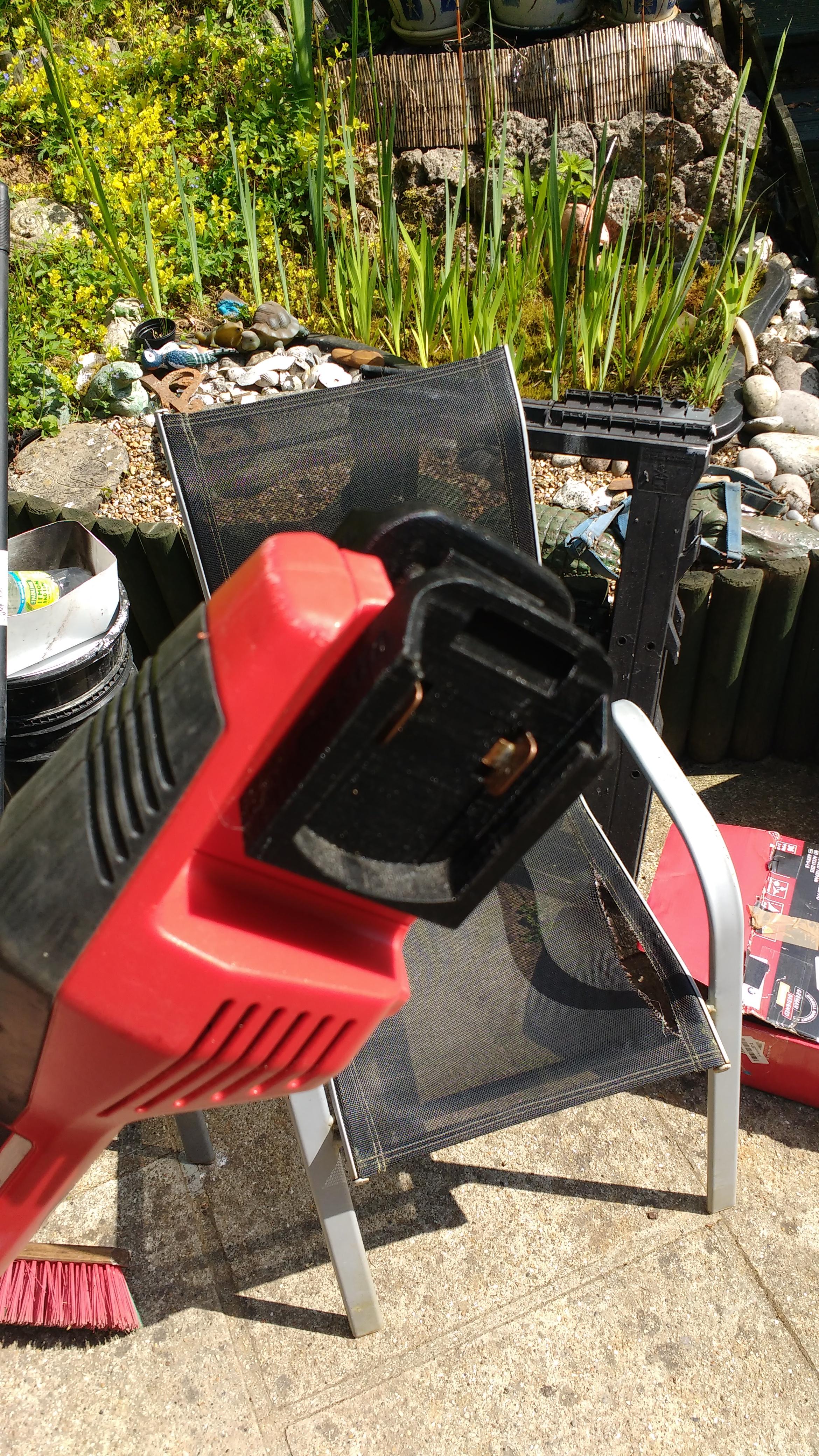

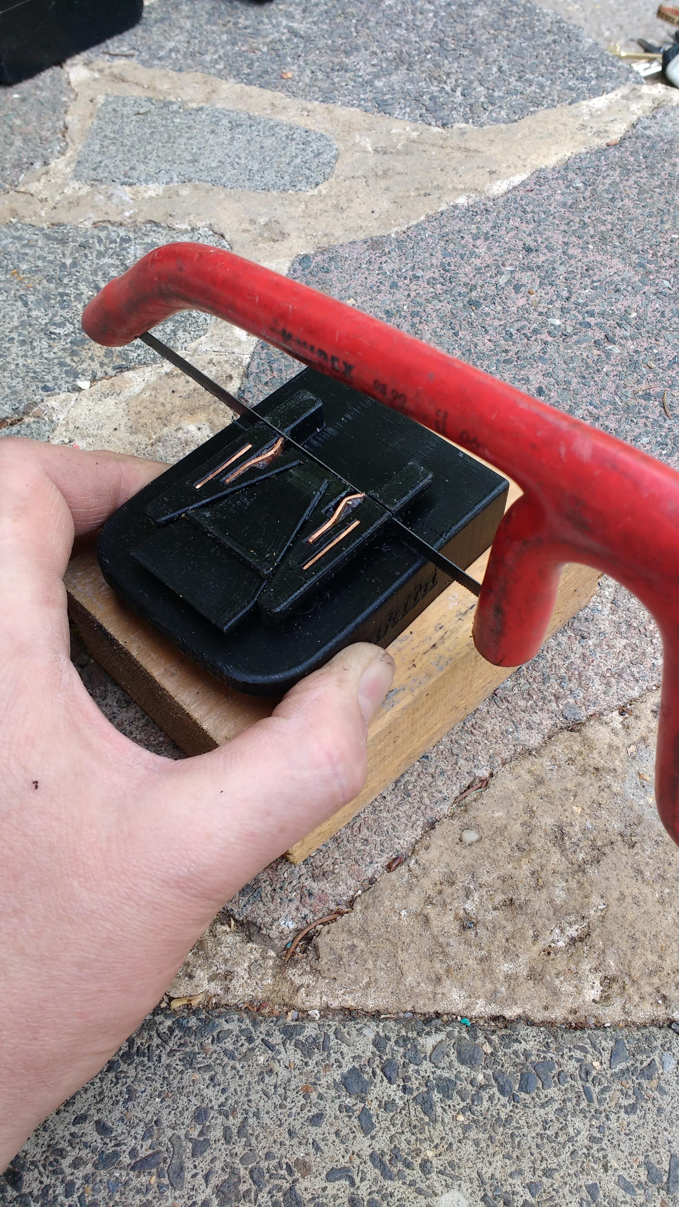

Posted
Laugh! ?

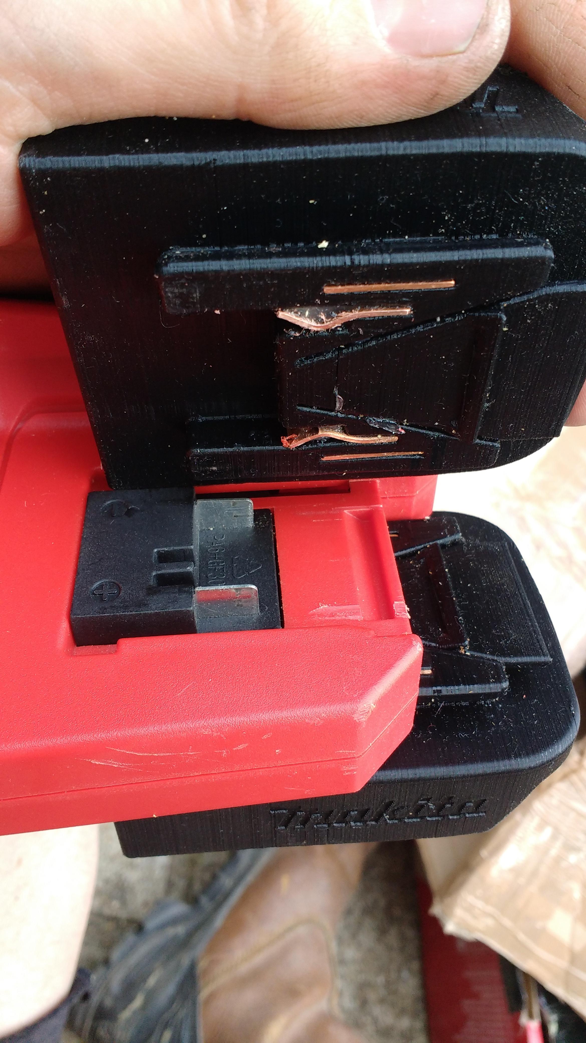

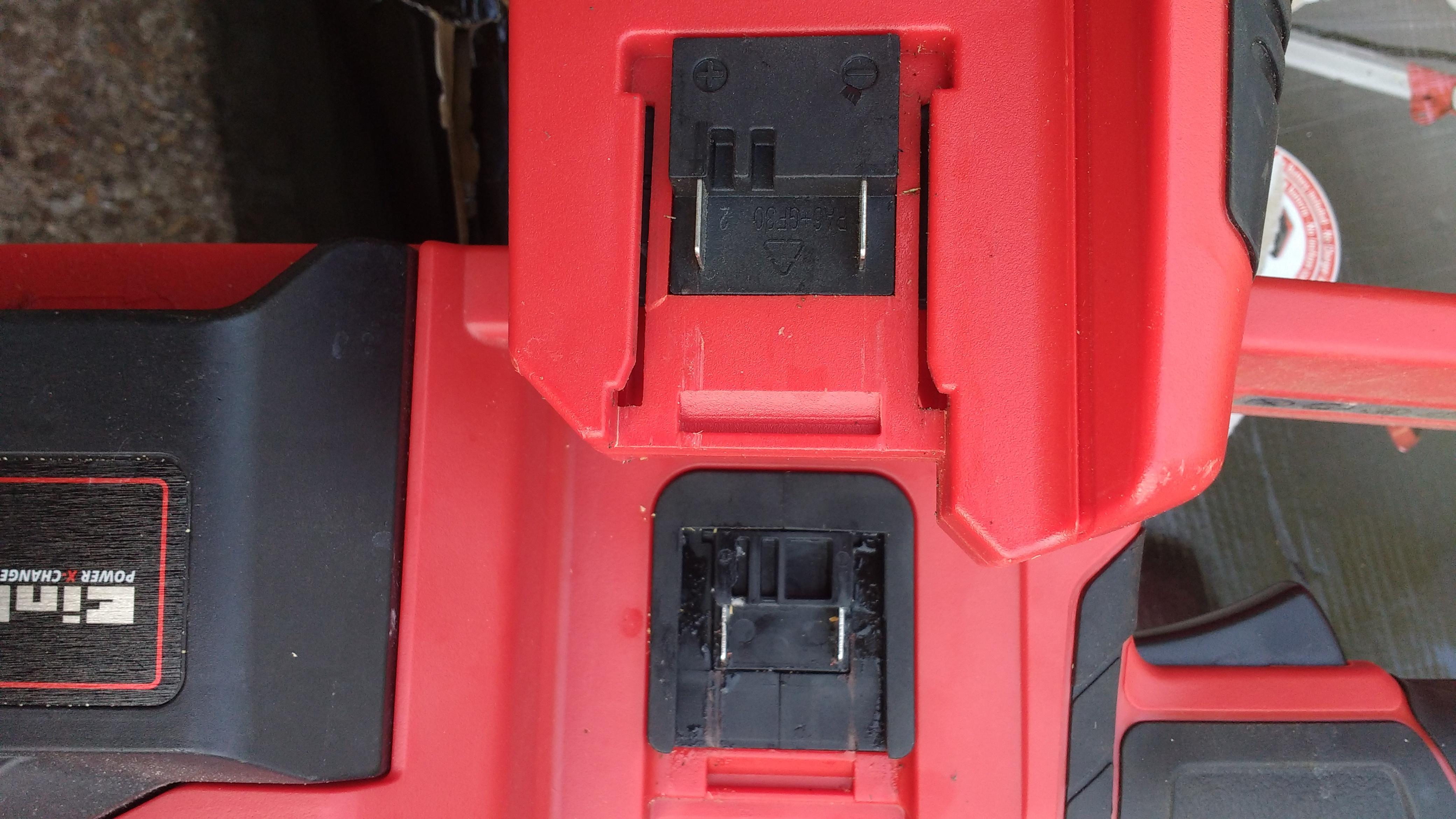

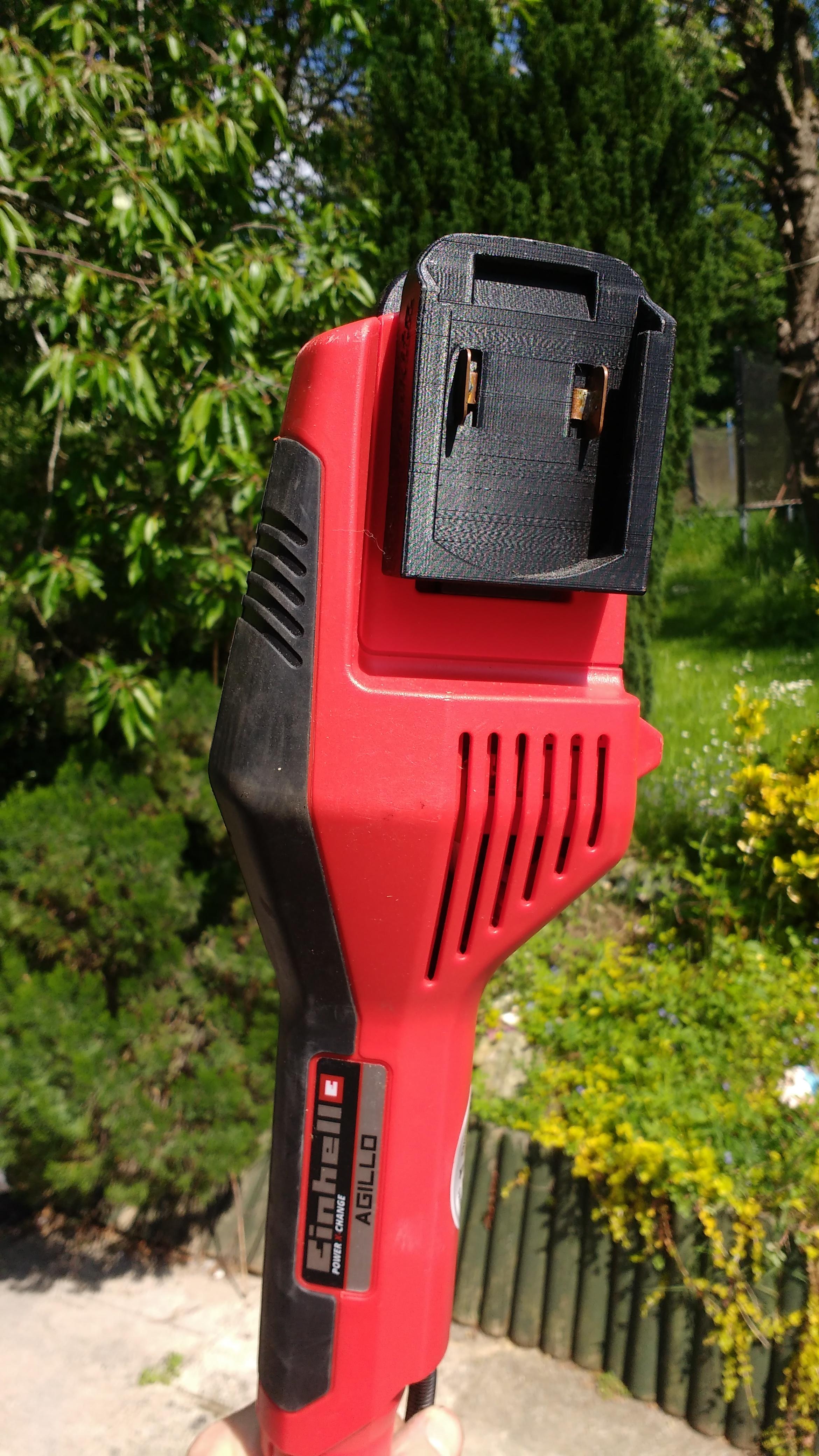

Could be a bit more straightforward than I thought...although the battery adapters appear to slide in fine.....
THE CONTACTS DON'T REACH!
It only slides about this far:
Subtle differences between the chainsaw and brush cutter where the battery connects. Brush cutter top, chain saw bottom:
So...
Enough for tonight, ? o'clock.
