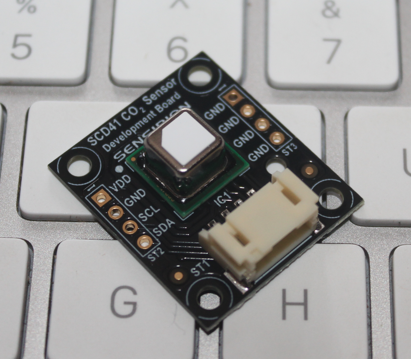

Adrian Walker Posted May 29, 2021 Posted May 29, 2021 (edited) I'm building a true CO2 meter based on the Sensirion SCD41 sensor with a Raspberry Pi. It might also include the SGP40 VOC sensor. Edited May 29, 2021 by Adrian Walker Multiple entry
MortarThePoint Posted May 29, 2021 Author Posted May 29, 2021 5 minutes ago, Adrian Walker said: I'm building a true CO2 meter based on the Sensirion SCD41 sensor with a Raspberry Pi. It might also include the SGP40 VOC sensor. Nice. I've used their flow sensors before and know the company to be reputable which is important
Adrian Walker Posted May 29, 2021 Posted May 29, 2021 19 hours ago, MortarThePoint said: Yes, that is a concern. I know there has been a lot of progress in gas sensors over the past 20 years and hoped that some would have filtered down to consumer grade products. I do see some interesting IR based CO2 sensor modules for around £20 and PM2.5 ones for around £30. That's probably what I would incorporate into a homebrew one. Yes internal AQ. We're not having MVHR but I am looking at PIV and/or dMEV and so there is scope to close the loop on air quality which MVHR would also allow. MVHR is obviously a more energy efficient approach, but we're exploring all of that on another thread. Have a look at the Sensirion SCD41 sensor - https://www.sensirion.com/en/environmental-sensors/carbon-dioxide-sensors/carbon-dioxide-sensor-scd4x/
MortarThePoint Posted May 29, 2021 Author Posted May 29, 2021 8 minutes ago, Adrian Walker said: I'm building a true CO2 meter based on the Sensirion SCD41 sensor with a Raspberry Pi. It might also include the SGP40 VOC sensor. Nice. I've used their flow sensors before and know the company to be reputable which is important 1
Adrian Walker Posted May 29, 2021 Posted May 29, 2021 (edited) 4 minutes ago, MortarThePoint said: Nice. I've used their flow sensors before and know the company to be reputable which is important It's nice and small and uses photoacoustic sensing principle, that's the development board sitting on my Apple keyboard Edited May 29, 2021 by Adrian Walker

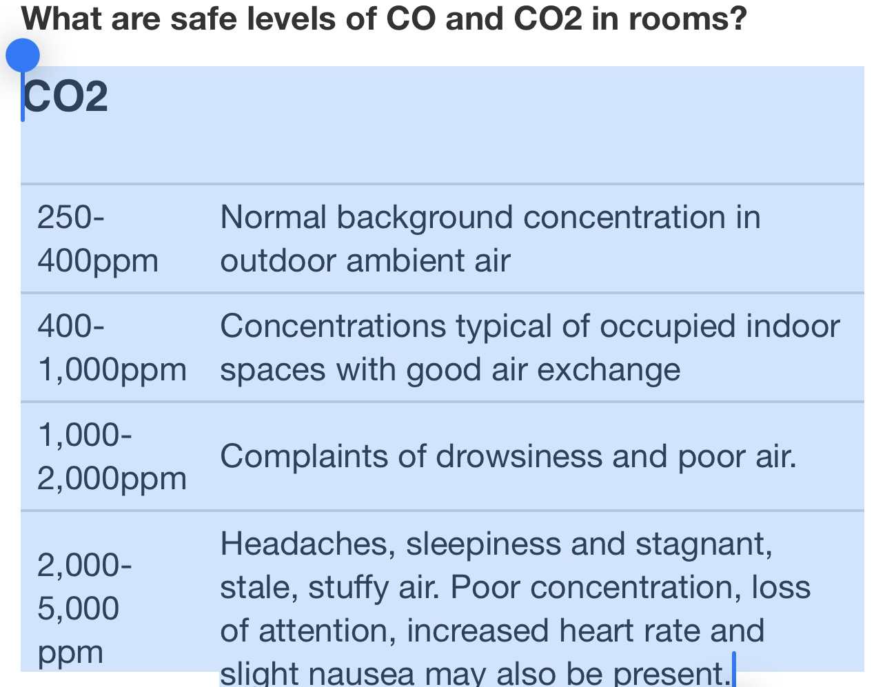

Kelvin Posted September 12, 2024 Posted September 12, 2024 I fitted Deka CO2 monitors in each bedroom and the study so four of our rooms are monitored. They record current level, 8 and 24hr average and 24hr peak. Google says: I couldn’t sleep last night so used the small guest bedroom. Guest bed ( 1 occupant small room low ceiling window closed) - 8hr average - 789ppm 24hr peak 906ppm Master bed (1 occupant large room high ceiling Velux trickle vent open) - 8hr avg - 540ppm 24hr peak 625 ppm Upstairs sitting room (unoccupied large room high ceiling Velux trickle vent open) - 8hr avg 345ppm 24hr peak 503ppm - monitor is beside a wall mirror that other half uses to get ready for work Study (medium sized room low ceiling variously occupied throughout day window closed) - 8hr avg 402ppm 24hr peak 473ppm The guest bed has peaked much higher than that when we’ve had two people sleeping in it so I open the window. 1
