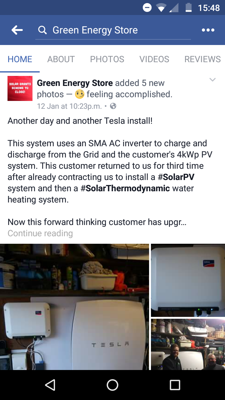

Declan52 Posted March 6, 2017 Share Posted March 6, 2017 (edited) 58 minutes ago, lovo said: We have a Solar iBoost in current house that does the same thing. I guess a lot of us are waiting for a battery that makes economic sense still. Thanks If you have a look on the green energy stores Facebook page they do the type of battery storage system you are looking for. They are based in newtownards. They give a rough cost of £6500 so it's not cheap. Read some of the comments about the length of time to break even. I got £85 back from my exported electric this year so payback is 76 years!!! Edited March 6, 2017 by Declan52 Link to comment Share on other sites More sharing options...
