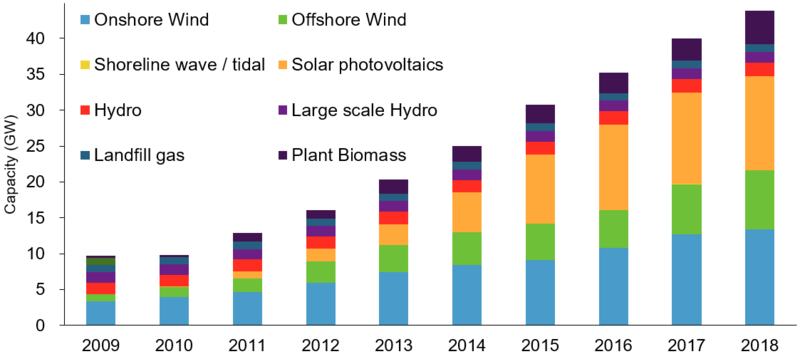

I studied renewable energy at university and I am still amazed how fast we can build generation now, and we have not built any significant onshore wind generation for a few years now.
