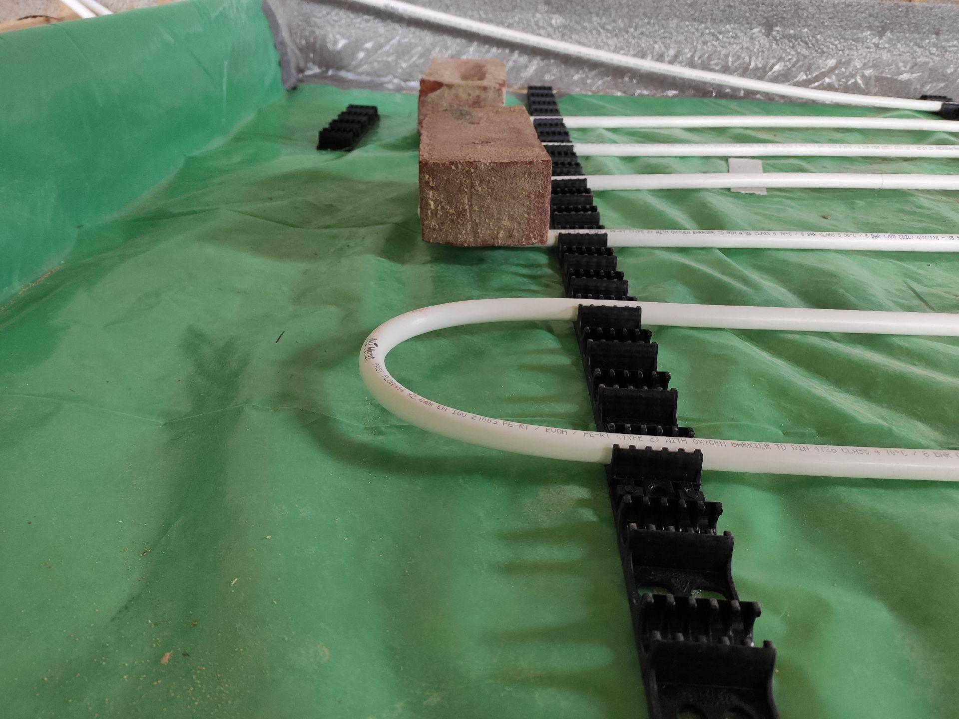

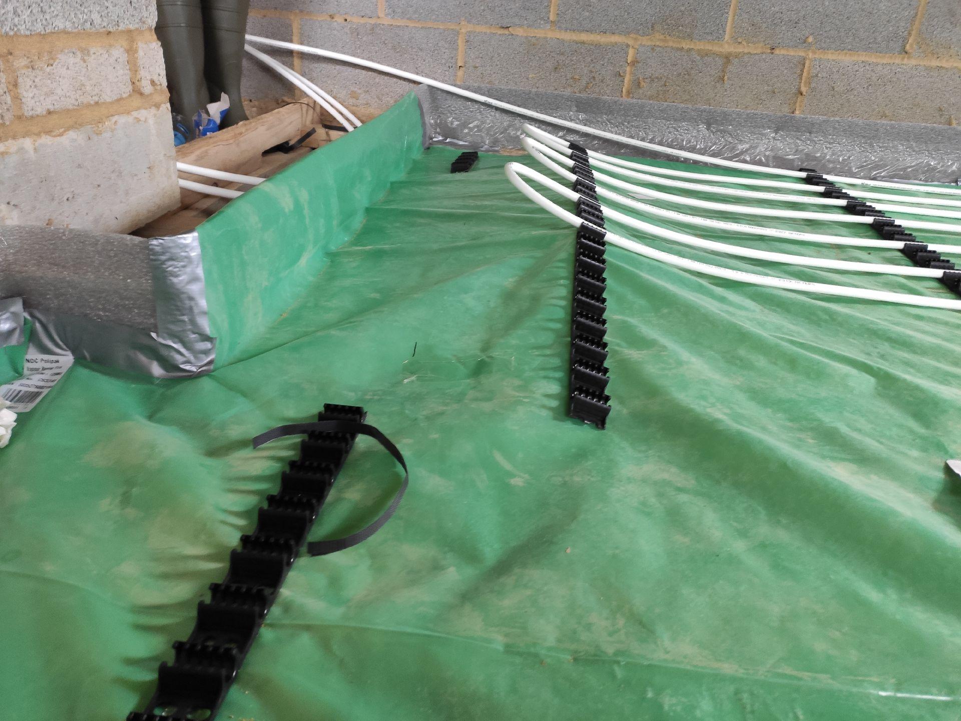

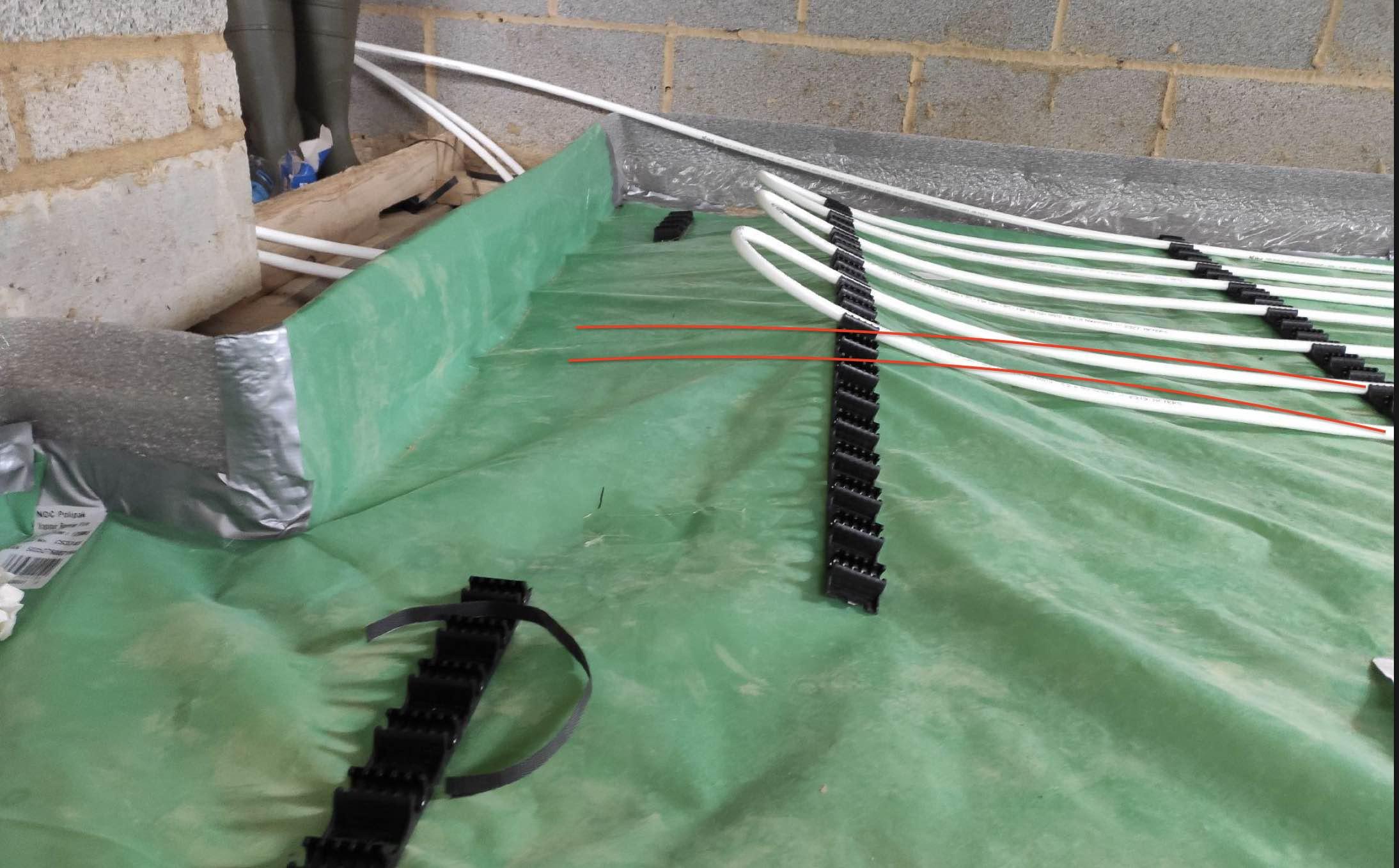

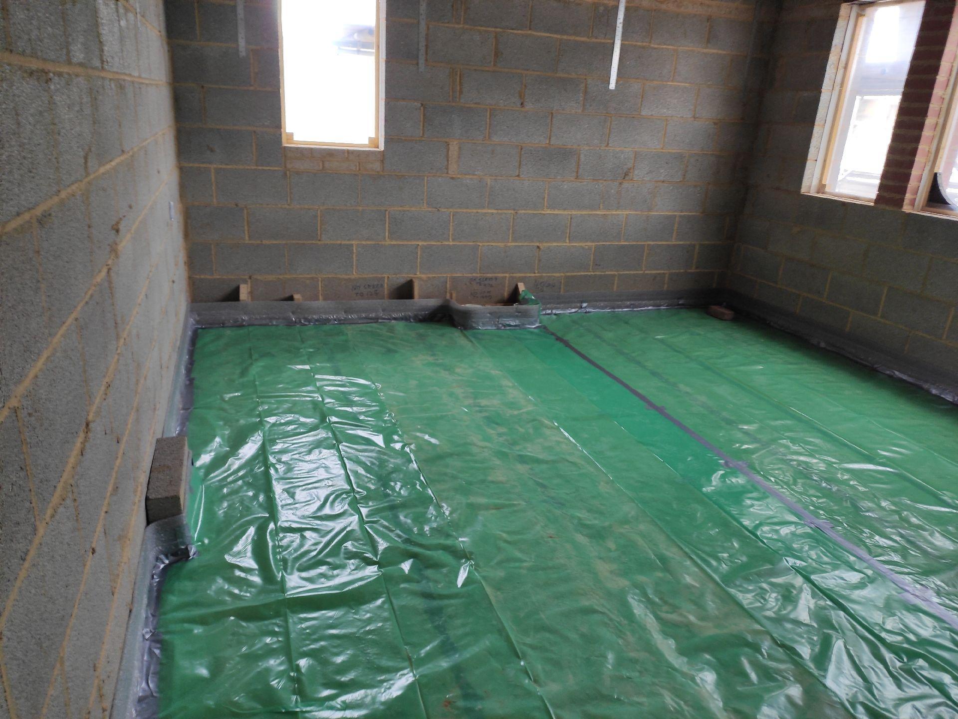

MortarThePoint Posted May 23, 2021 Posted May 23, 2021 I was pleased to get the keep outs, edge strip and membrane down But unfortunately the UFH pipes are pulling up Any ideas as to how to solve this? I can't use anything that penetrates the green sheeting. It's not insulation underneath, it's concrete and, on ground floor, a gas membrane too.
PeterW Posted May 23, 2021 Posted May 23, 2021 Just a couple of concrete screws through the tracks will do it. It won’t cause any problems with the membrane - if you’re worried just a glob of LVT sealant under each hole to seal. 1

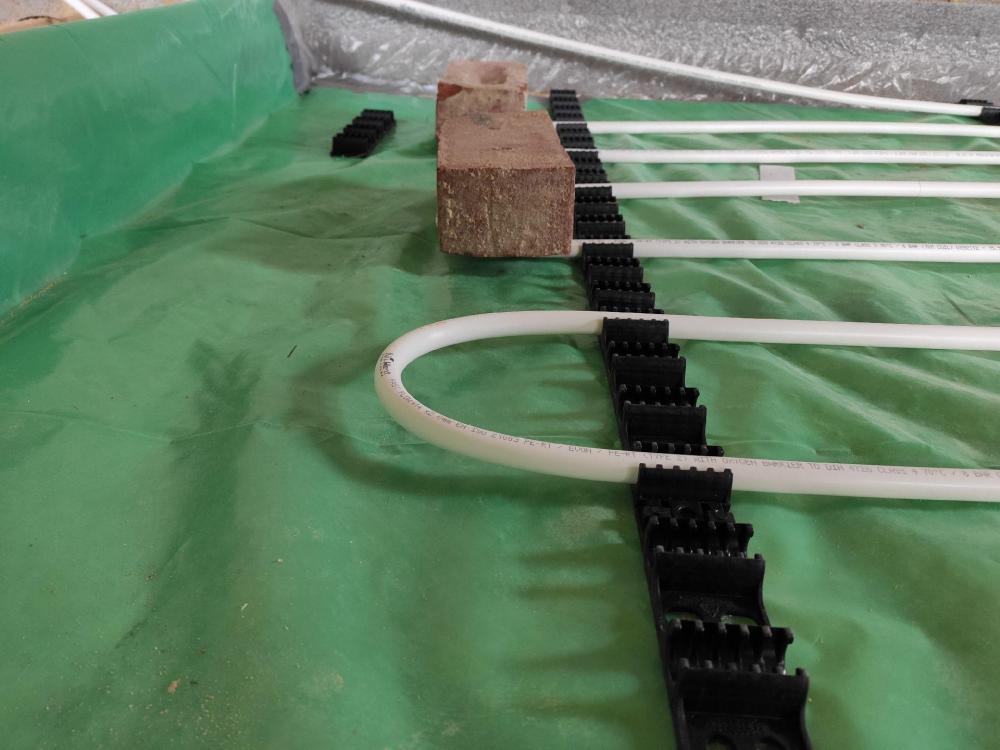

MortarThePoint Posted May 23, 2021 Author Posted May 23, 2021 (edited) This is looking promising. I weighed down the closest pipe with a brick overnight. I may also try a heat gun at around 100C (testing on membrane scraps first) Edited May 23, 2021 by MortarThePoint
JFDIY Posted May 23, 2021 Posted May 23, 2021 Lay the pipe with the twist the other way, then the push down at ends and rise less severely in the middle, when filled with water should flatten out better that way.
Nestor Posted May 23, 2021 Posted May 23, 2021 (edited) @MortarThePoint If using Pert/Al pipe, try putting a soft bend in the middle of each pipe away from the floor, this should push the end of the loops down. Edited May 23, 2021 by JamesP
PeterW Posted May 23, 2021 Posted May 23, 2021 1 hour ago, MortarThePoint said: Would be OK upstairs but not with the gas barrier Gas barrier is irrelevant - concrete isn’t gas porous and unless you’ve built a sump etc and got positive pressure under the floor you won’t extract it anyway. If it worked the way you think it will be coming up the outside edges where you’ve turned them up the walls. 1
dpmiller Posted May 23, 2021 Posted May 23, 2021 gas barrier would be outside wall to outside wall, continuous.
Mr Punter Posted May 23, 2021 Posted May 23, 2021 Yes radon barrier goes right over the slab. The green polythene is not a gas membrane. It looks like a separation layer to isolate the screed from the concrete so you have an unbonded screed.

Nickfromwales Posted May 31, 2021 Posted May 31, 2021 Just screw them down a-la @PeterW’s advice! Making holes in membranes is neither here nor there. Failing to keep your UFH pipes down on the deck will be a multiples of £1000 fcuk up with no chance of repair. Seriously……. Just drill the 6mm hole for a concrete screw, then immediately prior to putting the screw home fill the hole top with sealant, smother the screw thread, wind it in, and repeat. This will be of zero detriment to any of the layers. Screw them down or prepare to fail. 2
