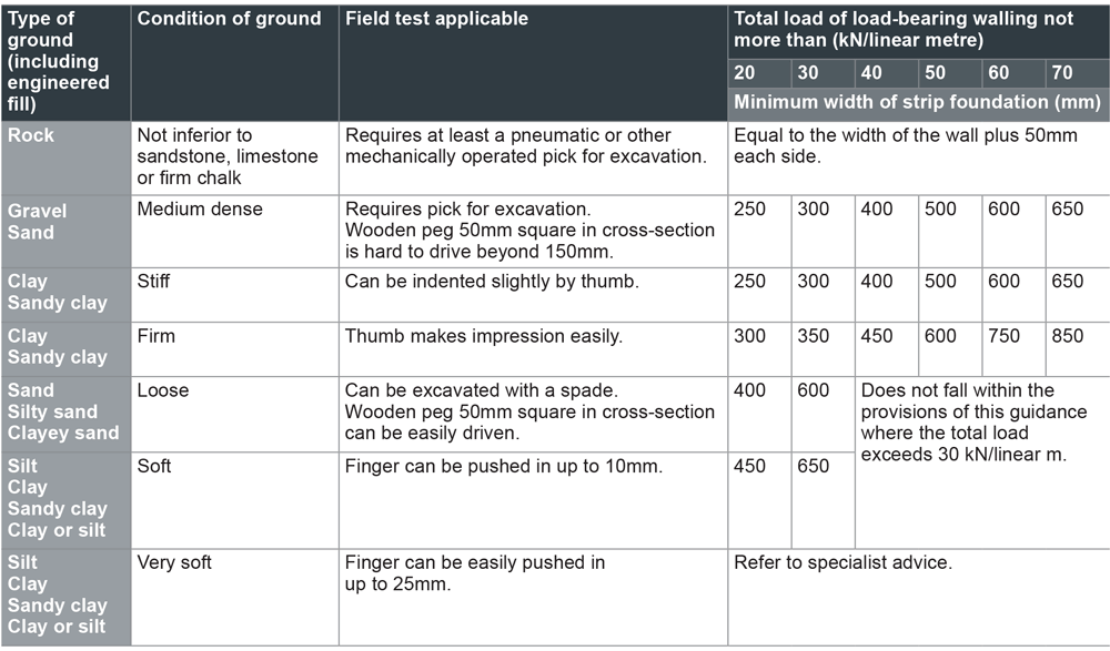

Temp Posted November 17, 2022 Share Posted November 17, 2022 I'm no SE but I thought the width of your foundation trench could be increased to effectively spread the load over a wider area when the ground was a bit soft. The NHBC have this but pushing in fingers doesn't seem very scientific.. https://nhbc-standards.co.uk/4-foundations/4-3-strip-and-trench-fill-foundations/4-3-7-safe-transmission-of-loads/ Link to comment Share on other sites More sharing options...
George Posted November 18, 2022 Share Posted November 18, 2022 It's either thumb pushing or a geotechnical investigation unfortunately (although I'd love to get a hand shear vane, it's only applicable to certain soil types and not much better than a thumb) Link to comment Share on other sites More sharing options...
