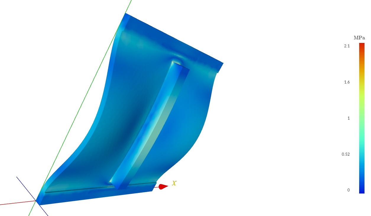

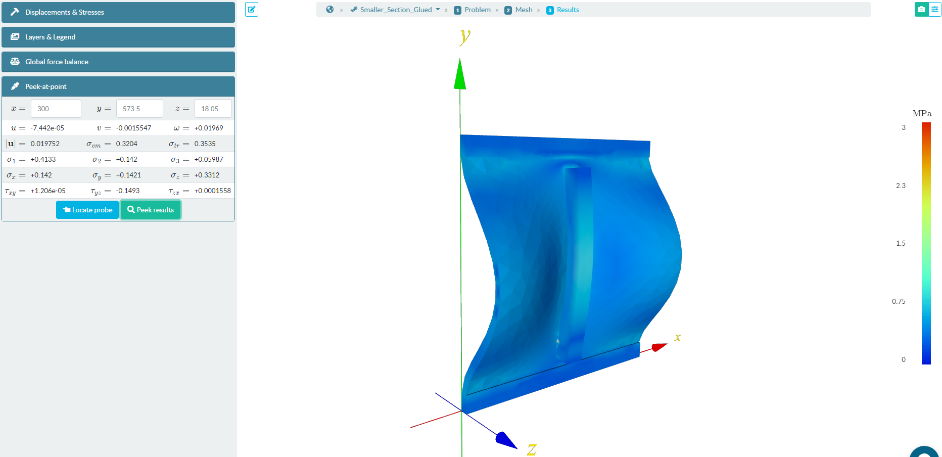

Well I love over analysing things and was wondering about sections of timber fixed under the subfloor at 600mm c/c, but not fixed to the joists. The benefit of this is they don't have to be cut to size and it removes the difficulty of screwing a noggin to the joist. I have modelled sticking 500mm lengths of 2x2 timber under 18mm sheet material and 600mm c/c 47mm perfectly stiff joists. I have used a Young's Modulus (MOE) of 2GPa for the sheet and 8GPa for the timber. OSB3 has a major axis MOE of around 2500MPa and a minor axis of 1250MPa. My tool doesn't allow anisotropic materials (could add ribs) so I plucked for 2000MPa. As for the timber, 8GPa is 'typical' of pine I think.
I've added a 5mm thickness of the 2GPa material to model the compliance of the joist fixment. The  bottom surface of that 5mm is rigidly constrained. Zero X-direction displacement constraints on the ends due to symmetry to model and infinite joist length. My model could be a quarter if the size, but...
I'm applying a uniform pressure of 0.002 MPa = 2kN/m2 to the top surface of the sheet.
Three scenarios:

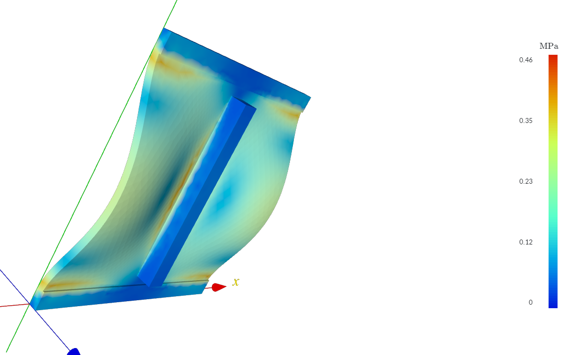

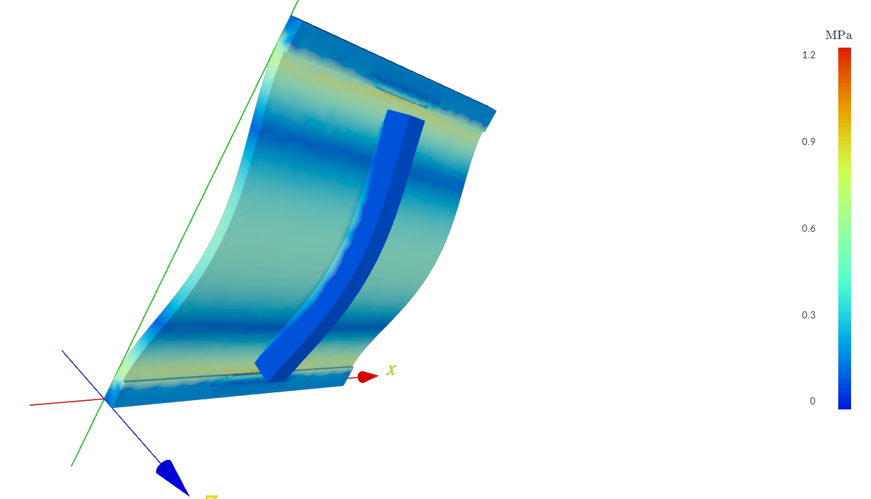

    No noggin: max displacement 0.52mm midway between joists. Maximum stress 1.2MPa in sheet at joist edge. [modelled by making noggin very soft, MOE 0.001GPa]

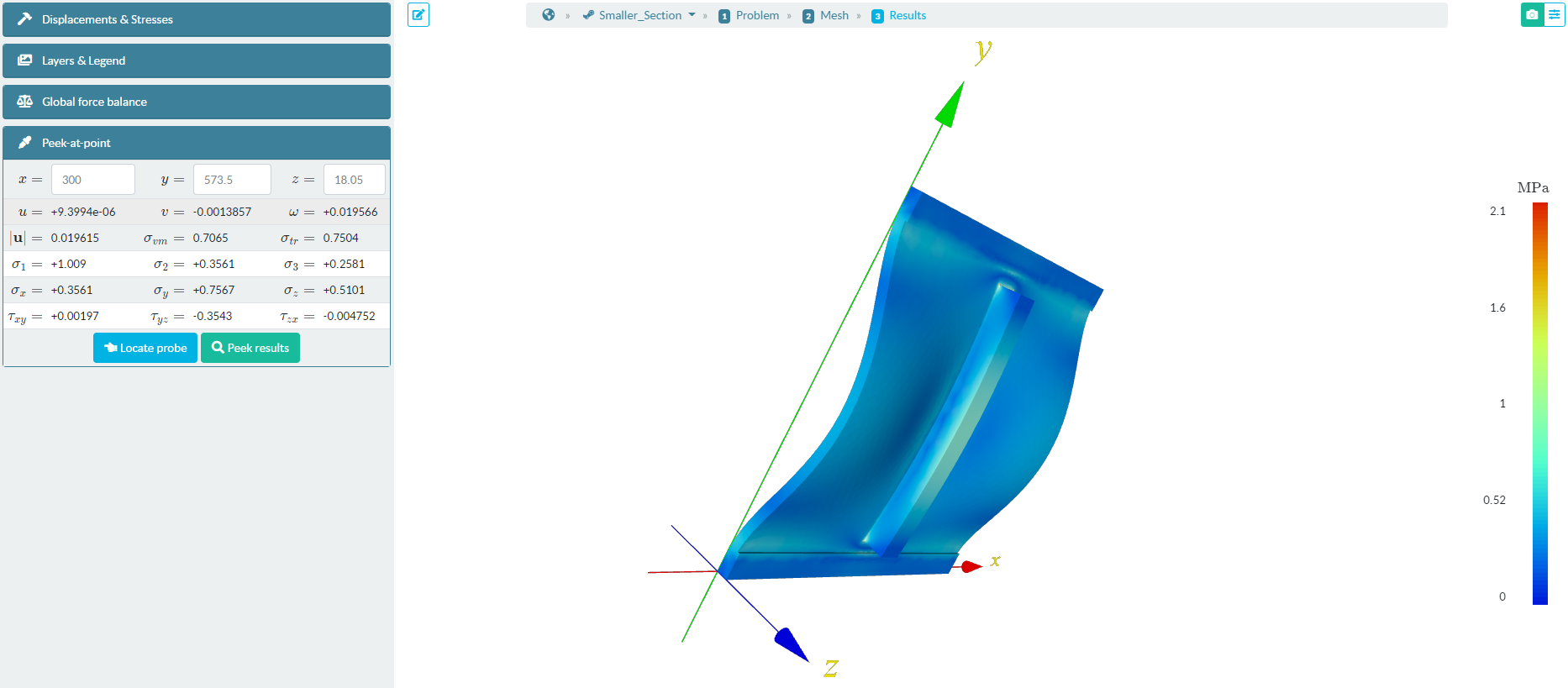

    Floating noggin: max displacement of 0.29mm midway between joist and noggins. Max stress of 2.1MPa at edge of noggin bond*.
    Fixed noggin: max displacement of 0.25mm midway between joist and noggins. Max stress of 0.46MPa** at edge of noggin and edge of joist.
* not real as there would be some compliance here. I could model a lower MOE material between the two to represent the glue, bit that feels excessive.
** may be underestimated as mesh size large here.
I think this could be a good approach as it is pretty quick to fit having precut a load of 500mm 2x2 pieces. Grab adhesive and 4 screws per ' floating noggin'. It's cheap too as uses 1.38m of 2x2 per m2 so, in cheaper times, would cost less than £1/m2.
Is this a done thing, what do people think?
Fixed noggin modelled by constraining bottom fact of noggin.

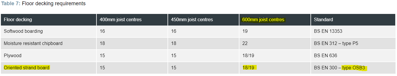

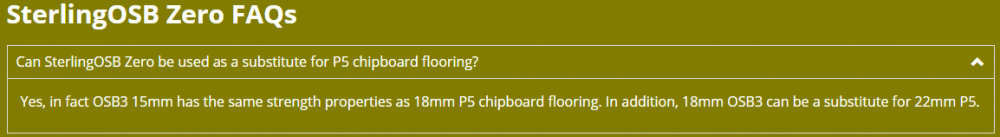

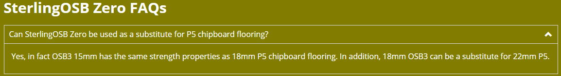

I probably should have just called these 'stiffening timbers' rather than 'flying noggins'. As far as I can tell, 18mm OSB3 can be used on 600mm c/c joists:
https://www.norbord.co.uk/resources/help-advice/faqs/
https://nhbc-standards.co.uk/6-superstructure-excluding-roofs/6-4-timber-and-concrete-upper-floors/6-4-19-floor-decking/

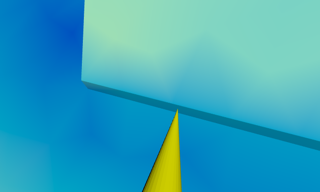

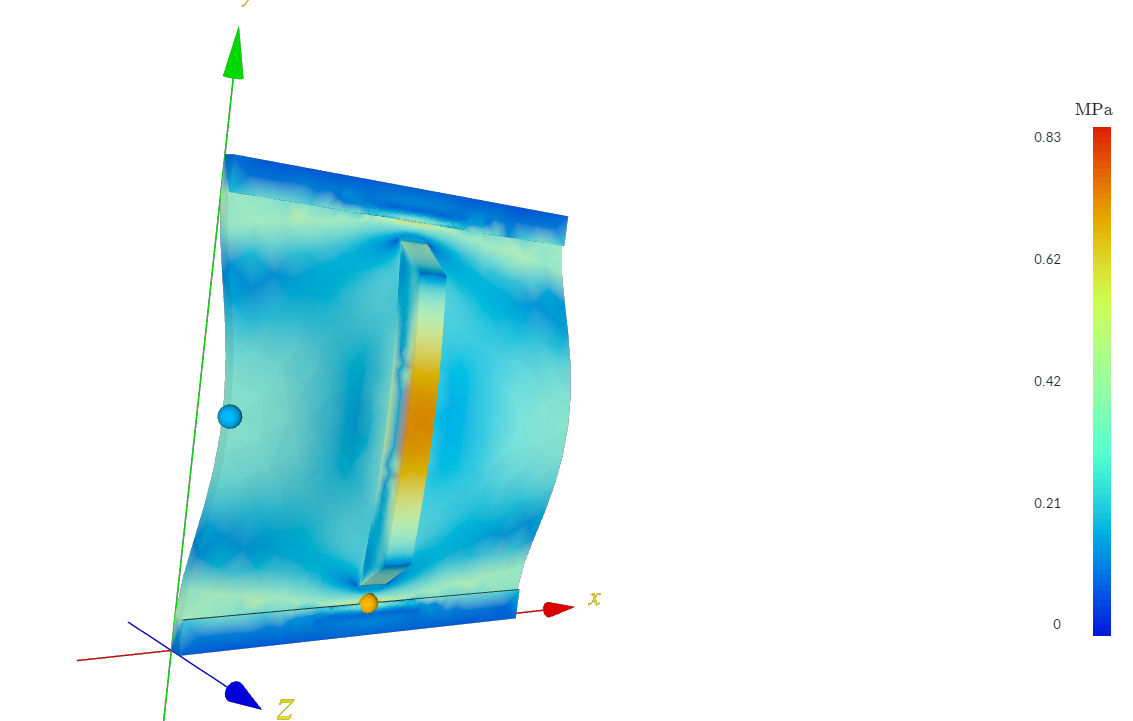

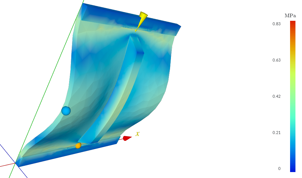

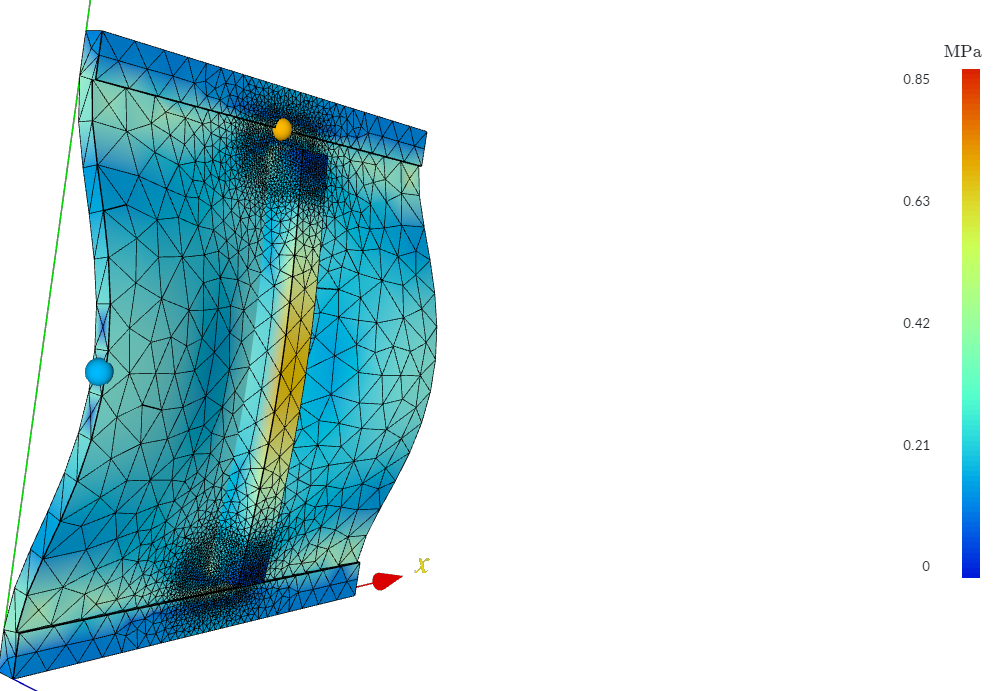

I did model it with a glue layer after all and as suspected the peak stress is lower at 0.85MPa. The orange ball shows where that is and the blue ball shows where the peak displacement is (0.30mm). I've used a coarser mesh away from the area of interest and a finer mesh in the area of interest. I've modelled the glue as 0.1mm thick and having a very low Young's Modulus of 10MPa which is probably a bit low, but even with that low a stress of 1MPa would be a strain of 10%, so 0.010mm.

It's 18mm OSB3 which is equivalent to 22mm P5 chipboard

It is using the correct product, perhaps not normally the preferred product. 18mm OSB3 is equivalent to 22mm P5.
This approach is a thought for improving the stiffness of any sheet subfloor (P5 or OSB3). I'm interested in OSB3 as that's what I'll be using.

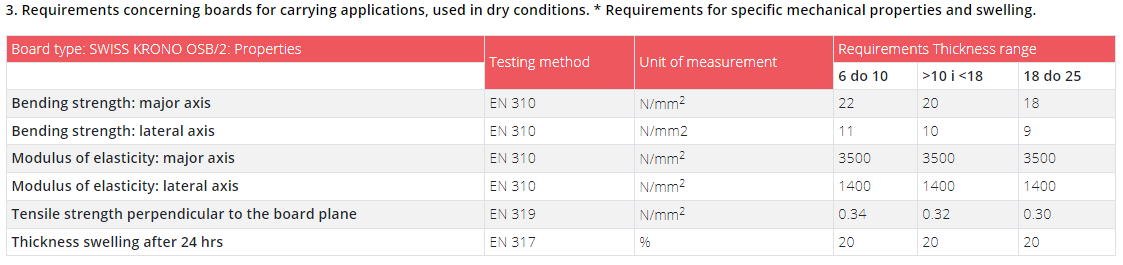

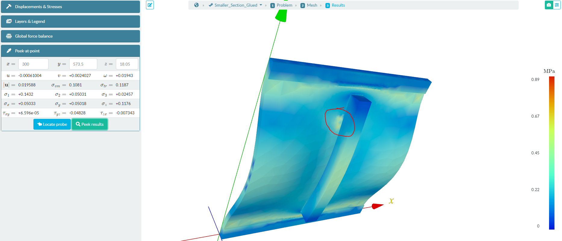

As feared, the tensile strength of OSB3 perpendicular to the board plane is poor. Below is example data for something I could find and it's only 0.3N/mm2 = 0.3MPa. I think the peak stress applied to the OSB3 in this fashion is around 4x that figure. The screw could help, but it would be better of the material properties were compatible with just the glue.
It occurs to me that the stress could be reduced by having a 45degree cut at the end of the splint. I don't know if that would be enough though as that out of plane strength is very low.
I've tried the 45degree cut. To aid visualisation, I increased the glue thickness to 1mm, but not changing its MOE. The maximum displacement is now 0.33mm, but the peak tensile stress is much reduced (if it is to be believed) to 10% of the OSB3's out of plane tensile strength. The maximum displacement is 0.33mm.
Increasing the MOE of the glue by a factor of 10x to compensate for the increase in thickness (therefore giving the same deformation) puts the deflection back to 0.30mm, but the peak tensile stress to 0.24MPa which is 80% of the OSB3's out of plane tensile strength.
The 45 degree cuts help and using a more flexible glue would definitely also help.
Glue stiffened to counteract effect if increase thickness used for visualisation:

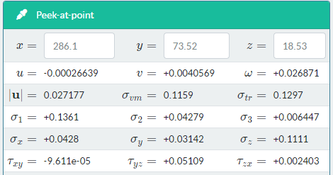

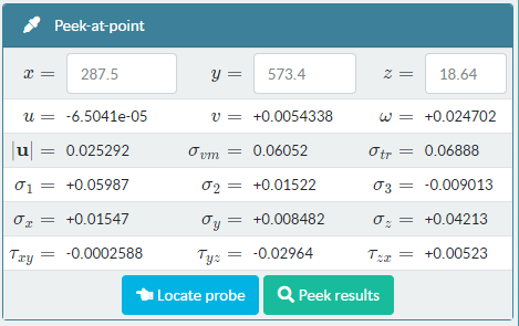

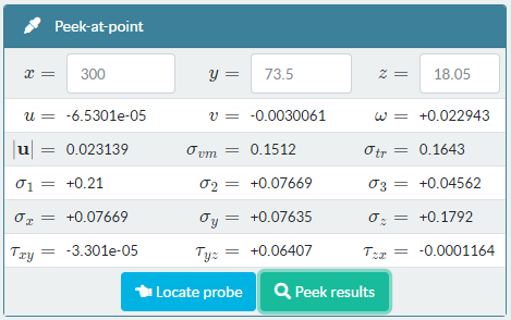

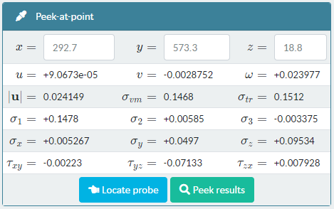

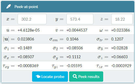

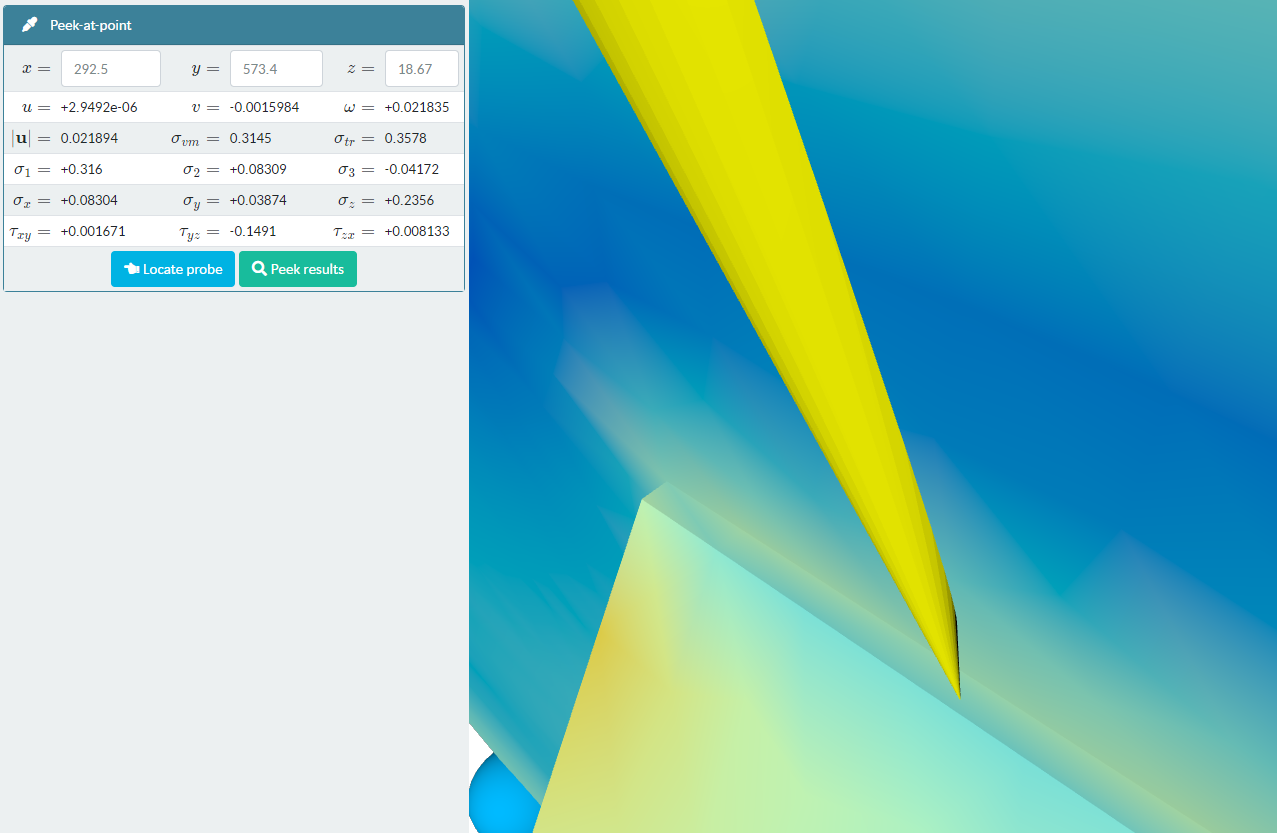

For reference, the glue tensile stresses in the non-45 degree cut 47 x 47 case at the end of the rib where I expect it to be highest are:
  • Not modelling glue layer: 0.51MPa [global max stress was 2.1MPa, not sure where]
  • Modelling the glue layer: 0.33MPa [global max stress was 3MPa, not sure where]
Both of these are higher than the OSB3 out of plane tensile strength (0.3 MPa) so would be an issue.
Modelling the glue layer and approximating the 22 x 100 gives a glue tensile stress of 0.18MPa. I'm not trusting that value as the solver is doing something weird and violating symmetry (circled). That needs to be halved though due to the way I am modelling the dimension change and so the value becomes 0.09MPa, well under the OSB3 out of plane tensile strength of 0.3MPa. Note, peak deflection in that model is 0.3mm. A hand waving argument would suggest the stiffness per unit width of the rib has gone down to (22/47)^3 = 10% and the glue stress should too for the same displacement. Displacement there will be higher by a factor of (47/22) ~ 2 higher and so the glue stress should be about 20% of the 47 x 47 case. That supports a figure of around 0.06 to 0.1 MPa, under the OSB3 out of plane tensile strength of 0.3 MPa.
22 x 100:
