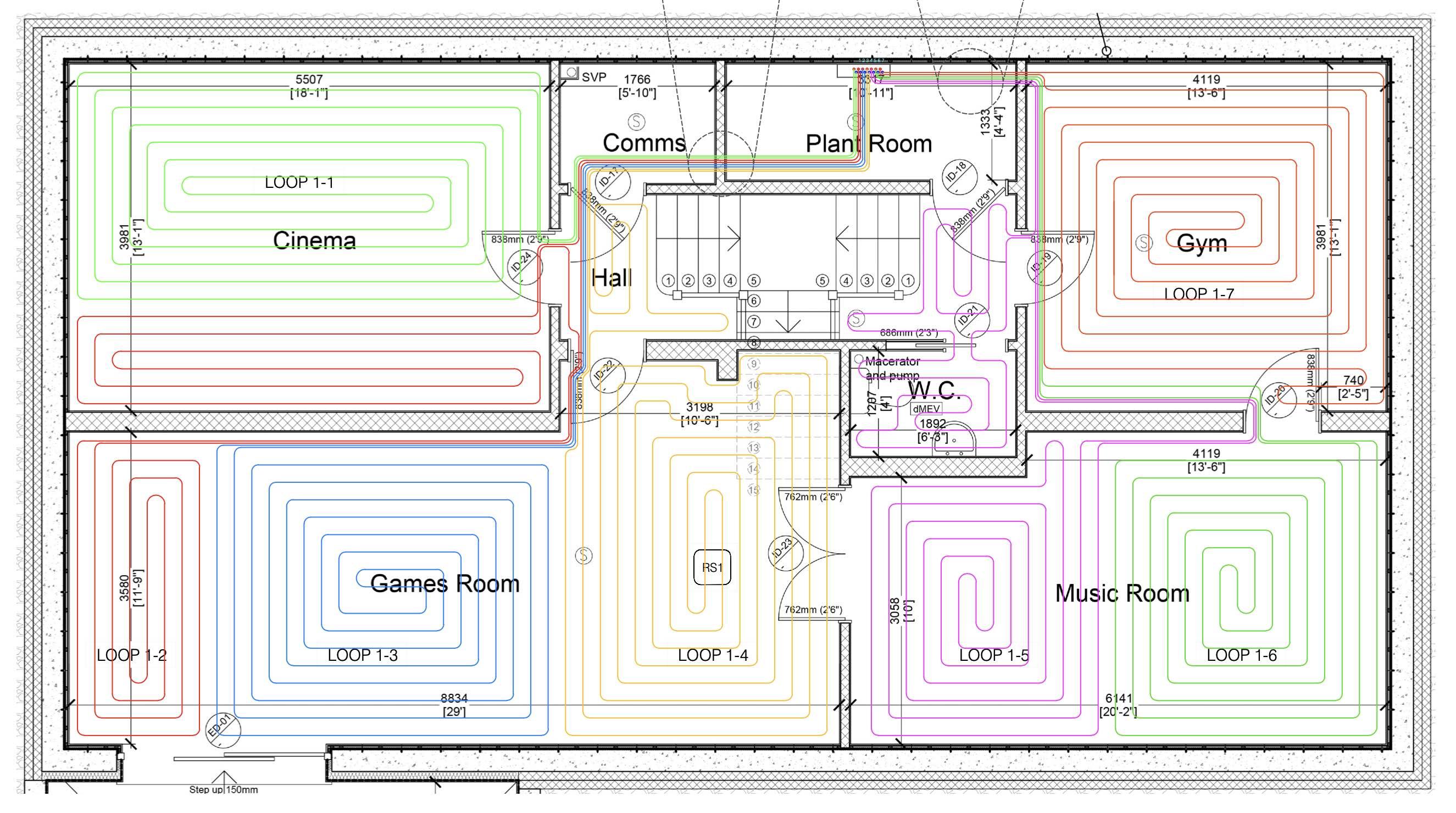

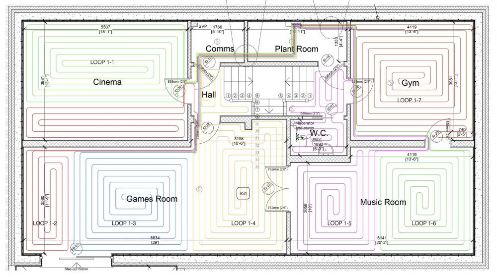

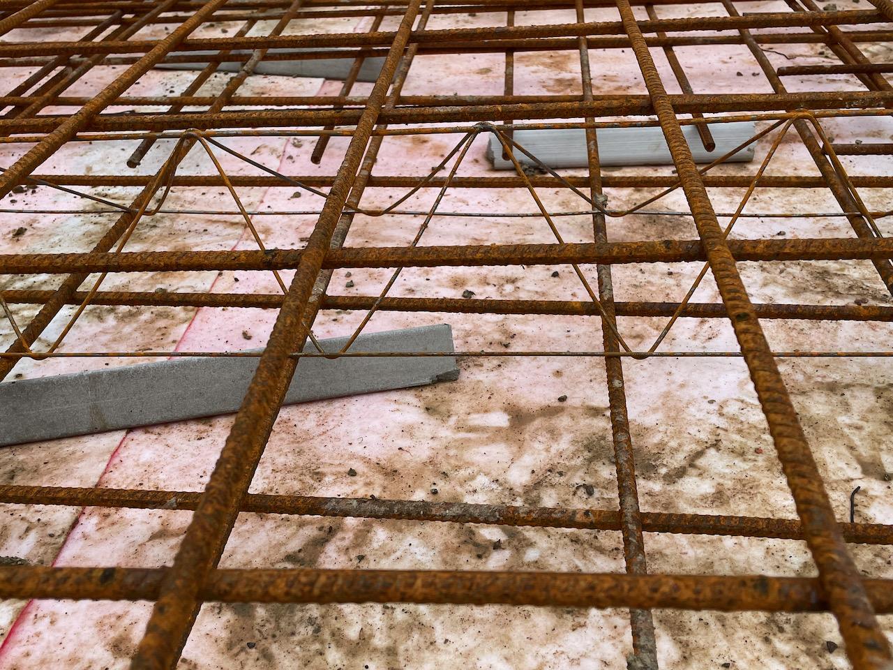

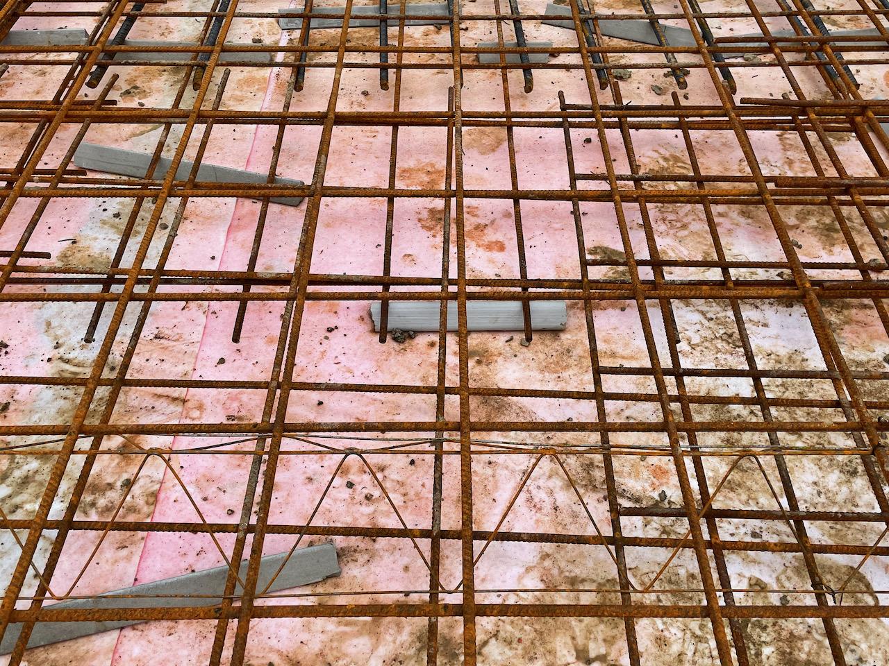

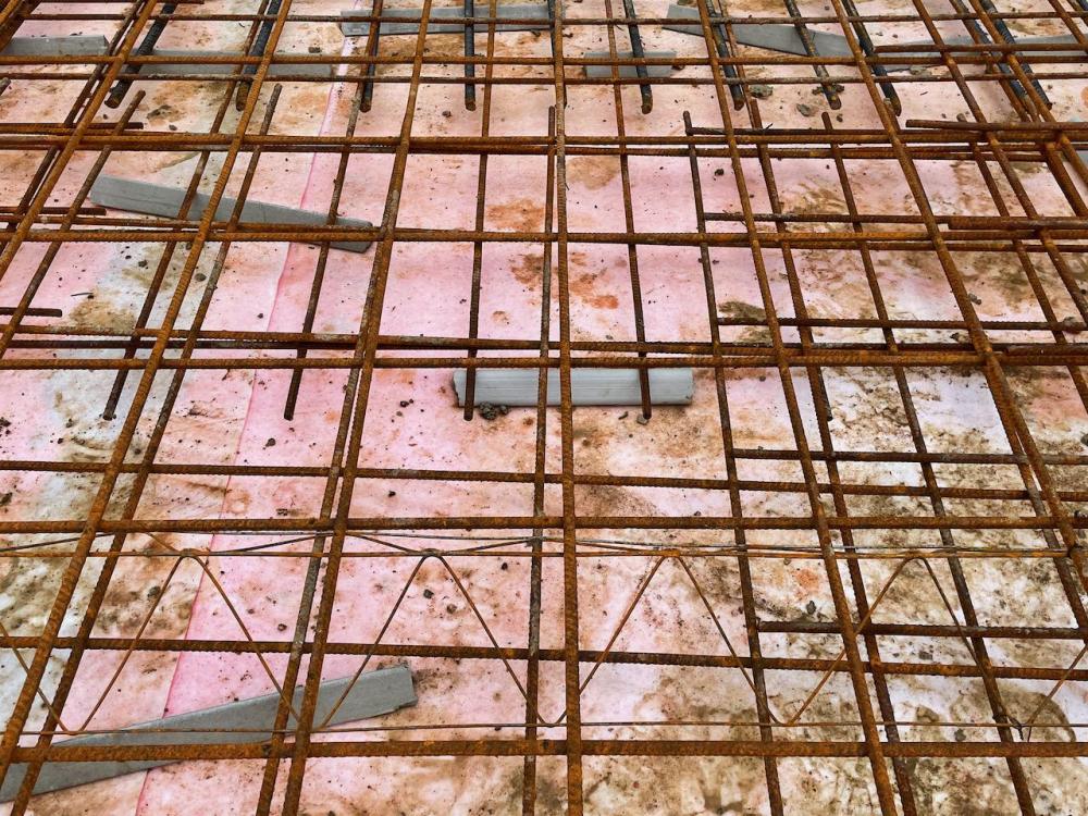

On 14/05/2021 at 12:25, Thorfun said:
@joe90 and @PeterW I've taken another look and lifting up the top mat is never going to happen. here's a couple of photos of the mesh and chairs.
if you both think it'll be a complete nightmare to run the UFH pipe as per the Wunda plan...
347669079_Screenshot2021-05-14at12_20_53.thumb.jpg.55da9af17537ac442c561b471f27bb8f.jpg
then I think we're leaning towards just scrapping the UFH in the basement. I know that @Bitpipe doesn't have heating in his basement and says it's a comfortable temperature all year round so it is a possibility just to scrap it.
I guess this is a dilemma all first time self-builders go through as I have never lived in a well insulated and air tight house so trying to get my head around the concept of not needing heating is a challenge!
