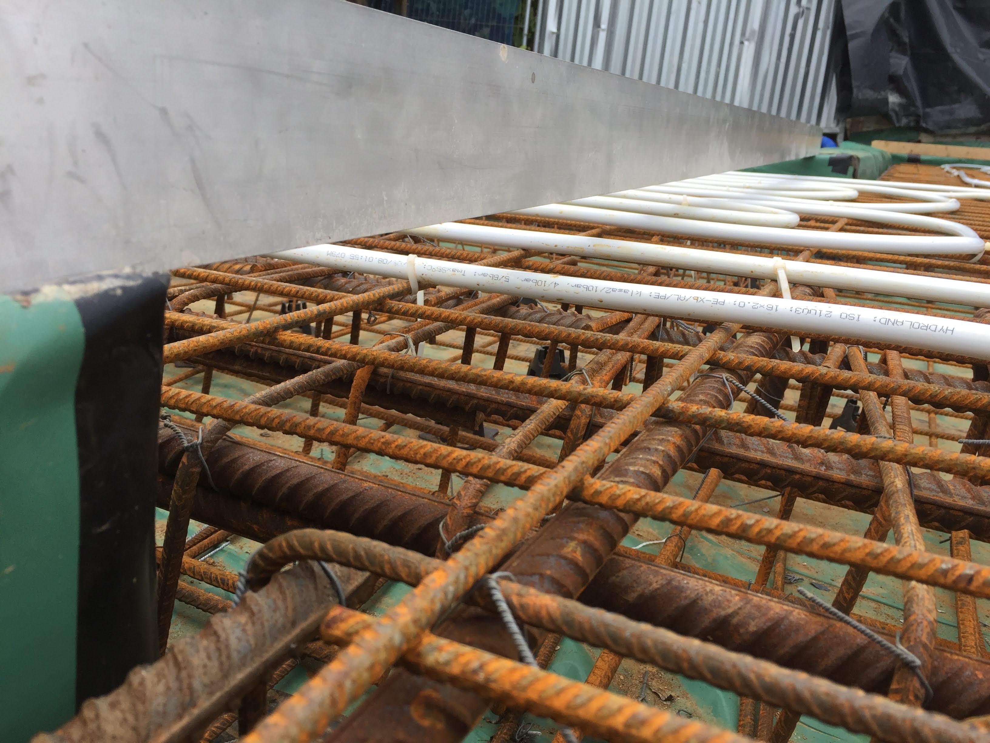

Hi all,
I am hoping that the rebar will be in place for the slab pour next week and so I will have this weekend to lay the ufh pipes in the basement. Wunda have designed it so that all the pipes go through the doorways but as our walls in the basement will be blockwork and there shouldn't be any penetrations/nailing in the slab do I have to stick with running pipes through doorways?
Basically, is it ok to run UFH pipes in the insulated slab underneath blockwork walls?

No issues but you won’t be able to thread pipe under the mesh. You will have to lay the bottom mesh and the chairs, lay the pipes then lay the top  mesh and cable tie the pipe up to the top.
  • Thanks 1
it's too late for that @PeterW. top mesh has already been laid so it'll be a case of threading pipe under the top mesh or just forgoing UFH in the basement altogether! I'm aware it'll be very time consuming but it's the only option I have now.
Having laid UFH pipes I don’t think it would be possible to thread pipes as you want. How difficult would it be to take that top mesh up then put it down again? (I recon faster and easier than trying to thread UFH pipe under it ?)
  • Thanks 1
I'm pretty sure the basement guys have already tied all the steels together so would be a nightmare to undo it all and then re-tie it. (I'll just pop out and take a look)
bugger.

@joe90 and @PeterW I've taken another look and lifting up the top mat is never going to happen. here's a couple of photos of the mesh and chairs.
if you both think it'll be a complete nightmare to run the UFH pipe as per the Wunda plan...
347669079_Screenshot2021-05-14at12_20_53.thumb.jpg.55da9af17537ac442c561b471f27bb8f.jpg
then I think we're leaning towards just scrapping the UFH in the basement. I know that @Bitpipe doesn't have heating in his basement and says it's a comfortable temperature all year round so it is a possibility just to scrap it.
I guess this is a dilemma all first time self-builders go through as I have never lived in a well insulated and air tight house so trying to get my head around the concept of not needing heating is a challenge!

It's not just the heating but also the potential future cooling if connecting to ASHP.
I was also tight for space when fitting the UFH pipes on top of the top layer of mesh but managed it.
Might be worth measuring what height you have available now above the mesh.
Perhaps using 12mm pipe might help...a tiny bit.
Chill :) Can you get a refund on the UFH kit you bought?
I had the same dilemma and at one point of the build even considered retrofitting electric mat heating, but glad I didn't. Since we moved in our basement has never, ever been cold and has never overheated - always a comfortable 20oC year round. To be honest the ground floor heating rarely comes on either.
Try addding up all the watts that your basement electrical kit will generate (especially in rooms like cinema, gym, music, comms & plant room etc) and that's probably more than enough heating input before you add humans to the mix. Remember that your exterior is a consistent 12 degrees or thereabouts so do some thermal modelling based on that.
we'll have between 30 - 40mm between top of mesh and top of slab. working on 30mm with the 16mm pipe it leaves only 14mm between top of pipe and top of slab. I sent this information to the structural engineers and they said that isn't enough. not sure 12mm pipe would help much tbh and, it's probably too late as the pour is on Tuesday.
For peace of mind, you can get your electrician to make provision for a few panel heaters (i.e. just fused spurs) or just 13A sockets and add those later as a worst case measure (you won't need them). If you're tiling the WC floor, plan a 150W electric heating mat under the tiles.
You don't seem to have much in the way of natural light in there though - no light wells at all or just not reflected in that drawing?
I probably could get a refund on the UFH pipe from Wunda but as we're going to install wet UFH on the ground floor I might as well just keep it for when that happens.
when I discussed this with the wife she also said that most of the rooms in the basement are active rooms so when we're playing music or in the gym then we'll be generating heat, the cinema projector will chuck out enough heat as well and so it'll just be the games room area which will probably end up being a den for the kids and their mates so that might be the only potential area that needs heating and if there are a few of them then I'm sure it'll be fine.
We don't have much natural light. we were thinking of light wells but it was an expense and complication that we decided not to bother with as the activities that the rooms have been earmarked for don't really need natural light and there should be enough coming through the sunken courtyard sliding doors to make the games room area light enough for teenagers. ?

anyway, I've made the decision now. we're not having UFH in the basement for now. we'll see how it all goes and can always add something later if at all required but we don't think it will be going on the levels of insulation we have and other member's experiences.
