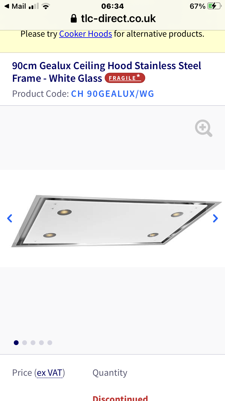

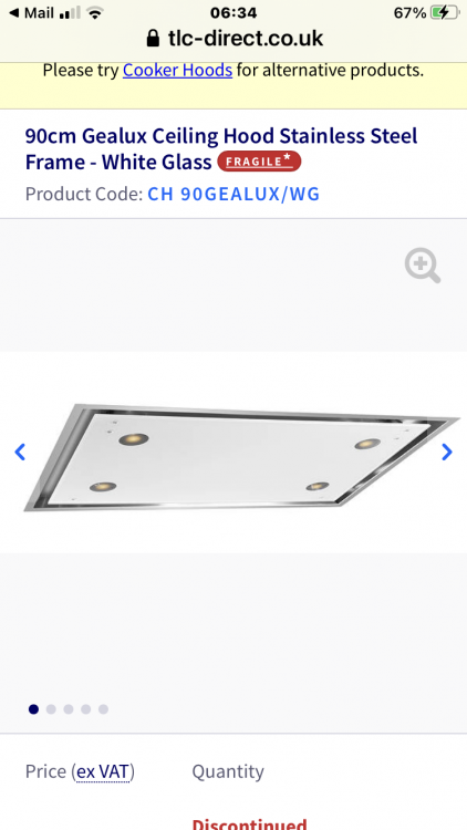

nod Posted May 12, 2021 Share Posted May 12, 2021 We used Geolux Far more powerful than we needed Link to comment Share on other sites More sharing options...
PeterW Posted May 12, 2021 Share Posted May 12, 2021 7 hours ago, irish_admiral said: Hi PeterW Yup, I’m sure: https://luxairhoods.com/image/catalog/PDF/Cooker Hoods/Ceiling Hoods/LA-Celux-Delux/LA-Celux-Technical-Info.pdf I’m new to the area, but 720m3/hr comes down to 12m3 per minute, and less per second based on my maths? yep - that is 203l/s which is quite substantial on full power ..! It’s nearly 7 times the building regs minimum hence my query. Link to comment Share on other sites More sharing options...
irish_admiral Posted May 12, 2021 Author Share Posted May 12, 2021 1 hour ago, nod said: We used Geolux Far more powerful than we needed Thanks Nod. Think that’s one of the old Gealux models? It has a lot more welly than the newer ones (950m3/h vs 650m3/h)... would be interested to know if you ever use it on max and how noisy you find it?! How big is your kitchen space? Cheers pal. Link to comment Share on other sites More sharing options...
nod Posted May 12, 2021 Share Posted May 12, 2021 It has four setting We tend to just use number 1 Number4 four will clear a burning grill in seconds Though its like being stood next to a jet engine I fitted it three years ago Link to comment Share on other sites More sharing options...

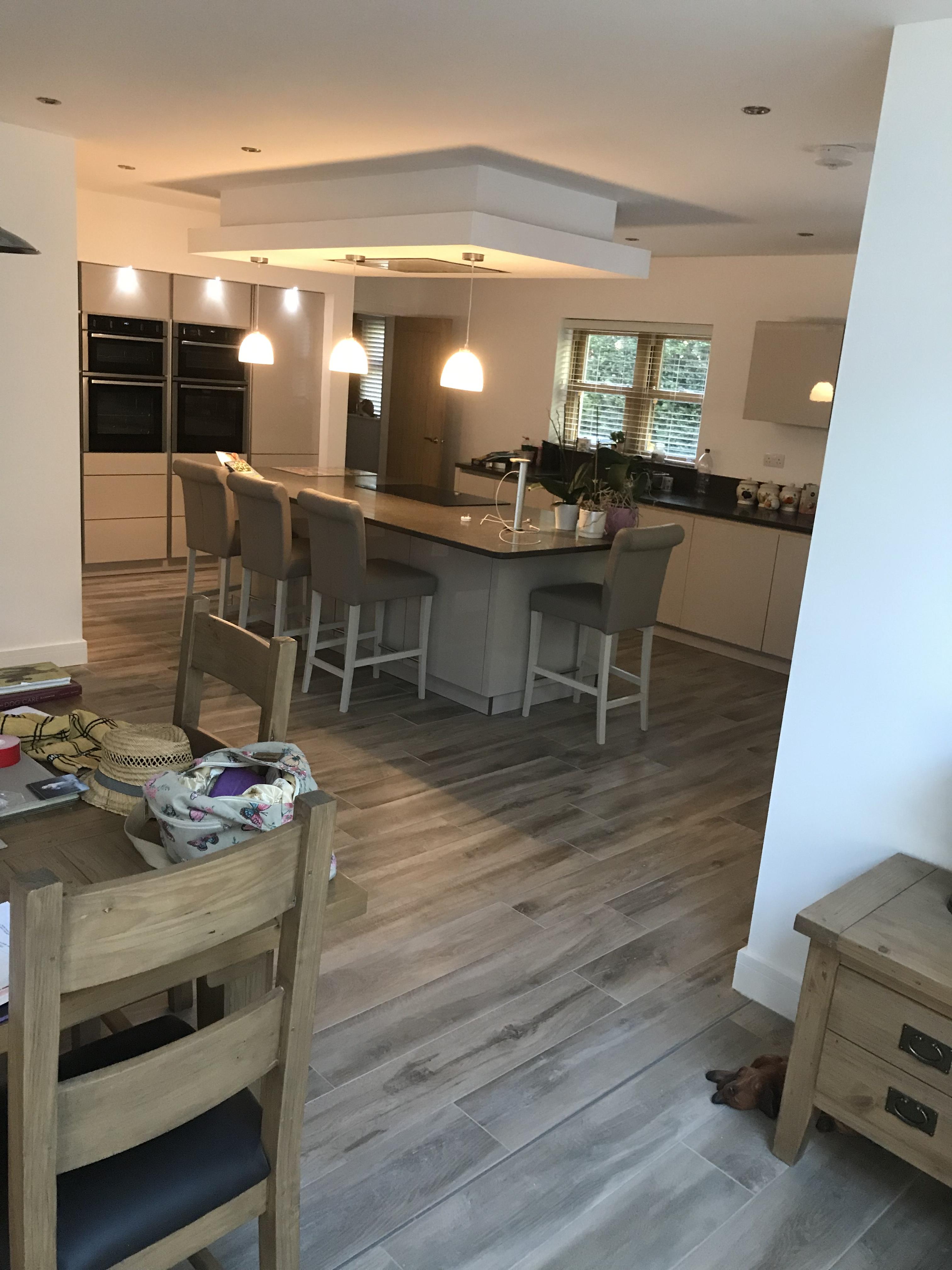

nod Posted May 12, 2021 Share Posted May 12, 2021 2 hours ago, irish_admiral said: Cheers mate. Good to have some real-world feedback (the numbers don't always tell the story). I'm interested in particular in the extraction values... sound levels i'm pretty good at as I moonlight as a PA tech, and know what 'loud' is! Our current one runs at c.69dB at full welly, and that's pretty loud. Louder than i'd want in an open plan most of the time. What size is your space if you don't mind me asking? Ta. It’s 110m2 of floor Ceiling to floor is 2.7 Link to comment Share on other sites More sharing options...
irish_admiral Posted May 12, 2021 Author Share Posted May 12, 2021 3 hours ago, nod said: It’s 110m2 of floor Ceiling to floor is 2.7 Nice! That's a fair old space. Good to know it clears it well. Link to comment Share on other sites More sharing options...
