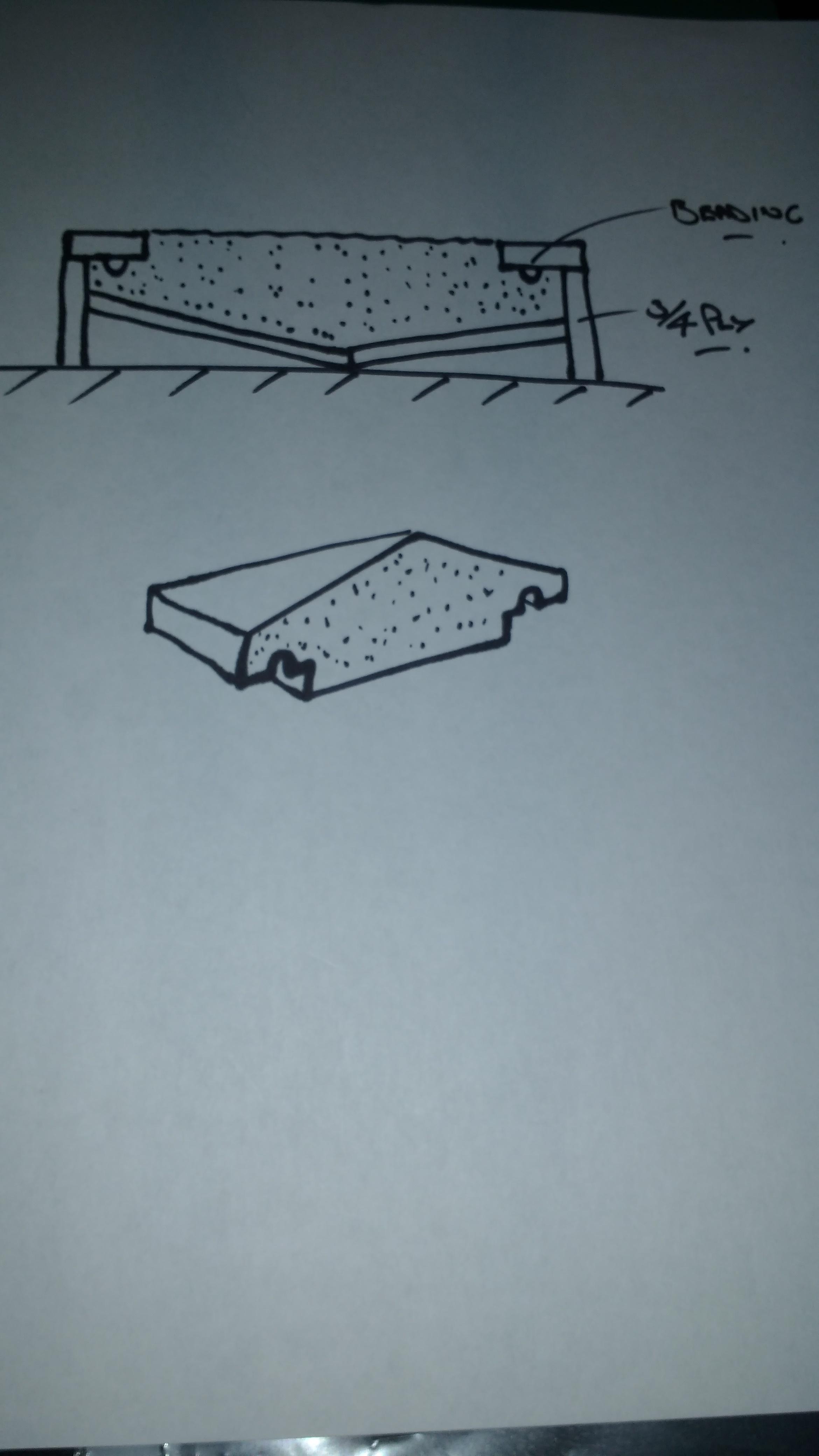

epsilonGreedy Posted May 9, 2021 Share Posted May 9, 2021 (edited) Just musing the practicalities of this... On a long walk around the village I noticed that most properties built over a 100 year time span have rough cast concrete window cills and this includes new heritage houses that were build around 10 years ago under the regime of a very strict conservation officer. The rough cast cills are typically 1 brick high with a shallow gradient for water run off and are painted in the same colour as the window frame. Would this type of window cill be cast in-situ in the window aperture or on the ground and then fitted like a normal art stone window cill? Part of the motivation for doing this is to avoid the modern estate look with 2 brick high bathstone coloured cills and I also assume it would be cheaper. Edited May 9, 2021 by epsilonGreedy Link to comment Share on other sites More sharing options...
tonyshouse Posted May 9, 2021 Share Posted May 9, 2021 I have done the several times, need to mitigate thermal bridging, concrete is a bit naff so we buttered the shuttering box with a clever mix of yellow pit sand and white cement , add a few bits of reinforcement then careful concrete, finally top off with the sand mix ensuring no concrete shows when set almost indistinguishable from real Bath stone. easier on the floor for upstairs, quoins etc - 1 Link to comment Share on other sites More sharing options...

PeterW Posted May 9, 2021 Share Posted May 9, 2021 I cast a load of coping stones to match a Yorkstone using a mould made from kitchen cabinet offcuts. Mix is 4 parts washed plastering sand, 1 part white cement and 1/2 lime. Half filled the mould, laid in some cut up rendering mesh (glass fibre coarse mesh) and then topped up. Vibrate it with the SDS drill and left to set. all look good and tbh 1/10th of the price of York stone...!! 1 Link to comment Share on other sites More sharing options...

epsilonGreedy Posted May 9, 2021 Author Share Posted May 9, 2021 14 minutes ago, Onoff said: I need to have a drip bead on all 4 sides and that looks to be a nice "fine" mix that'd take up the drip bead detail. I was thinking of using a rubber or plastic strip to form the drip gully and leaving it there for a week after the mould has been released, before pulling the strip out. Link to comment Share on other sites More sharing options...
PeterW Posted May 9, 2021 Share Posted May 9, 2021 1 hour ago, Onoff said: Would that mix work for gate pillar caps? I need to have a drip bead on all 4 sides and that looks to be a nice "fine" mix that'd take up the drip bead detail. Is washed plastering sand commonly available? Yeh it would and just a square of 10mm copper pipe pushed in, or even just scrape off the excess and when it starts to set you could carve in the drip detail with some sort of tool. Plastering sand in tonne bags is about £40 around here and available from the Jewson/TP/MKM merchants and also from Wickes I think. Link to comment Share on other sites More sharing options...
Onoff Posted May 9, 2021 Share Posted May 9, 2021 6 minutes ago, PeterW said: Yeh it would and just a square of 10mm copper pipe pushed in, or even just scrape off the excess and when it starts to set you could carve in the drip detail with some sort of tool. Plastering sand in tonne bags is about £40 around here and available from the Jewson/TP/MKM merchants and also from Wickes I think. Cheers. I only need to make 2 caps so these would do: https://www.wickes.co.uk/Tarmac-Plastering-Sand---Major-Bag/p/131886 Plus some of my hydrated lime! Link to comment Share on other sites More sharing options...

Onoff Posted May 9, 2021 Share Posted May 9, 2021 @Construction Channel made his: 1 Link to comment Share on other sites More sharing options...
epsilonGreedy Posted May 9, 2021 Author Share Posted May 9, 2021 1 hour ago, Onoff said: @Construction Channel's photo of the cill moulding is very instructive. I assume the metal reinforcement grid is stainless. If I copied that I think I would raise the grid 20mm above the bricks below for increased strength. I like the rear overhang detail, I now reckon I should form the rear of the mould using PIR that will permanently sandwiched by the finished cill. I notice @Construction Channel solved the potential for leakage down the facing bricks by squashing some foam between the brickface and front moulding. He well and truly cramps the front moulding to the inner block wall with long cramps, not sure of their correct name. The taper at each end will look good in the final cill and also helps the release I assume. And he used cable to form the drip channel. 1 Link to comment Share on other sites More sharing options...
Construction Channel Posted May 10, 2021 Share Posted May 10, 2021 19 hours ago, epsilonGreedy said: @Construction Channel's photo of the cill moulding is very instructive. I assume the metal reinforcement grid is stainless. If I copied that I think I would raise the grid 20mm above the bricks below for increased strength. I like the rear overhang detail, I now reckon I should form the rear of the mould using PIR that will permanently sandwiched by the finished cill. I notice @Construction Channel solved the potential for leakage down the facing bricks by squashing some foam between the brickface and front moulding. He well and truly cramps the front moulding to the inner block wall with long cramps, not sure of their correct name. The taper at each end will look good in the final cill and also helps the release I assume. And he used cable to form the drip channel. Couldnt have explained it better myself. But the mesh was just standard galvanised and was raised a little while i filled the mould Link to comment Share on other sites More sharing options...
Onoff Posted May 10, 2021 Share Posted May 10, 2021 I'm going to make an upside down mould like this if I can figure the "pyramid" maths to cut the bits. I'll then fill from the top and vibrate it so it hopefully fills the voids: Link to comment Share on other sites More sharing options...
