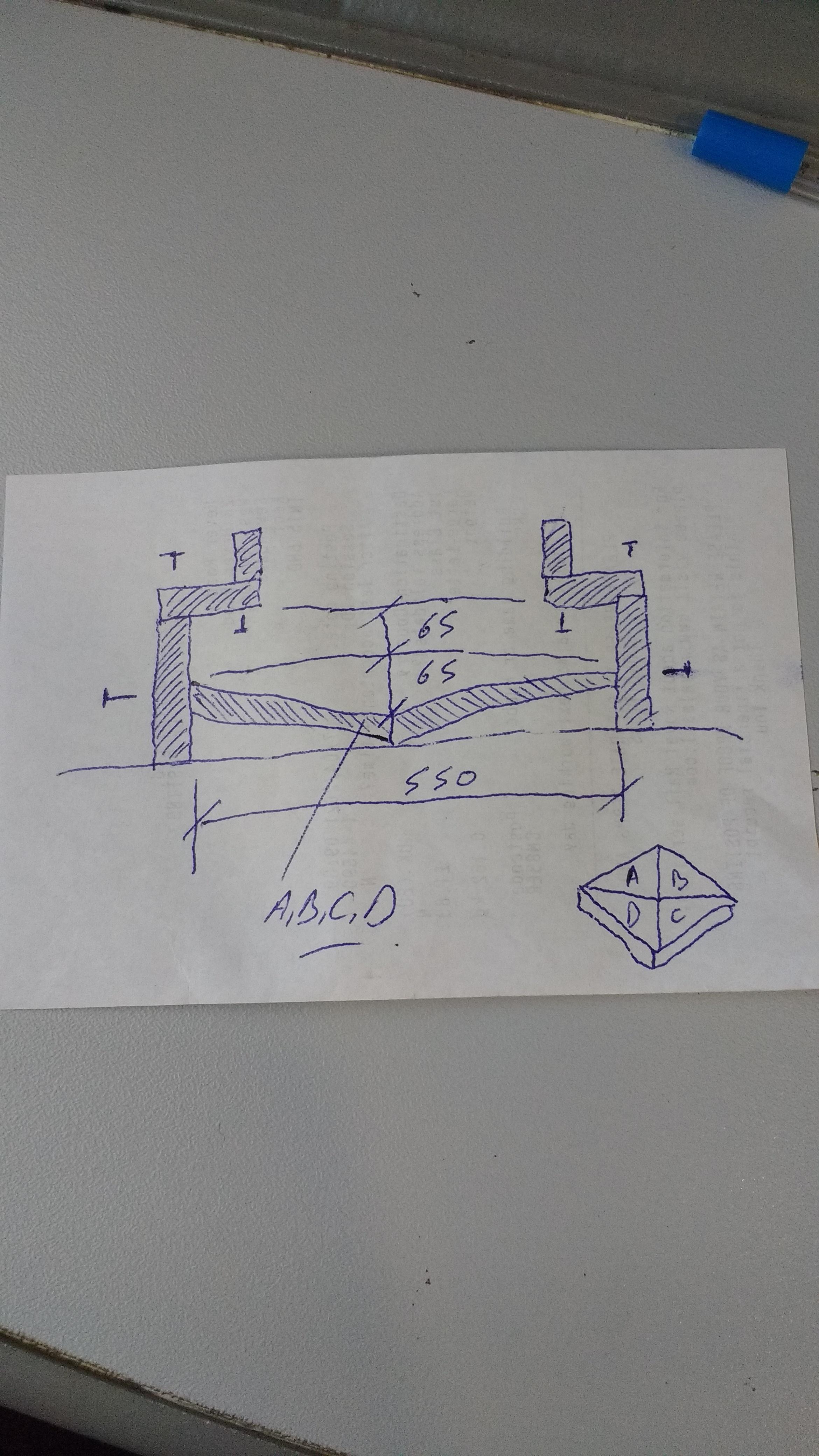

The pillar is 2x2 bricks so 450x450mm. I want a 50mm overhang around the edges with the drip bead say 25mm in from the edge.
Overall height 130mm so a 65mm pyramid sat atop a 65mm slab. Just got to calculate & cut, 4 precise, triangles that will butt up and glue to each other to form the pyramid.

Basically this fag packet sketch drawn on a lurching train!
The key really is 4 triangles as aforementioned. The angle where the sloping sections meet the vertical sides of the mould, no problem. Just need to figure where the day A edge meets B edge. Fire up the CAD!

Putting your numbers into the online trig calculator at http://www.carbidedepot.com/formulas-trigright.asp
Using SideA = 65 SideB = 275
I make the pitch of your pyramid to be 13.3 degrees which is good aesthetically speaking because too steep would look a bit toytown.
Of more interest the calculated SideC is 282.6mm which is one side of your right angled moulding triangle. The gutter side of your moulding triagle is 275mm i.e. half the length of one side of your plan view.
Going back to the online trig page and calculating a new triangle.
Using SideA = 275 SideB = 282.6
Which gives us a calculated SideC of 394.3mm (*) which on a hipped roof would be the length of the hip rafter and also the 3rd side of your moulding triangle.
Hence 4 triangles measuring 275 x 282.6 x 394.3 should fit together to create your 13.3 degree pitched pyramid.
However never trust what you read on the internet so let's test my numbers with a different calculation.
The plan view length of one of those hip lengths is derived from an isosceles triangle with two sides measuring 275 which gives a SideC = 388.9mm (**)
Viewing the same hip rafter triangle from the side we calculate a new triangle with Using SideA = 65 SideB = 388.9 (**) we get... SideC = 394.3 (*) which matches the original calculated SideC ?
The pitch of the hip is 9.5 degrees taken from AngleA in this new triangle. That set off an alarm bell in my head then I realised a hip rafter pitch is always significantly lower than the principal roof pitch.

Ta. CAD concurs at 394.3mm on 2 sides. I get 9.49deg on those sides & 13.3deg on the 550mm side.

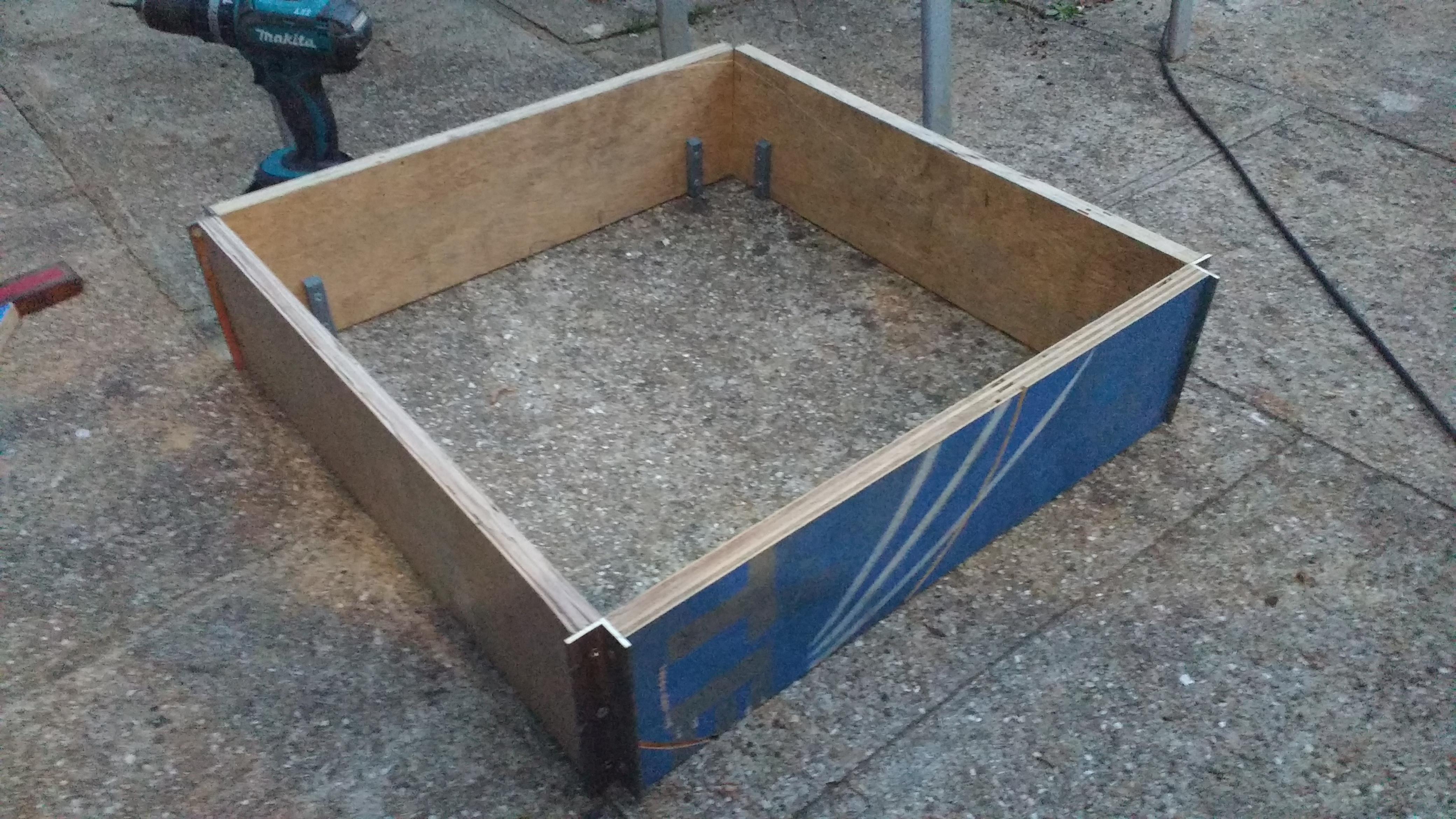

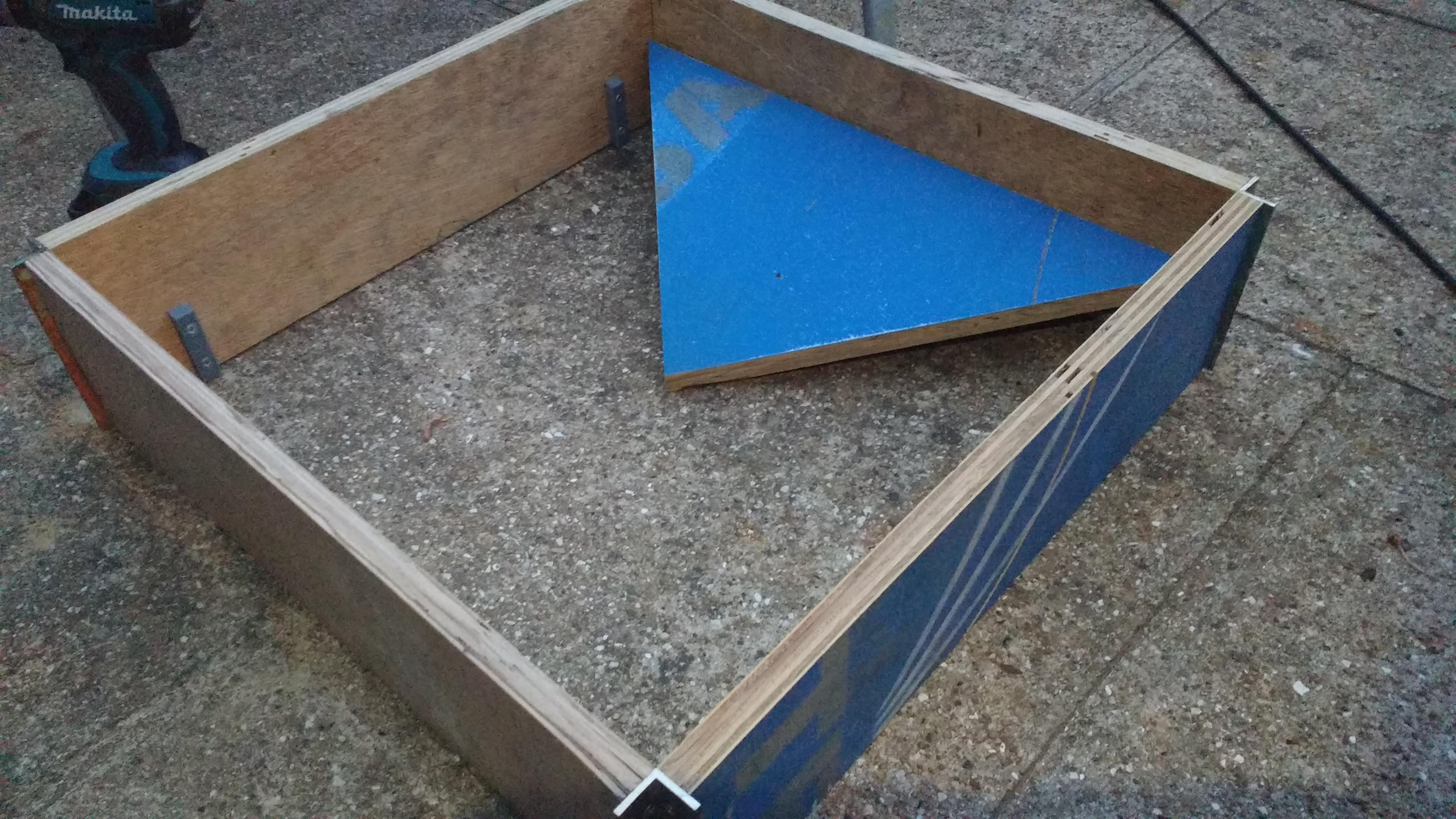

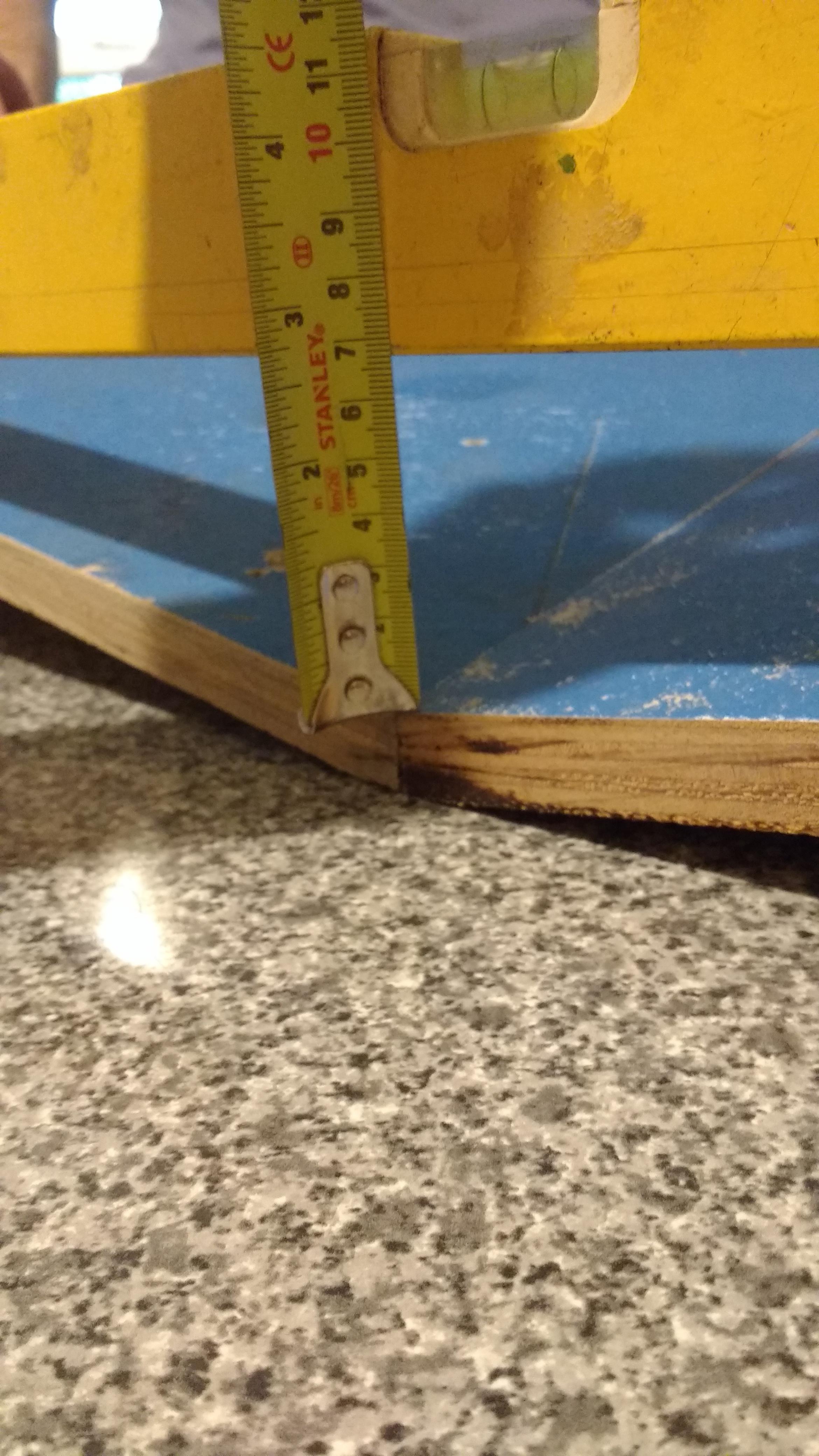

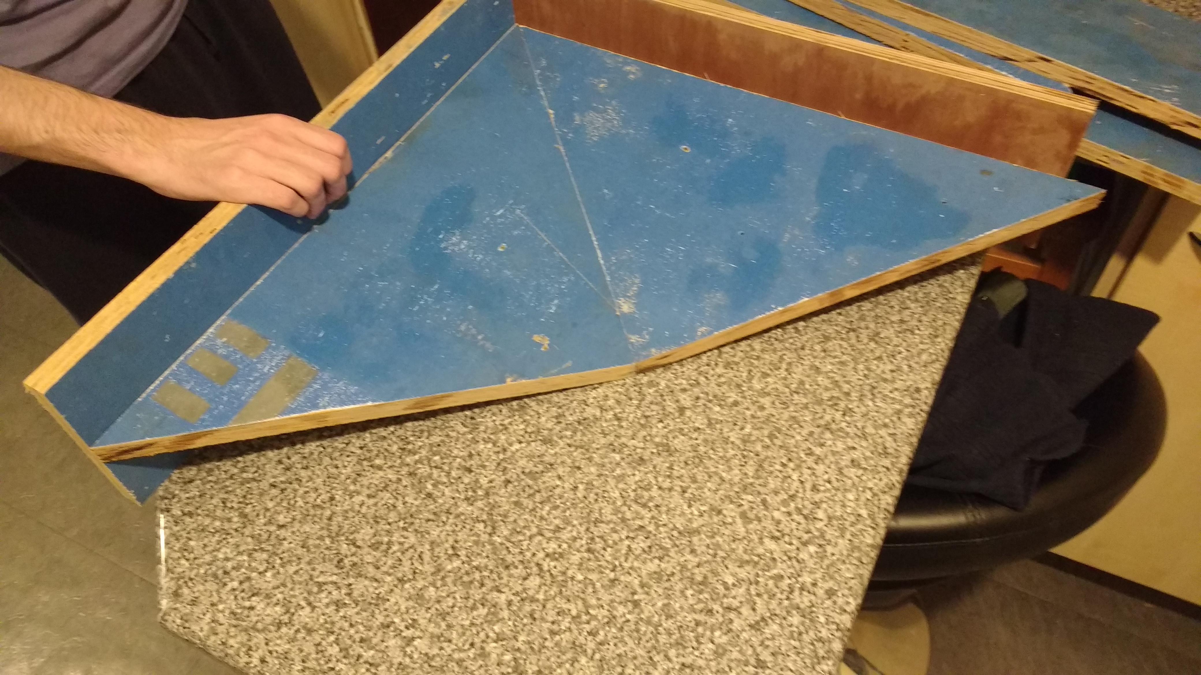

Making some supports to go inside the mould:

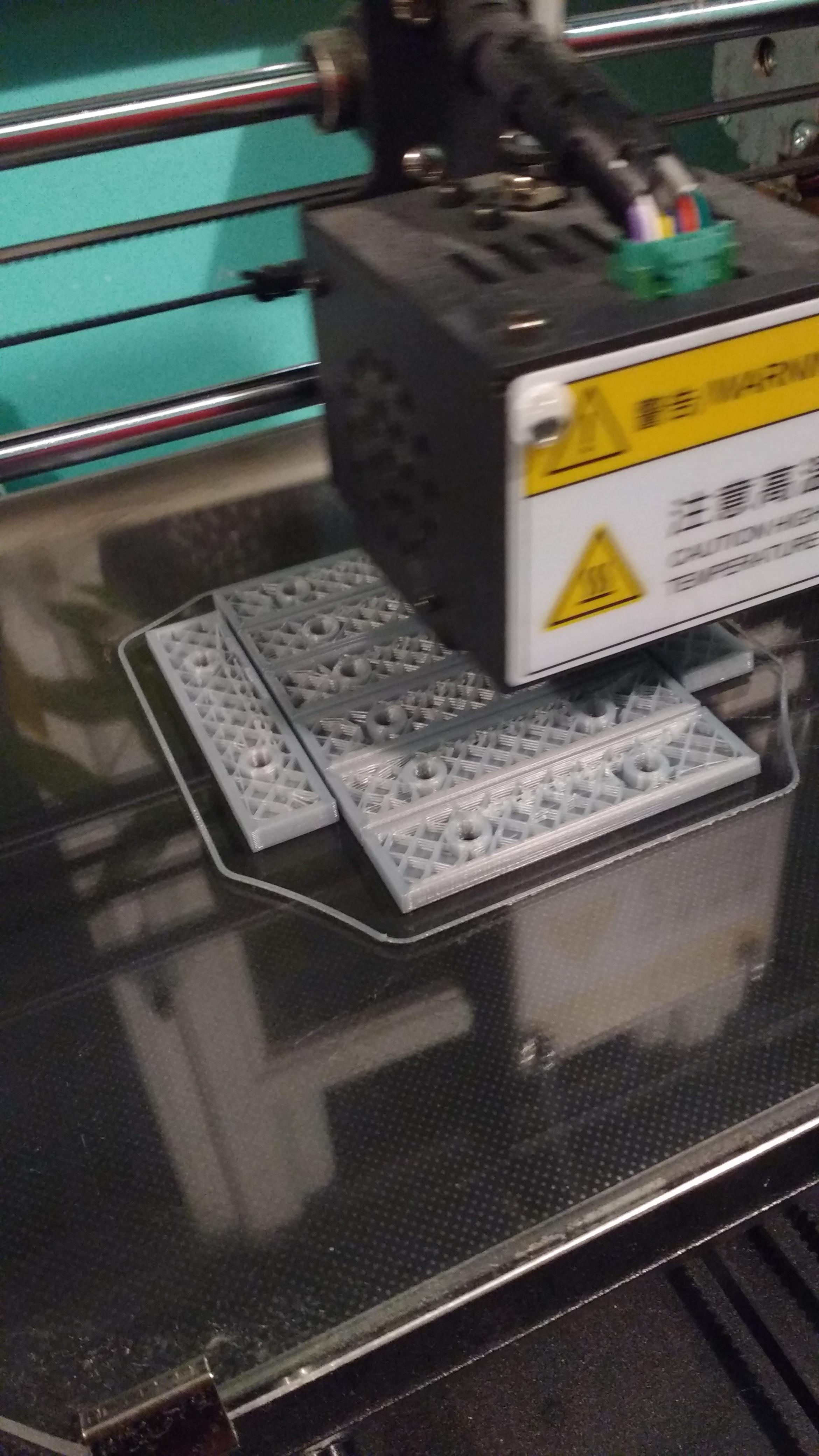

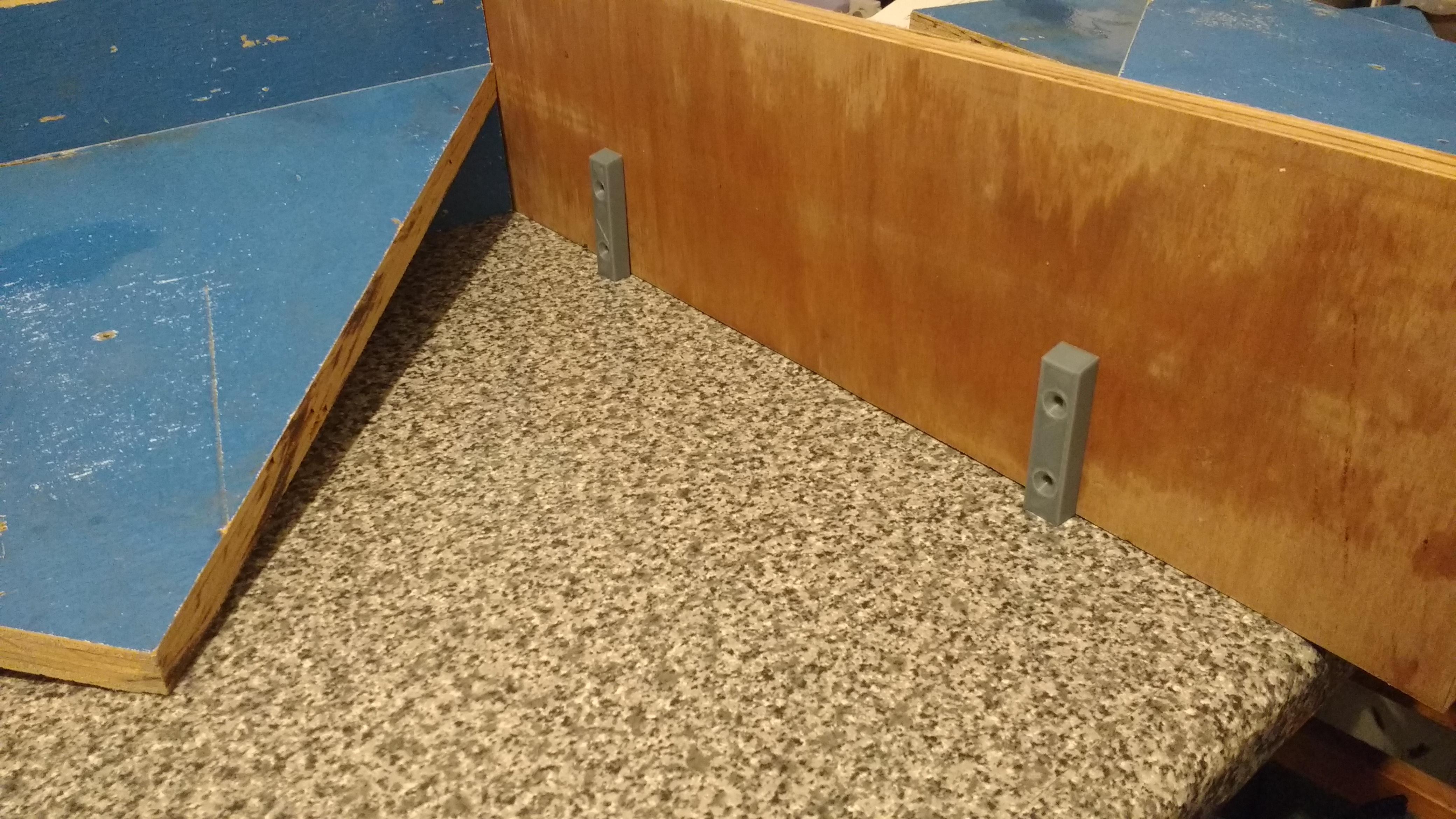

Looking like the mould idea will work. Some scrap 18mm ply (old site hoarding). The 3D printed bits will screw onto the sides. Tbh I should have done them at 9.5deg but they're at 9.
These will support the top edge of the triangles that form the pyramid:
I was aiming for 65mm and it's just over. Might change when all screwed together.

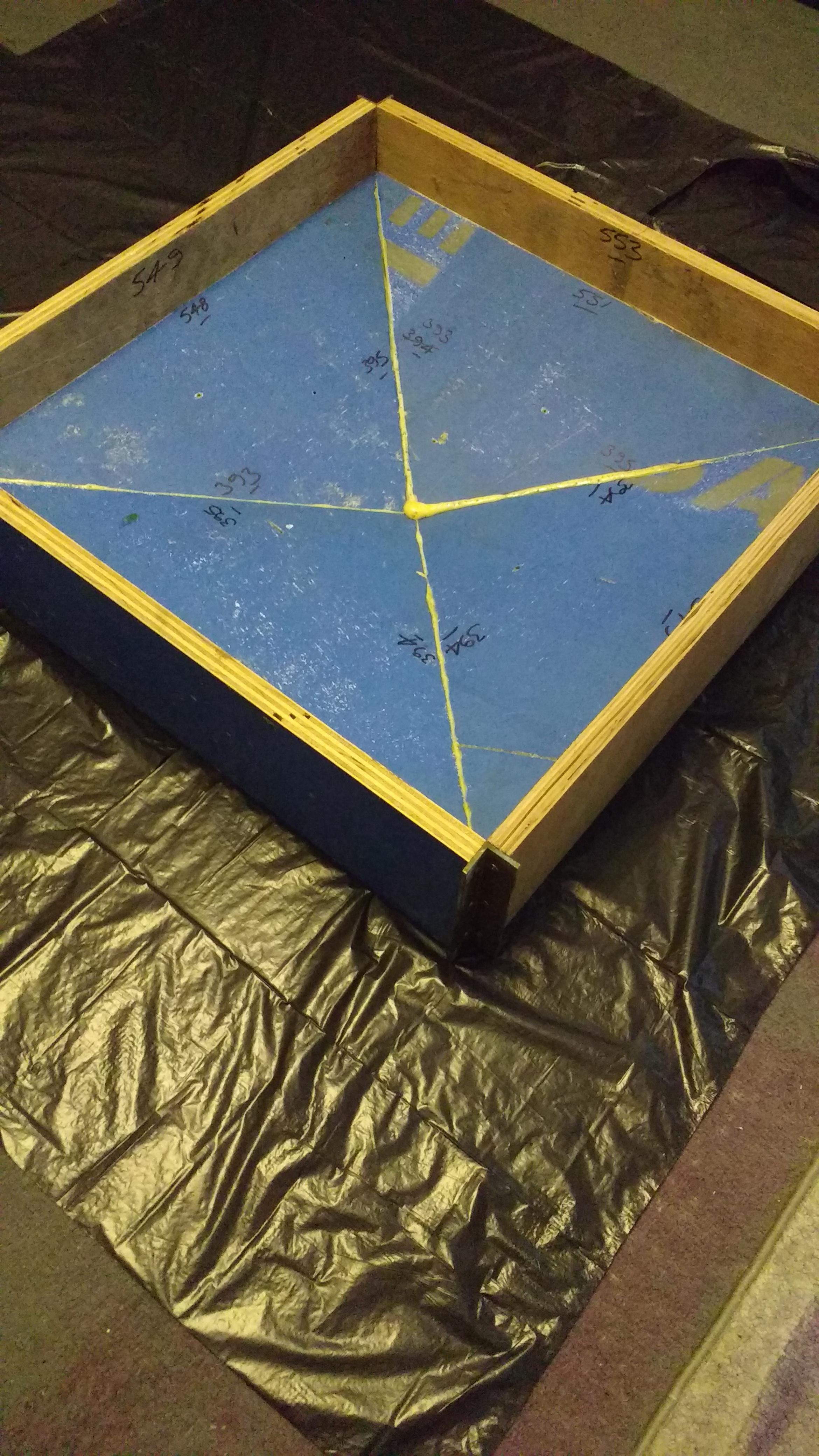

I'm going to use spray adhesive and line the mould with DPM.

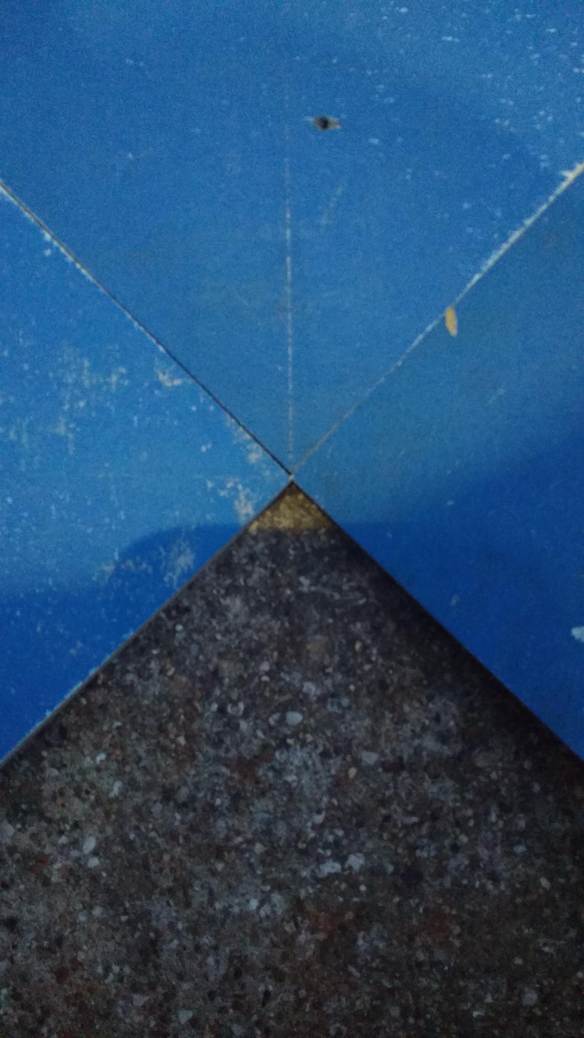

A little fettling required. It'll be accurate enough for a pier cap!
I glued the mating faces of the pyramid with Gorilla Glue. Not a perfect fit at the apex as in a mm or two out but good enough I think. Going to carefully have to multitool the glue off...
I'm debating next sticking sections of DPM in. Then, at the joins running a bead of silicone and taking it off with the Fugi Cramer tool to get radiused edges.
