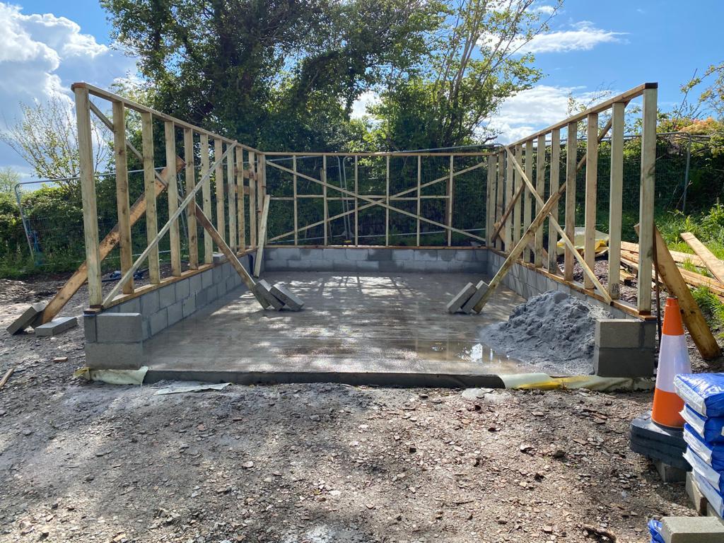

Omnibuswoman Posted May 25, 2021 Author Share Posted May 25, 2021 Quick update, and bit of a panic about the roof.... We have three of the walls done now - 1750mm studs (2x4s) with top and sole plate, fixed into the blocks with hammerfix screws. Overall height is 2310mm which feels generous for my height (1.6m) and even adequate for HWMBO. So far so good... We are going to move on to the front wall today, but I have started thinking about the roof and panicking that my design isn't sound... The workshop is 6.5m long and 4.6m wide. I had planned a ridge plate (2x10) with 2x6 rafters coming up to meet it, covered in 18mm ply. I ordered two 3.6m lengths of 2x10 for the ridge plate. I started looking at how to fix them together, and then had a panic about the roof design not being sufficient and collapsing in and killing us all.... So now I'm considering whether to do an almost flat roof by adding an extra top plate on the right hand side, and running timbers across the 4.6m width sloping down slightly to the left hand side. I spent a lot of last night looking at roof trusses and the design of trusses, but it looks quite difficult to get right, and I'm still worried about the roof falling in. Any and all thoughts will be hugely appreciated!! Photos of progress to date attached... Link to comment Share on other sites More sharing options...

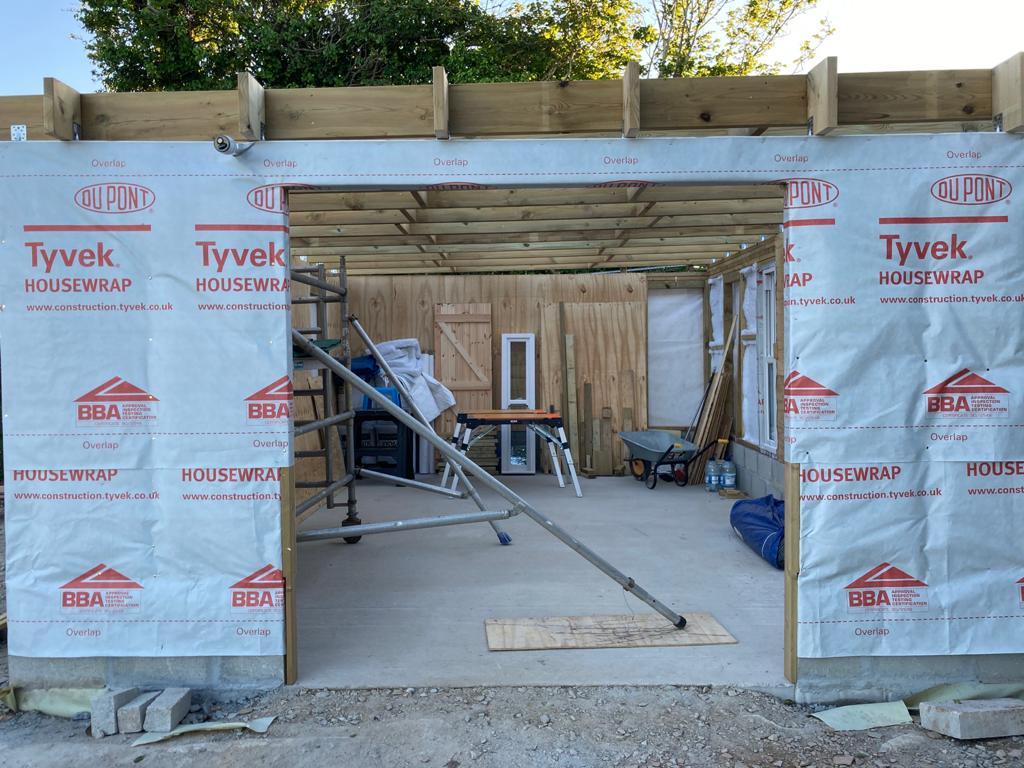

Omnibuswoman Posted May 25, 2021 Author Share Posted May 25, 2021 Problem solved, courtesy of Ali Dymock's amazing YouTube videos and the span tables linked to above. We need 10x2s for the 4.6m span, and will put in some noggins for stability/to better support the roof. 18mm ply on top, with EPDM over that. It actually looks achievable now, although we only have until the end of the day on Monday which might be a challenge. I can see that Ali Dymock left his garden room wrapped in tyvek membrane all winter, so if we run out of time to do the cladding it won't be the end of the world as we can return to it later on. Where would I be if not for the buildhubbers?!! 1 Link to comment Share on other sites More sharing options...
Nickfromwales Posted May 25, 2021 Share Posted May 25, 2021 Mine's been wrapped in membrane since the start of last winter. Perfectly fine and I'm only now continuing with the cladding which I'm doing 'in my spare time', so probably be 'part-wrapped' for 3 more winters at this rate Seriously consider some of the closed cell spray-on insulation kits to boost draught-proofing and insulation in both the roof and the walls Quick, easy and effective. Wish I had done mine ? May well attempt a retro fit somehow if I can inject from inside..... 1 Link to comment Share on other sites More sharing options...
TonyT Posted May 25, 2021 Share Posted May 25, 2021 My house wrap was only guaranteed for something like 4 months exposure to UV Tyvec house wrap I think from memory. Link to comment Share on other sites More sharing options...
